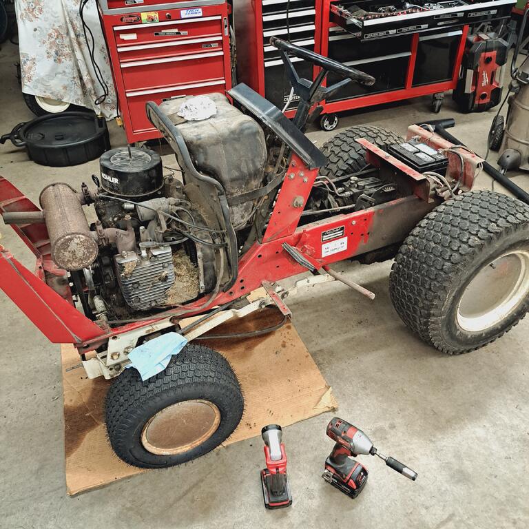

WHX?? 55,620 #1 Posted June 20, 2024 (edited) Got for a song... might win a award for the filthiest tractor ever. Stripped down for a bath & a real pain getting engine tins off. I had looked at this tractor a couple years ago as having a donor motor for a ailing C-195. Super C since moved on. KT17 series 1 with some hours on the clock but runs good. Always operated on flat ground. Kohler must be embarrassed with series 1 as they won't even give a IPL! This one will get flipped after full maintenance. Any one care to guess it's worth? Has a 44" deck in nice shape and a brand new electric clutch. Edited June 20, 2024 by WHX?? 3 Share this post Link to post Share on other sites

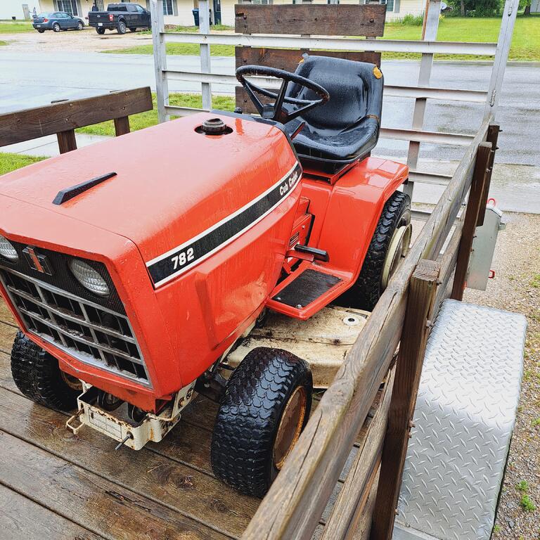

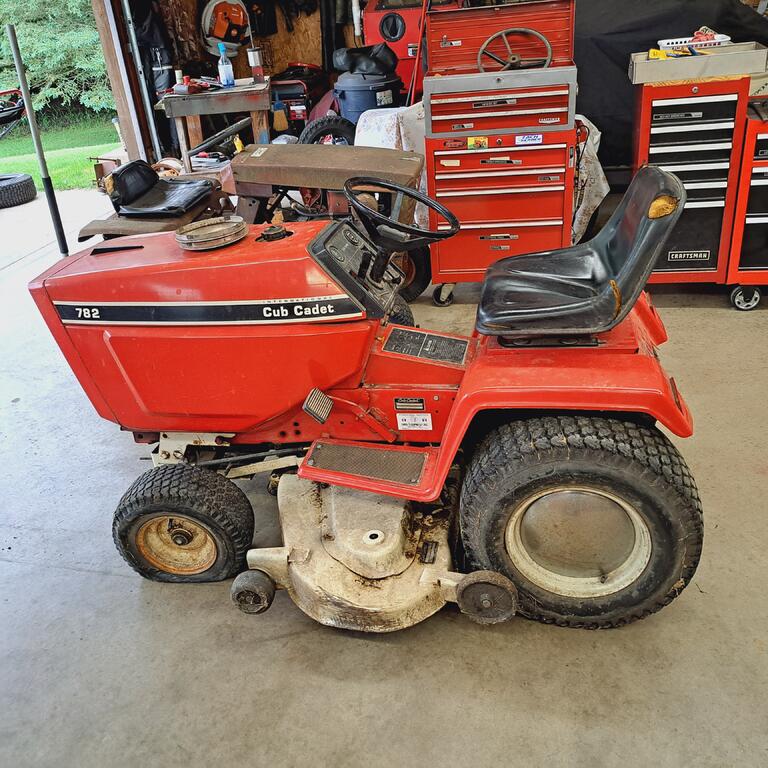

WHX?? 55,620 #3 Posted June 20, 2024 Anyone cipher for the year? This one has IH badging & @Achtosays that was stripped off when MTD took over the brand early 1980s? 1 Share this post Link to post Share on other sites
Achto 31,243 #4 Posted June 20, 2024 (edited) The IH serial numbers 1979 2050594U643507 1980 2050594U667400 1981 2050594U685776 IH sold the line to MTD in May of '81. The last recorded SN was at the beginning of April & ended in 693143. I can not find a list for the MTD models 1982 - '85 Looks like yours may be an '82 or newer. Edited June 20, 2024 by Achto 2 Share this post Link to post Share on other sites
Achto 31,243 #5 Posted June 20, 2024 Did some more research. MTD switched to using the model number to indicate the year of the tractor. Model number staring with - 142 = 1982 143 = 1983 144 = 1984 145 = 1985 2 Share this post Link to post Share on other sites
Achto 31,243 #6 Posted June 20, 2024 (edited) More indications as to who was in charge when the tractor was built. '79 - 81 serial plate will say International Harvester - Chicago IL '82 - '85 serial plate will say Cub Cadet - Brownsville or Cleveland IH used iron for the tranny cases, MTD apparently switched to using aluminum. Nuff learning for me today. Edited June 20, 2024 by Achto 3 Share this post Link to post Share on other sites

WHX?? 55,620 #8 Posted June 20, 2024 44 minutes ago, ebinmaine said: So which one does yours have? Not sure so frickin dirty not a bare piece of metal showing! Pump is AL but they all were. Will find out at bath 🛁 44 minutes ago, ebinmaine said: You did good ! Yeah Thanks.. I had a hard time just finding manuals. Tractor Data wasn't real helpful. Will call it a '83 MTD. Me thinks MTD may have paid IH to use their badging & trademarks for awhile. Sales & marketing don't ya know. Thing sure does have the customary Cub hydro road gear tho. Skiing anyone!?!? 1 2 Share this post Link to post Share on other sites

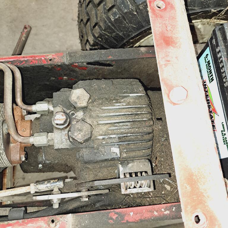

WHX?? 55,620 #11 Posted June 21, 2024 Just these two...EB? No drain plug on transmission Dan? 1 Share this post Link to post Share on other sites

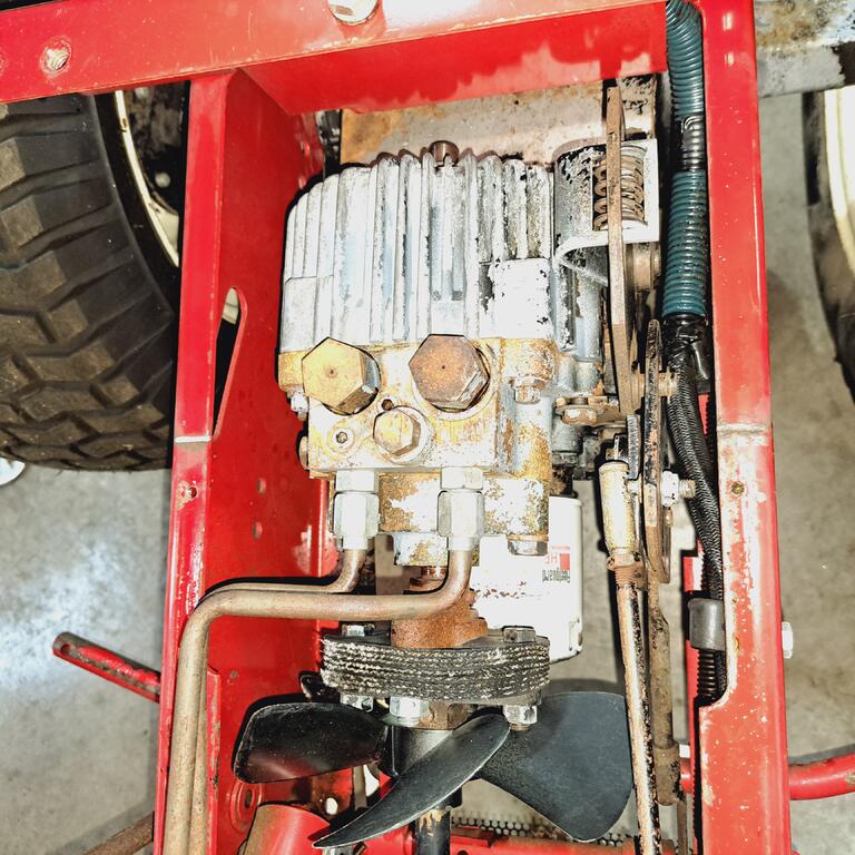

WHX?? 55,620 #12 Posted June 21, 2024 (edited) Appears the transmission is cast with AL axle stubs. Uses the same 1410 NAPA/ 3990 Toro filter as horses. Wonder can a guy drain the tranny by taking off the rear plate or the pump suction tube? Otherwise cleaned up nice. Edited June 21, 2024 by WHX?? 1 Share this post Link to post Share on other sites

OoPEZoO 594 #14 Posted June 25, 2024 On 6/21/2024 at 9:16 AM, WHX?? said: Wonder can a guy drain the tranny by taking off the rear plate or the pump suction tube? Short answer, YES, unbolt the rear plate to drain the tranny. That will also expose the ring gear, so you can have a decent look/see to make sure everything looks decent. Wow, you weren't kidding about that thing being filthy. Looks to be in good shape though. I imagine you will have zero issues finding it a new home once its cleaned up. 2 Share this post Link to post Share on other sites

Achto 31,243 #17 Posted June 26, 2024 On 6/21/2024 at 8:16 AM, WHX?? said: Uses the same 1410 NAPA/ 3990 It does use a Sundstrand pump. 1 Share this post Link to post Share on other sites
