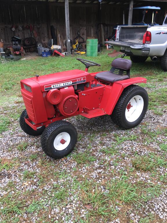

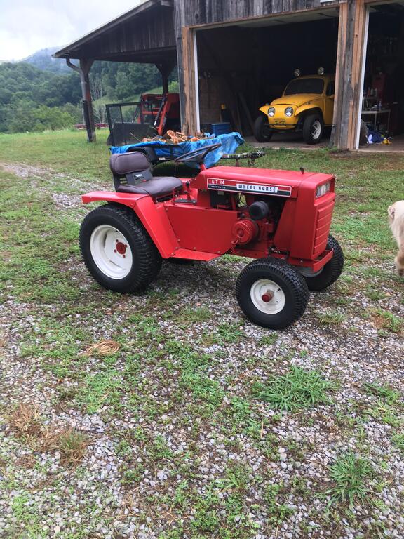

sqrlgtr 466 #9 Posted June 11 1 hour ago, gwest_ca said: It was the last 2 models in 1972-73 that had battery ignition using K321S-60149A engines. Previous models had breakerless magneto ignition using K321S-60125B engines. I was thinking it was other way around but your probably right. You have me curious know will try and look at model number on my gt14 next time Im at shop.Will also try and get pic of switch... I could of swore mine was a 69 but may have looked at it wrong. Here is the only pics I have on phone at the moment... 1 2 Share this post Link to post Share on other sites

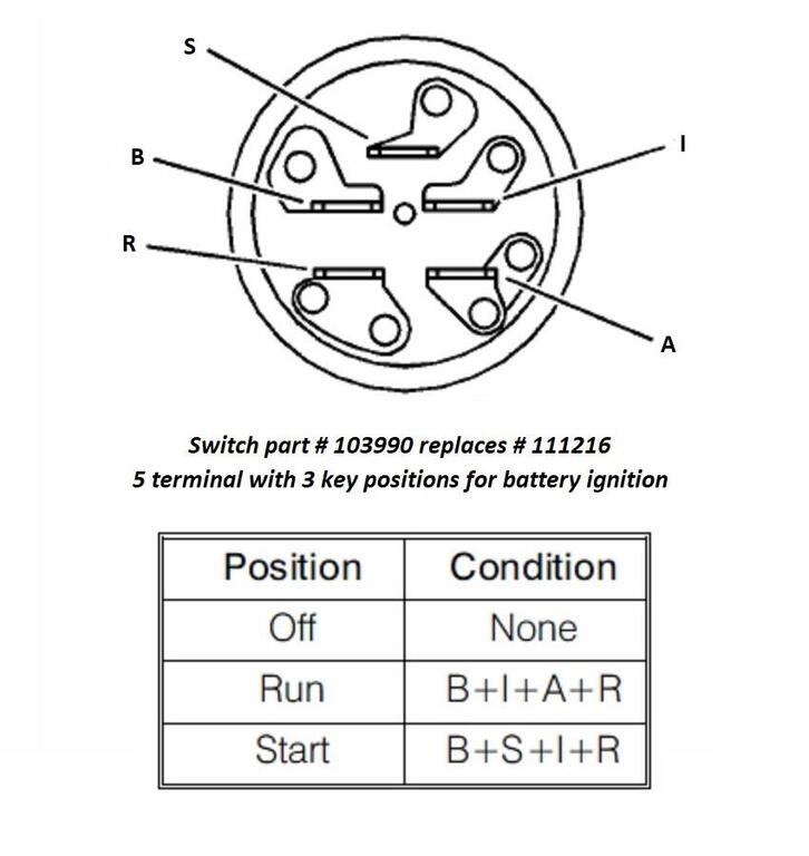

953 nut 53,596 #10 Posted June 11 10 hours ago, sqrlgtr said: This makes the third switch I've run into with this problem. Sounds to me like you are using the wrong switch or the wiring to them is wrong.. The likelihood of having three defective switches bought at seper4ate times with the same defect is rather low. You probably have the "A" terminal of the ignition switch connected to your coil. Typically a battery ignition system switch will drop out the "A" (accessory) terminal during Start but will connect it during Run. 2 1 Share this post Link to post Share on other sites
sqrlgtr 466 #11 Posted June 12 1 hour ago, 953 nut said: Sounds to me like you are using the wrong switch or the wiring to them is wrong.. The likelihood of having three defective switches bought at seper4ate times with the same defect is rather low. You probably have the "A" terminal of the ignition switch connected to your coil. Typically a battery ignition system switch will drop out the "A" (accessory) terminal during Start but will connect it during Run. The ones I've had trouble with were already on the tractors when I brought them home and I just went ahead and swapped them out when I ran into the trouble but I hadnt thought about the acc dropping out during cranking that may have been what was going on.... Should have been more clear this has been over a period of years and not like three in a row being bad...sorry for any confusion. Actually I haven't swapped the gt14 switch out and its been like that for few years know.. 1 Share this post Link to post Share on other sites
