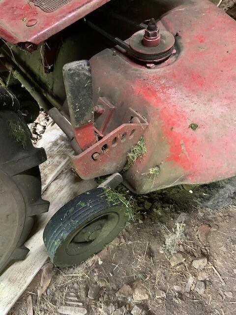

John2189 558 #1 Posted June 8, 2024 I’ve had this tractor for a couple years but never really used it. My main mower is having problems so I used the 165 to mow the back yard. The adjuster is in the highest hole, but it still cuts way too short. I used the lift handle, but that is too high. Is there any other adjustments? Its a side discharge mower 2 Share this post Link to post Share on other sites
ebinmaine 76,122 #2 Posted June 8, 2024 Perhaps the deck isn't being lifted enough by the main mechanism. Do the rubber pieces on top of the deck touch the bottom of the tractor foot boards at full "up" position? Share this post Link to post Share on other sites
