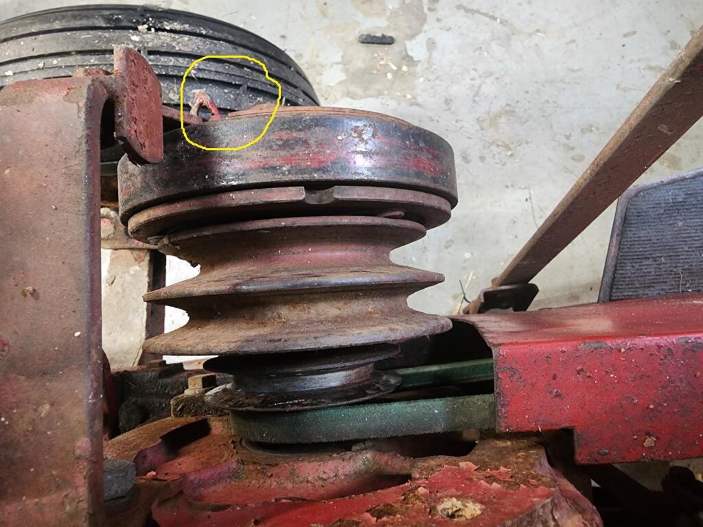

Ed Kennell 46,477 #26 Posted June 7, 2024 (edited) Could be the camera angle, buy that inner hyd pump belt looks too wide for the pulley. Should be 3/8x48. BTW, I was mistakenly looking at the 1045 manual where I saw the 70" drive belt. The 1054 and 953 manual lists the 82" belt. Looking at this pic again, that belt looks fairly new. I'm wondering if the PO tried to install a new 1/2x82" transmission belt and had trouble getting it on the larger pulley and just put it on the smaller inner hyd pump pulley. Edited June 7, 2024 by Ed Kennell 1 Share this post Link to post Share on other sites

squonk 47,286 #28 Posted June 7, 2024 All kinds of WT's goin on. 953/1054 didn't come with an electric PTO either. 1 Share this post Link to post Share on other sites

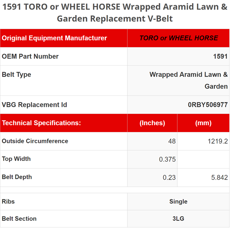

Dave E 37 #30 Posted June 7, 2024 Another place to get the Hydraulic which is indeed (.375") 3/8" x 48" : https://www.vbeltguys.com/products/1591-toro-or-wheel-horse-fhp-replacement-v-belt 1 Share this post Link to post Share on other sites
squonk 47,286 #31 Posted June 7, 2024 (edited) That big honkin pulley on the end with the wire hanging out (yellow circle.) Electric clutch PTO Should look like this: Edited June 7, 2024 by squonk Share this post Link to post Share on other sites

Ed Kennell 46,477 #33 Posted June 7, 2024 9 minutes ago, Dave E said: Ok, I have no idea... anyone else? No idea why anyone would change the PTO to electric.. The instant on engagement is not good for the equipment and the wires are usually broken off too short to repair. IMO, the original PTO system shown on Mikes 953 pic was the best ever. No safety switches, easy to set the gap and pressure on the plate, and nothing to wear out. 3 Share this post Link to post Share on other sites
Dave E 37 #34 Posted June 7, 2024 9 minutes ago, Ed Kennell said: No idea why anyone would change the PTO to electric.. The instant on engagement is not good for the equipment and the wires are usually broken off too short to repair. IMO, the original PTO system shown on Mikes 953 pic was the best ever. No safety switches, easy to set the gap and pressure on the plate, and nothing to wear out. Ok, so I guess I am on the hunt for an original PTO, are the forum here and eBay the best places? I want simple and it looks like this is already a problem with the broken off wires... Share this post Link to post Share on other sites
