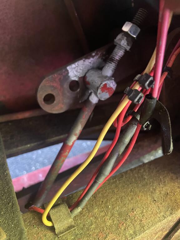

Canoetom85 21 #1 Posted June 3, 2024 Hi there, anyone have any diagrams on how best to hook up the plow same to the lift assembly? I found one online for a chain style but I have a rod. I got it work currently but just want to know if it’s correct? any help is greatly appreciated!! Tom Share this post Link to post Share on other sites
ebinmaine 77,564 #2 Posted June 3, 2024 6 minutes ago, Canoetom85 said: have a rod What's the length on that? Share this post Link to post Share on other sites
OutdoorEnvy 1,807 #3 Posted June 3, 2024 If it lifts it around 5" or more off the ground and lowers to the ground you should be fine. There's usually some wiggle room for adjustment but that's the general idea of what you are going for. 1 Share this post Link to post Share on other sites
Canoetom85 21 #4 Posted June 3, 2024 This is the rod I have Share this post Link to post Share on other sites
ebinmaine 77,564 #5 Posted June 3, 2024 Click on the link above and see if the pictures tell you what you're looking for. Kind of an exploded diagram of course.... Share this post Link to post Share on other sites
Handy Don 16,024 #6 Posted June 4, 2024 5 hours ago, Canoetom85 said: This is the rod I have That looks similar to the lift rod for the 60’s RM geared mower decks. The solid plow links I’ve seen were flat bars with clevis pins at the ends. I’m also a bit concerned about the angle it’s at (I’d expect it to be more vertical). Can you get a picture from the side that shows the plow frame and the lift attach point? Someone with more plow experience will chime in. 1 Share this post Link to post Share on other sites
