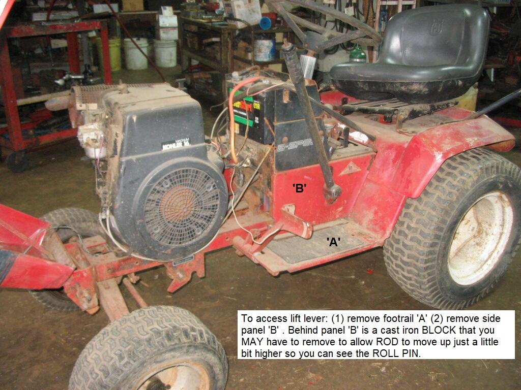

tallen4392 71 #26 Posted June 13, 2024 Thank you so much for all the info i will give it a shot this weekend again i might take you up on a pm phone number don’t really know what’s going on my sun got the lever to just go under his deck while cutting the grass ever since the button is jammed will not move at all freak mishap for that to happen thanks again i keep my fingers crossed it works out Share this post Link to post Share on other sites
tallen4392 71 #27 Posted June 14, 2024 how do you push the rod up so u can get at the roll pin it does not come out of the slot at the bottom so u can turn it and force it up Share this post Link to post Share on other sites

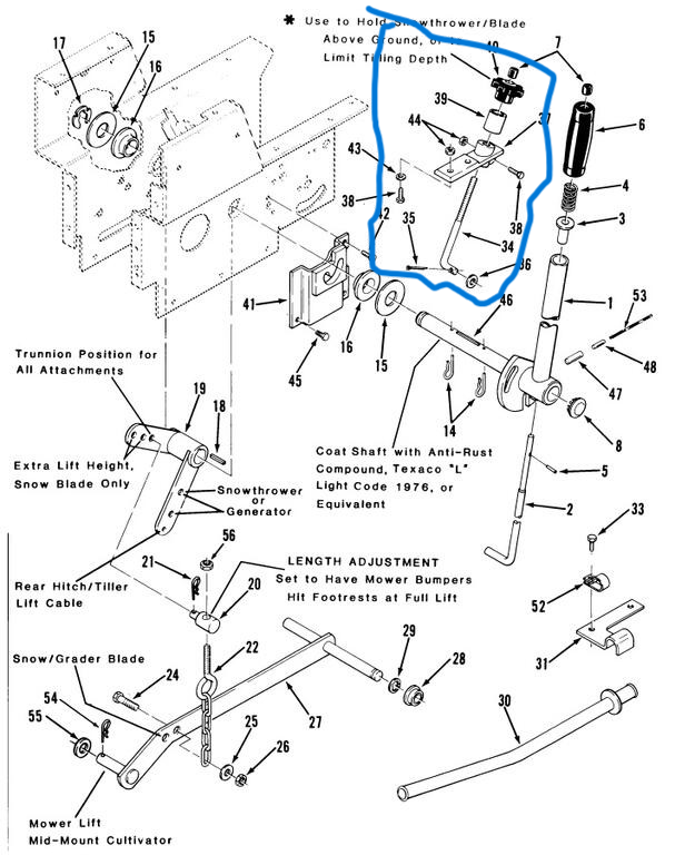

daveoman1966 3,884 #28 Posted June 14, 2024 If you can't see the ROLL PIN from the top to drive it out or cut it off flush, take off another side panel 'B' in this pic. Behind it there s/b a cast iron part (#41 in schematic) bolted to the hoodstand...that the rod 'locks' into. It MAY be preventing you from seeing the top of the rod... Share this post Link to post Share on other sites
tallen4392 71 #29 Posted June 14, 2024 i have the floorboard and side panel off i think i can get it apart and see what’s going on in there if i could get the bent rod to go up a little bit but it only goes so far when it is in that slot Share this post Link to post Share on other sites

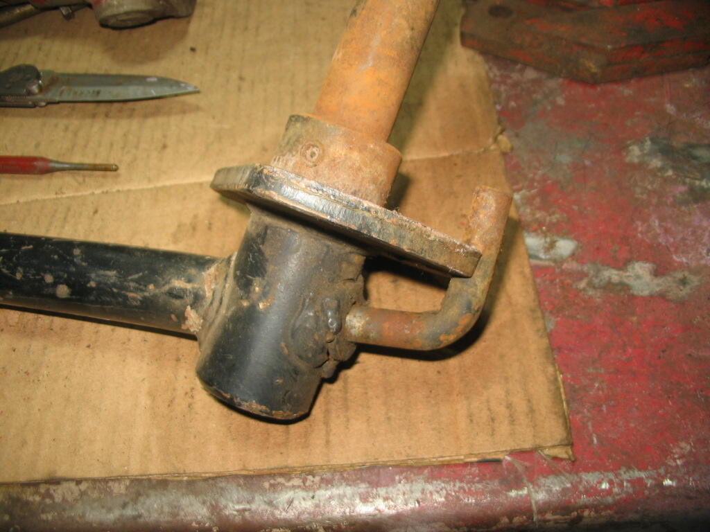

daveoman1966 3,884 #30 Posted June 14, 2024 I looked closer at the SHIFT LEVER assy in my shop. With the ROD up as high as it will go while in the tube--- I can easily see the ROLL PIN. Share this post Link to post Share on other sites
tallen4392 71 #31 Posted June 14, 2024 i am going to mess with it sunday the first pic i sent that it is with the rod all the way up but it is still in the slot on the bottom won’t go any more unless i can get it out of that slot then it would be easy Share this post Link to post Share on other sites

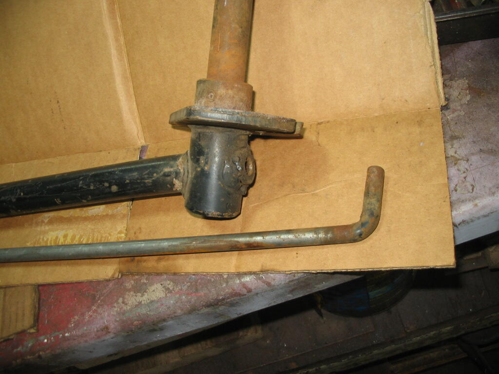

tallen4392 71 #32 Posted June 16, 2024 Hi Dave when can u ship parts 2 3 4 and 5 are those all used parts ?? Share this post Link to post Share on other sites
daveoman1966 3,884 #33 Posted June 17, 2024 I can ship parts the day after receipt of payment. The parts 2,3,4, & 5 are used...but not abused. Make payment of $35 to me in Paypal as "Send Money to a Friend". My Paypal account name is: daveoman@windstream.net When I see that payment in my account, I'll box and prep the parts to ship. Be sure to include your FULL NAME and address for me. Share this post Link to post Share on other sites

tallen4392 71 #35 Posted June 26, 2024 Hey Dave do you have part #34 adj rod i need that part ?? Share this post Link to post Share on other sites
daveoman1966 3,884 #36 Posted June 26, 2024 I have the adjuster rod but not the KNOB #40 for it. .....but does your tractor have the height adjuster block #37 and stuff circled in BLUE?. That rod---NEW--- is $47.99. I can put it in your mailbox for just $25...shipped. Share this post Link to post Share on other sites
