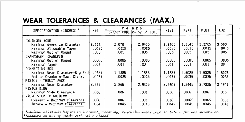

Chevy_59 18 #1 Posted May 28, 2024 I've got a 702 that has been in the family since the eighties when we got it from the neighbor who bought it new. My dad had the engine rebuilt sometime in the late eighties when it was fogging the neighborhood while I mowed. It sat for quite a few years until I dug it out and got it running again in '21 for my boys. Last week they were driving it around it started making "weird" noises so they shut it down and came and got me. We started it up and it sounded like it was severely knocking so we pulled it in the garage and this weekend we started tearing it down. It's been a leaker since we got it running again and I blamed myself for not double checking that they were checking the oil as it was low. After we got it off the tractor and removed the tin we went to remove the flywheel and found the nut was loose and the flywheel was wobbly. Wonder what the chances are that was our death noise and not the rod? It needs to come apart for a reseal anyway so we tore it down and inspected everything and checked clearances, that's where my question lies. The piston is marked .020 and the rod and crank measure out at -.010. The crank and rod look fine, no scoring or noticeable wear and when I measured them they come in at .034 clearance. The sources I have found don't agree with whether that is acceptable. The kohler manual I found says max is .035 but the garden tractor pulling tips website kohler section says .025. The bore looks decent, still has a good amount of crosshatch visible and the tractor didn't smoke or foul plugs, so think the rings were fine. I'm wondering if it would seem foolish to re-gasket it and see if the flywheel was our death noise or if I should at least replace the rod? I'm hoping to get it back together as quick as we can, since we're hoping to get to the big show this year with it. (great timing, huh?) So I guess I'm mainly wondering what would you guys do in this situation? Thanks for reading and sorry so long. Share this post Link to post Share on other sites

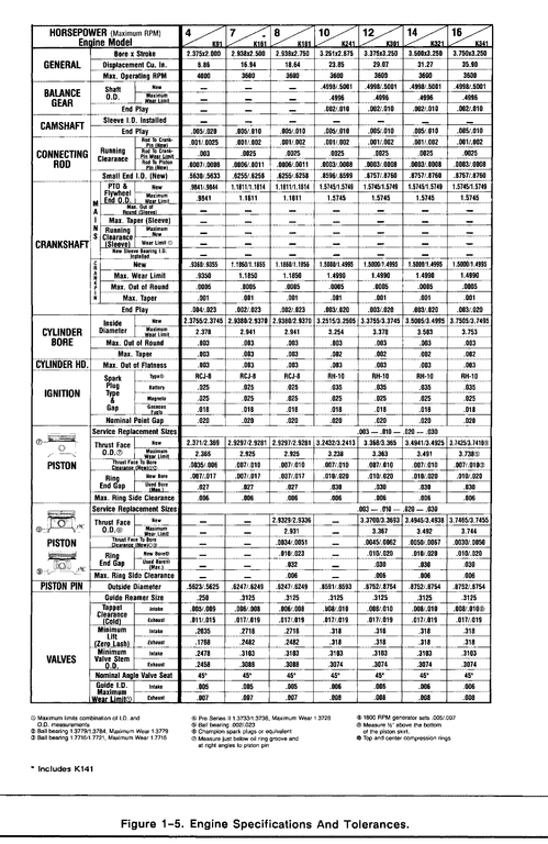

oliver2-44 11,057 #2 Posted May 29, 2024 3 hours ago, Chevy_59 said: The crank and rod look fine, no scoring or noticeable wear and when I measured them they come in at .034 clearance. The sources I have found don't agree with whether that is acceptable. The kohler manual I found says max is .035 but the garden tractor pulling tips website kohler section says .025. The I suspecct you left a .0 of when you typed .034 as your measurement. If that were correct it would knock very badly This chart in my copy of the Kohler manual shows rod to crank pin max wear limit at 0.0025. 3 Share this post Link to post Share on other sites

Chevy_59 18 #12 Posted May 29, 2024 1 hour ago, WHX?? said: Other ? Is Chev is does the piston show signs of oil washing? If not check the rod big end and if it passes new rings and chalk the noise up to the loose flywheel. You could go against the manual & use the old rings. Guys claimed they have with no issues. Personal decision I guess. I don't think the piston or cylinder look too bad and like I said it wasn't smoking or fouling plugs. As far as the rod, like i said it looks fine and the crank looks great just was wondering about clearance. The older kohler manual i downloaded says .0035 max and the newer one that was referenced above says .0025 and I'm coming in at .0034. I'm just trying to decide about doing a close inspection on the flywheel and resealing the engine or if I should at least throw a new rod in it. I would rather hold off on a full rebuild with machine work until this winter so we can enjoy the tractor this summer. 1 Share this post Link to post Share on other sites

oliver2-44 11,057 #14 Posted May 29, 2024 1 hour ago, Chevy_59 said: I don't think the piston or cylinder look too bad and like I said it wasn't smoking or fouling plugs. As far as the rod, like i said it looks fine and the crank looks great just was wondering about clearance. The older kohler manual i downloaded says .0035 max and the newer one that was referenced above says .0025 and I'm coming in at .0034. I'm just trying to decide about doing a close inspection on the flywheel and resealing the engine or if I should at least throw a new rod in it. I would rather hold off on a full rebuild with machine work until this winter so we can enjoy the tractor this summer. Based on the numbers your 0.034 is at the edge of the old kohler 0.0035 and 50% More out on the new kohler 0.0025 specs. So, where do your measurements point to the wear being? Crank big end , rod or both. By my way of thinking, if your going to mow with it all summer, if a new rod will reduce your clearance .001, it would be good insurance so an not to ventilate the block and have nothing usable left. Share this post Link to post Share on other sites

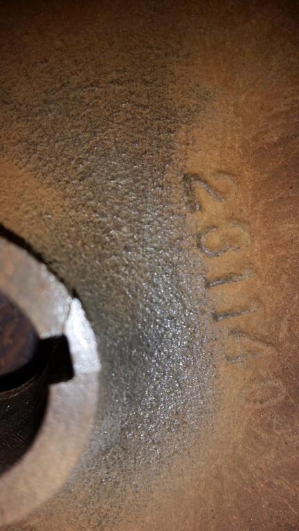

WHX?? 53,305 #16 Posted May 30, 2024 3 hours ago, Chevy_59 said: big find right now is the flywheel is cracked by the keyway on the inside Crap I hope I didn't jinx ya. I got lucky and found one on fleabay for 80 clams shipped. Seller said it was off a JD ... Correct Kohler PN is on my pic. I think you would be OK with that rod. Share this post Link to post Share on other sites
Chevy_59 18 #17 Posted May 30, 2024 1 hour ago, WHX?? said: Crap I hope I didn't jinx ya. I got lucky and found one on fleabay for 80 clams shipped. Seller said it was off a JD ... Correct Kohler PN is on my pic. I think you would be OK with that rod. You didn't jinx me. I'm just a little upset with myself for not looking closely at it when removing it. I guess I was more interested in showing my boys how to disassemble the engine and thinking it was going to be the rod when I should have been thinking about why the flywheel nut would be loose. 1 Share this post Link to post Share on other sites
