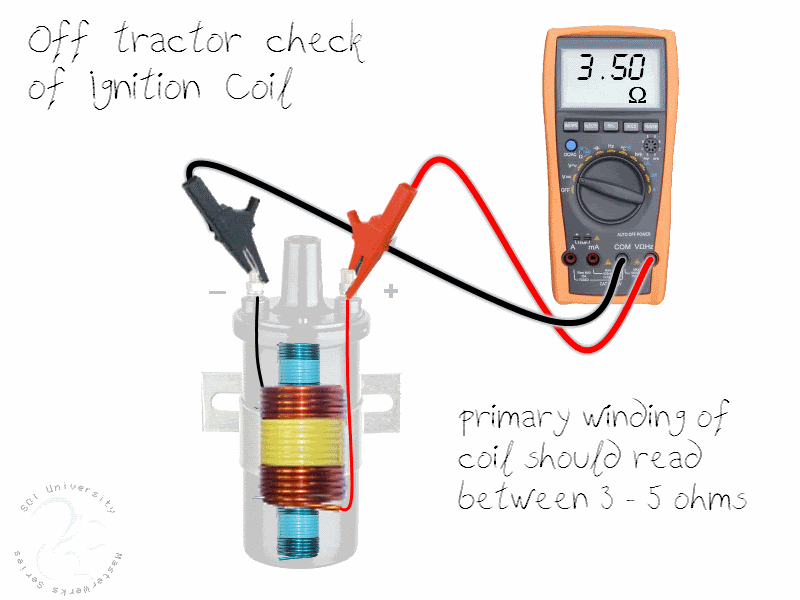

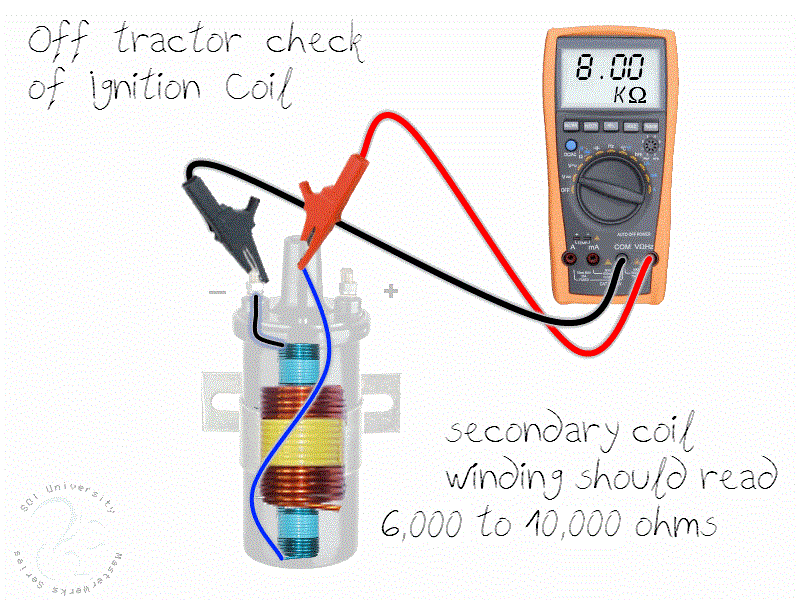

953 nut 64,638 #6 Posted May 27, 2024 Here are a couple of drawings from @Save Old Iron that will help you check those coils. 3 Share this post Link to post Share on other sites
wallfish 19,498 #7 Posted May 27, 2024 1 hour ago, 953 nut said: Here are a couple of drawings from @Save Old Iron that will help you check those coils. Miss SOI as he always had solid, practical and non-complicated advice on all electrical stuff. I don't care if he didn't have any tractors. 2 1 Share this post Link to post Share on other sites
