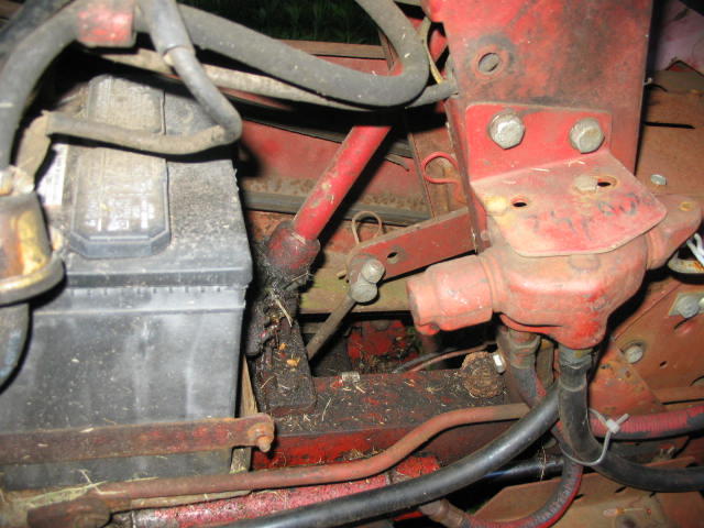

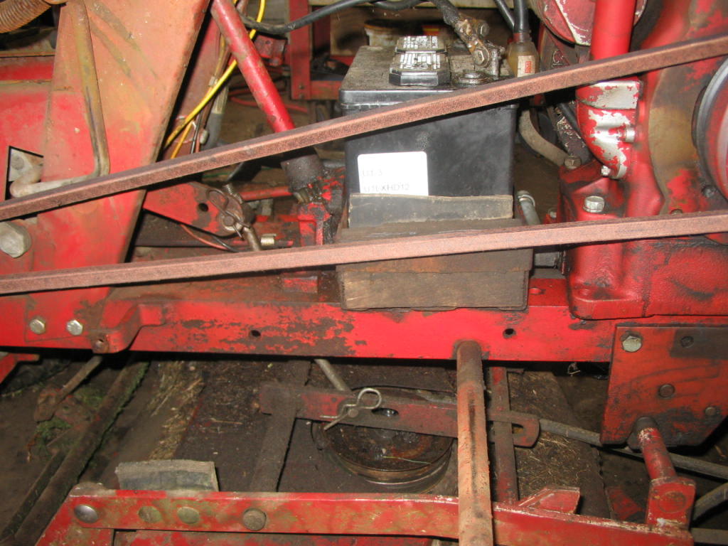

daveoman1966 3,882 #3 Posted May 24, 2024 (edited) My Bronco 14 does NOT have the long lift bar you refer to....NOT like a C-120 or C-160. Instead, it uses a 10" - 12" TRUNION on a lift ROD hanging down from a BELL CRANK. You can't see it too well in this pic, but I do have another I could put in the mail to you. Edited May 24, 2024 by daveoman1966 2 Share this post Link to post Share on other sites
siebenaler 114 #4 Posted May 24, 2024 48 minutes ago, daveoman1966 said: My Bronco 14 does NOT have the long lift bar you refer to....NOT like a C-120 or C-160. Instead, it uses a 10" - 12" TRUNION on a lift ROD hanging down from a BELL CRANK. You can't see it too well in this pic, but I do have another I could put in the mail to you. Ok I get it I can come up with something I think Share this post Link to post Share on other sites
