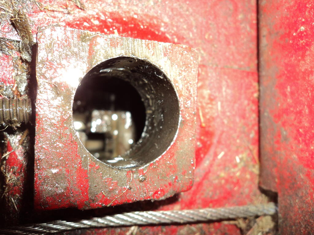

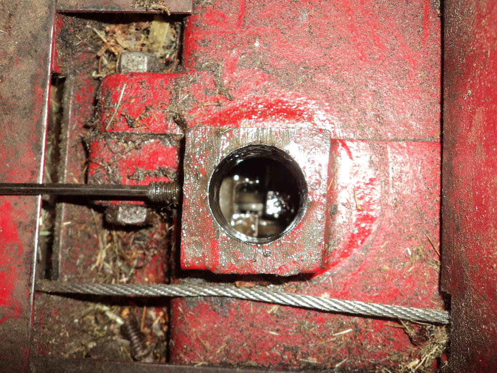

Bach-Ed 170 #3 Posted May 24, 2024 Well, I pulled the set screw and was able to slide the gears (2nd & 3rd) back and forth. So, I reinstalled the shifter. Now I can shift right and left. But not front to rear to get to 1st and rev. Is that set screw setting super fussy or ?????? Share this post Link to post Share on other sites
stevasaurus 23,619 #4 Posted May 24, 2024 Pull the shifter again and see if you can move the other fork from side to side...the fork for 1st and reverse. Make sure that both forks are in neutral when you put the shifter back in. Use a long screwdriver to move the forks between neutral and all of the gears, You could jack up the back end and move the forks between all gears and check out the gear box that way while running thee horse. Let us know what you find 1 Share this post Link to post Share on other sites
953 nut 64,259 #5 Posted May 24, 2024 4 hours ago, Bach-Ed said: Is that set screw setting super fussy Tighten the dogpoint until the shifter is hard to move (donut pinched in opening) then back it off slightly where the shifter well move smoothly but no play. 1 Share this post Link to post Share on other sites

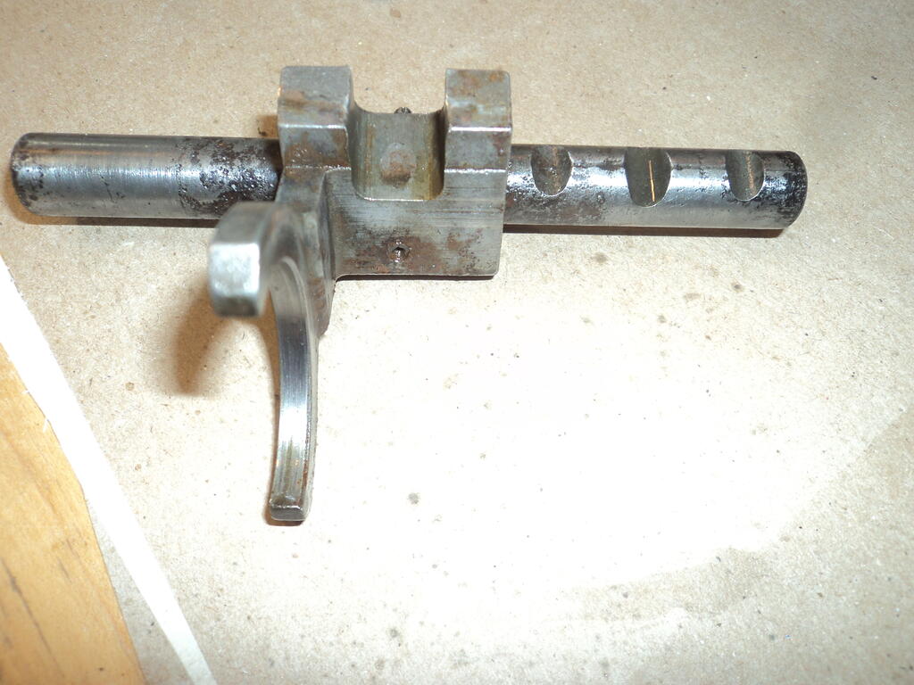

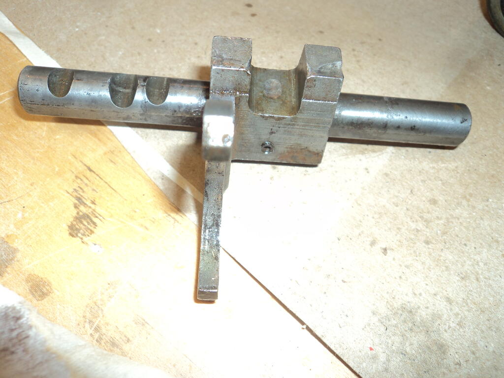

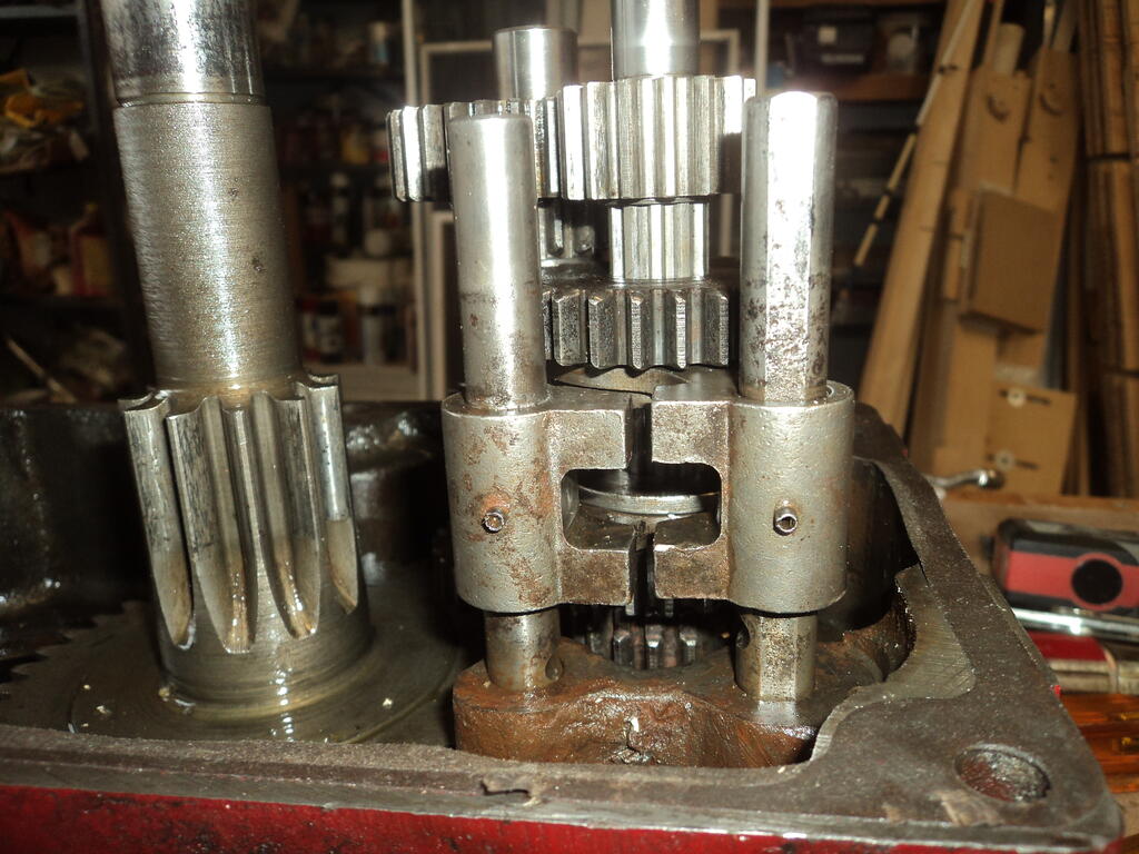

stevasaurus 23,619 #7 Posted May 25, 2024 (edited) The front fork is your 1st and reverse and (in the picture) that fork is in neutral. The rear fork is in gear, but I can't tell which one. You are saying you can't move that rear fork?? When your trans is in neutral, those forks will look like the picture in Post #2. If you can't move that rear fork, I think you will have to drop and split the trans. With a #5053 trans, you should not be able to shift the 1st/reverse fork when either 2nd or 3rd is in gear. The 2nd/3rd fork has to be in neutral before you can shift into either 1st or reverse. The new style shift rails along with the longer stop prevents being in 2 gears and the same time. That being said, there is not much it can be...a roll pin holding the fork to the shift rail or some wrong with the detent system (broken spring, missing detent ball, broken stop). I'm sure your trans is fixable for not much money. I am in Elgin if by chance you need a good 3 speed trans that will bolt right in. I have a couple of spares. Take good pictures. Edited May 25, 2024 by stevasaurus 1 Share this post Link to post Share on other sites

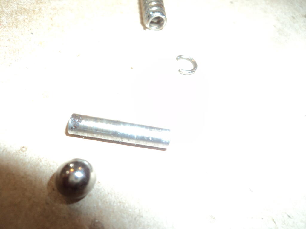

Bach-Ed 170 #10 Posted July 4, 2024 Well, I finally got the transmission opened. I didn't see much wrong but after some digging, I found i was missing a shift ball. Of course I might have lost it during disassembly? But I ran a magnet down the hole and came up with this curl of metal. It appears to be off the end of the spring. Now I wonder if that piece of broken spring jambed the shifter fork? As we all like pictures I added the pictures of forks but they seem ok. Share this post Link to post Share on other sites
squonk 45,590 #11 Posted July 4, 2024 How long have you owned this tractor? Sounds like someone was in it before and lost a ball. They don't disappear all by themselves. The balls not only lock into the fork detents but keep the spring out of harms way. You may need to get a complete transmission just to get the right spring. Share this post Link to post Share on other sites
Bach-Ed 170 #12 Posted July 4, 2024 I've had it over 10 years. A new tranny to get a spring sounds like a lot but you guys have more experience than I. I was going to try McMaster for springs. Share this post Link to post Share on other sites
stevasaurus 23,619 #13 Posted July 4, 2024 (edited) If you have both detent balls...great. If not, they are 1/4" steel balls and are available at ACE hardware. While there, see if they have a spring that will work. I once had one of those springs that got bent on the end. I was able to bend it straight and pulled it apart a bit (stretched). It is still working great. See if a spring from a fountain pen will work ?? I would not doubt that someone here has one of those springs that they would send you. Edited July 4, 2024 by stevasaurus 1 Share this post Link to post Share on other sites
squonk 45,590 #14 Posted July 4, 2024 You can probably get a spring from McMaster. The key is the tension. Too weak and it may not hold in gear. Too stiff and it will be hard to shift. Measure the wire diameter carefully. You can probably get one in the ball park. check everything else inside the trans before you button it up. Those bearings have been in there a long time. 1 Share this post Link to post Share on other sites

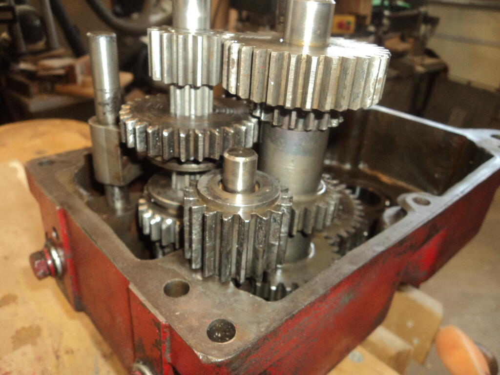

Bach-Ed 170 #15 Posted July 6, 2024 Well, the fun continues. Here are some pictures. The first three are with it in neutral, does it look like I have all the gears in the right places? 1 Share this post Link to post Share on other sites
stevasaurus 23,619 #16 Posted July 6, 2024 That is how it is supposed to look. Well done !!! You should be able to shift the gears and turn the input shaft by hand...watch the axles turn. Did you find a detend spring ?? Share this post Link to post Share on other sites
