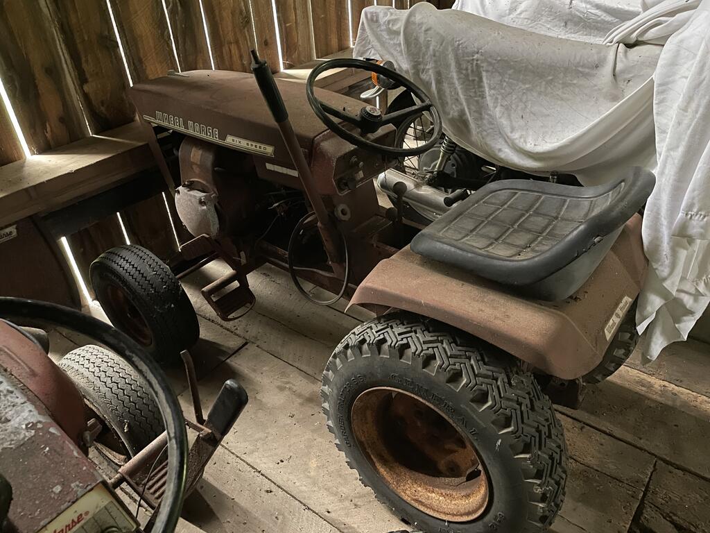

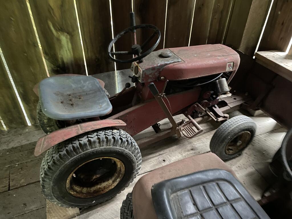

Mister_520H 58 #81 Posted May 28, 2024 Mike, I’m interested. I’ll send you a pm. Thanks So I inherited my granddad’s horse and a “parts tractor” from my old man a few years ago. They’re in the queue but dang the queue is long. Anyone know much about these units? First photo is my grandpas wheel horse, second parts. He bought it new back in the 50’s I believe. Used it in the yard on the family farm down in Enon Valley. 1 Share this post Link to post Share on other sites
Handy Don 17,735 #82 Posted May 28, 2024 (edited) 42 minutes ago, Mister_520H said: This one is most probably a 1963 or 1964. Round hood with the dashboard integrated with the fuel tank and the two-spoke steering wheel. The belt guard would normally have an indented rectangle with a decal of the model (603, 653, or 854 for example based on horsepower, engine manufacturer, recoil or electric start, and model year) so it may be off an earlier ’61 or ’62. 42 minutes ago, Mister_520H said: This one is 1970 plus or minus a year or two. The Six Speed was the start of the high/low range in the 1-2-3-R gearbox, so six forward speeds. These were also 10-pinion and Limited Slip differentials. These are in remarkably good condition with what appear to be original tires and paint. Lucky you! Edited May 28, 2024 by Handy Don Share this post Link to post Share on other sites

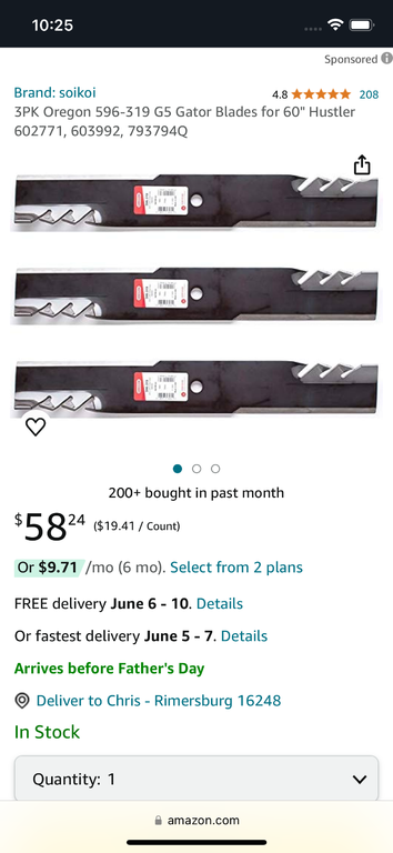

Mister_520H 58 #85 Posted May 31, 2024 I’m looking to improve the performance of my 60” deck and would love some blade specific feedback. I’m currently running standard blades that I sharpen regularly but I’ve read good reviews on some of the more modern designs that apparently produce better mulching results etc. Has anyone used these and if so, good experiences? If not, is there another design offered amongst guys running the big deck? Thanks! Share this post Link to post Share on other sites
