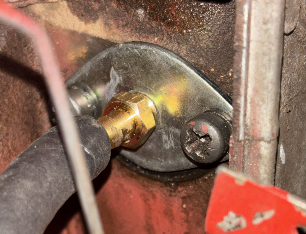

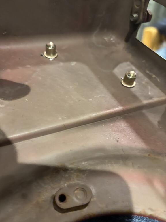

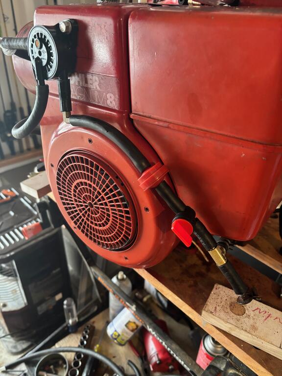

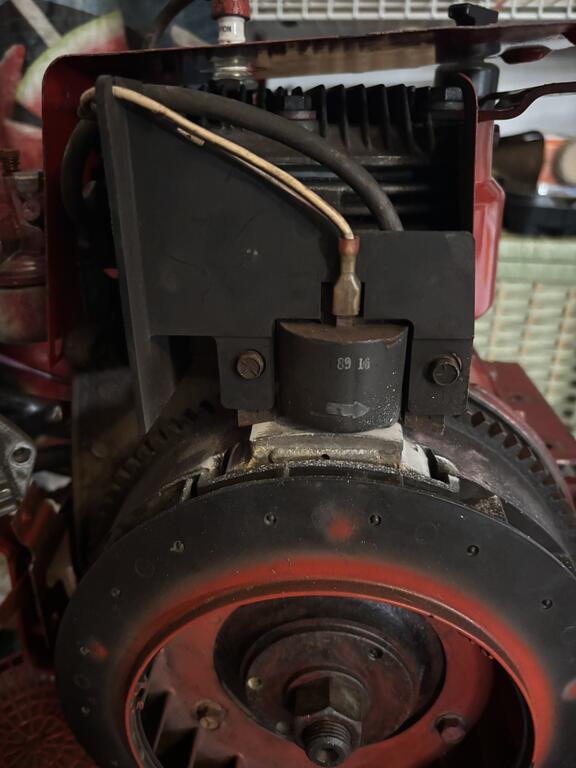

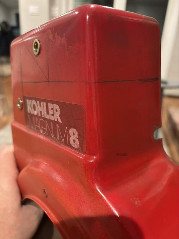

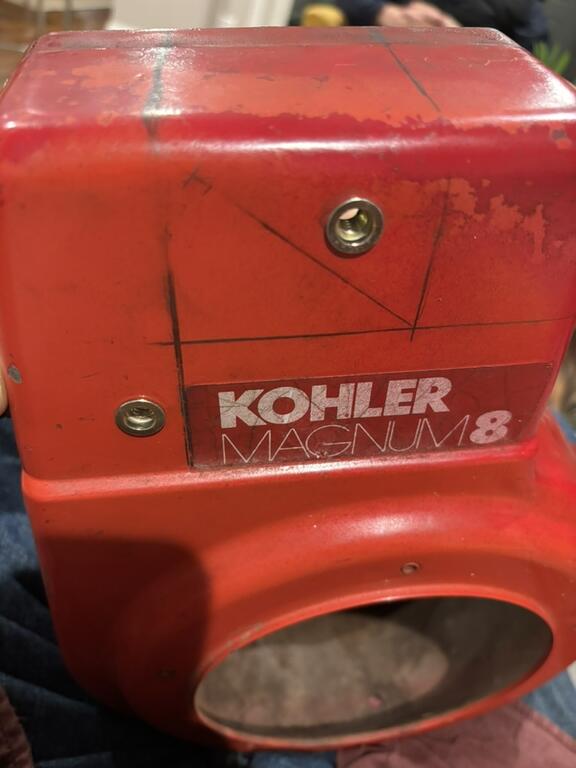

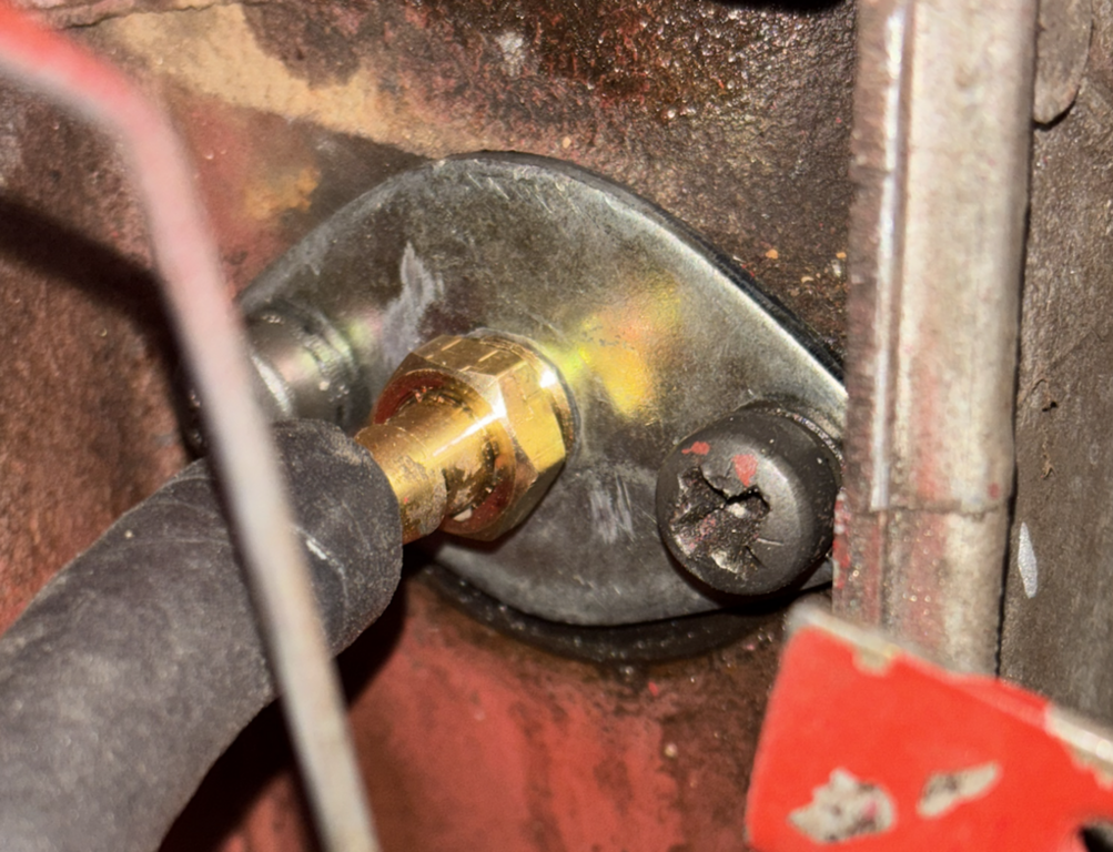

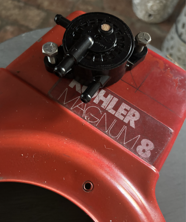

njdpo 10 #40 Posted December 8, 2024 (edited) hi all, been a while since ive had time to work on the M8... Ive been having problems with the fuel pump - while I rebuilt the mechanical pump it just wasn't pumping properly Ive had this problem before where new clone pump(s) off the internet didnt work out well for me either. ( I sometimes wonder if the cam that the pump arm rides on is worn excessively ? ) I have had good luck with those black plastic Mikuni vacuum pumps - I pulled the trigger and bought one for the M8. Followed by removing the mechanical pump, and replacing it with a blocking plate and a barbed vacuum tap off the block. For my next trick I needed to find a good location for the pump and I decided I would mount it to the blower shroud. 1/4-20 bolts are the perfect size for the vacuum fuel pump - so i used 1/4-20 rivit nuts to attach the pump to the shroud. I took my time to find a good location for that pump on the shroud - because the magneto assembly and plastic housing sit directly behind the area where I want to mount the pump. the attached pics show pencil marks on the shroud which represent the location of that plastic framework behind the shroud. Once I had the shroud marked up I drilled .350 diameter holes and wobbled the drill bit a little just enough for the rivets to fit very tightly into the holes. those rivets work very nicely. Edited December 8, 2024 by njdpo Share this post Link to post Share on other sites
Moparfanforever 940 #41 Posted December 12, 2024 Very nice job!! Share this post Link to post Share on other sites

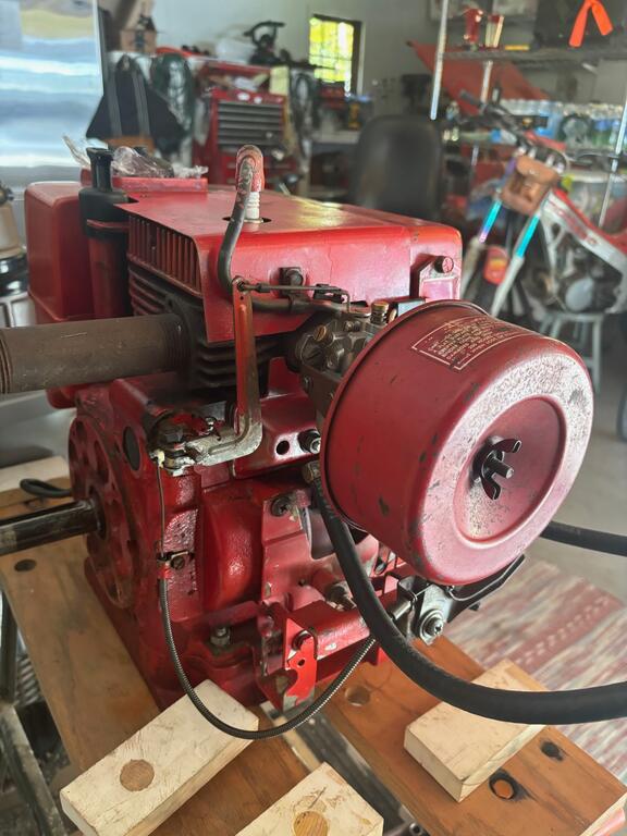

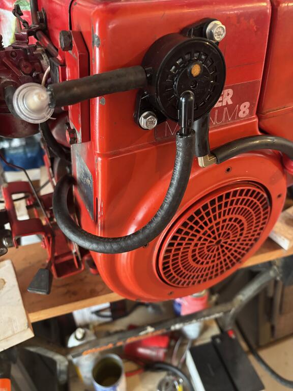

njdpo 10 #42 Posted January 1, 2025 heres a few more pics of the fuel line setup Notes: 2 fuel filters (those little clear 90 degree filters come in handy. original shutoff valve doest work - Im using the plastic shutoff valve near the red fuel filter, ( i might reverse their locations). The brass " T " fitting in front of the fuel filter allows me to drain the tank (remove water & winterizing). the starter motor was reinstalled. At this point I need to Share this post Link to post Share on other sites
