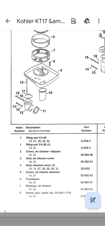

rmaynard 17,612 #2 Posted May 19, 2024 I think this is what you are looking for. Share this post Link to post Share on other sites
Sodaking27 1,358 #3 Posted May 19, 2024 10 minutes ago, rmaynard said: I think this is what you are looking for. Bob, Mine has the round chrome air cleaner with the snout on it. Not the squared one like above. Share this post Link to post Share on other sites

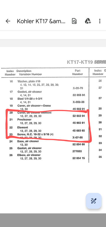

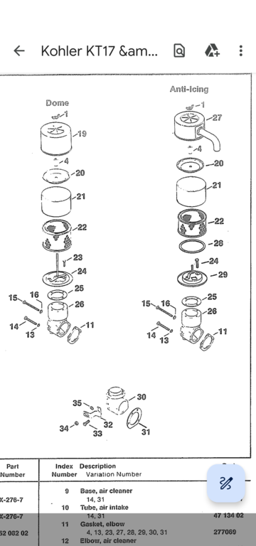

rmaynard 17,612 #4 Posted May 19, 2024 (edited) Edited May 19, 2024 by rmaynard Share this post Link to post Share on other sites

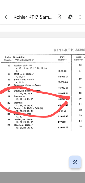

Sodaking27 1,358 #5 Posted May 19, 2024 Bob. That’s what I’m looking for. Just to verify #21 & 22 is 45 083 . The red line is covering some of it. Thanks Share this post Link to post Share on other sites
rmaynard 17,612 #6 Posted May 20, 2024 Sorry about that. Share this post Link to post Share on other sites
