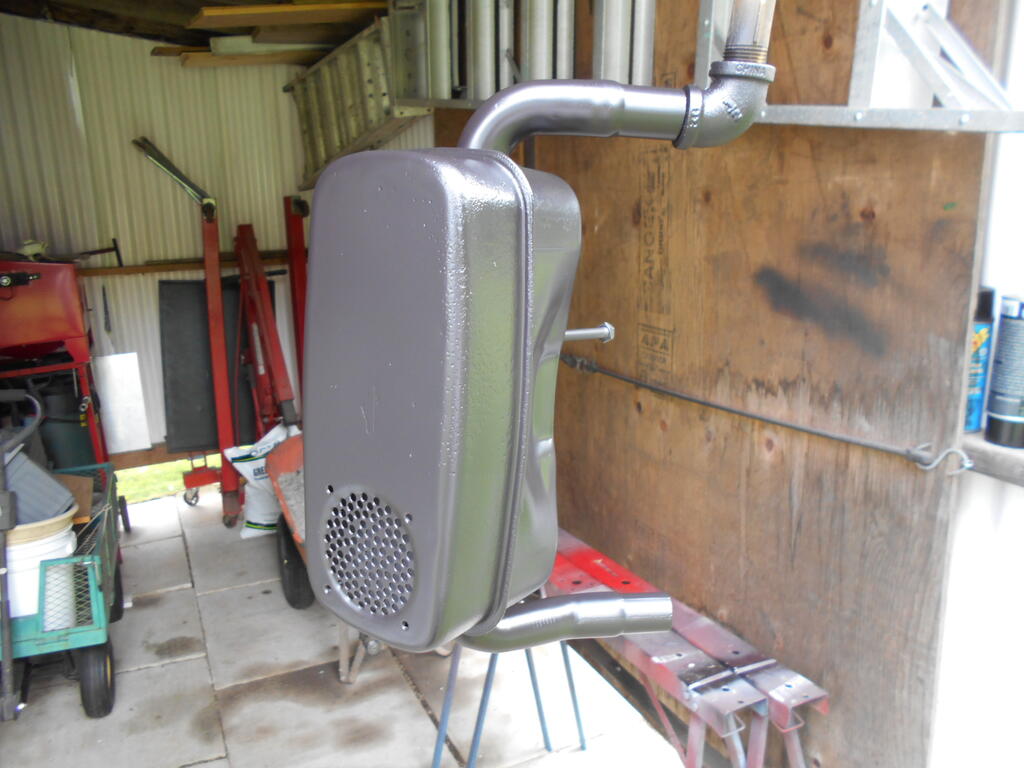

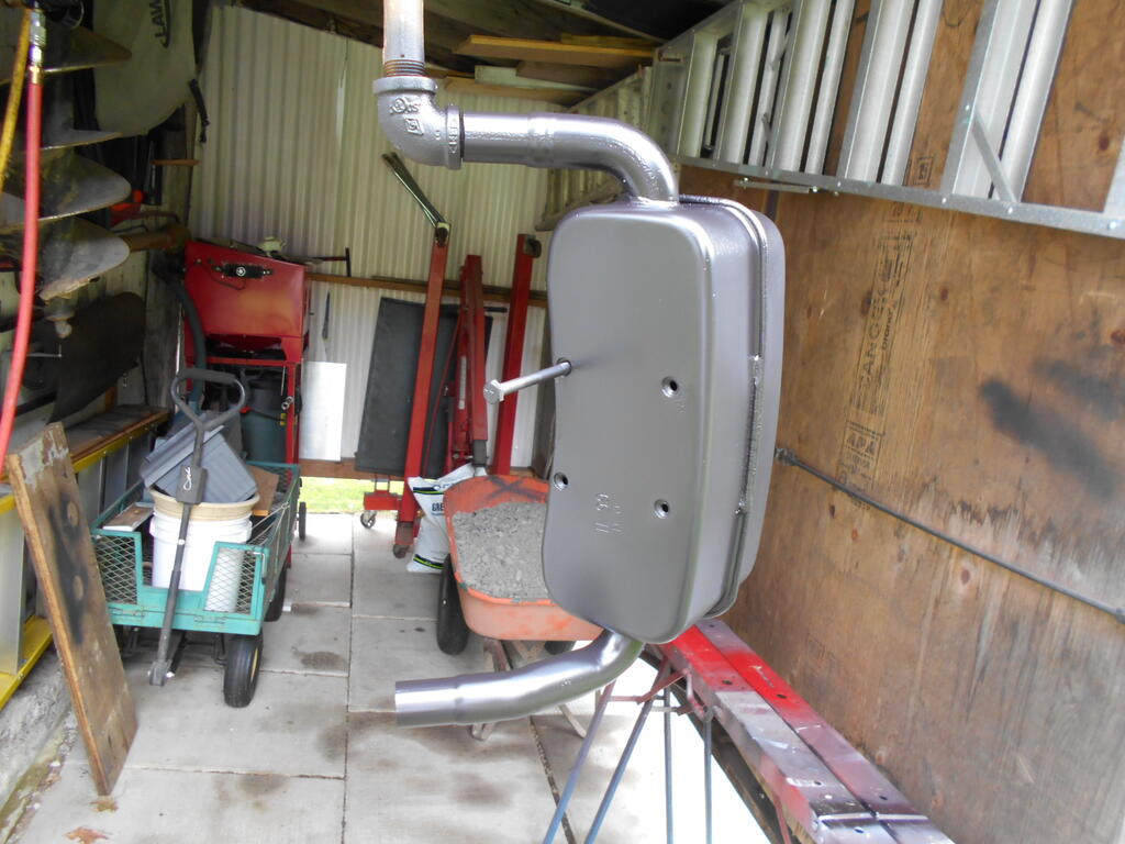

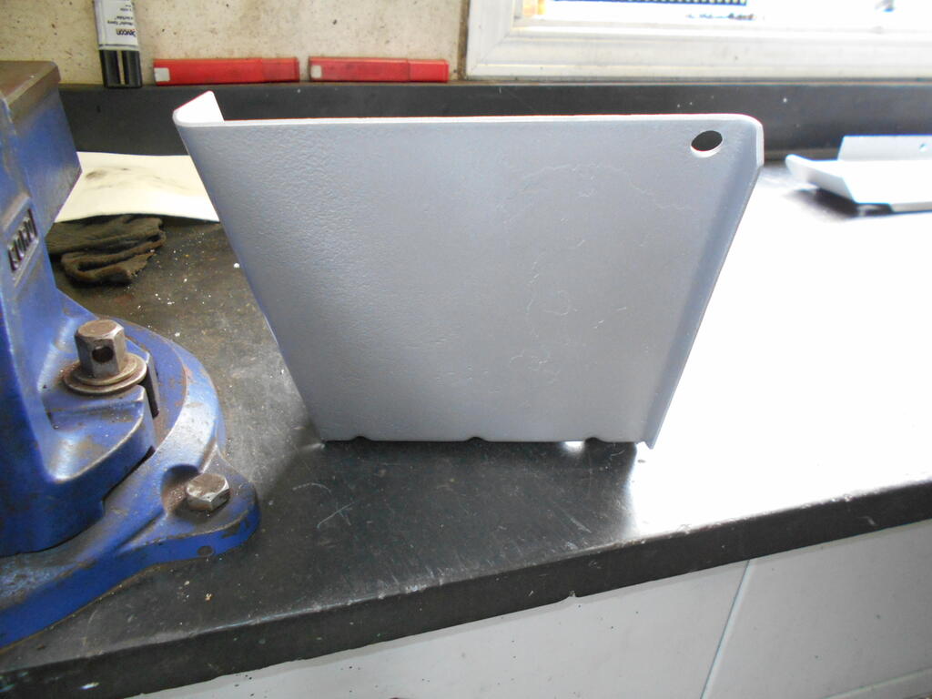

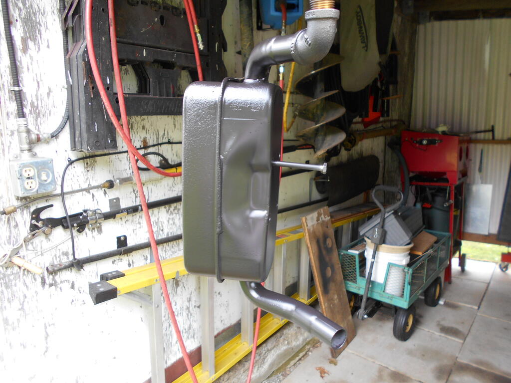

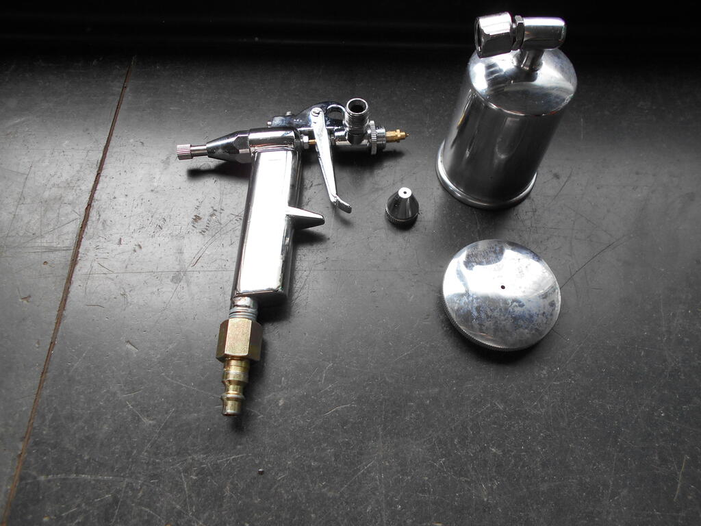

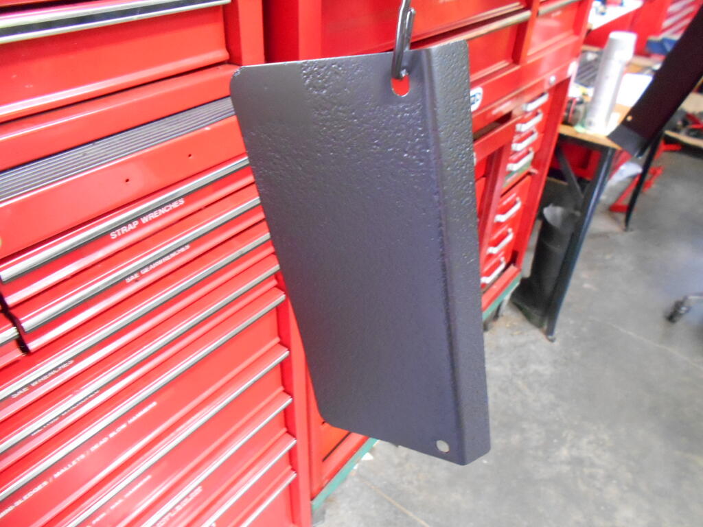

cleat 9,266 #127 Posted July 9, 2024 (edited) I have been waiting on high heat spray paint to go on sale then I realized that I have a can I bought for my pellet stove. I bought this little spray gun a year or two ago and have never used one before so I thought this would be a good learning experience. Paint seems fairly thin so I used it as is. Lower and upper heat shields painted. I was going to paint the muffler a silver colour but since I already have this paint and a silver deflector will be going onto it I sprayed it the same satin black as the heat shields. Spray gun worked well. The manual said to use 40-60 PSI but my little parts were getting blown all over so I reduced pressure to 30. Edited July 9, 2024 by cleat 3 3 Share this post Link to post Share on other sites

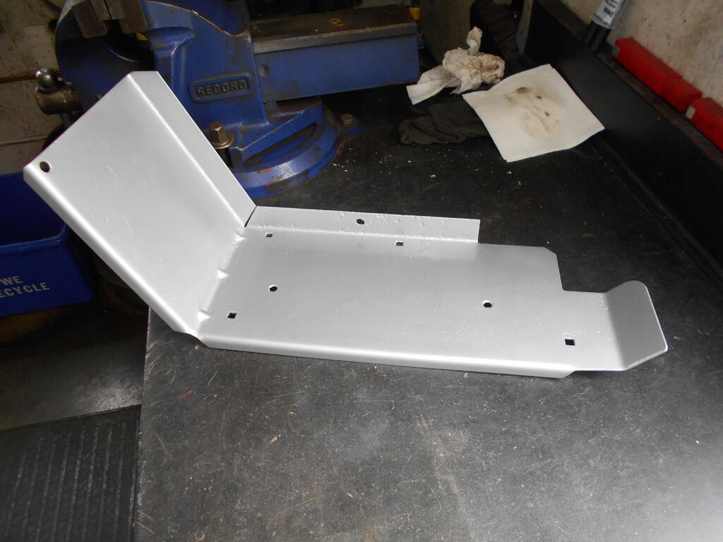

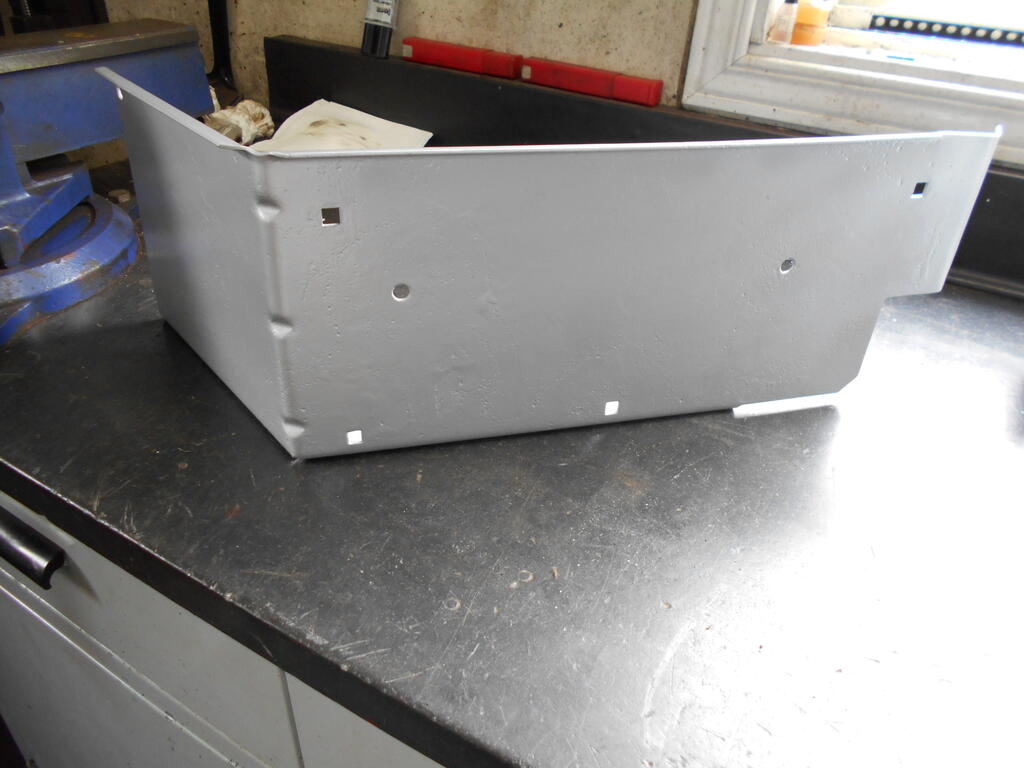

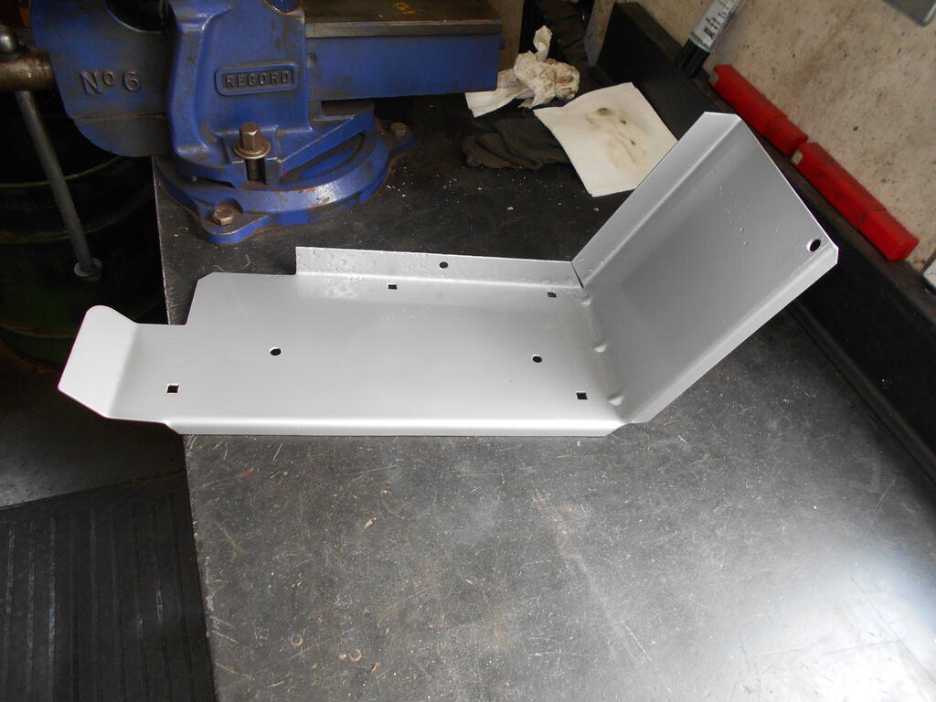

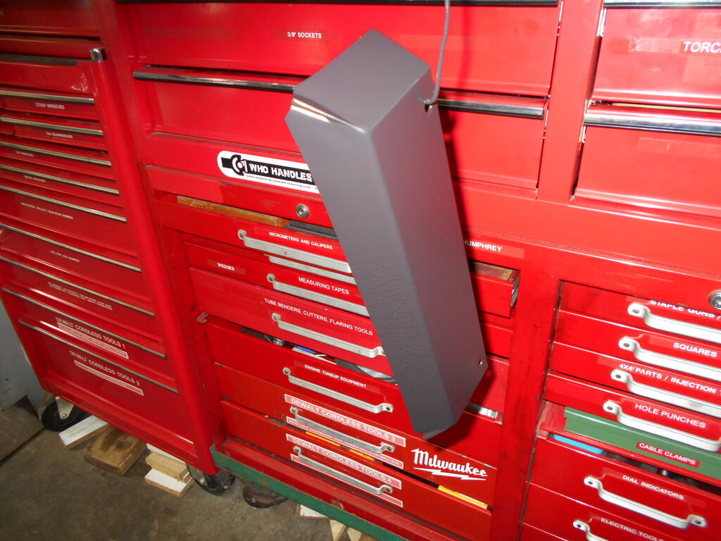

cleat 9,266 #128 Posted July 15, 2024 After much deliberation I have decided to paint my Work Horse silver aluminum with clear coat. Footrests painted and cleared. Footrest pads cut out. I will let the paint cure till at least September before spraying on the glue. That is nasty stuff that will lift any uncured paint. 2 1 Share this post Link to post Share on other sites

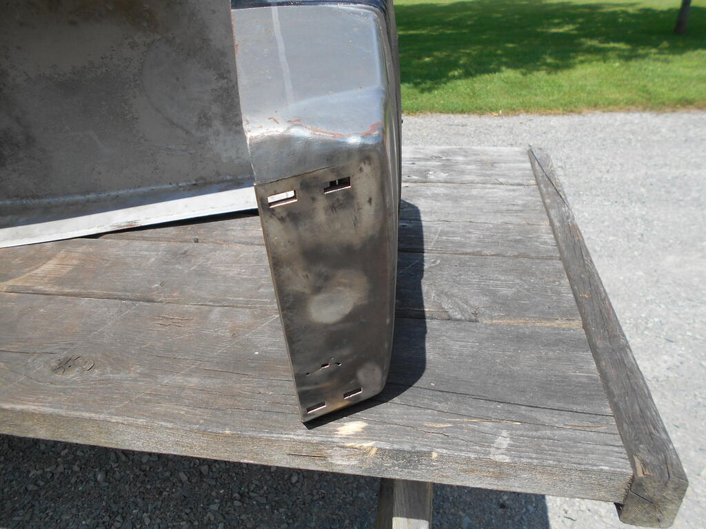

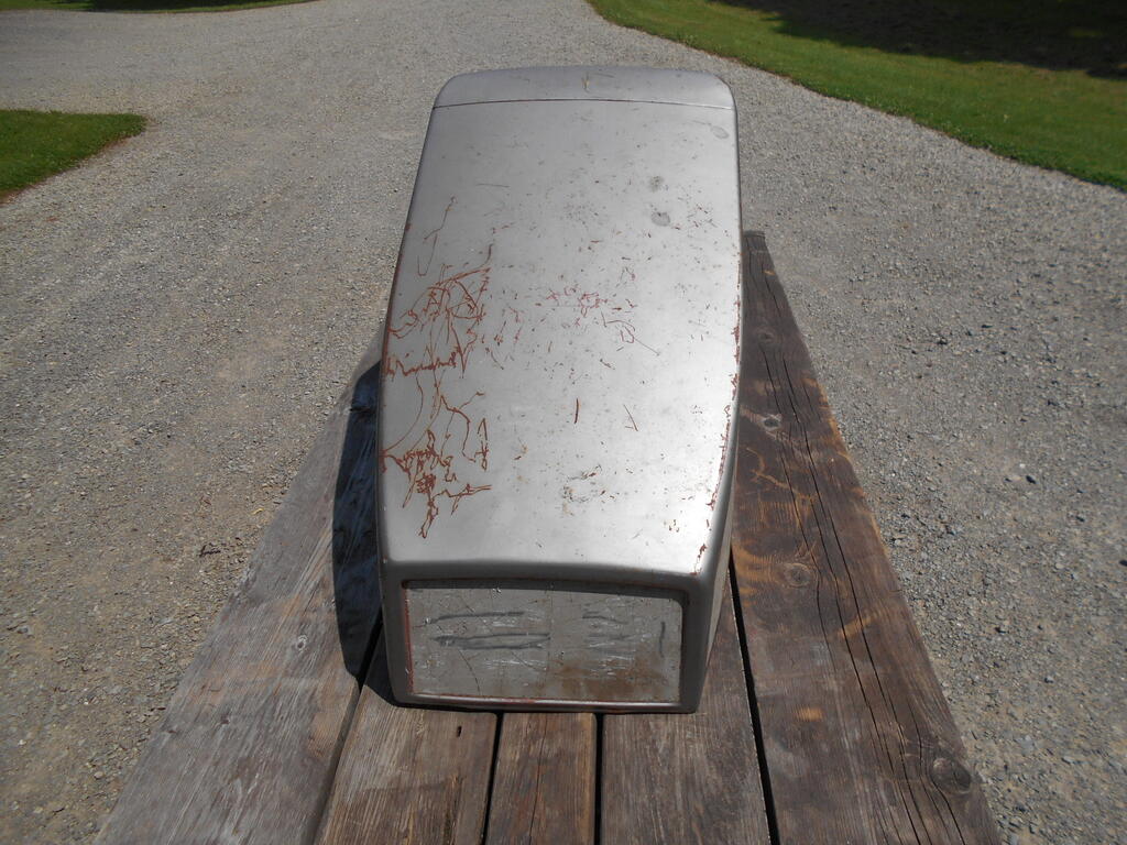

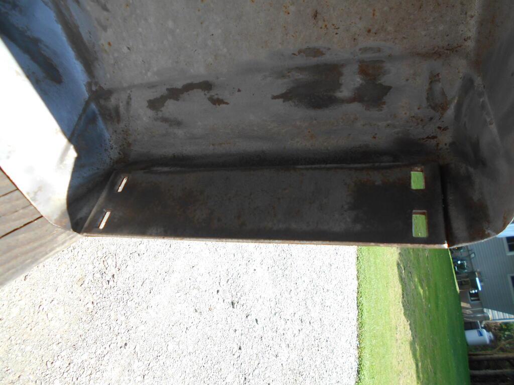

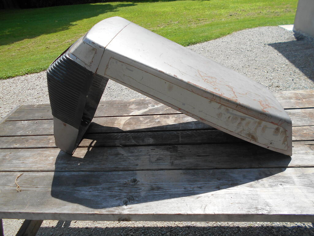

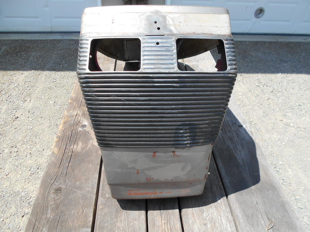

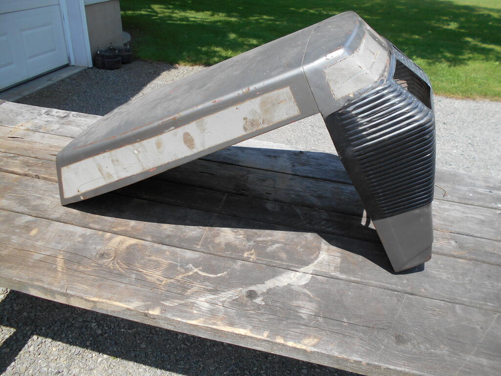

cleat 9,266 #129 Posted July 15, 2024 Front of hood cleaned up to have holes put in by some PO welded up. Bottom of hood cleaned up to get welded where it is torn on both sides of the bottom re-enforcement plate. I will be adding the brace that the later models came with to prevent this happening again. All decals removed. 2 1 Share this post Link to post Share on other sites

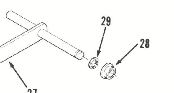

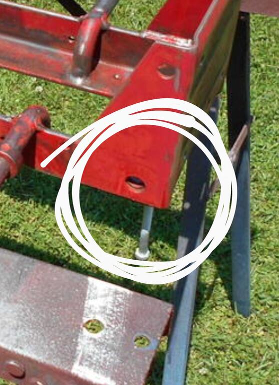

ebinmaine 80,426 #130 Posted July 16, 2024 What's the bushing that goes in this home?.. the one that holds the arm for the mower deck... Share this post Link to post Share on other sites
Handy Don 17,358 #131 Posted July 16, 2024 (edited) Its a shoulder bushing with the shoulder on the inside held in place with an e-clip (the other end of the rod is in a pocket--very clever) ID is the diameter or the lift arm crossbar OD (small) is the diameter of the frame hole; OD (large) is ⅛” or so more Edited July 16, 2024 by Handy Don 1 Share this post Link to post Share on other sites
ebinmaine 80,426 #132 Posted July 16, 2024 47 minutes ago, Handy Don said: Its a shoulder bushing with the shoulder on the inside held in place with an e-clip (the other end of the rod is in a pocket--very clever) ID is the diameter or the lift arm crossbar OD (small) is the diameter of the frame hole; OD (large) is ⅛” or so more Yes sir that's the one. Issue I am having is that what I'm seeing online is too thick. OD too big. I tried my favorite local hardware store and their stuff was exactly the same. Share this post Link to post Share on other sites
cleat 9,266 #133 Posted July 16, 2024 1 hour ago, ebinmaine said: What's the bushing that goes in this home?.. the one that holds the arm for the mower deck... Well, part of your issue is the lift arm does not go there it goes where you see it in this picture. The bushing OD is 5/8" ID is .5" Length from under flande to end of bushing is 3/8", OD of flange is 3/4" 1 1 Share this post Link to post Share on other sites
ebinmaine 80,426 #134 Posted July 16, 2024 27 minutes ago, cleat said: bushing That looks more like the broken flanged one I took out. So, knowing I can't get em around here... who has those? Share this post Link to post Share on other sites
ebinmaine 80,426 #135 Posted July 16, 2024 Looks like McMaster Carr? https://www.mcmaster.com/product/6338K572 1 Share this post Link to post Share on other sites
Handy Don 17,358 #136 Posted July 16, 2024 25 minutes ago, ebinmaine said: That looks more like the broken flanged one I took out. So, knowing I can't get em around here... who has those? 22 minutes ago, ebinmaine said: Looks like McMaster Carr? https://www.mcmaster.com/product/6338K572 Get a lathe buddy to turn down a straight bushing? The McM link is to a bushing with ½” ID, not ⅝" Share this post Link to post Share on other sites
ebinmaine 80,426 #137 Posted July 16, 2024 12 minutes ago, Handy Don said: Get a lathe buddy to turn down a straight bushing? No local lathe access to me. 12 minutes ago, Handy Don said: The McM link is to a bushing with ½” ID, not ⅝" Yep. That's what we need. 1 Share this post Link to post Share on other sites
cleat 9,266 #138 Posted July 16, 2024 1 hour ago, ebinmaine said: Looks like McMaster Carr? https://www.mcmaster.com/product/6338K572 Looks like that one will work. 1 Share this post Link to post Share on other sites

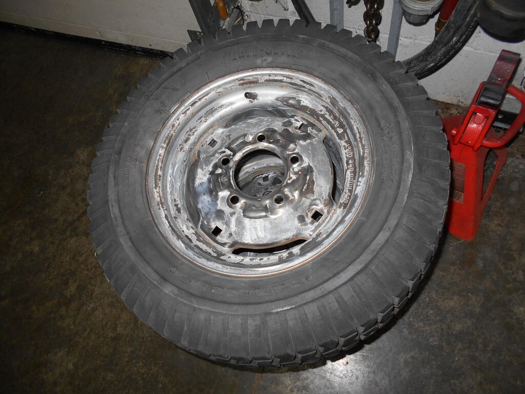

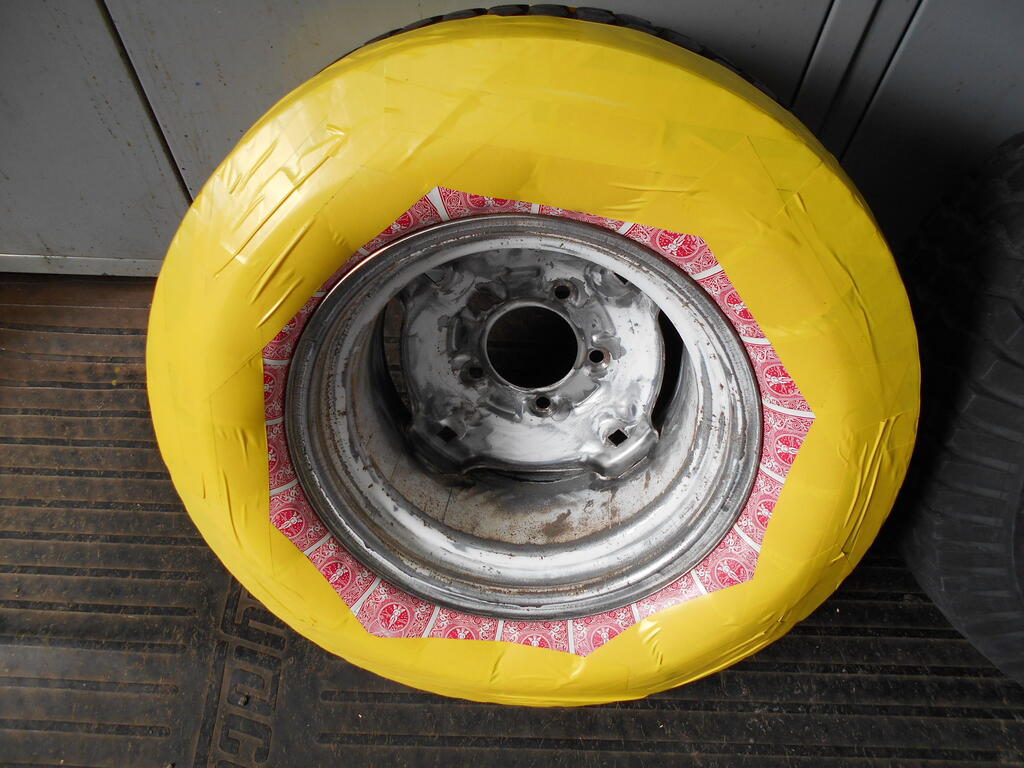

cleat 9,266 #139 Posted July 16, 2024 Washed all 4 wheels and pulled front wheel bearings. Started wire brushing the loose paint and rust off then stopped for lunch. Then the rain started so that's all for today. 3 1 Share this post Link to post Share on other sites

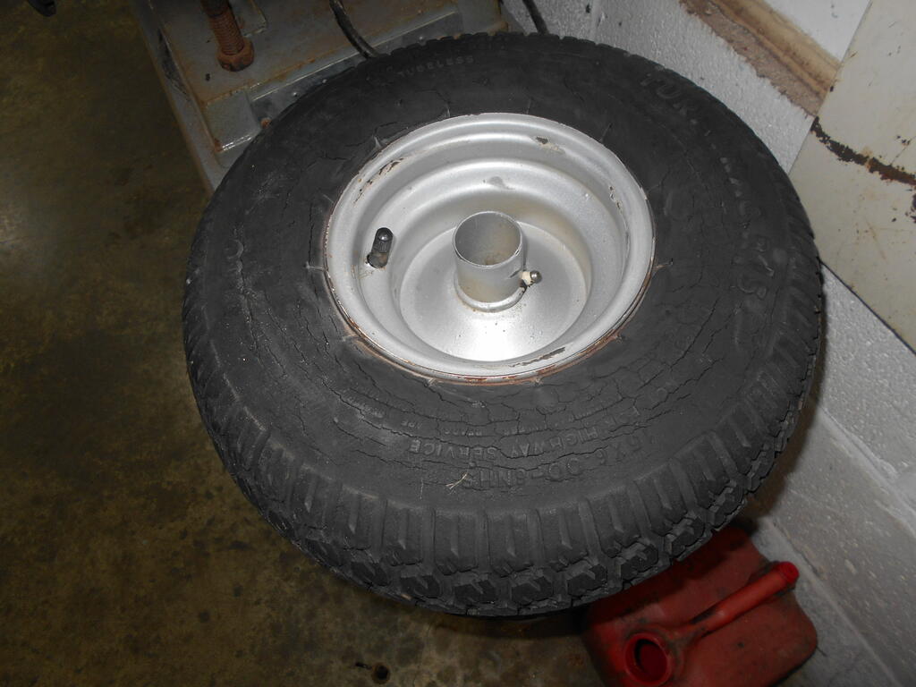

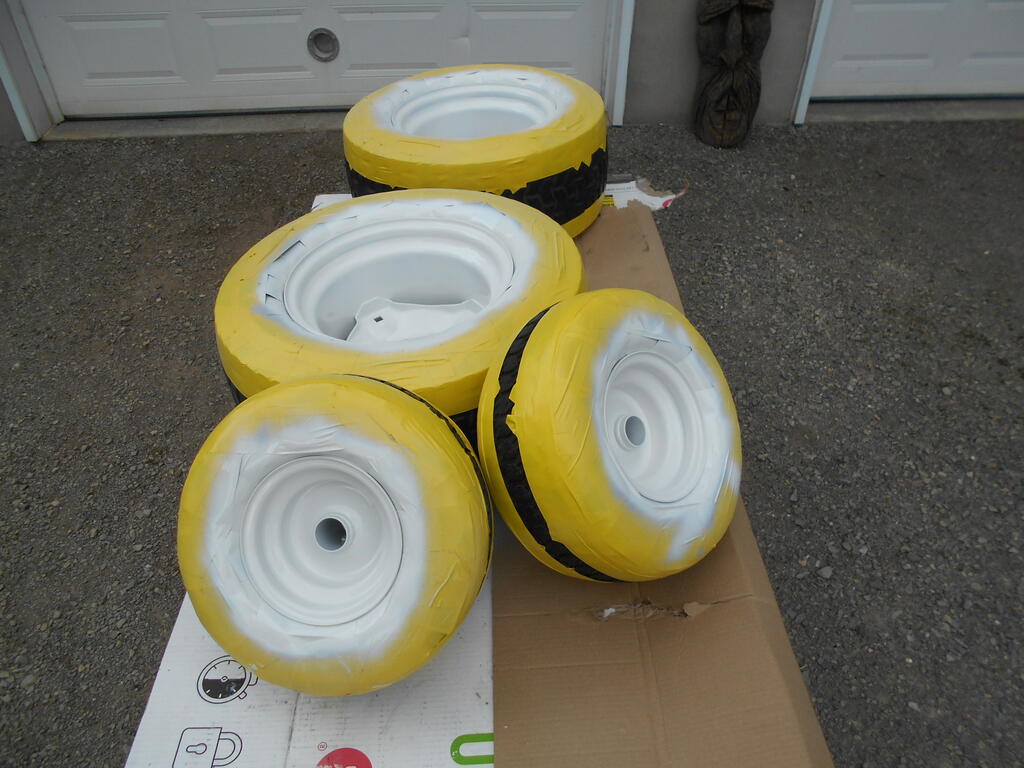

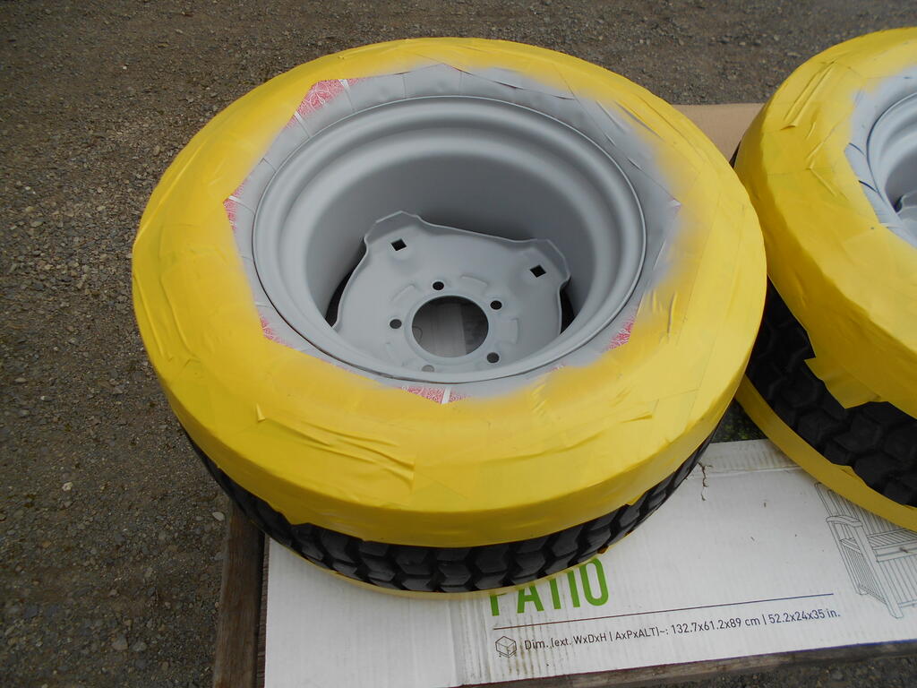

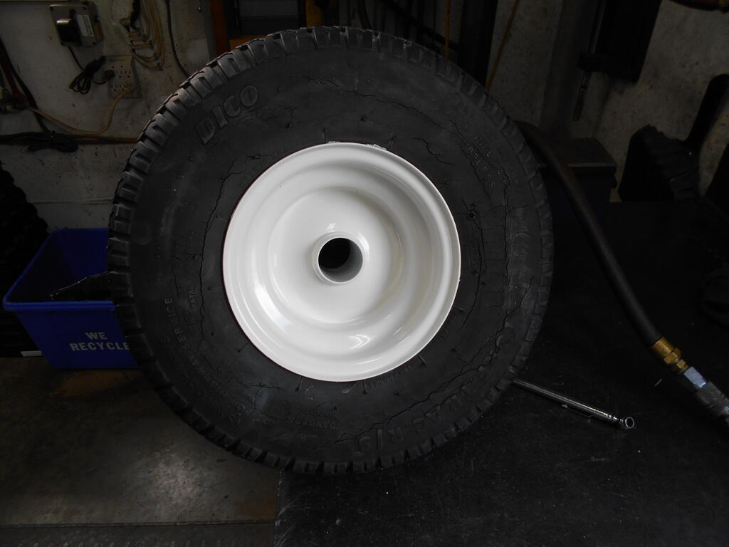

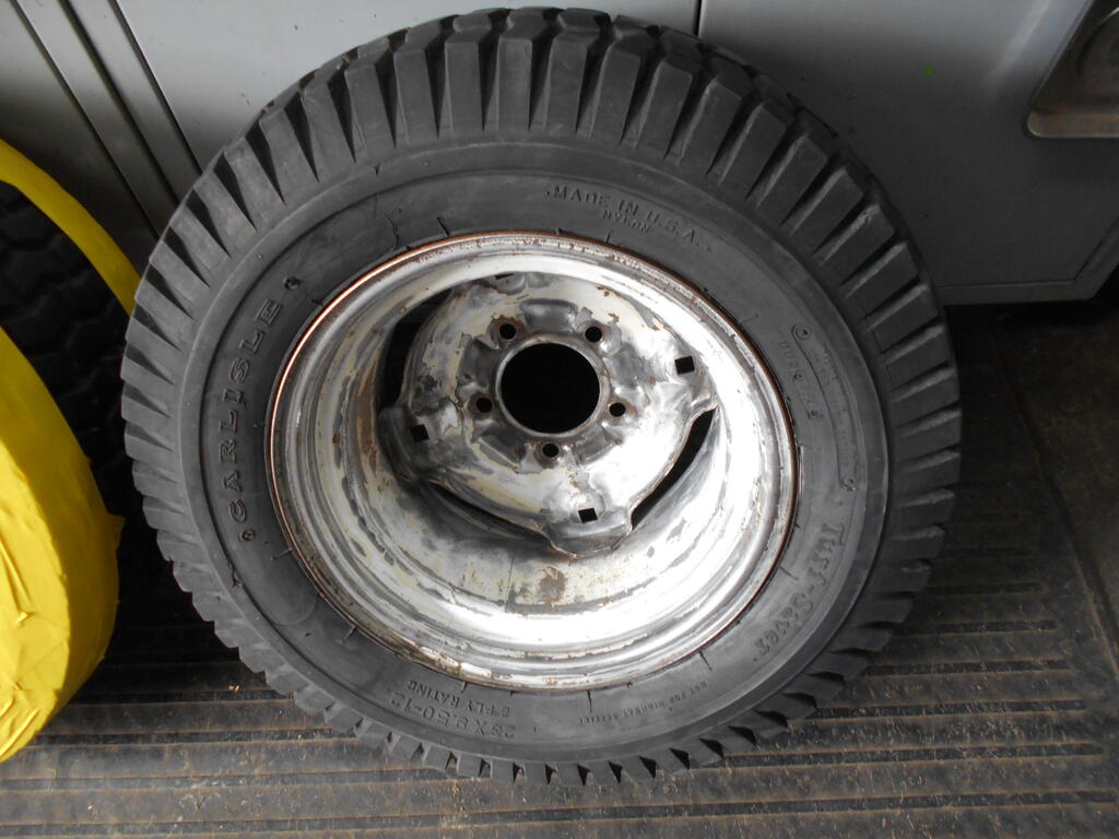

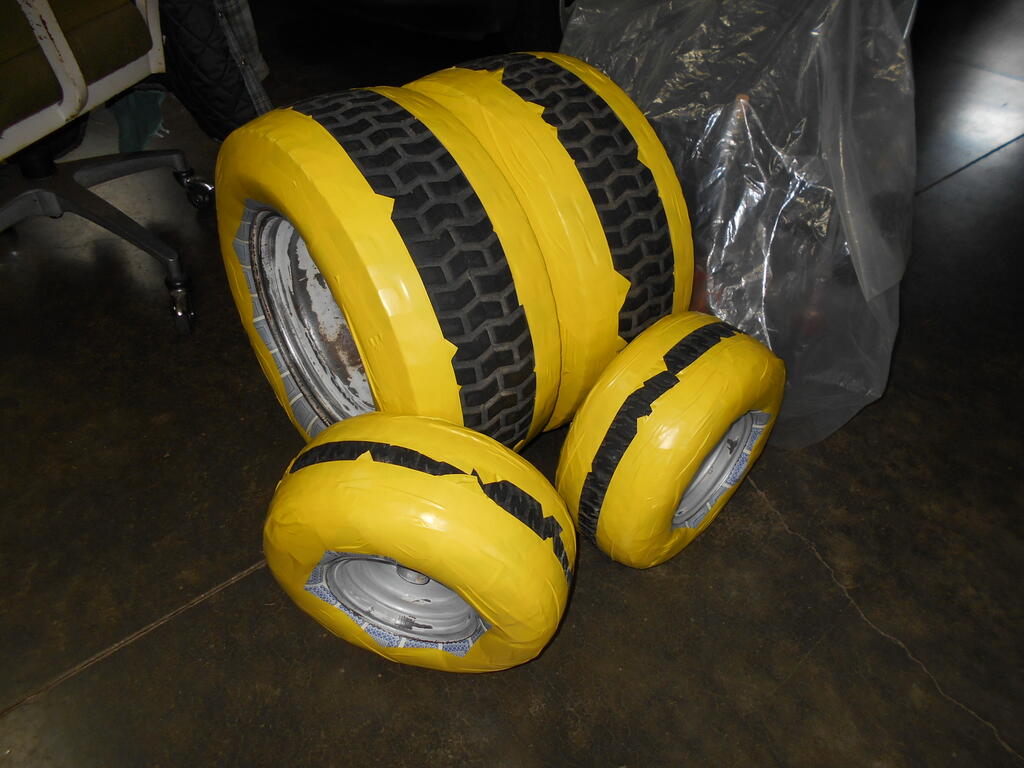

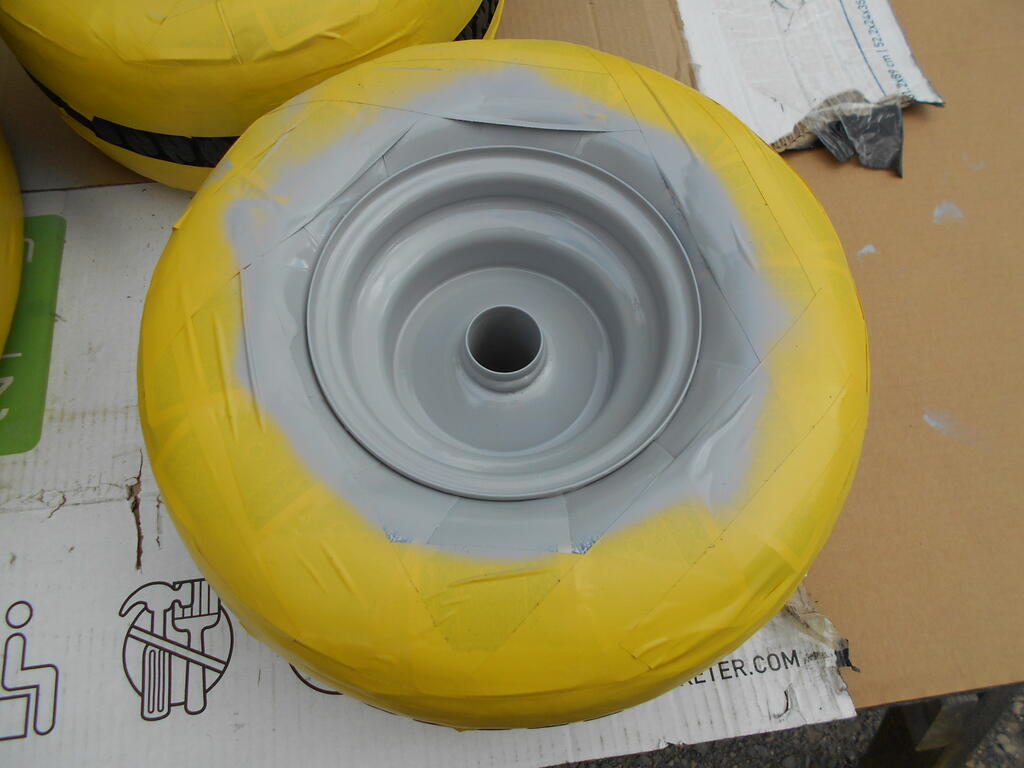

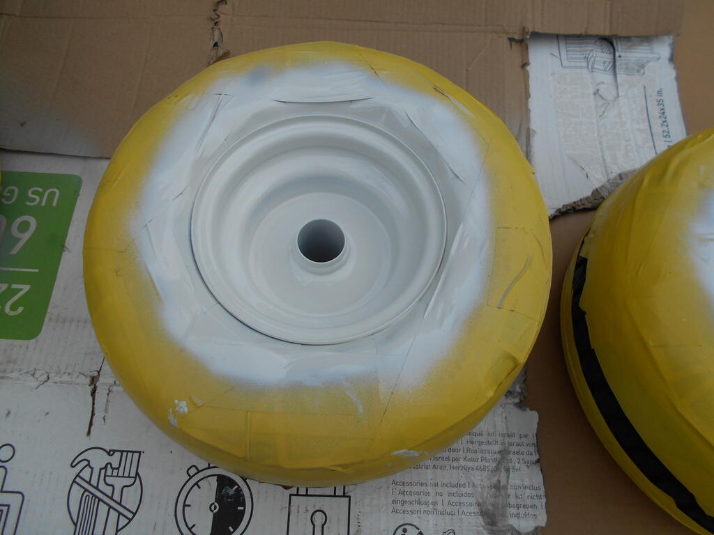

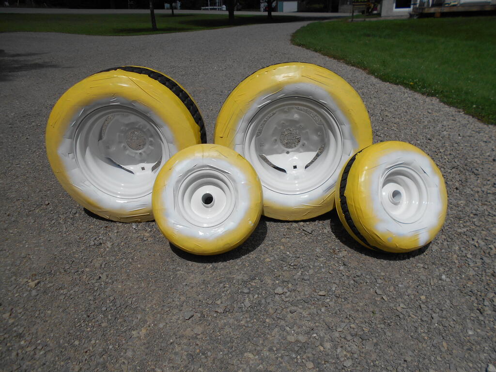

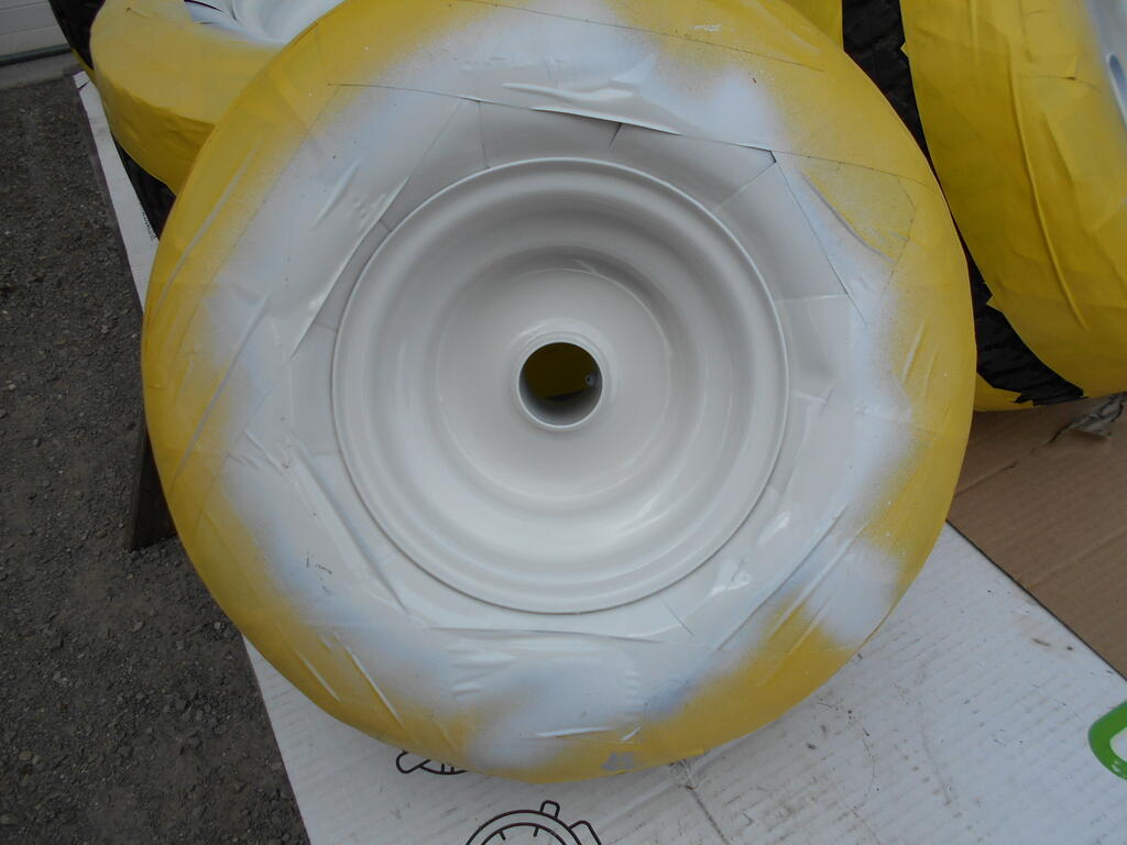

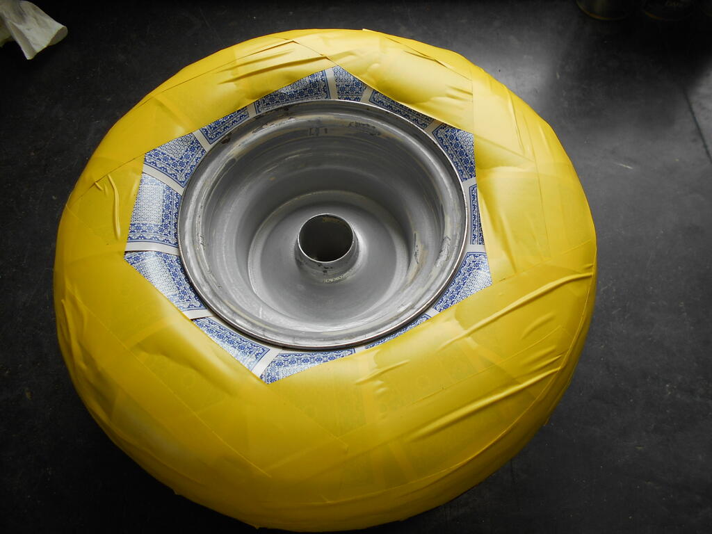

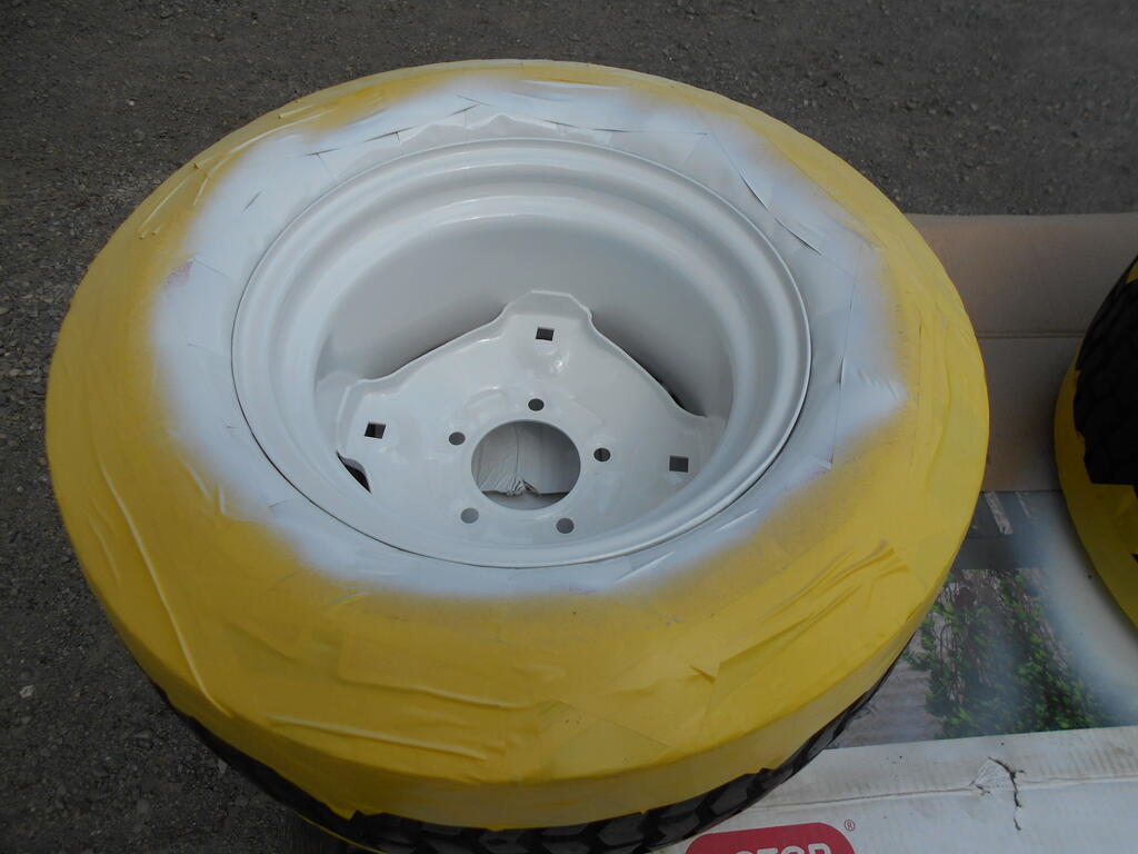

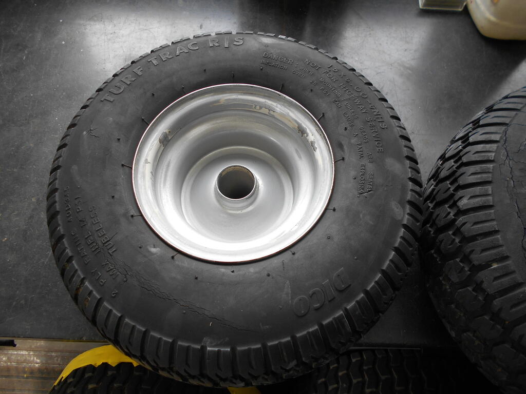

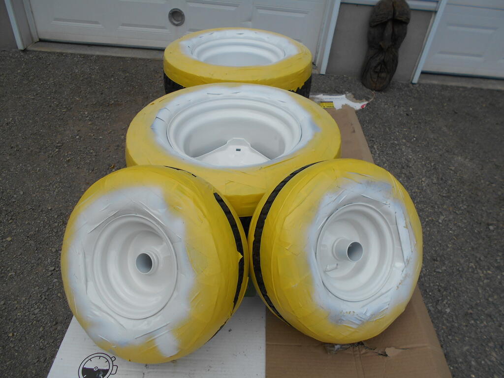

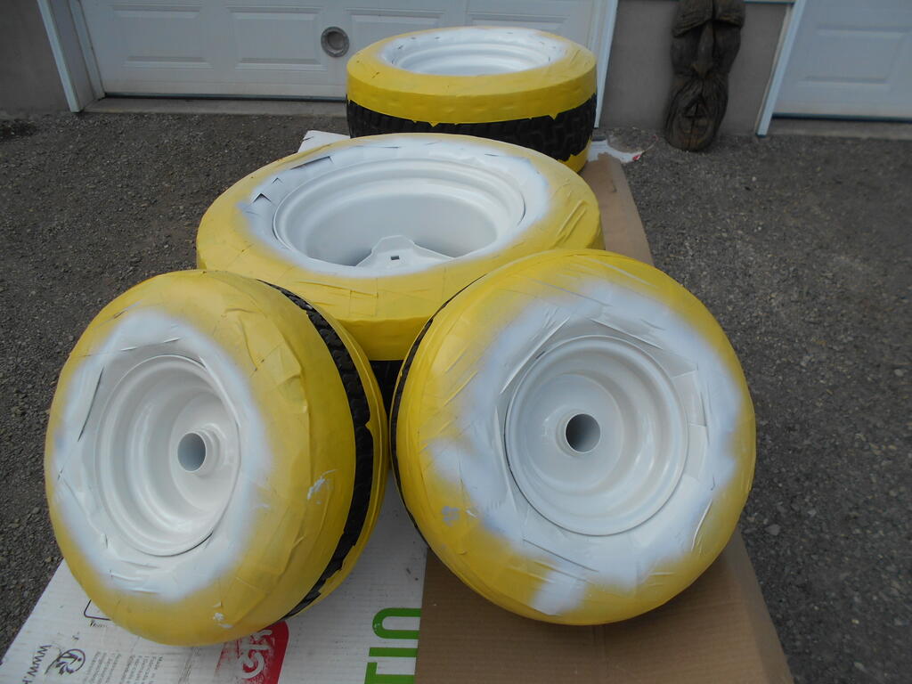

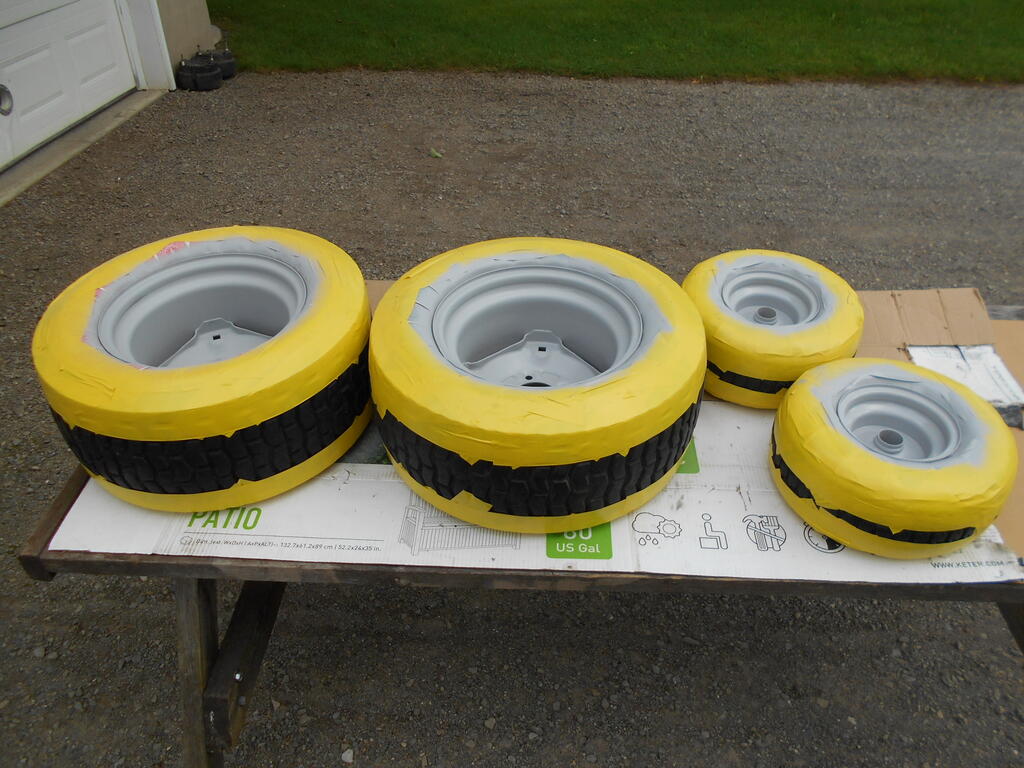

cleat 9,266 #140 Posted July 17, 2024 (edited) Rear wheel sanded. Rear wheel masked. Front wheel sanded. Front wheel masked. All wheels masked. Ready for paint but it is going to rain today and I am painting these outside so they will have to wait for a day or two. Yes these tires are cracked up pretty bad but they hold air so they will do for now. Some day I will get 8" wheels and tires for the front as well. Edited July 17, 2024 by cleat 2 Share this post Link to post Share on other sites

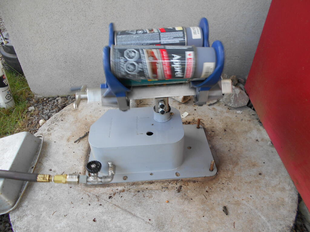

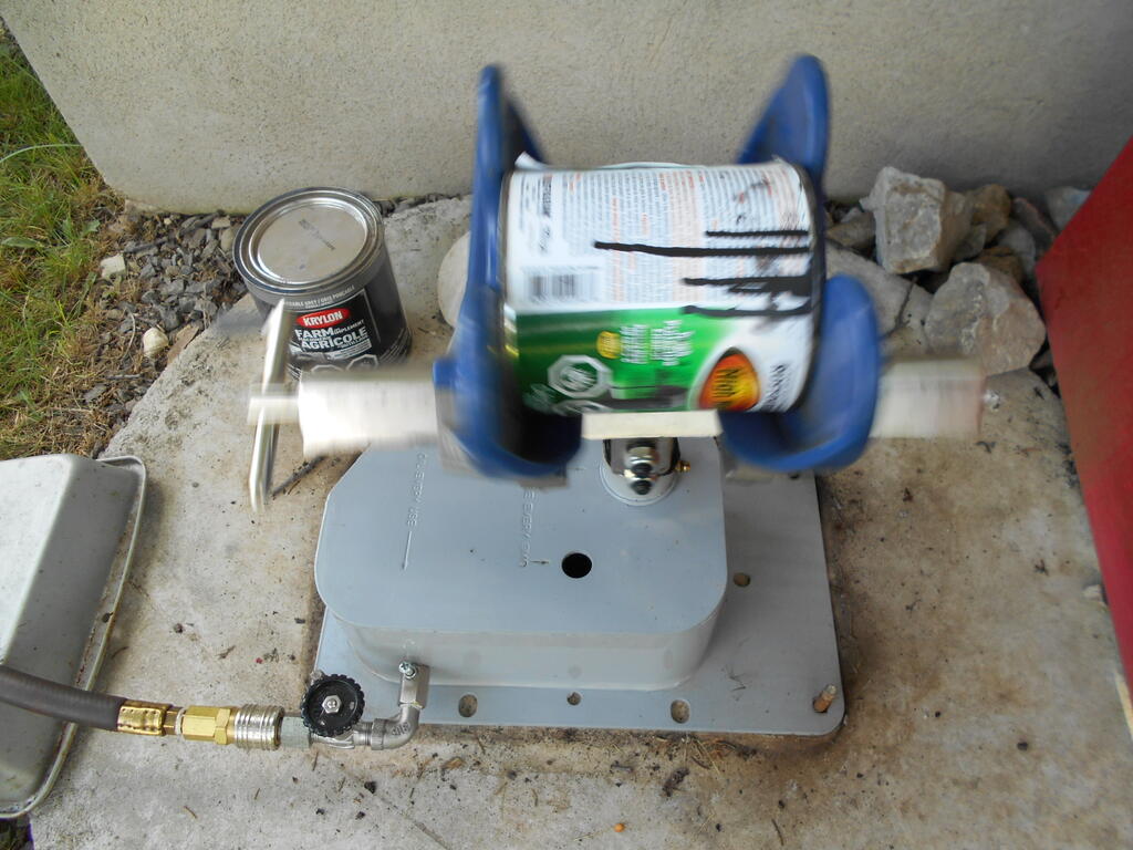

cleat 9,266 #141 Posted July 17, 2024 (edited) Paint shaker I bought a couple of years ago has been a godsend. Makes even the very old spray cans free up and work like new. Of course it works on regular cans of paint too. Edited July 17, 2024 by cleat 4 Share this post Link to post Share on other sites

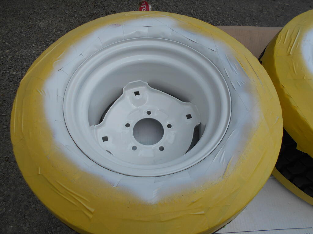

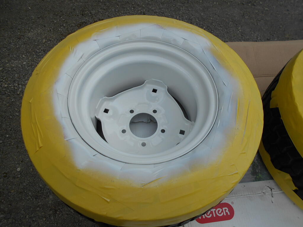

cleat 9,266 #142 Posted July 18, 2024 Primed the wheels. Of course as soon as I started the winds picked up and the clouds rolled in. 1 Share this post Link to post Share on other sites

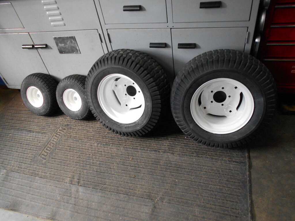

cleat 9,266 #143 Posted July 18, 2024 First coat of white paint finished. 2 Share this post Link to post Share on other sites
cleat 9,266 #144 Posted July 18, 2024 Second coat of paint done. 2 Share this post Link to post Share on other sites

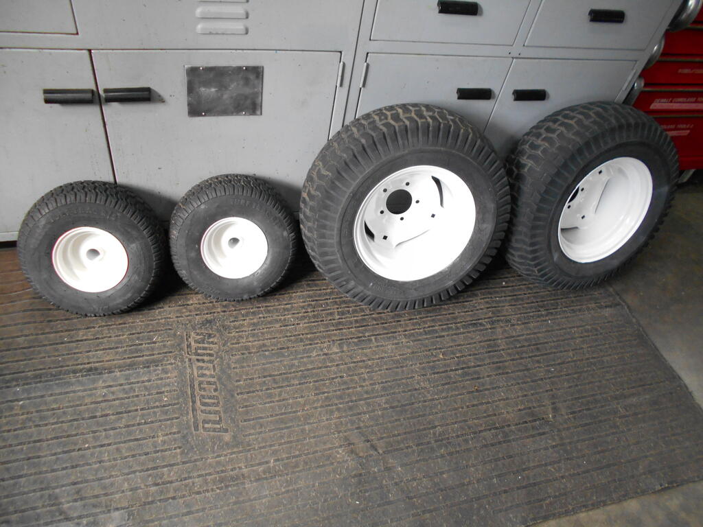

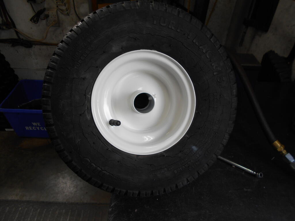

cleat 9,266 #145 Posted July 18, 2024 Wheels clear coated. 2 3 Share this post Link to post Share on other sites
Bill D 3,116 #146 Posted July 18, 2024 22 hours ago, cleat said: Paint shaker I bought a couple of years ago has been a godsend. Makes even the very old spray cans free up and work like new. Of course it works on regular cans of paint too. Where did you get that from? I'd like to buy one. 1 Share this post Link to post Share on other sites
cleat 9,266 #147 Posted July 18, 2024 (edited) 8 minutes ago, Bill D said: Where did you get that from? I'd like to buy one. I bought mine at Princess Auto but I see Harbor Freight sells them as well. There are also lots on ebay. https://www.harborfreight.com/pneumatic-paint-shaker-94605.html?_br_psugg_q=paint+shaker I mounted mine loosely on a patio stone to hold it. When I am not using it I just lift it off of the concrete anchor bolts and bring it inside. It would be nice to have inside but I was afraid of doing damage to my shop due to the intense shaking. Also if a paint can ruptures and sprays paint around I would prefer it to be outside. Edited July 18, 2024 by cleat 2 Share this post Link to post Share on other sites

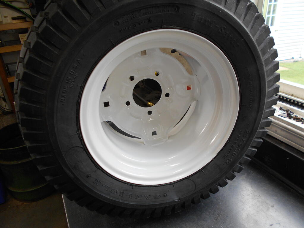

cleat 9,266 #148 Posted July 18, 2024 Wheels out in the sun to dry the paint. 3 2 Share this post Link to post Share on other sites
ebinmaine 80,426 #149 Posted July 18, 2024 5 hours ago, cleat said: Also if a paint can ruptures and sprays paint around I would prefer it to be outside. Having worked for a Dupont paint seller in the past I assure you that is true. 😅 Share this post Link to post Share on other sites

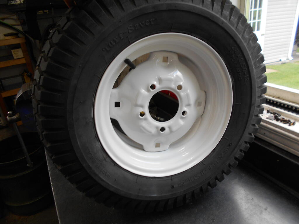

cleat 9,266 #150 Posted July 21, 2024 Masking removed from wheels. Tires all aired up to 12 PSI (they were de-aired for masking and painting). 3 1 Share this post Link to post Share on other sites
