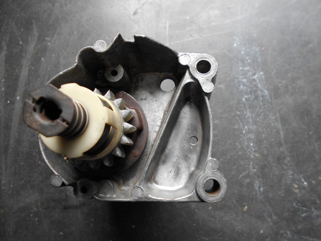

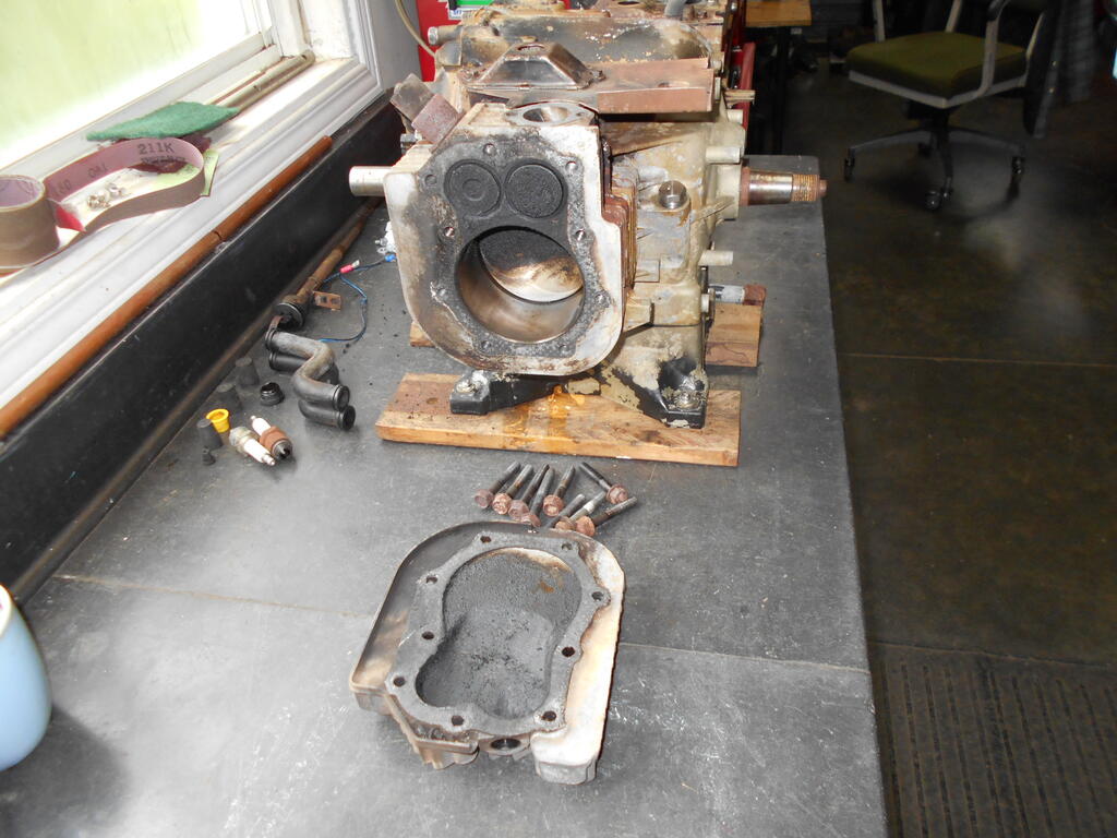

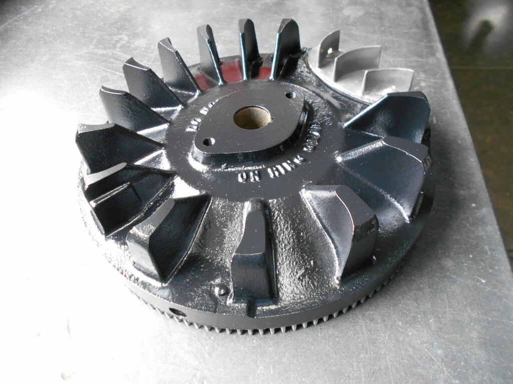

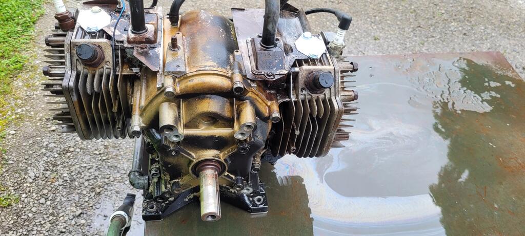

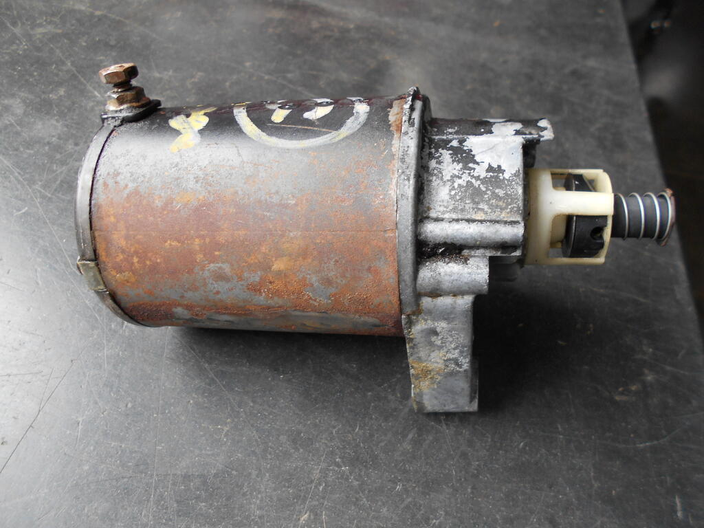

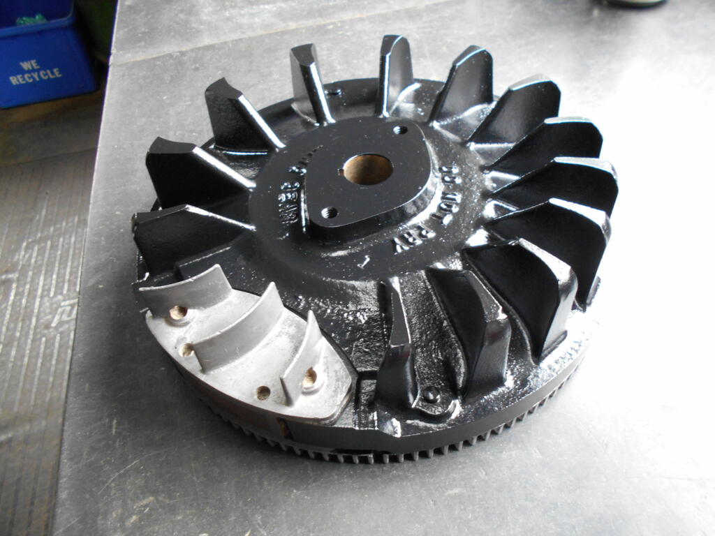

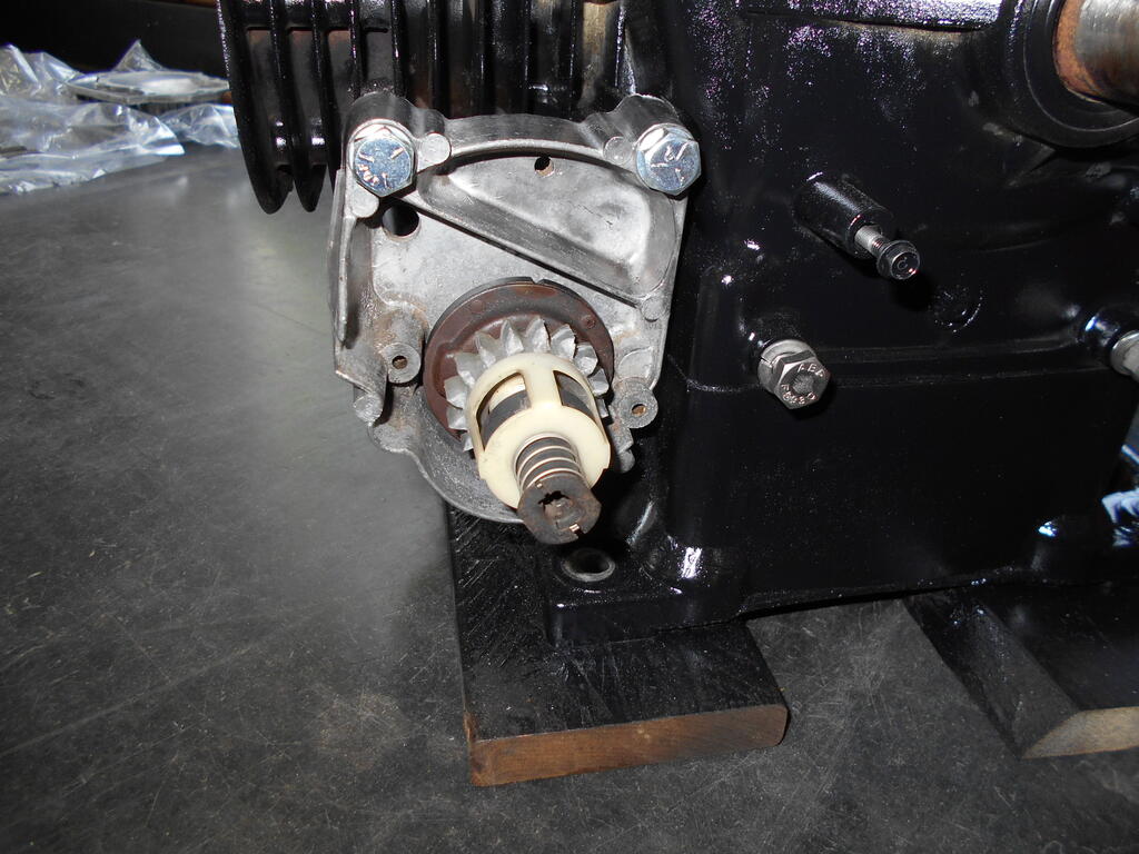

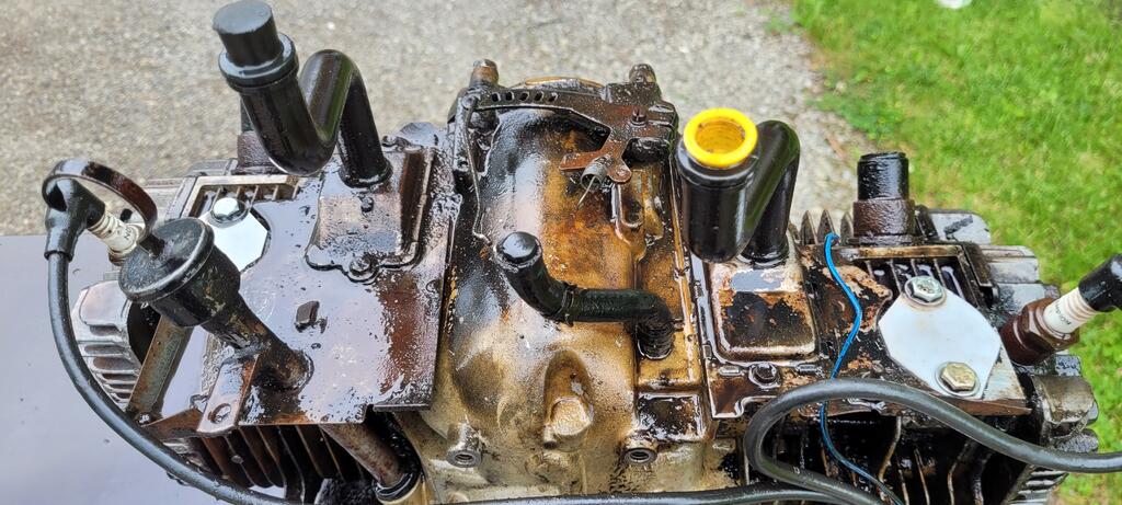

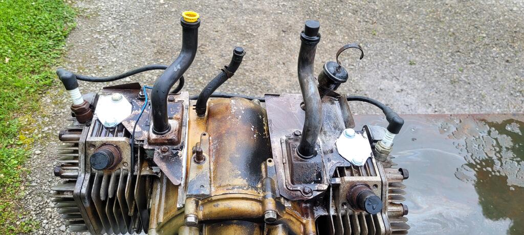

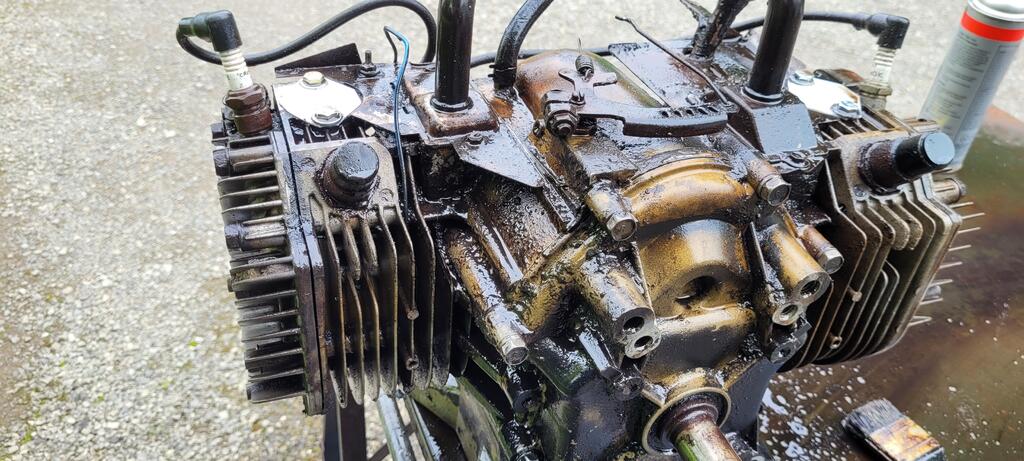

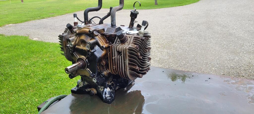

cleat 9,266 #78 Posted June 11, 2024 (edited) Flywheel painted. Engine during cleaning. Soaked with degreaser. Engine cleaned up ready for more disassembly. Starter as removed after engine cleaning. Edited June 11, 2024 by cleat 3 2 Share this post Link to post Share on other sites

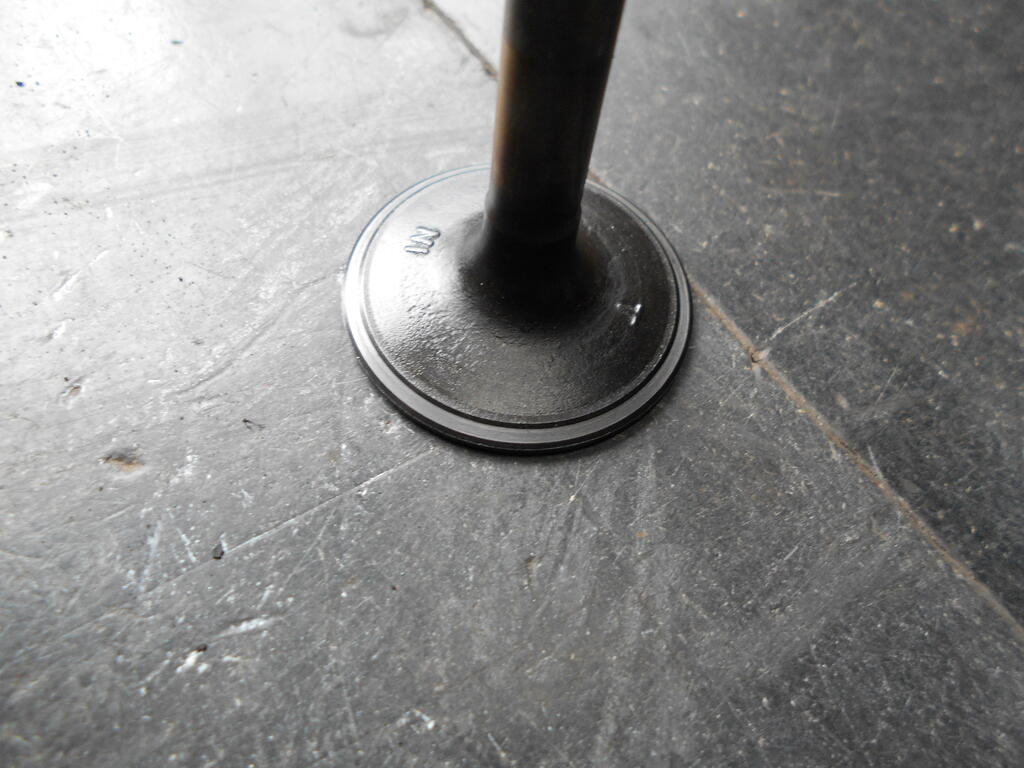

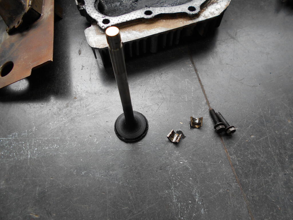

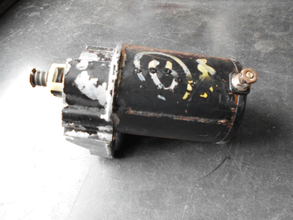

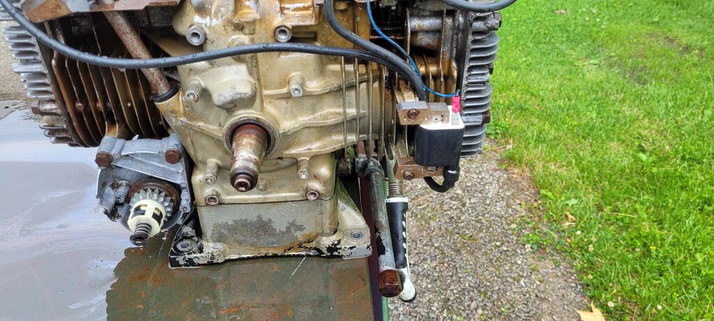

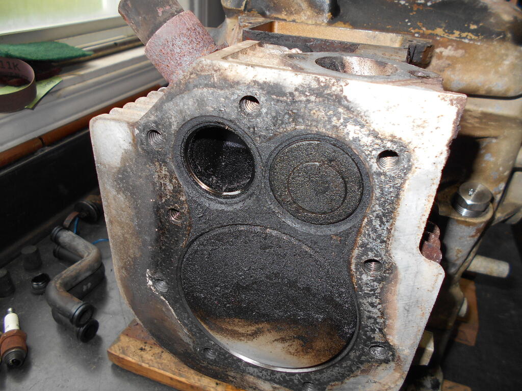

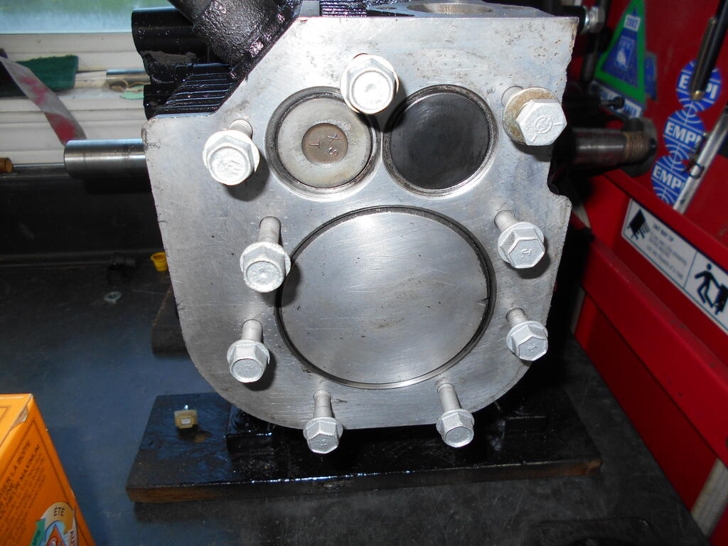

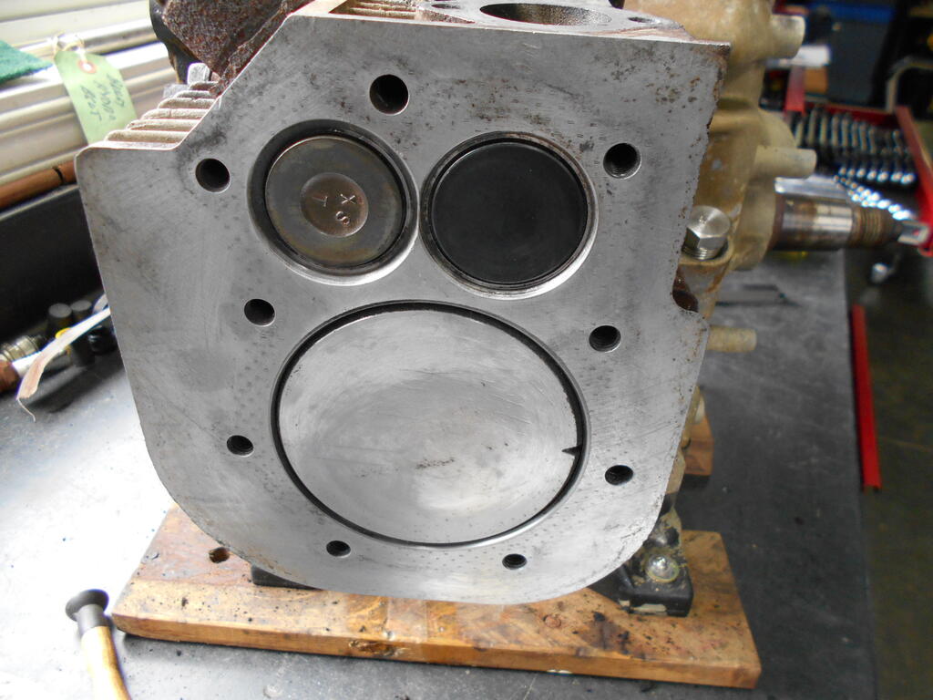

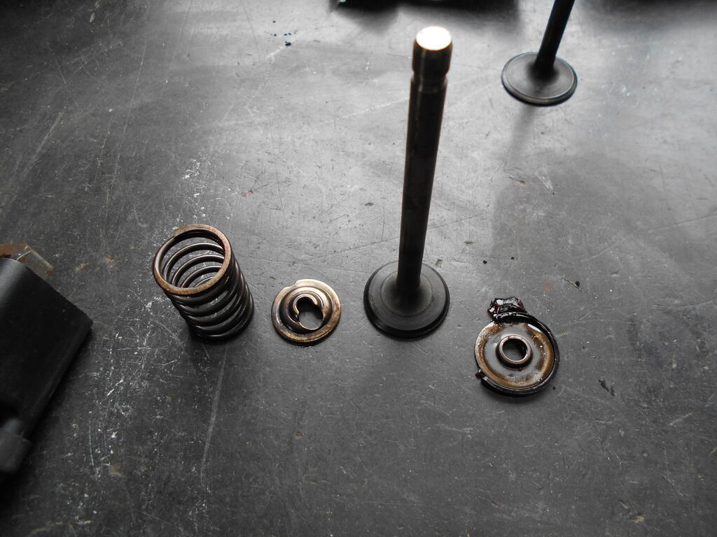

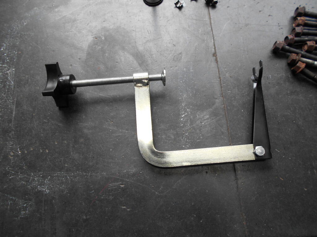

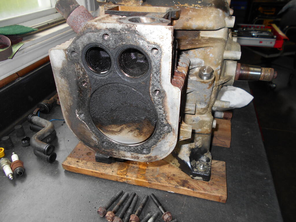

cleat 9,266 #79 Posted June 12, 2024 (edited) Pulled head back off after engine degreasing. Pulled exhaust valve. Pulled intake valve. Both valves now pulled. Lapped intake valve and set valve clearance. This is the lapping compound and valve spring compressor used. Piston and block cleaned. Valves both installed New intake valve seal installed. Edited June 12, 2024 by cleat 2 2 Share this post Link to post Share on other sites
kpinnc 18,915 #80 Posted June 12, 2024 1 hour ago, cleat said: Piston and block cleaned. As usual- beautiful work! 1 Share this post Link to post Share on other sites
Bill D 3,116 #81 Posted June 12, 2024 Nice work. Are you going to open up the engine and check for wear on the pin holding the crank gear to the crank shaft? I saw a video on YouTube where the gear was moving on the crank shaft due to the crank pin being worn almost in half. 1 Share this post Link to post Share on other sites
cleat 9,266 #82 Posted June 12, 2024 13 minutes ago, Bill D said: Nice work. Are you going to open up the engine and check for wear on the pin holding the crank gear to the crank shaft? I saw a video on YouTube where the gear was moving on the crank shaft due to the crank pin being worn almost in half. I'm not sure. Likely the OCD will kick in and I will. End play is at the high end as well so I could fix that at the same time. 1 Share this post Link to post Share on other sites

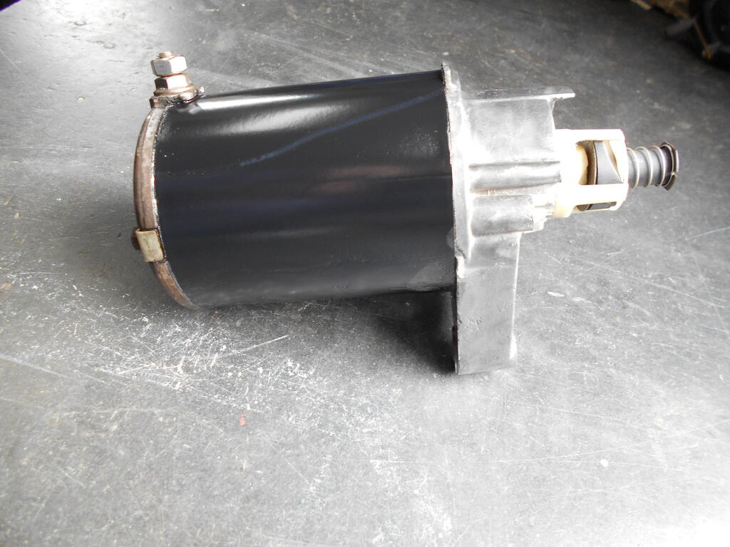

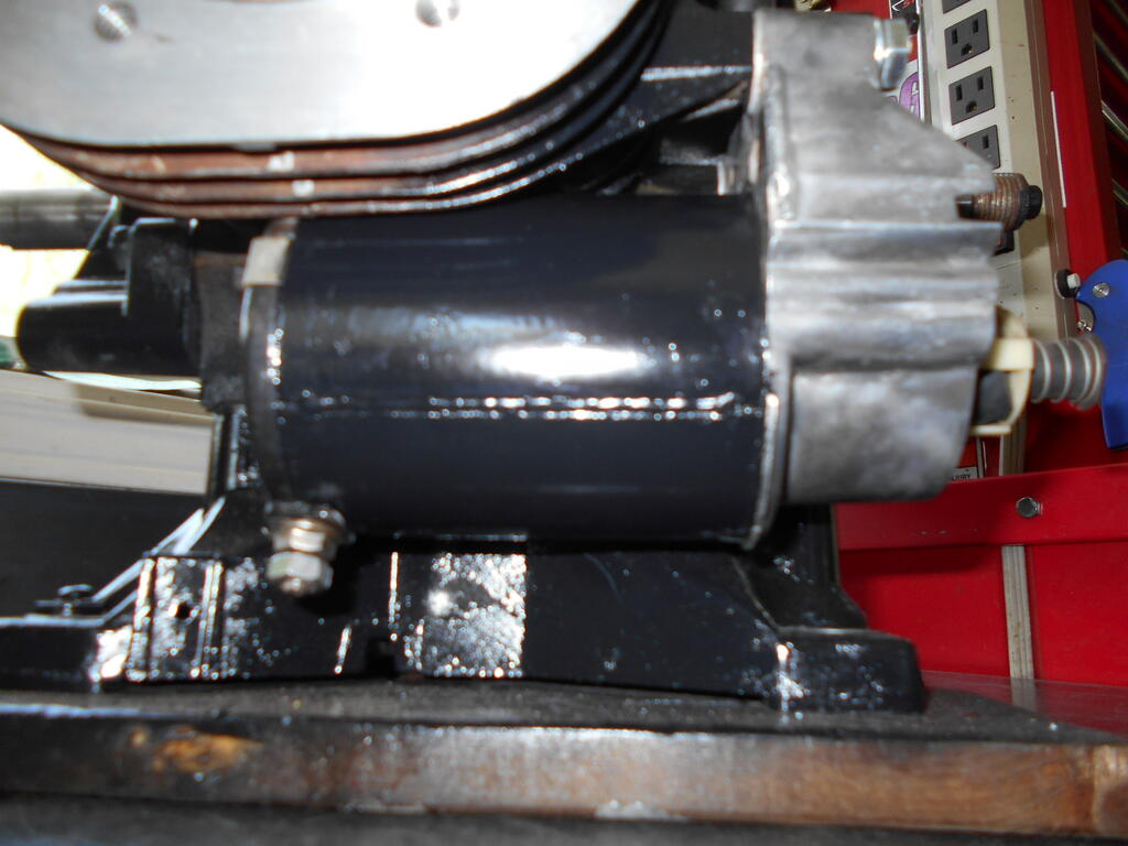

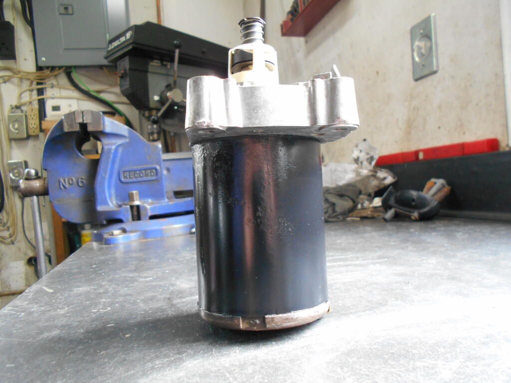

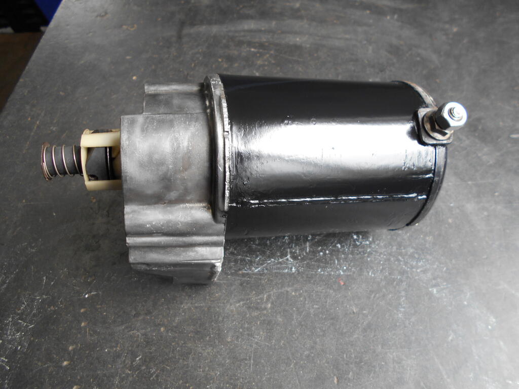

cleat 9,266 #83 Posted June 12, 2024 Starter painted. I did not open it up as it was working fine. 1 1 Share this post Link to post Share on other sites

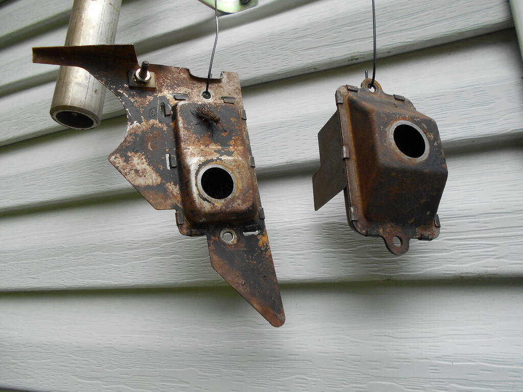

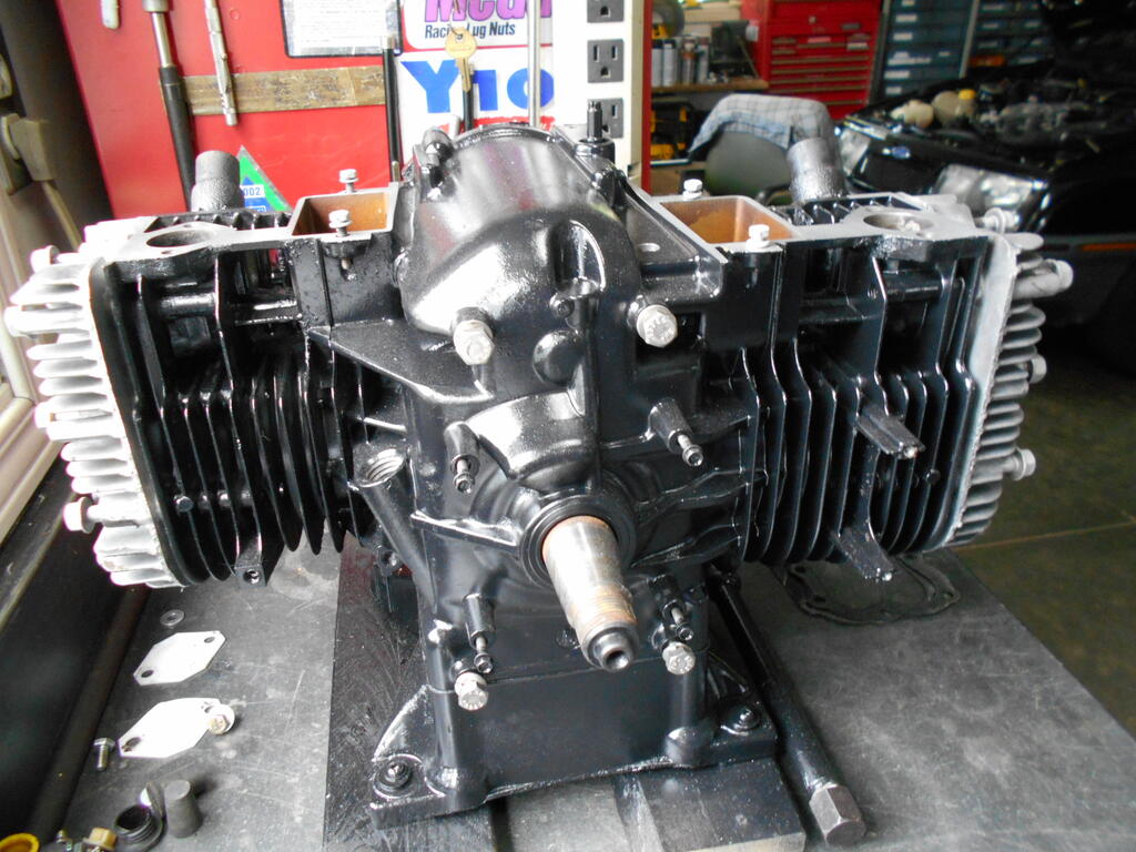

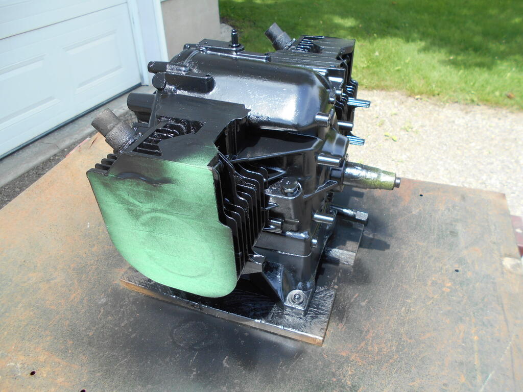

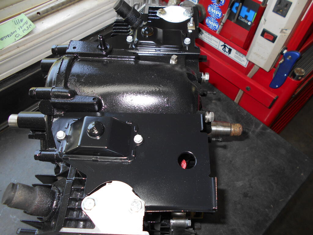

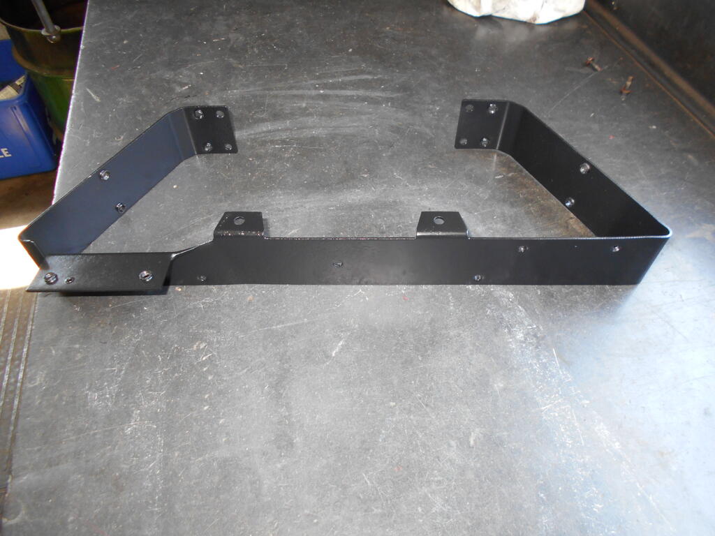

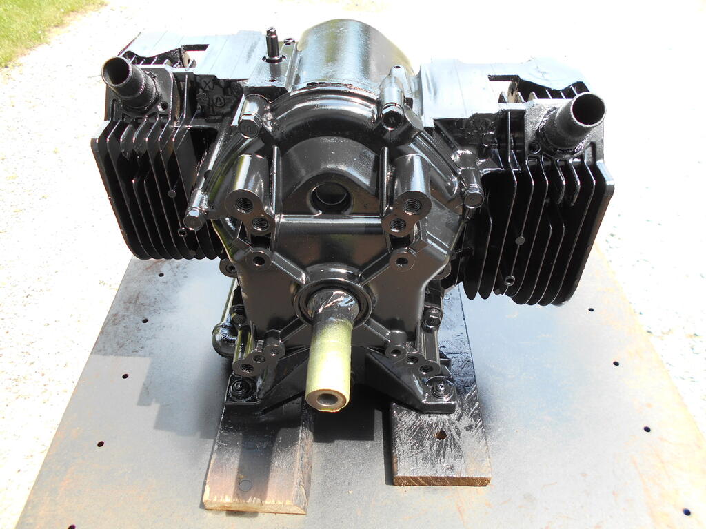

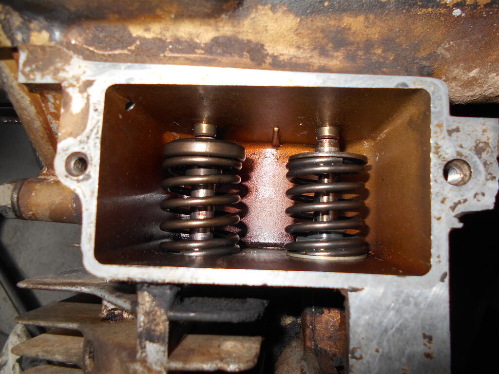

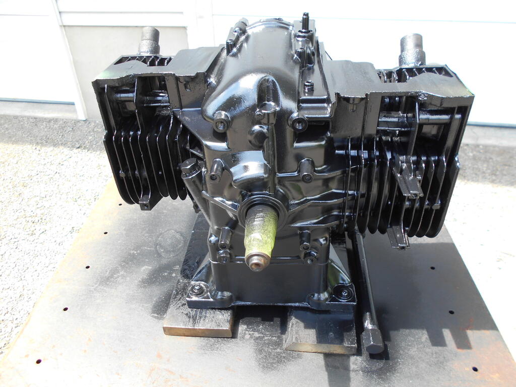

cleat 9,266 #86 Posted June 13, 2024 Air guide frame painted Engine block painted. Valve covers cleaned out using brake cleaner until screens looked clean and discs moved freely. Fly might be getting high from the fumes. 3 1 1 Share this post Link to post Share on other sites
Easton Rich 1,260 #87 Posted June 14, 2024 12 hours ago, cleat said: Air guide frame painted Engine block painted. Valve covers cleaned out using brake cleaner until screens looked clean and discs moved freely. Fly might be getting high from the fumes. Fly don’t know what’s happening to him but he likes it 2 Share this post Link to post Share on other sites

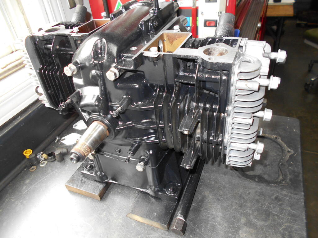

cleat 9,266 #88 Posted June 14, 2024 Masking removed from engine. All bolt holes tapped out. Head bolts, valve cover bolts, and alternator bolts cleaned up and painted. Heads degreased and washed. 4 1 Share this post Link to post Share on other sites
cleat 9,266 #89 Posted June 14, 2024 Valve covers painted. 3 1 Share this post Link to post Share on other sites

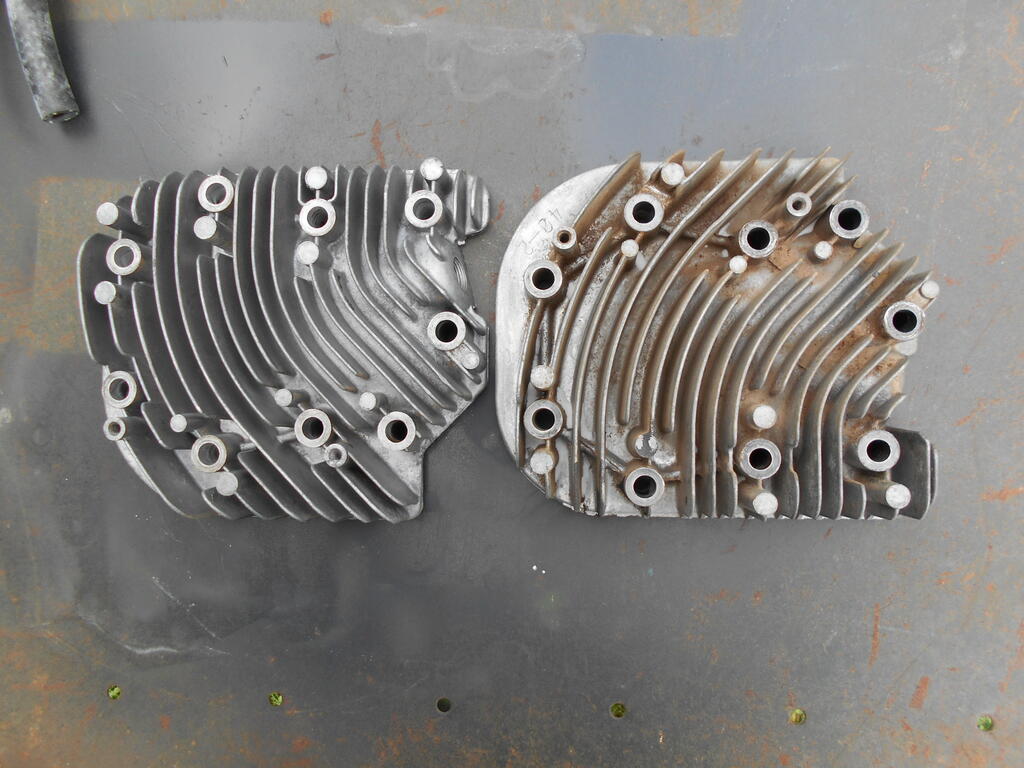

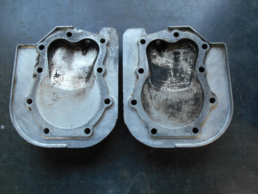

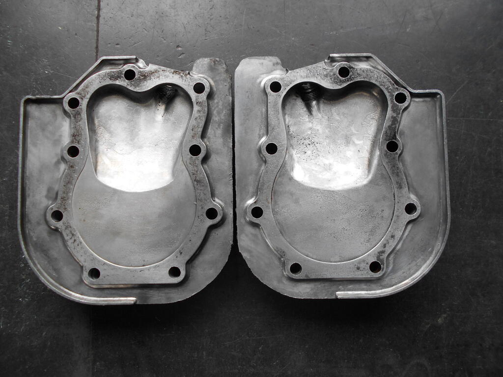

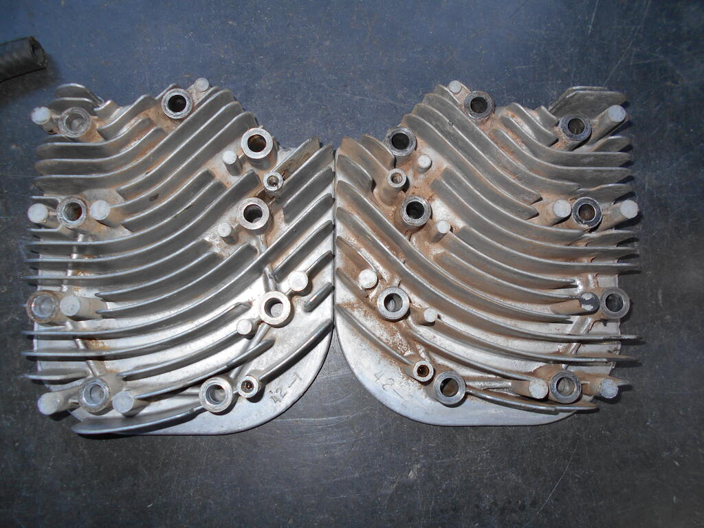

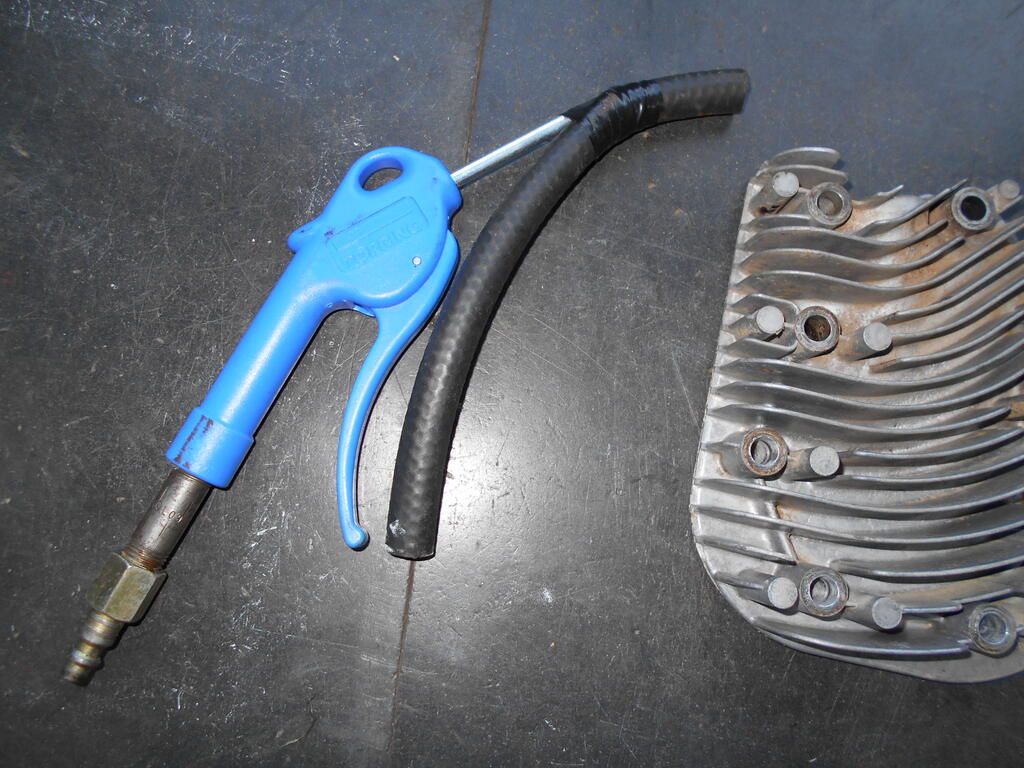

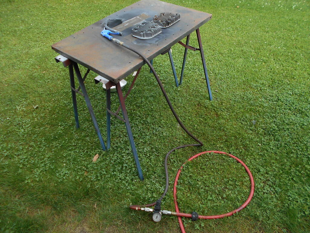

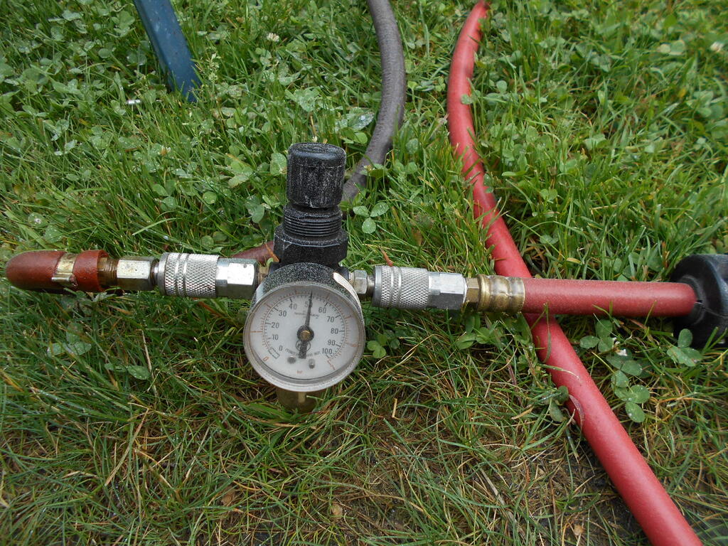

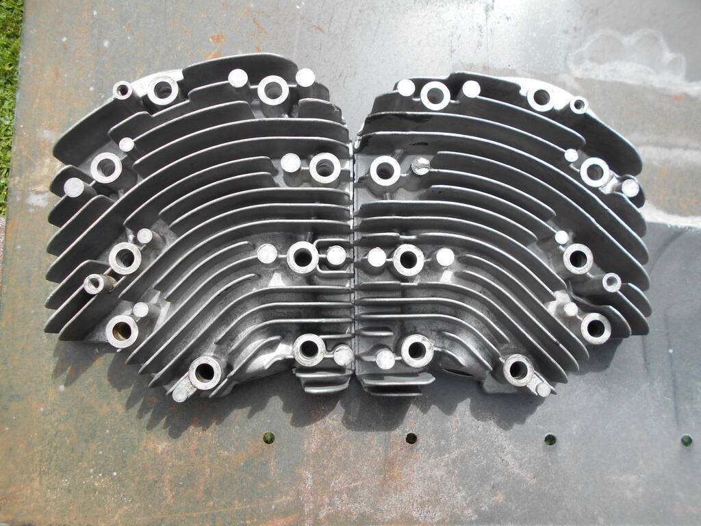

cleat 9,266 #90 Posted June 15, 2024 Decided to try soda blasting the heads clean. This is the home made soda blaster built from a blow gun and a piece of hose. I just used old expired baking soda. Pressure used. Around 50 PSI Soda blast work area. One head complete. Both heads complete. It took both boxes that were around 3/4 full each. Wire brushed the inside of the heads. 4 Share this post Link to post Share on other sites

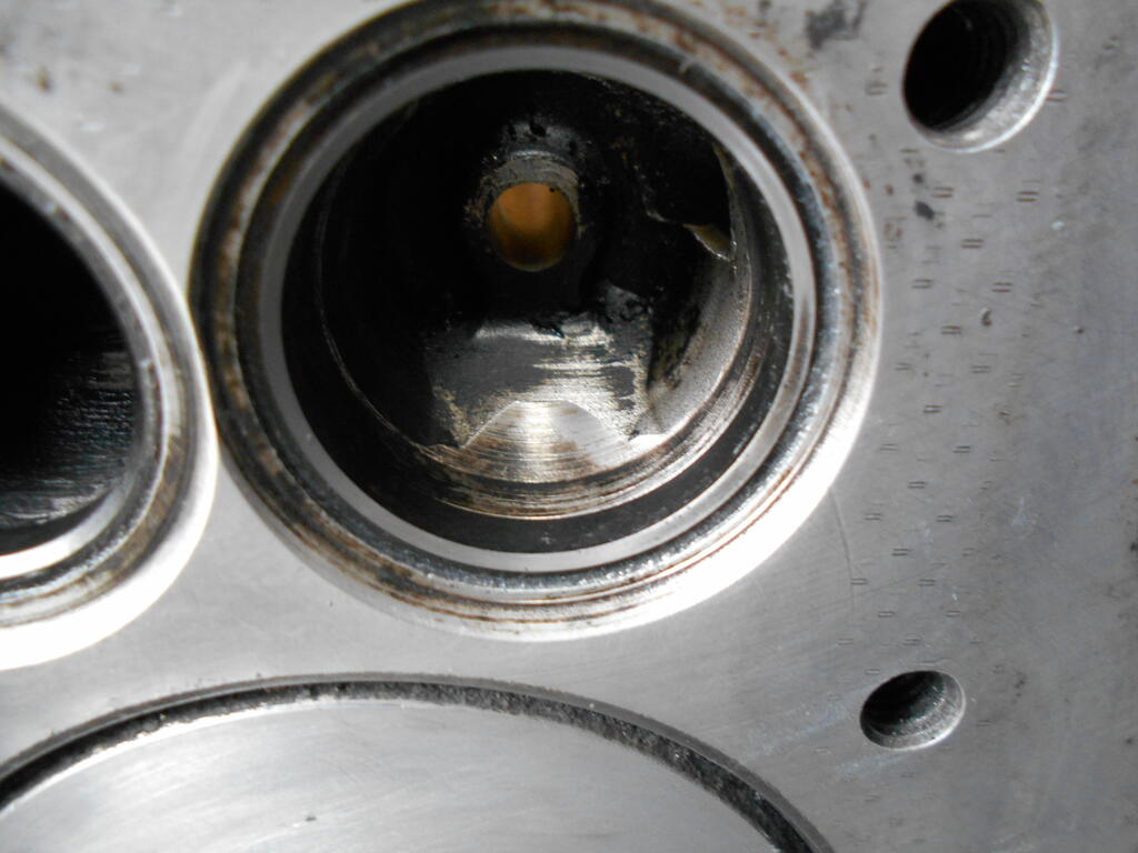

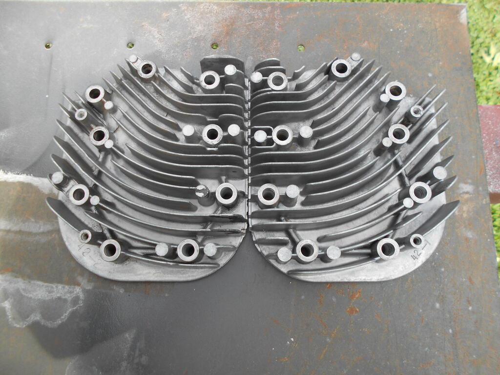

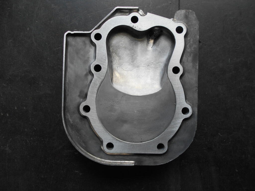

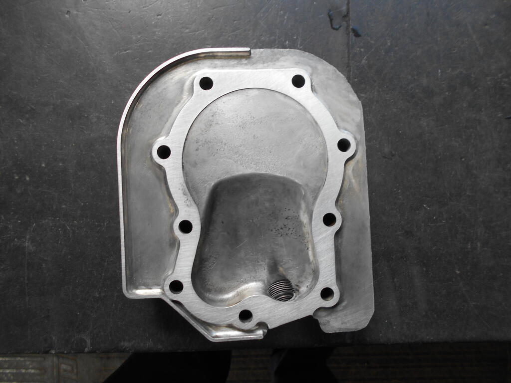

cleat 9,266 #91 Posted June 15, 2024 Heads sanded flat. Cyl #1 head was fairly flat and did not rock around on block. Cyl #2 head rocked on the block and took a lot of sanding to sit flat and also to get an even finish when sanding. Sits and looks good now. 2 1 Share this post Link to post Share on other sites
cleat 9,266 #92 Posted June 15, 2024 Heads loosely installed onto block as I don't have gaskets yet. 1 3 Share this post Link to post Share on other sites
cleat 9,266 #93 Posted June 16, 2024 Starter installed and torqued. Valve covers loosely installed with no gaskets. 4 1 Share this post Link to post Share on other sites

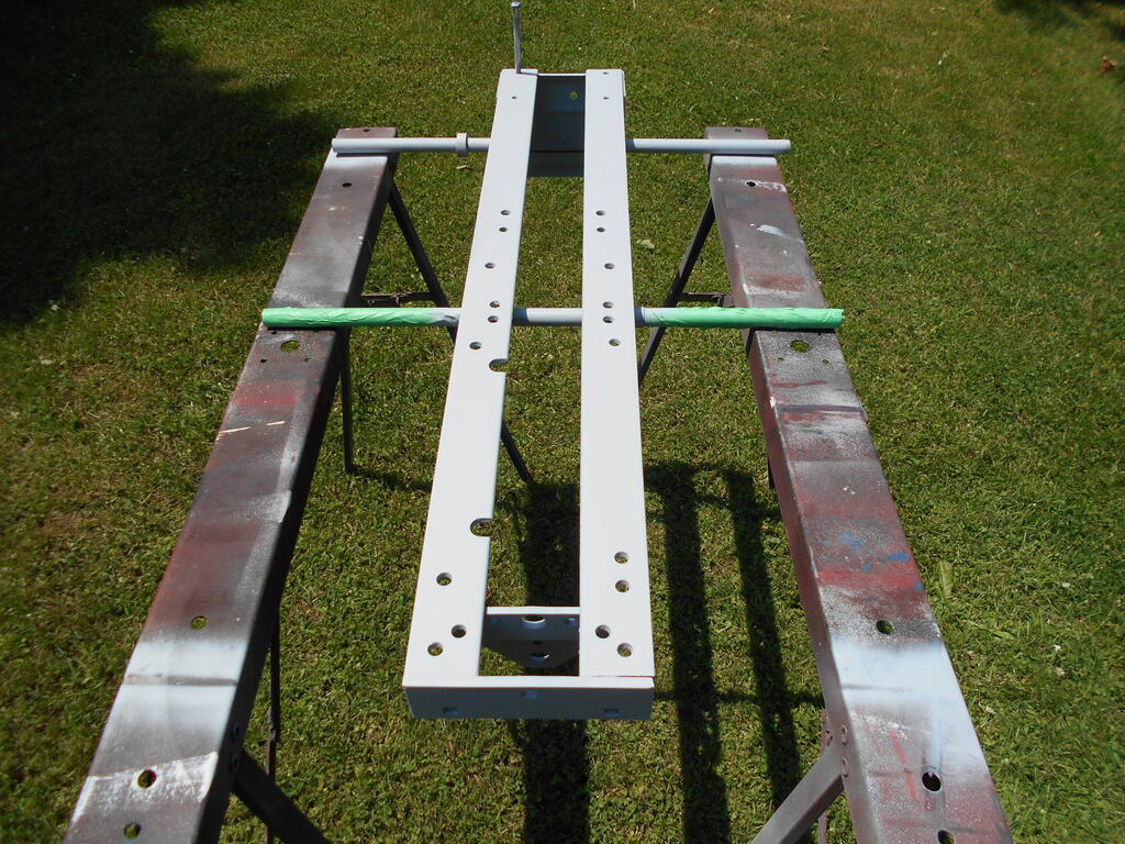

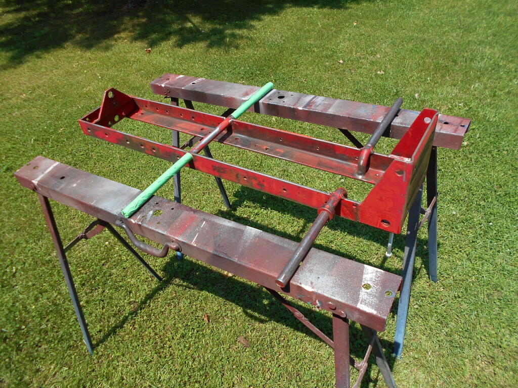

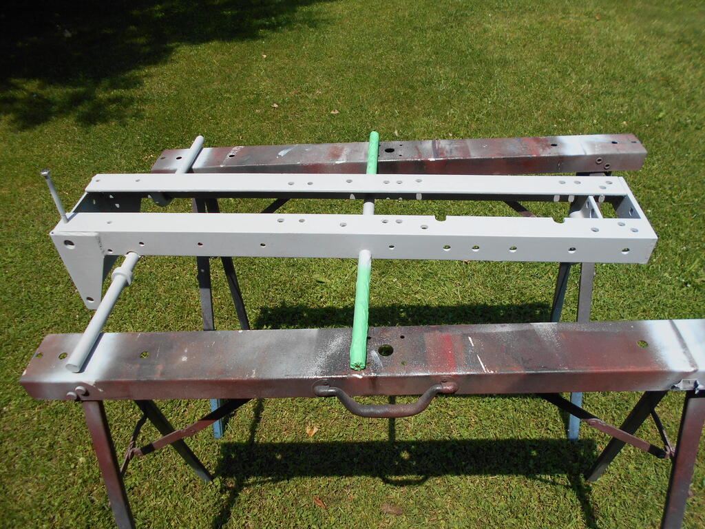

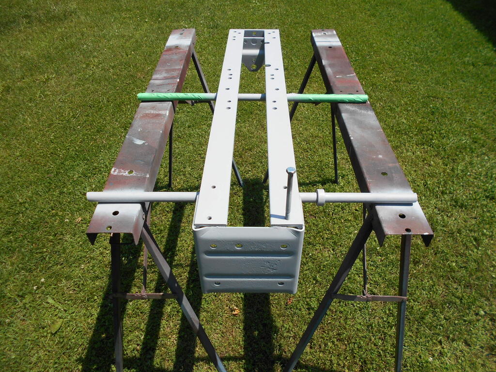

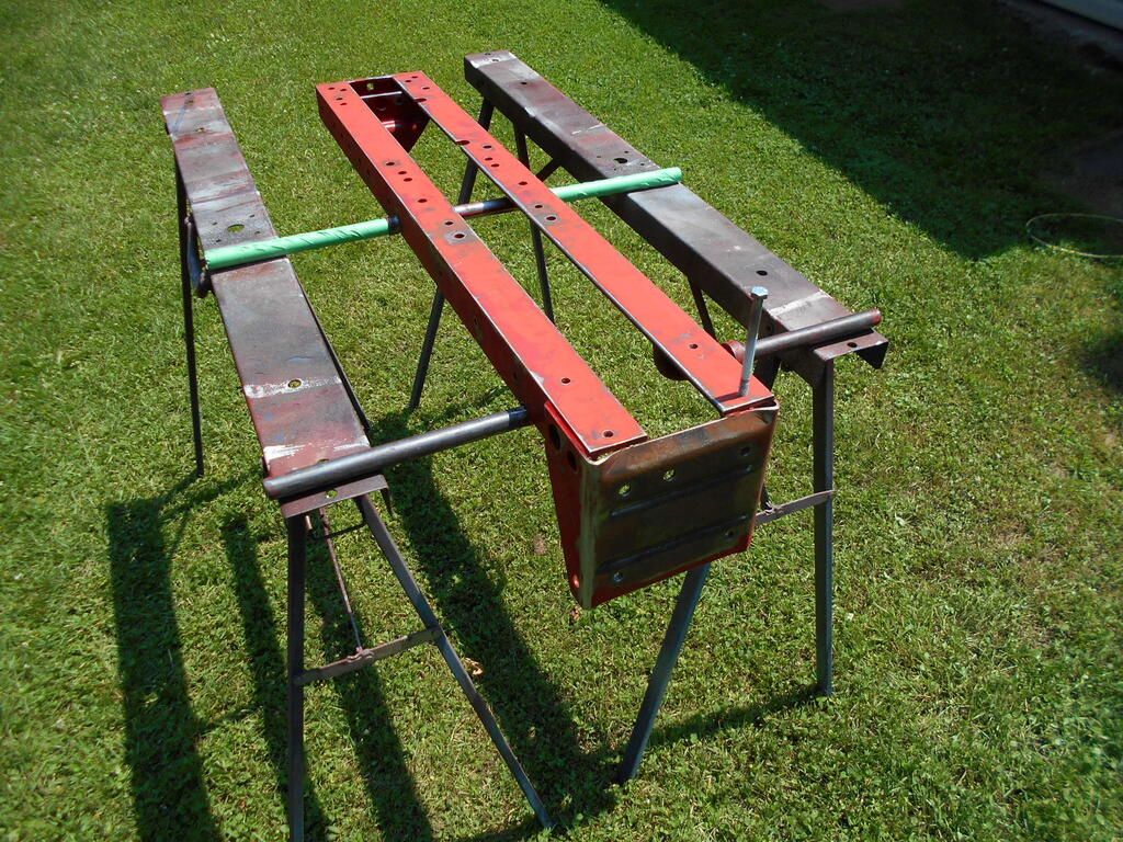

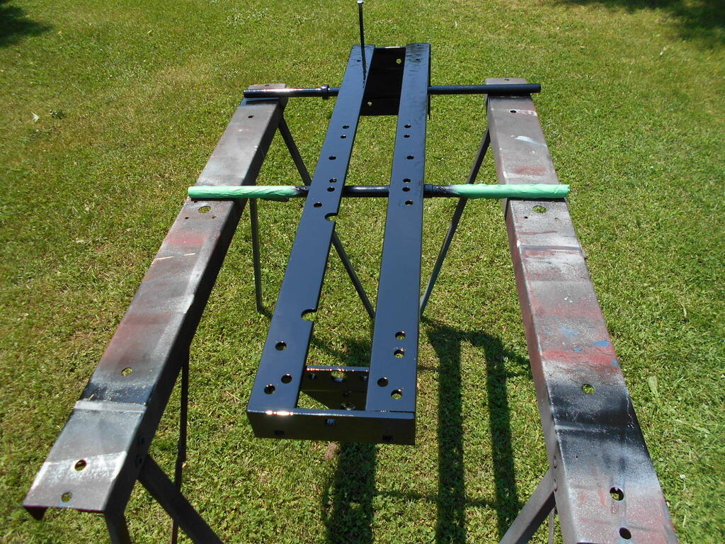

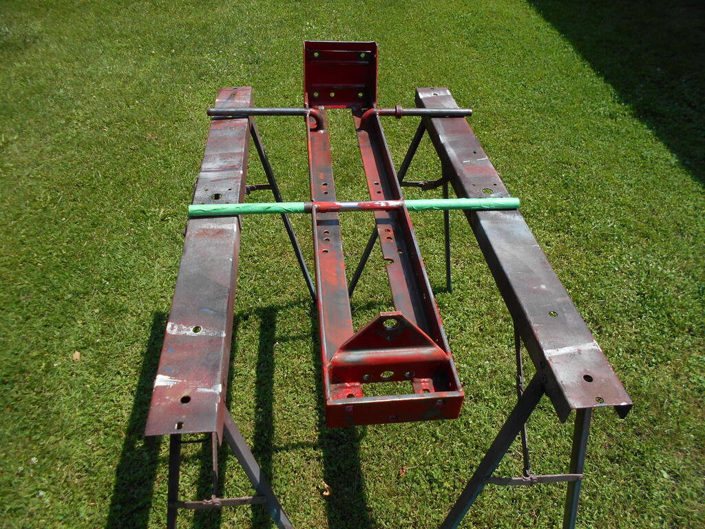

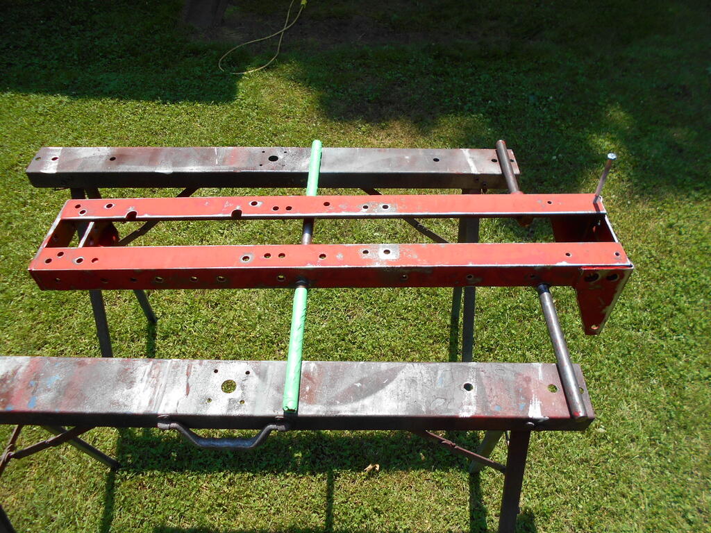

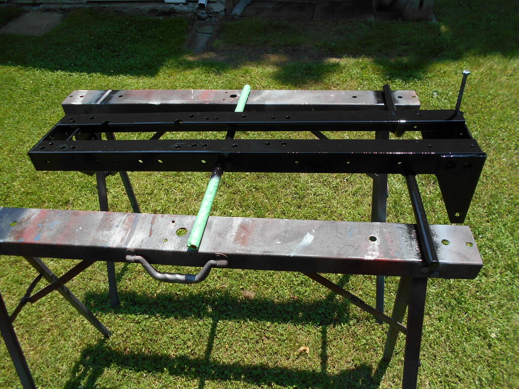

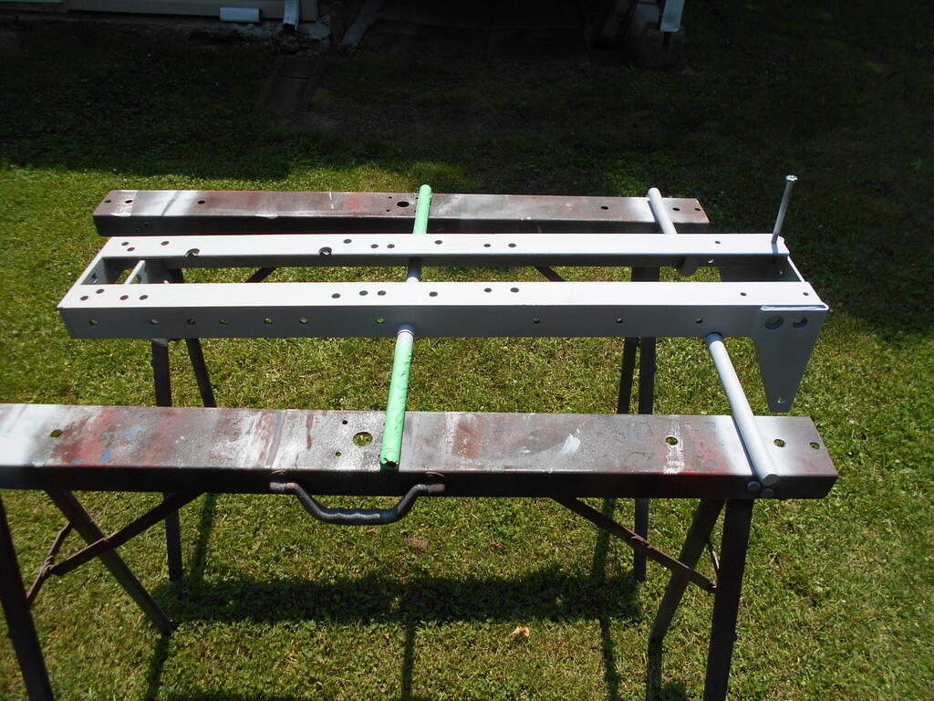

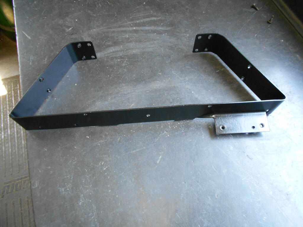

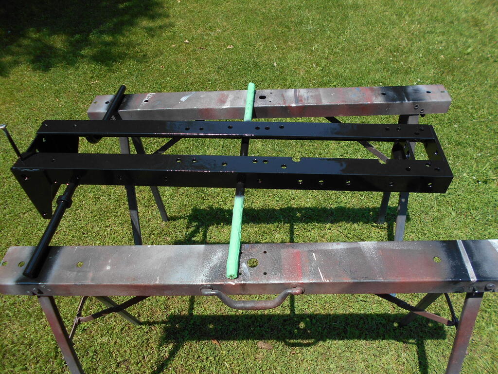

cleat 9,266 #94 Posted June 17, 2024 Frame wire brushed and sanded. Frame primed. 4 2 Share this post Link to post Share on other sites

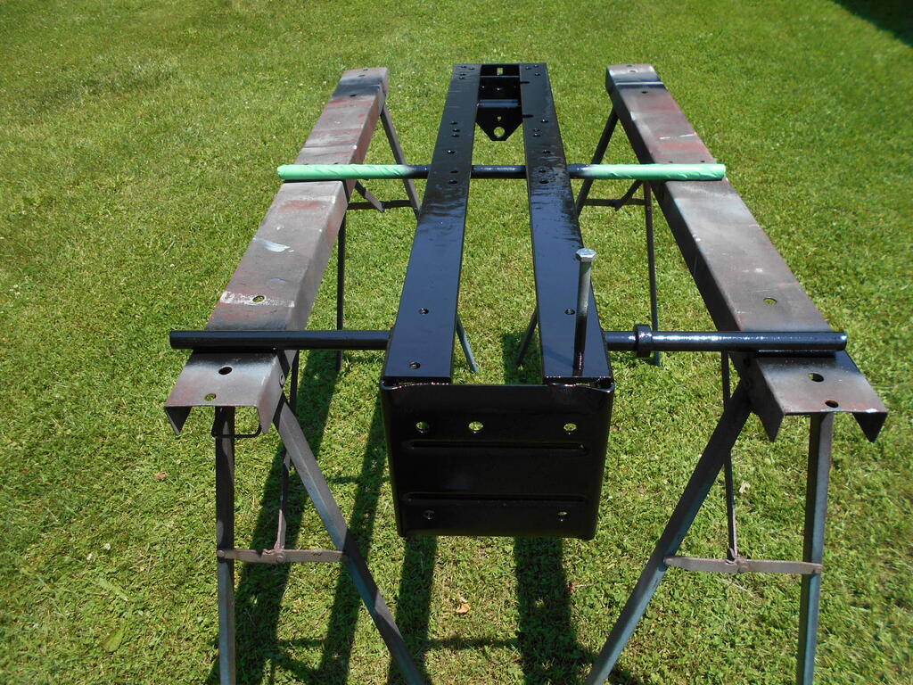

cleat 9,266 #95 Posted June 17, 2024 Frame painted. 5 3 Share this post Link to post Share on other sites
ebinmaine 80,426 #96 Posted June 17, 2024 On 6/15/2024 at 10:33 AM, cleat said: Decided to try soda blasting the heads clean. This is the home made soda blaster built from a blow gun and a piece of hose. Is that as ridiculously simple as it looks? 1 Share this post Link to post Share on other sites
cleat 9,266 #97 Posted June 17, 2024 (edited) Yes, it worked well for a couple of small parts. Just had to keep wiggling the black hose around in the baking soda to keep it flowing. Edited June 17, 2024 by cleat 1 1 Share this post Link to post Share on other sites

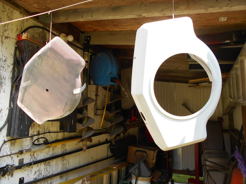

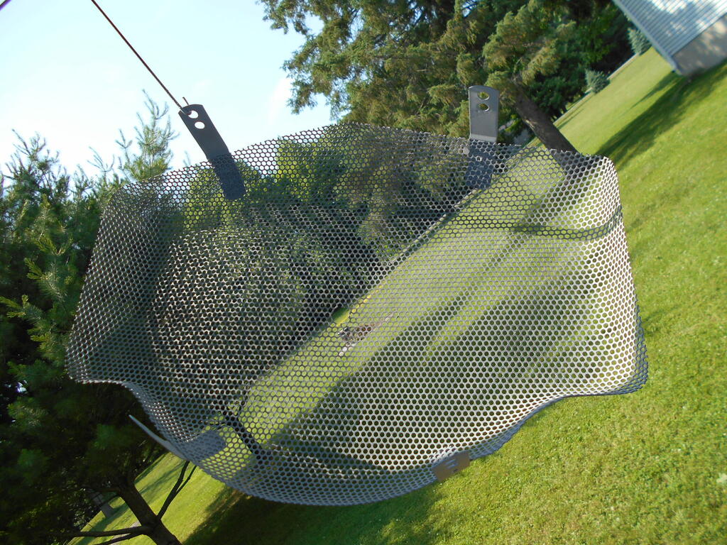

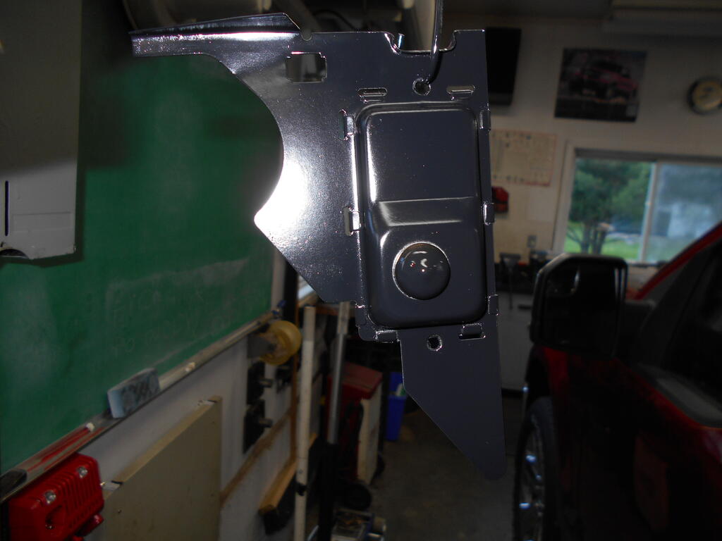

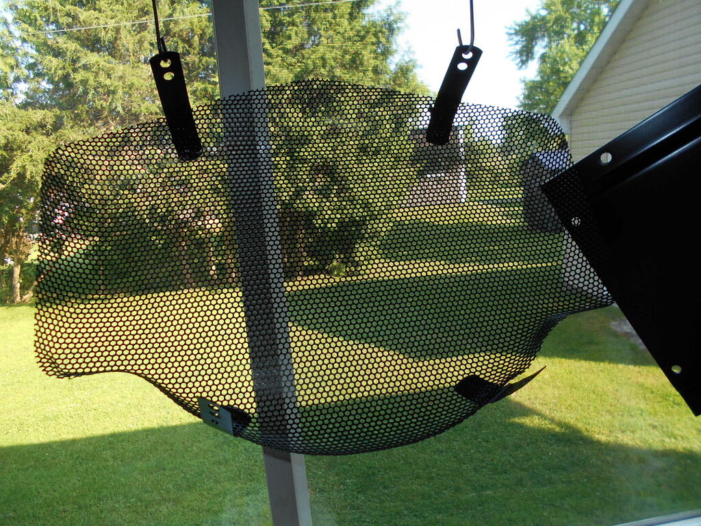

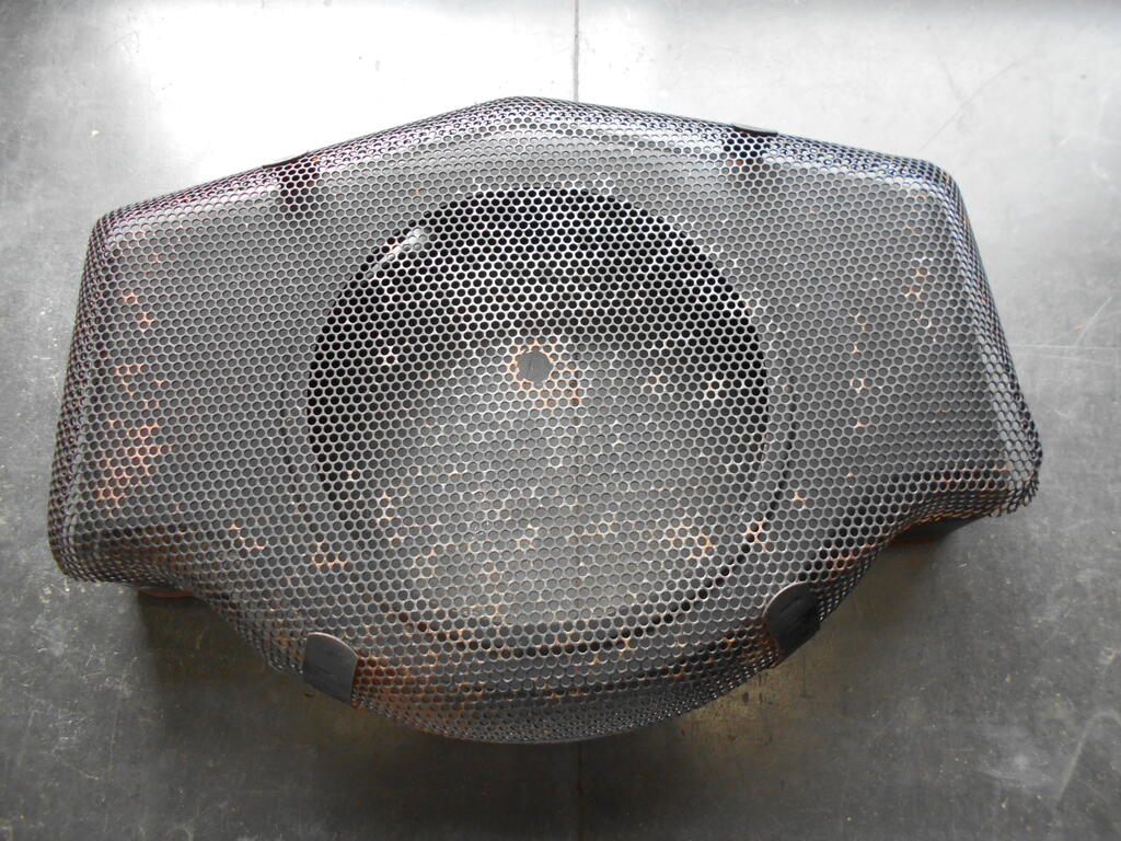

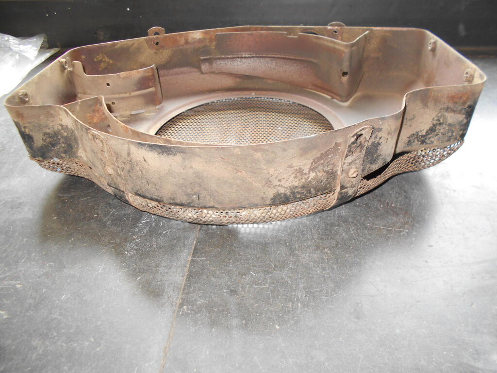

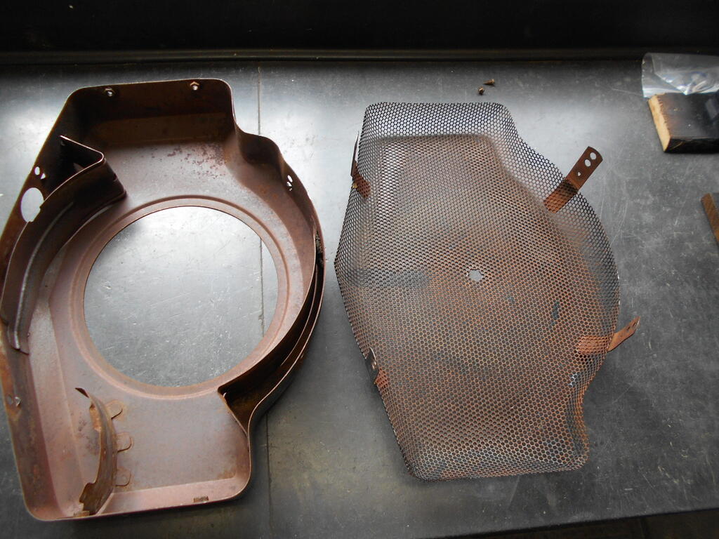

cleat 9,266 #98 Posted June 18, 2024 Blower housing and static guard as removed. Blower housing and static guard washed. 3 1 Share this post Link to post Share on other sites

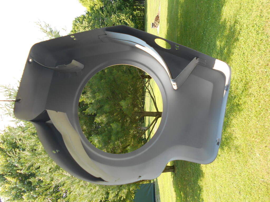

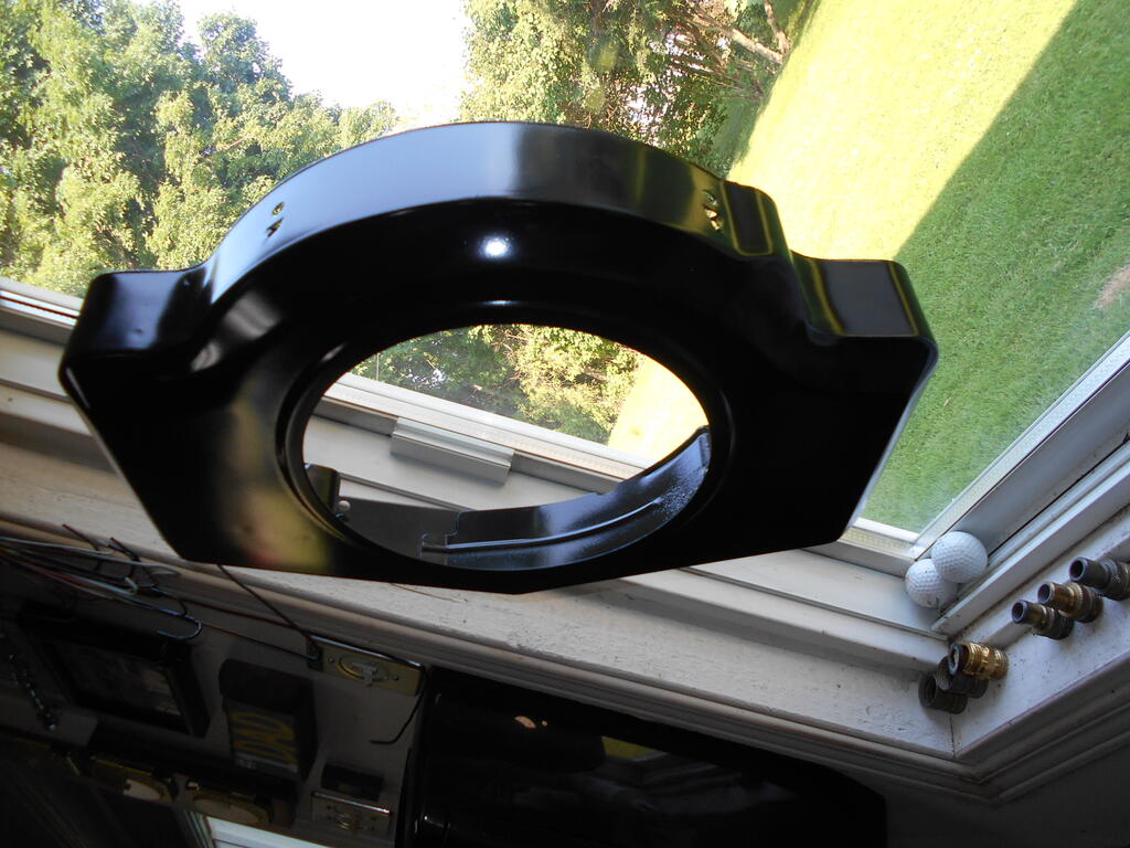

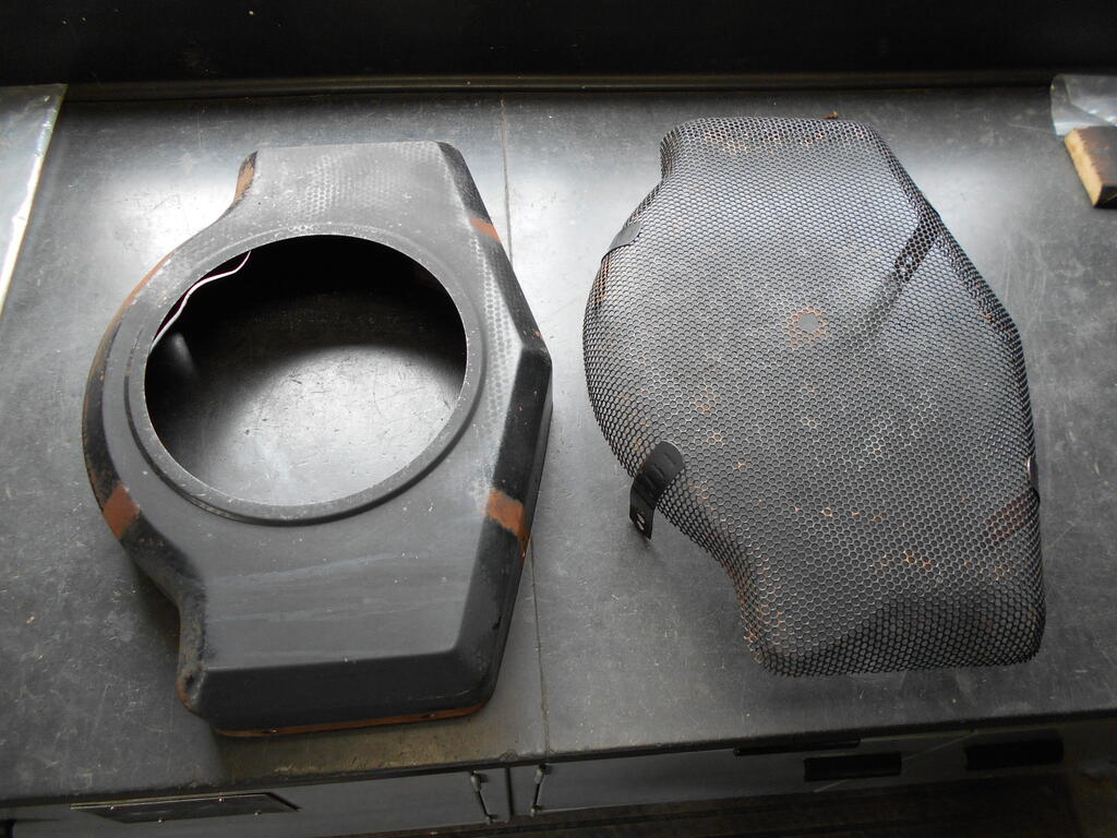

cleat 9,266 #99 Posted June 18, 2024 Blower housing and static guard bead blasted, primed and painted. It is currently 30 with a heat index of 40 degrees C (86 with a heat index of 104 degrees F) and we are not used to that here so it makes work a little harder. Good thing is the paint dries quick. 2 1 Share this post Link to post Share on other sites
cleat 9,266 #100 Posted June 18, 2024 Blower housing and static guard painted semi-gloss black. Not the best pictures, I will get better ones when the paint dries more. + 3 2 Share this post Link to post Share on other sites
