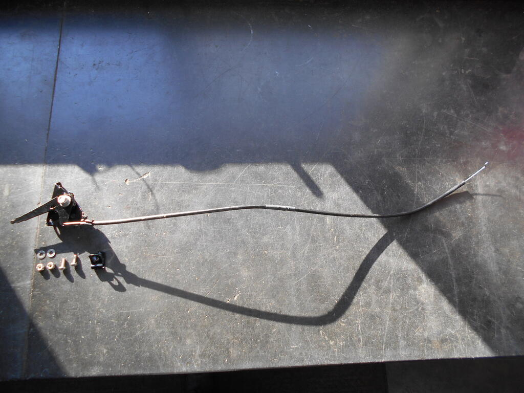

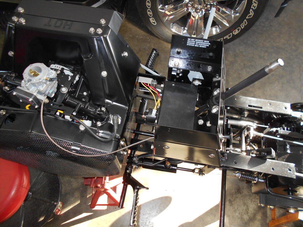

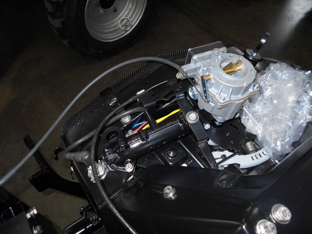

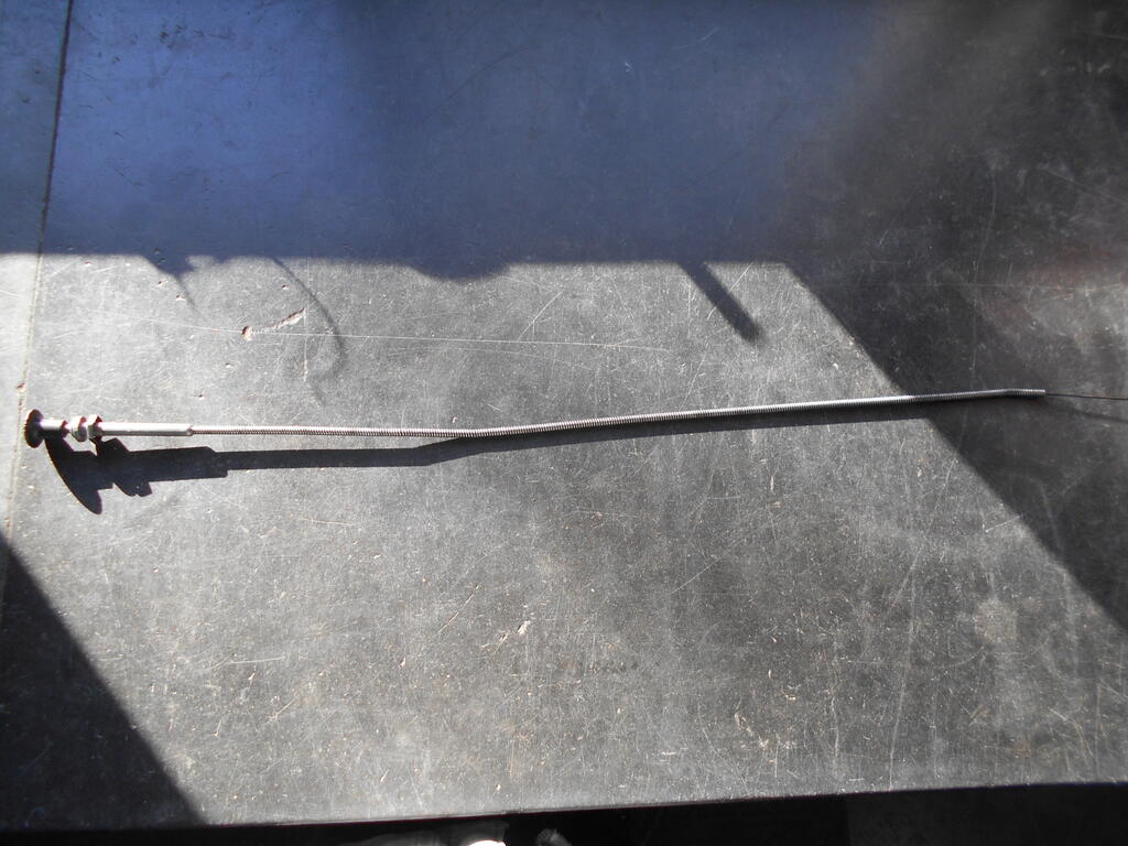

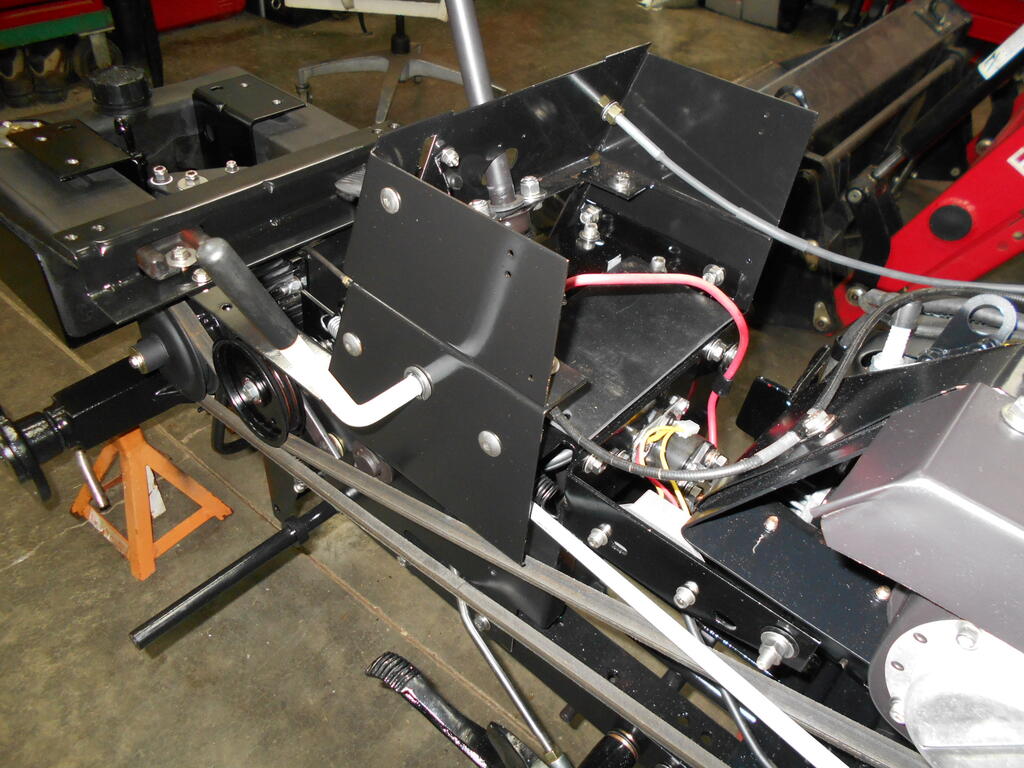

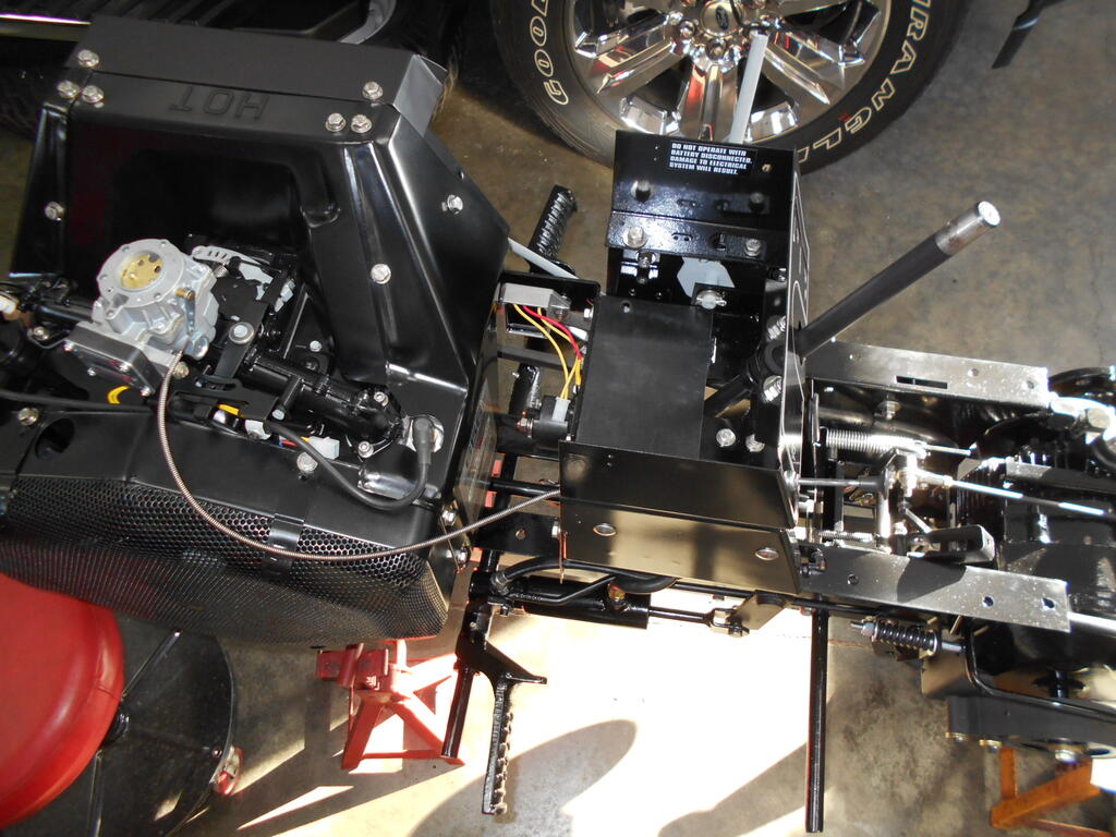

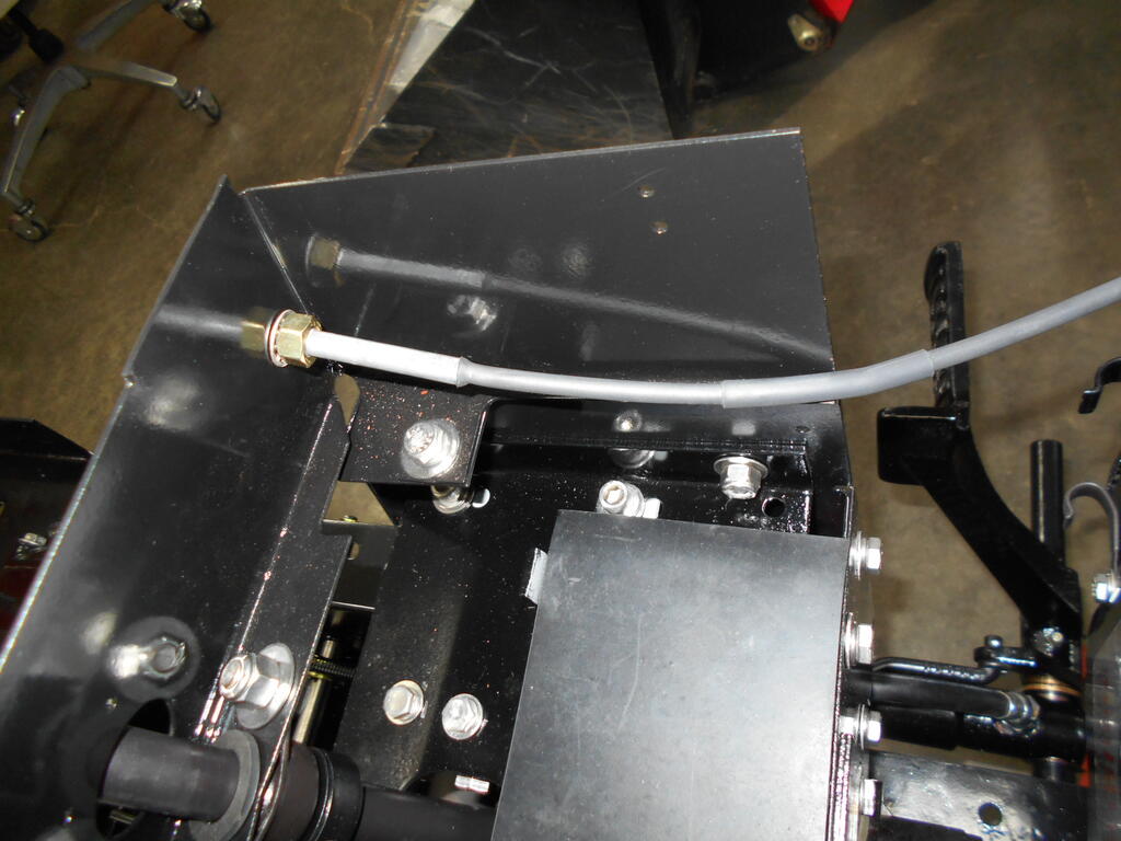

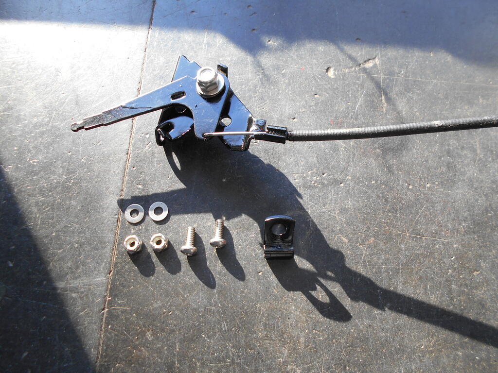

cleat 9,389 #326 Posted December 14, 2024 Choke cable ready to install. Choke cable mounting nut tightened. Choke cable installed choke open. Choke cable installed choke closed. 4 Share this post Link to post Share on other sites

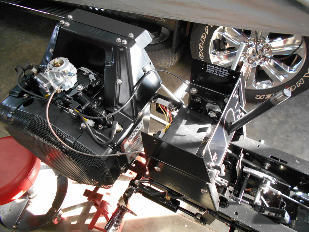

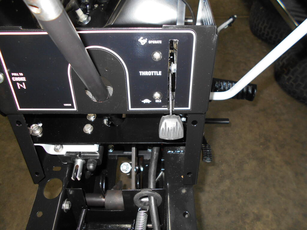

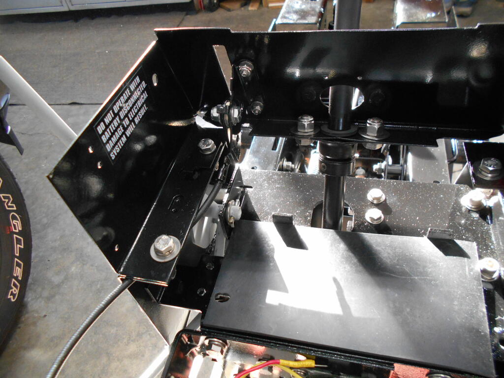

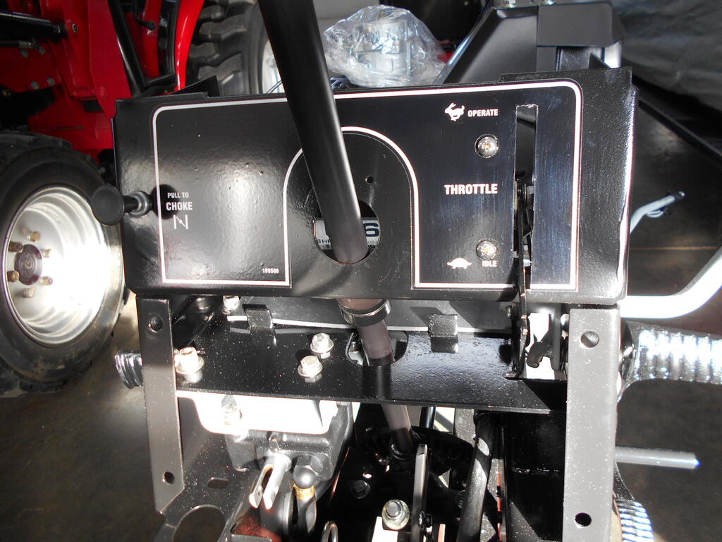

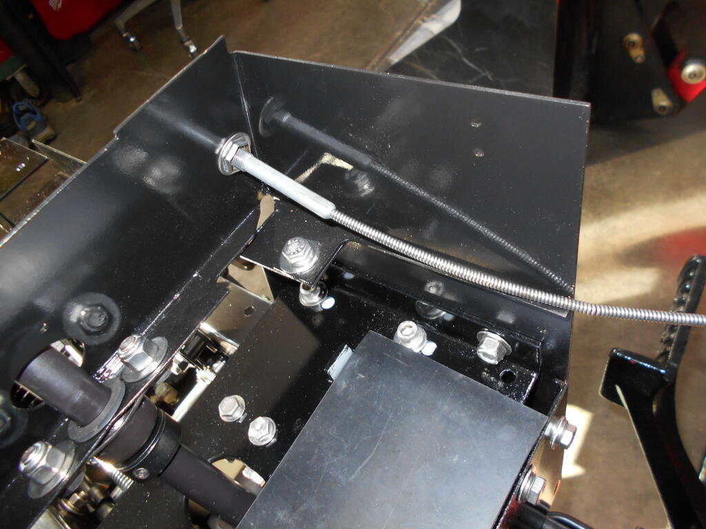

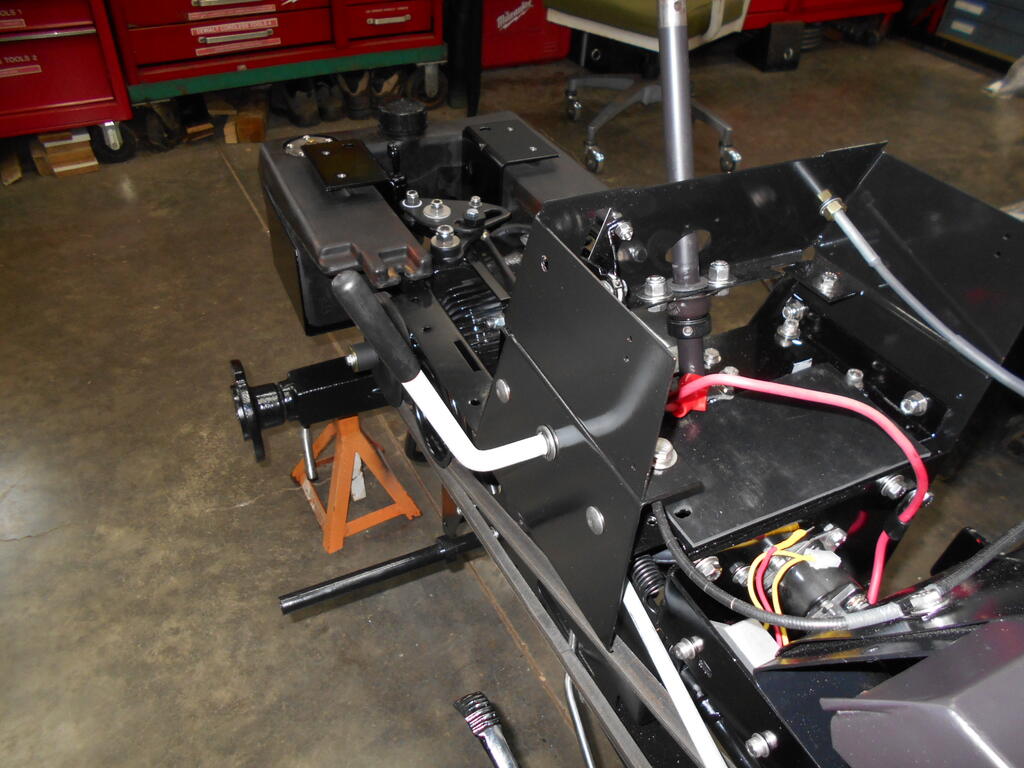

cleat 9,389 #327 Posted December 14, 2024 Throttle cable ready to be installed. Tension bolt tightened to hopefully the proper amount. Throttle cable installed. Dash showing throttle and choke cables installed. I will install the throttle knob later. 4 Share this post Link to post Share on other sites

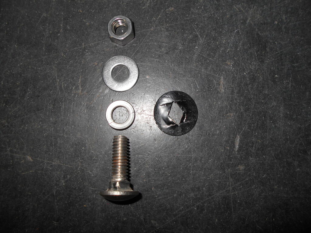

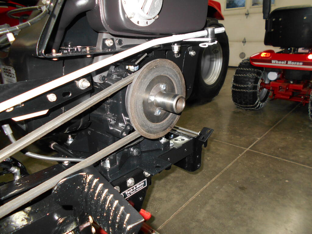

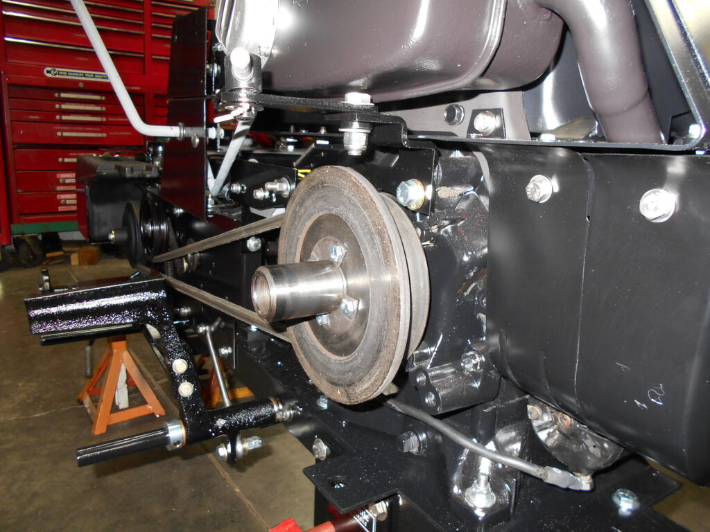

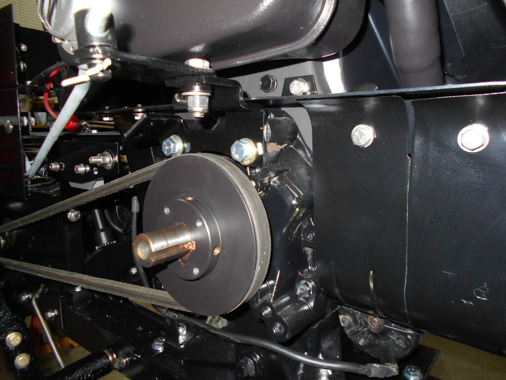

cleat 9,389 #328 Posted December 15, 2024 Belt guard upper bolt, push nut, washer, lockwasher, nut ready to install. Belt guard upper bolt installed and held in place by push nut. 2 Share this post Link to post Share on other sites
cleat 9,389 #329 Posted December 15, 2024 Throttle knob installed. 3 Share this post Link to post Share on other sites

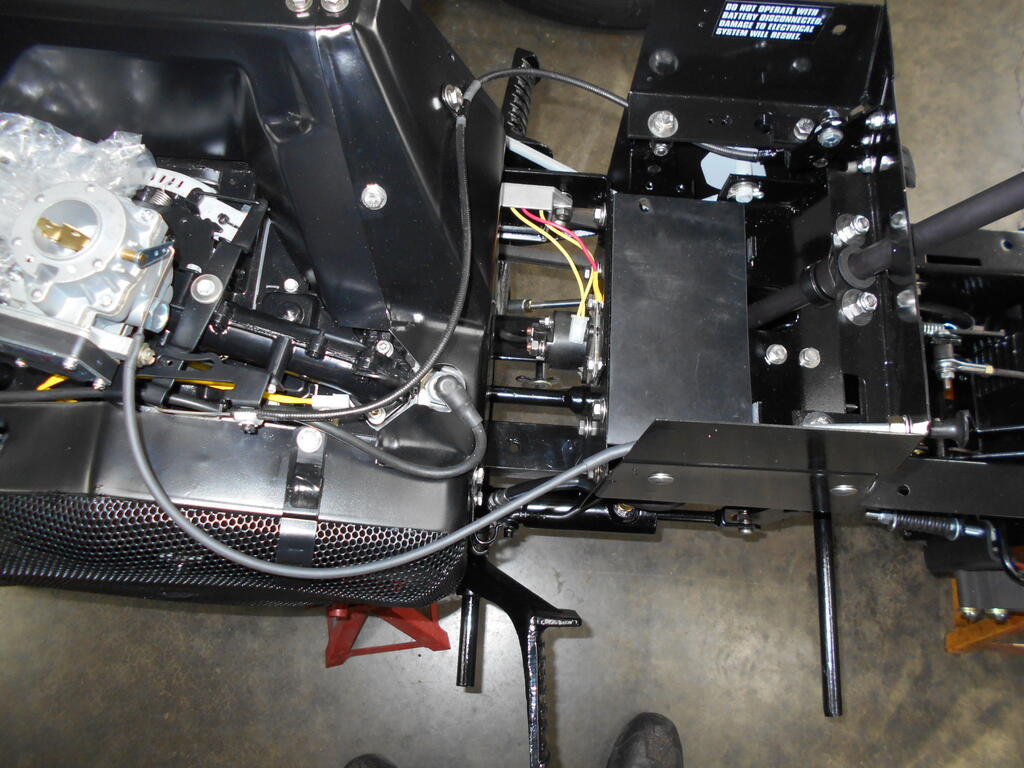

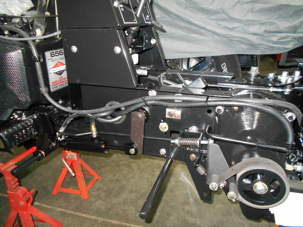

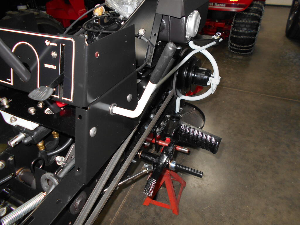

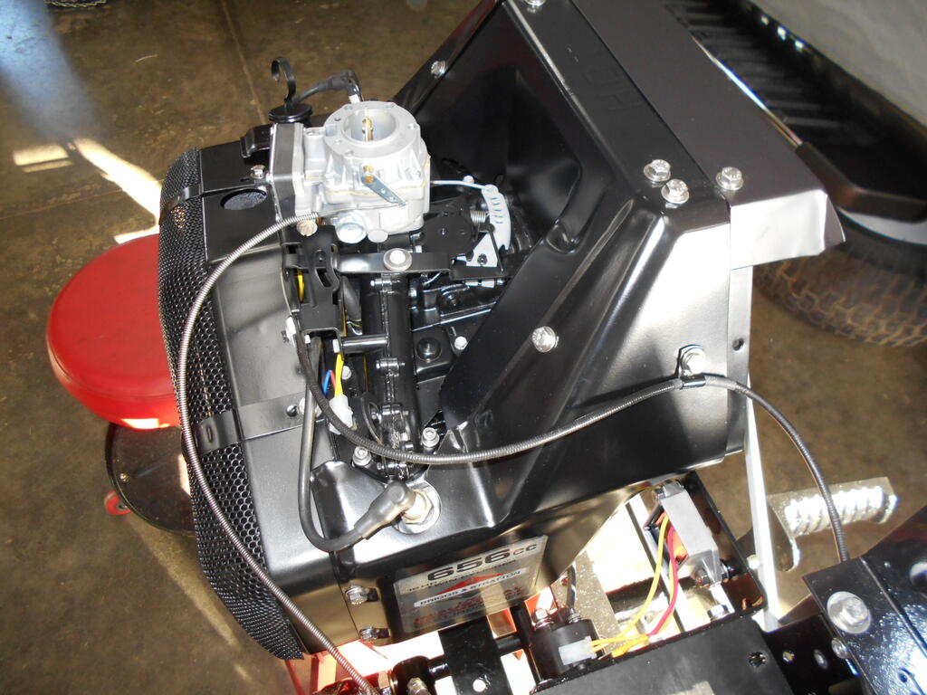

cleat 9,389 #330 Posted December 15, 2024 I pulled and covered the choke cable with a protective sheath of thick walled heat shrink tubing. Thanks to Bill D for this suggestion. I added a couple of layers of heat shrink where cable rubs the hood stand for protection. Also installed a better nut and a star washer also suggested by Bill D. A piece of smaller thin walled heat shrink used to help seal the open end of the cable. 3 2 Share this post Link to post Share on other sites

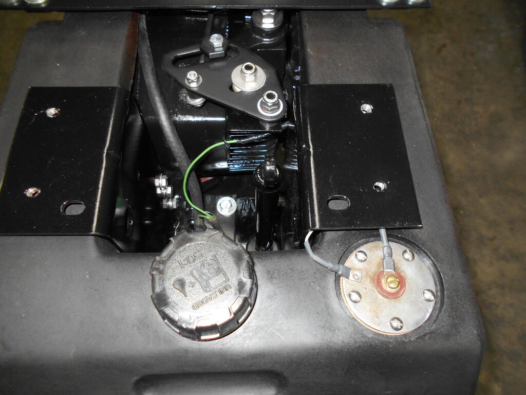

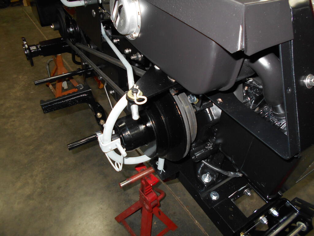

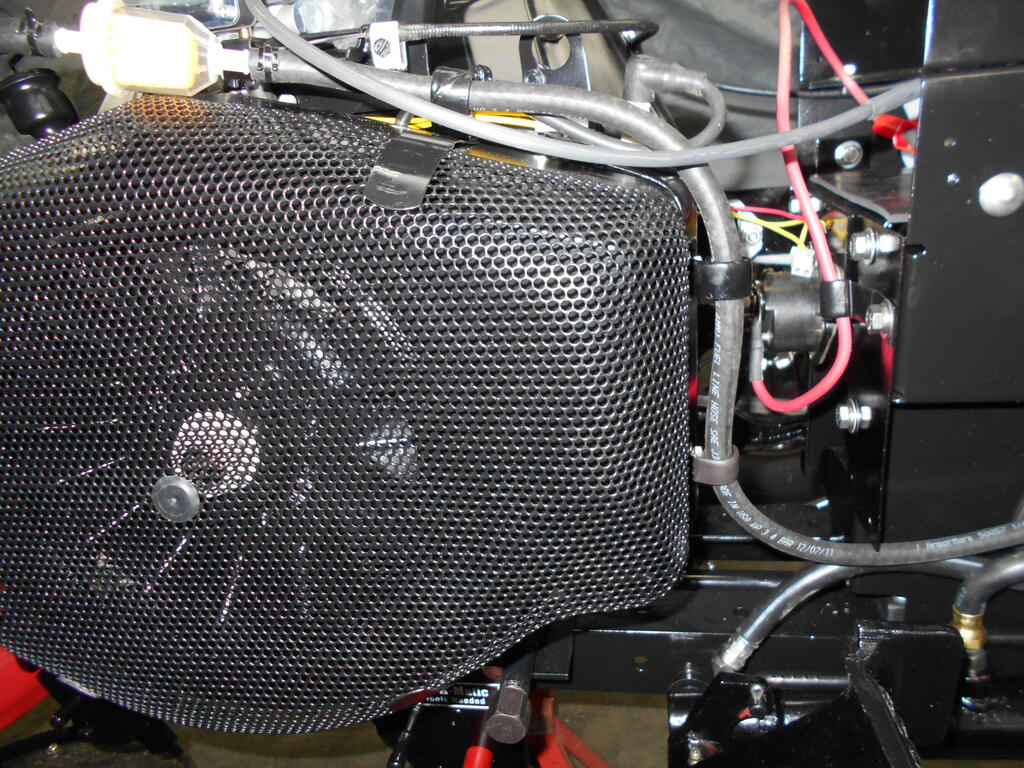

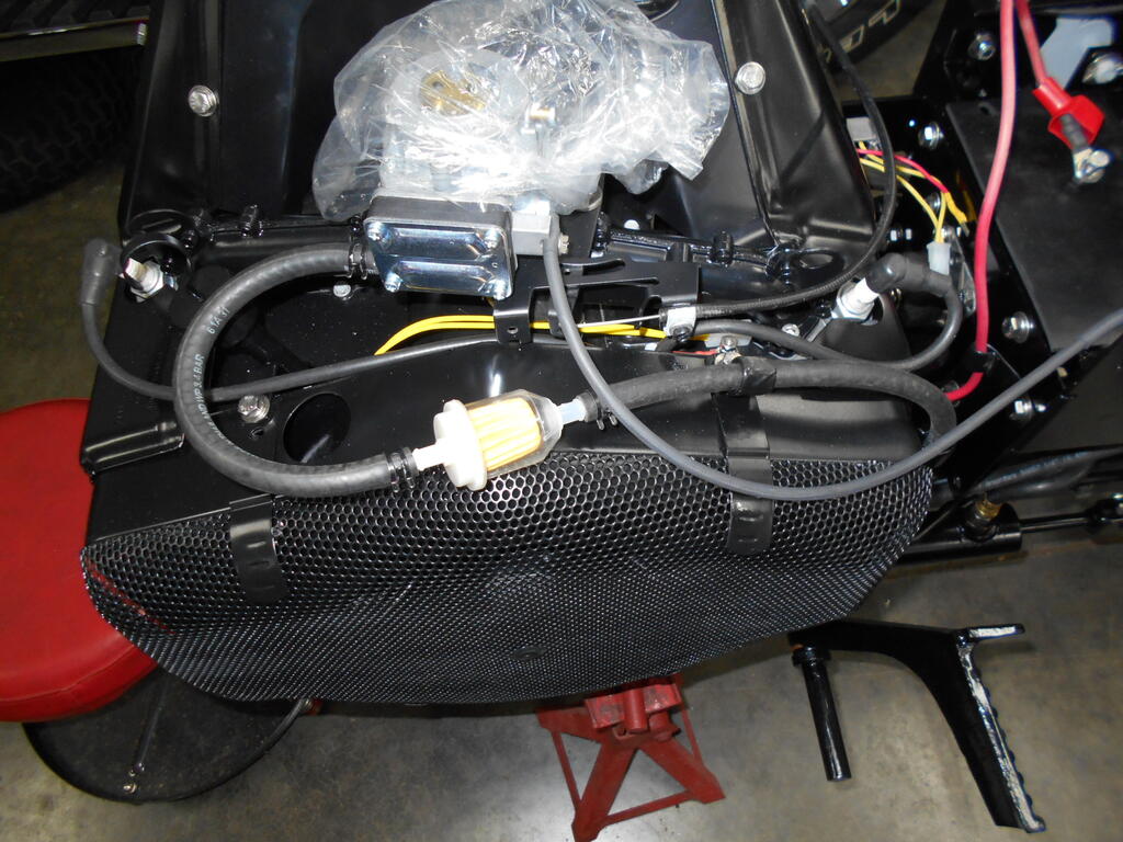

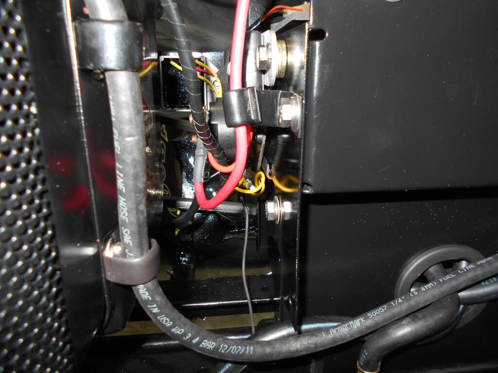

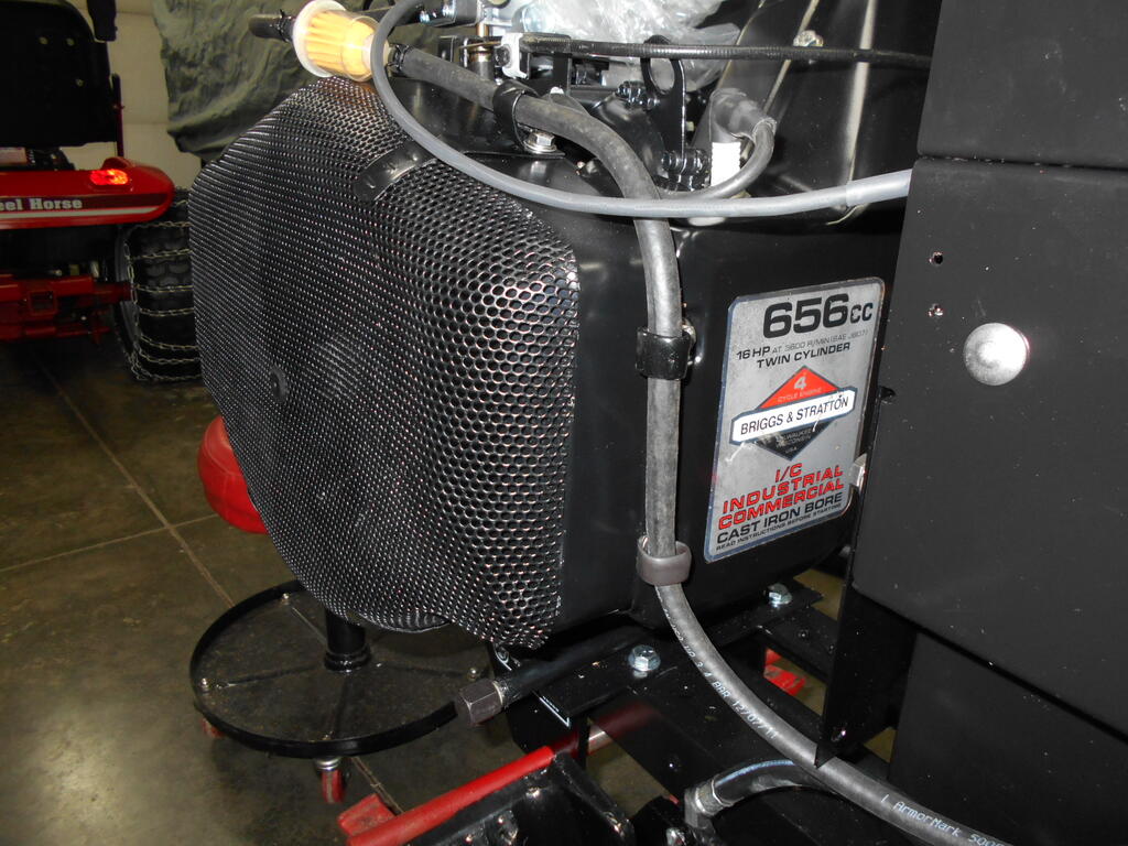

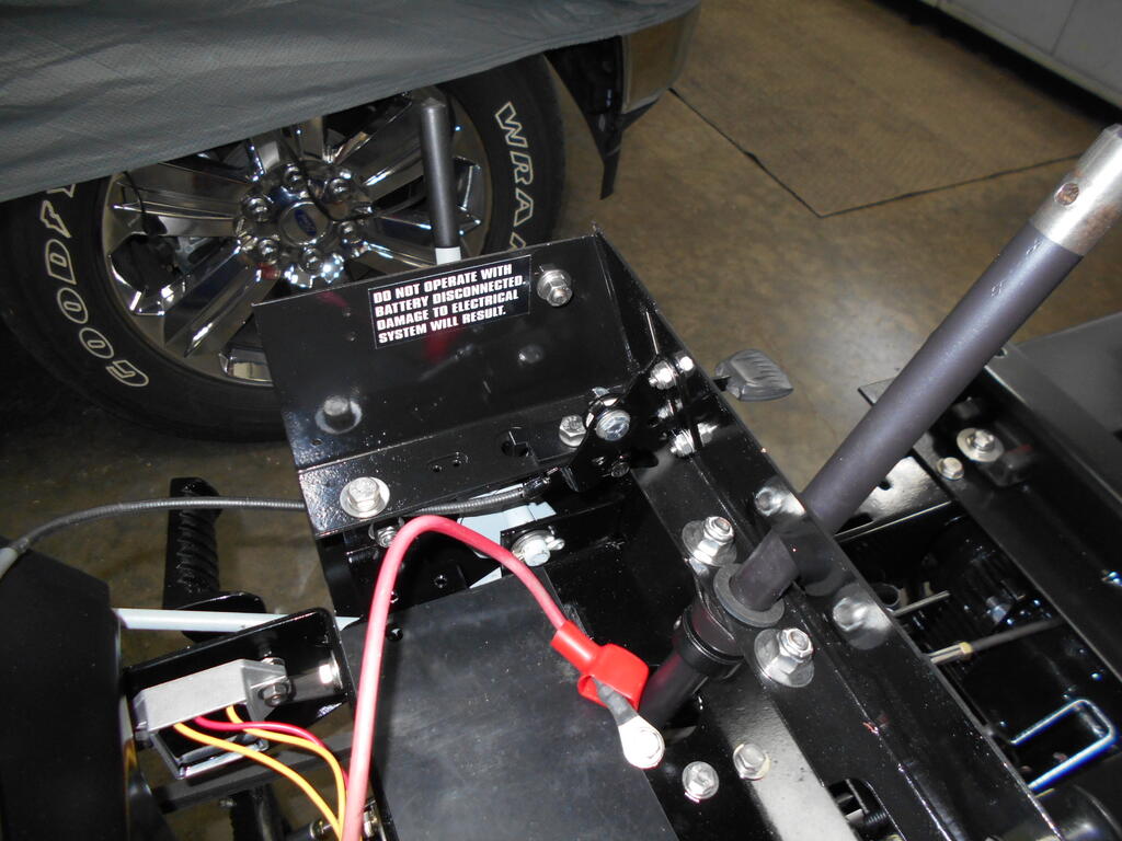

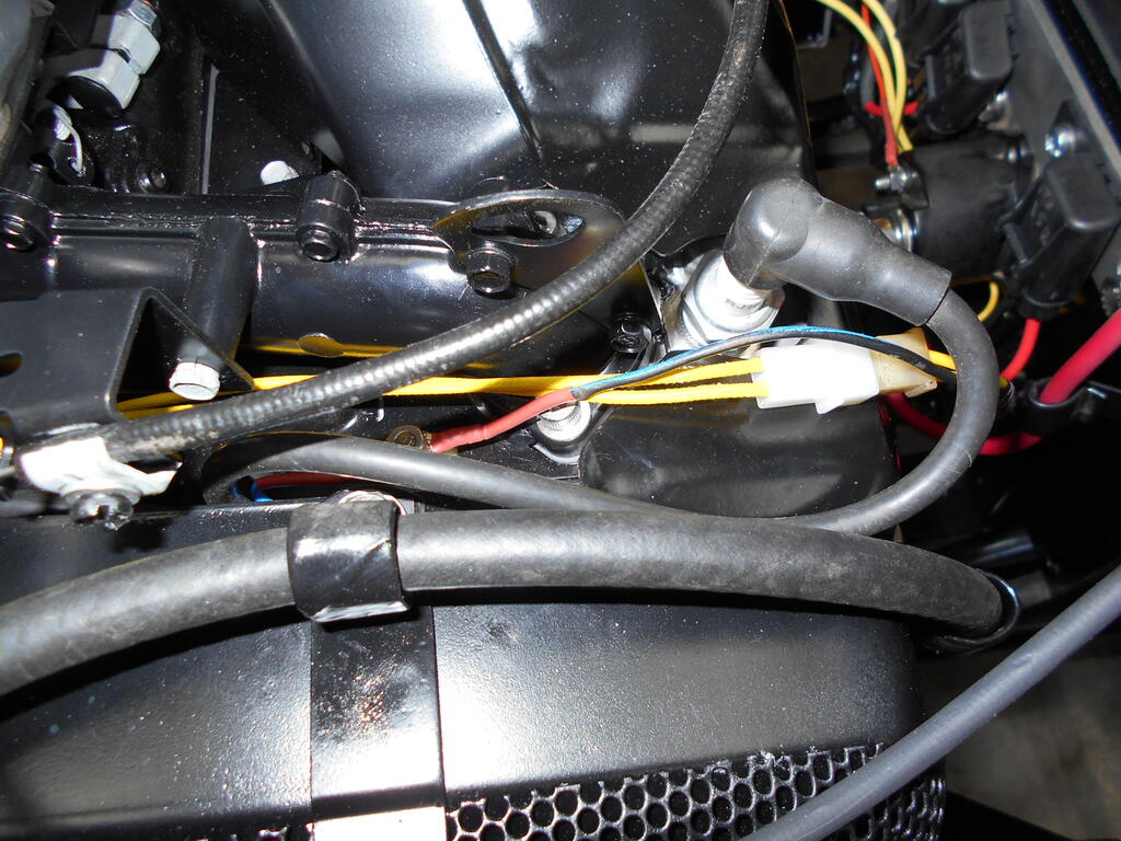

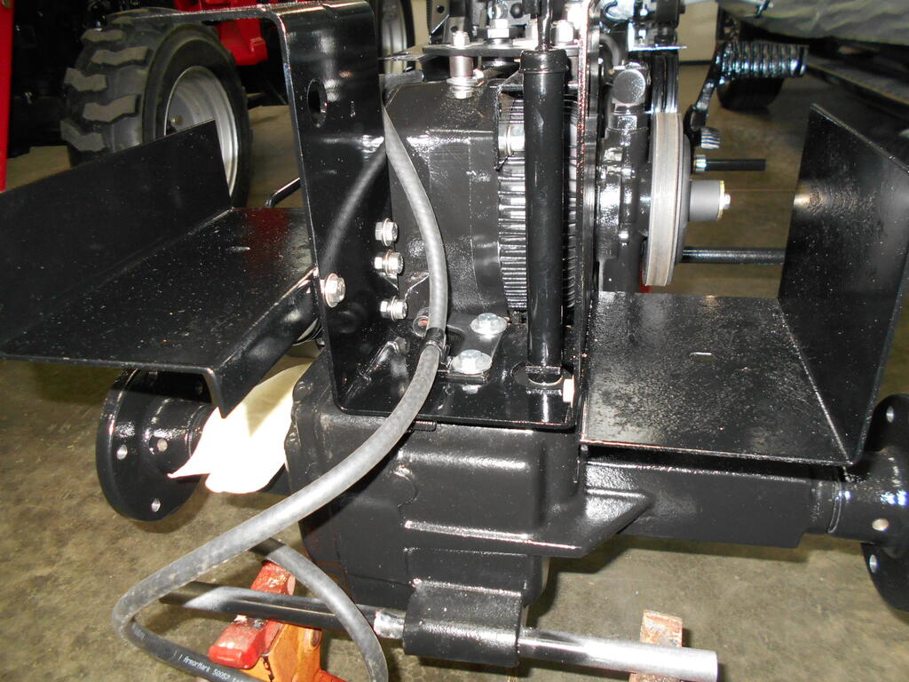

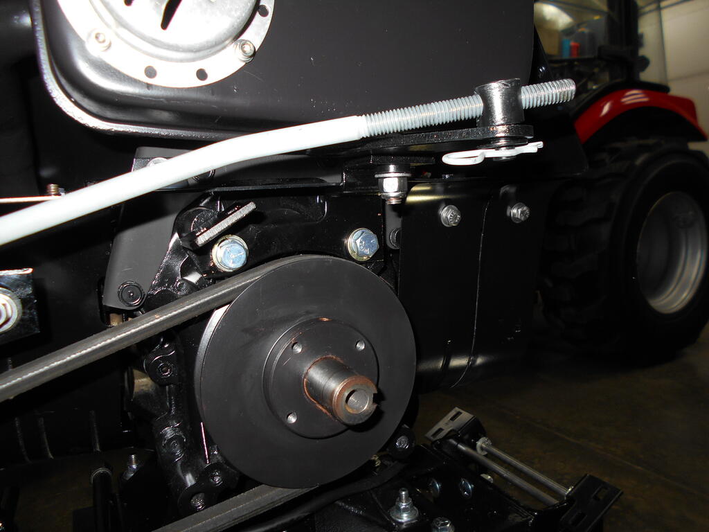

cleat 9,389 #332 Posted December 16, 2024 Fuel hose installed. I used plenty of clips to hold it in place and space it out slightly from the engine to help with heat soak issues. 5 1 Share this post Link to post Share on other sites

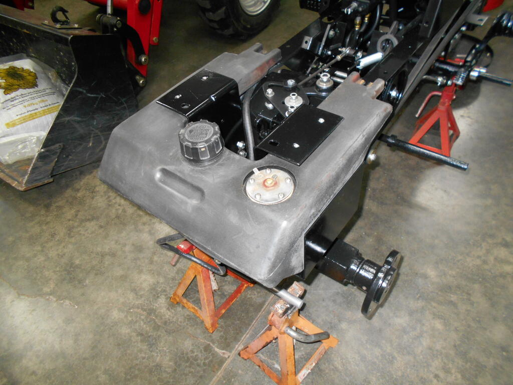

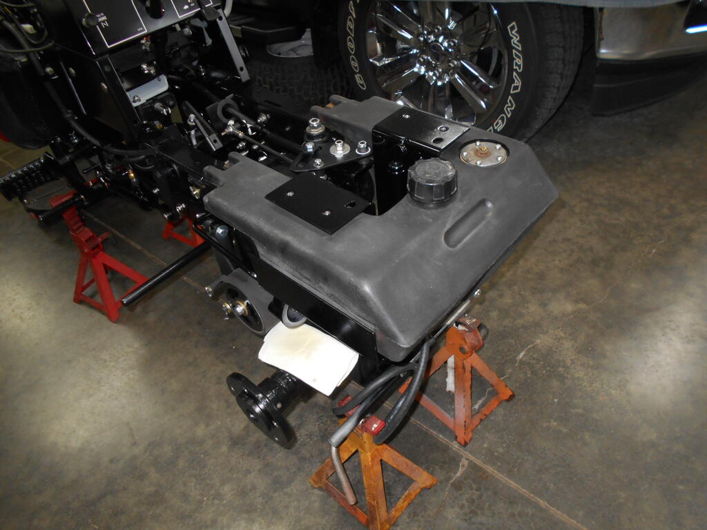

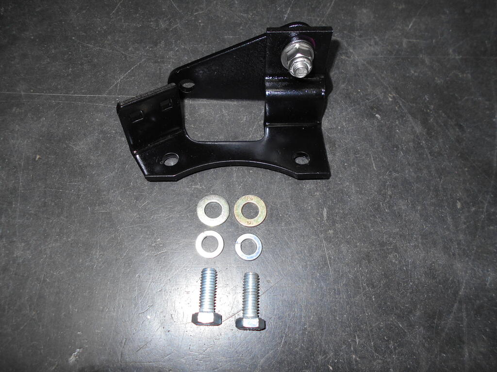

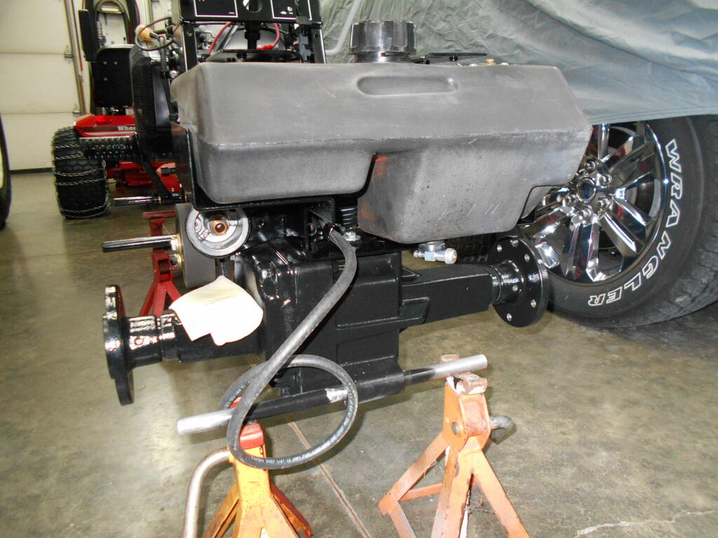

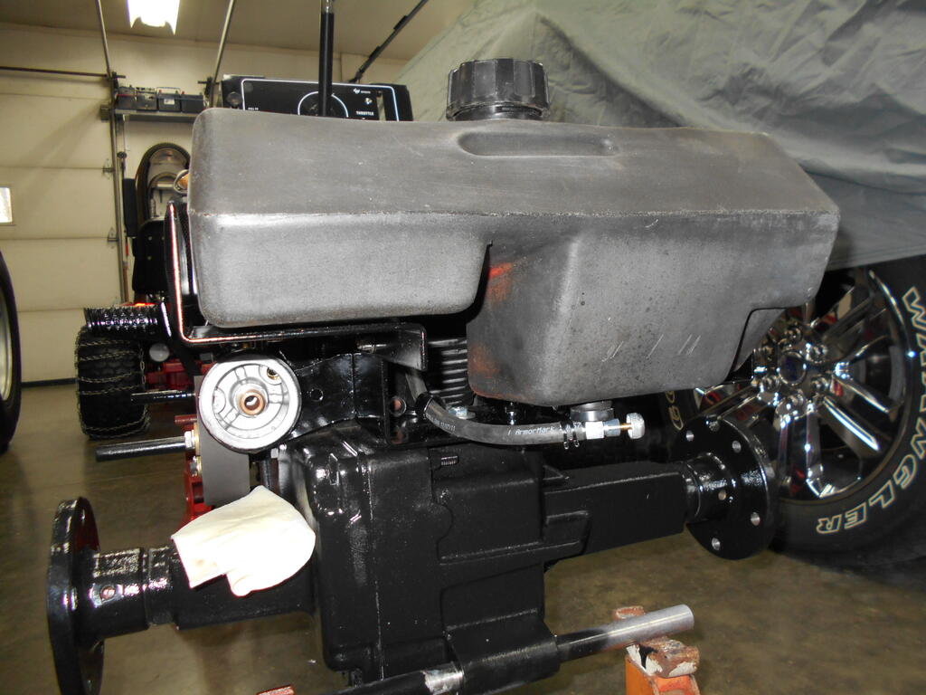

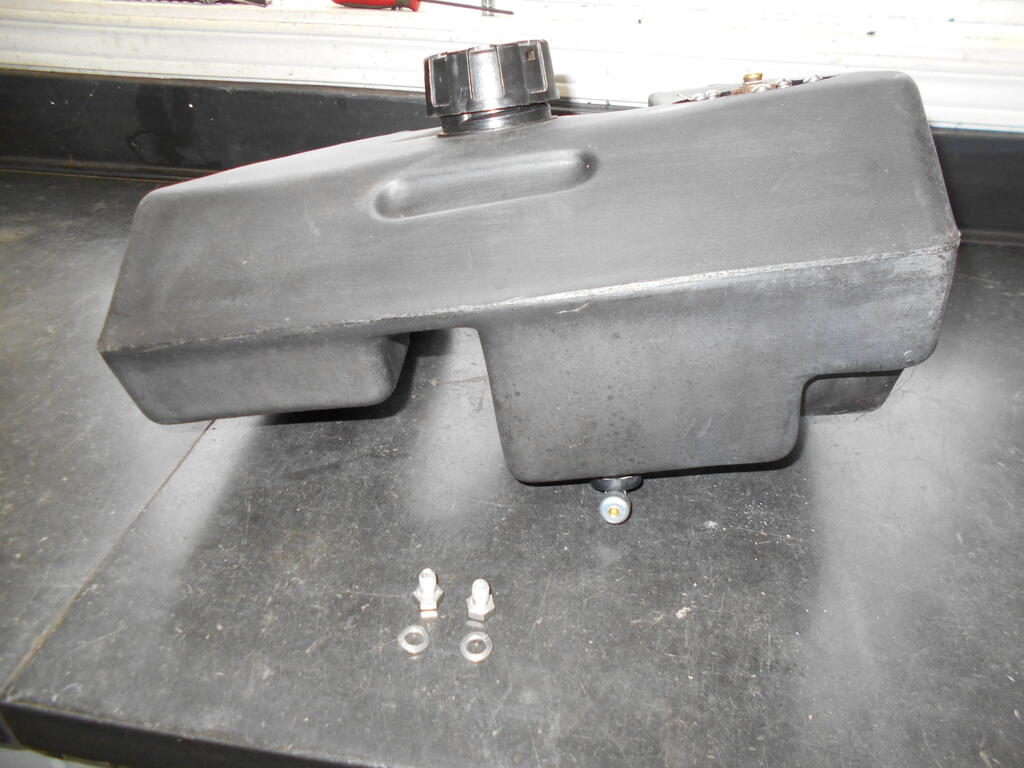

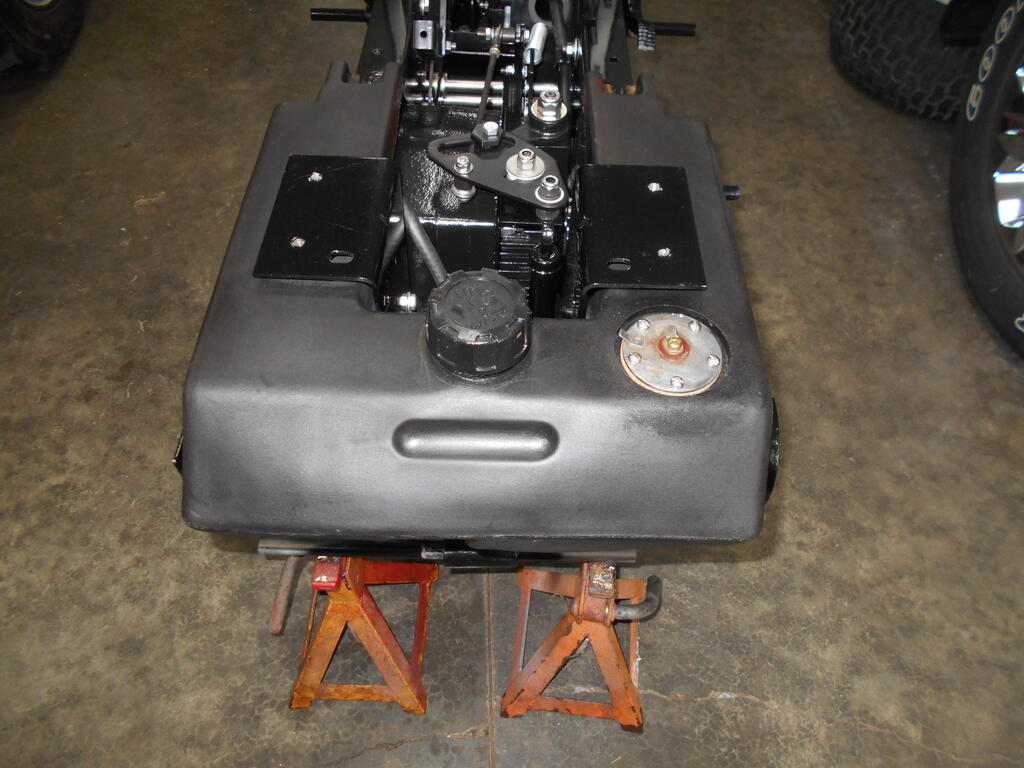

cleat 9,389 #333 Posted December 16, 2024 (edited) Fuel tank ready to install. Bolts shown are too short. I ended up using 5/16x3/4" bolts, lockwashers, and flat washers to get correct thread engagement. Fuel tank partly installed. Fuel hose connected to shutoff valve and bottom bolts installed into fuel tank. Edited December 16, 2024 by cleat 6 1 Share this post Link to post Share on other sites

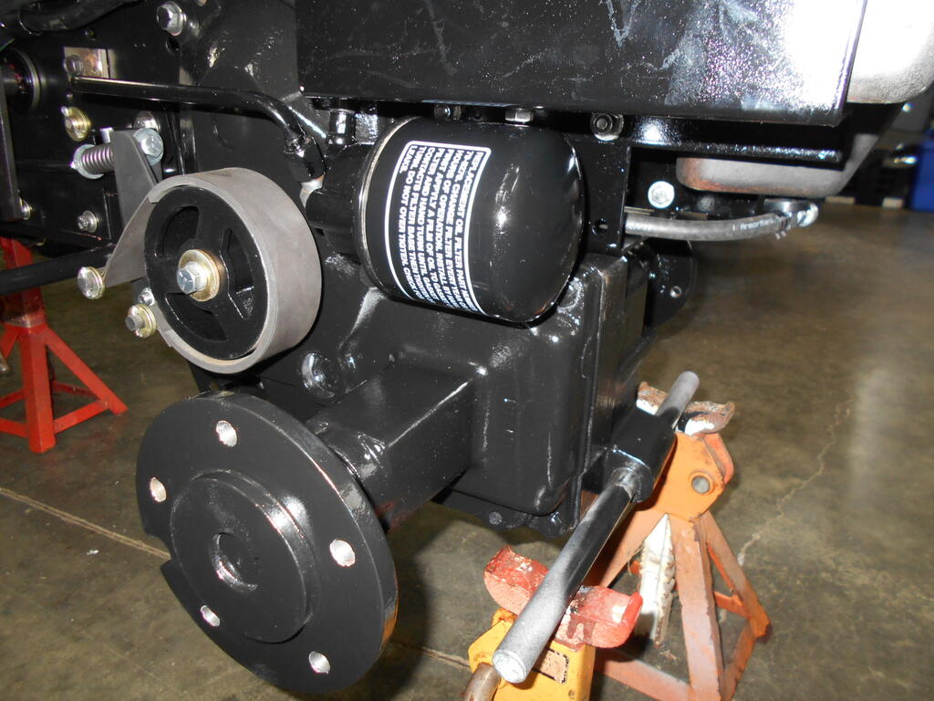

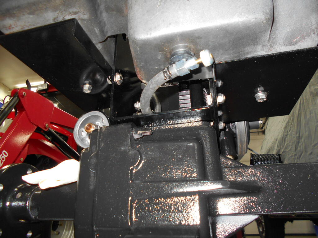

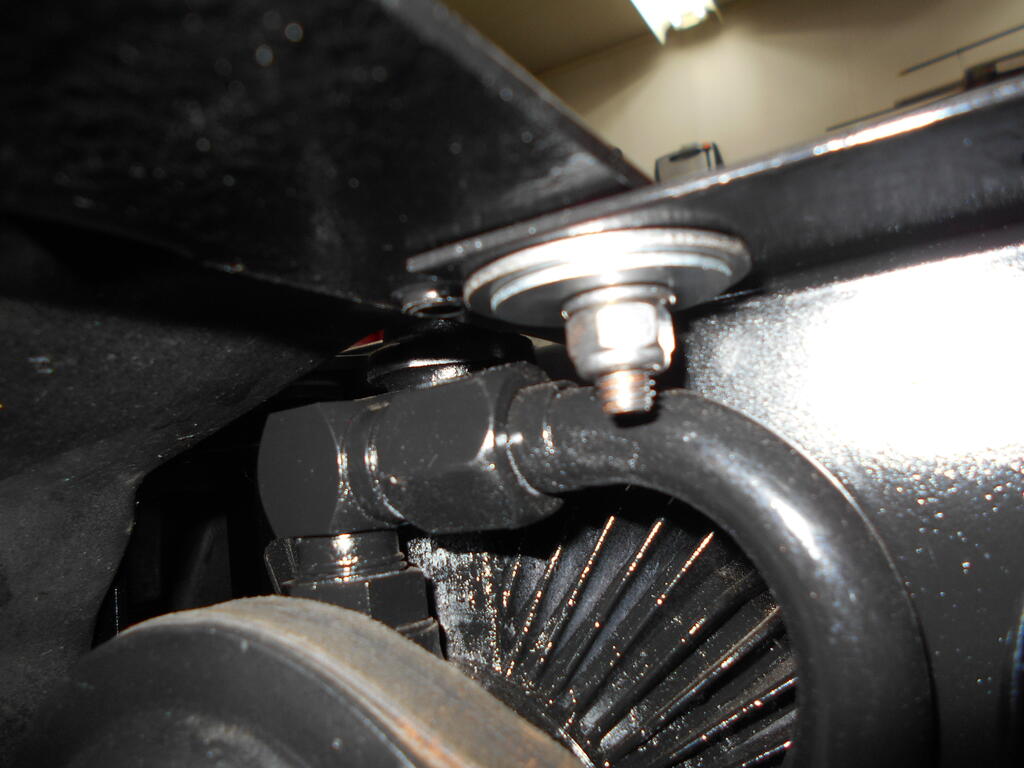

cleat 9,389 #334 Posted December 16, 2024 Hydraulic oil filter installed. Fuel tank lower bolt right above filter must be installed before filter is installed. Rear axle has been filled with oil prior to this filter being installed. 4 Share this post Link to post Share on other sites

cleat 9,389 #336 Posted December 16, 2024 Fuel tank treated with back to black. 7 Share this post Link to post Share on other sites

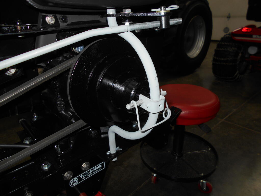

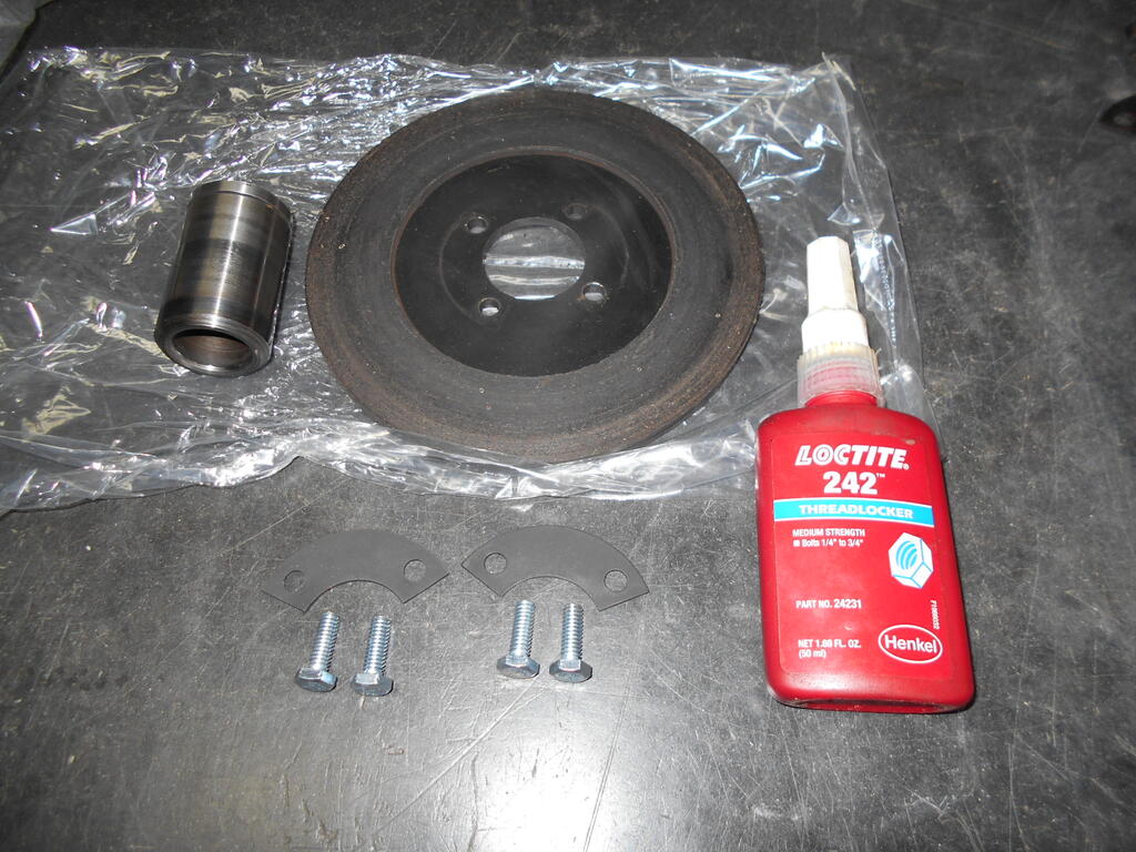

cleat 9,389 #339 Posted December 17, 2024 PTO pivot plate assembly ready to install. PTO pivot plate assembly installed and torqued to 26ft/lb. PTO clutch plate and bearing race ready to install. PTO clutch plate and bearing race installed using a little blue loctite on the bolt threads. Bolts torqued to 96in/lb. 3 1 Share this post Link to post Share on other sites

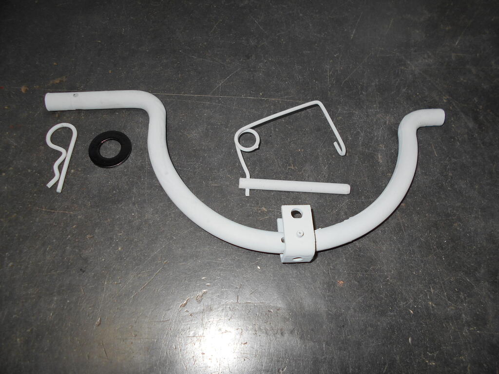

cleat 9,389 #340 Posted December 17, 2024 PTO hoop ready to be installed. PTO hoop installed. I used a 5/32 cotter pin instead of the hairpin clip at the bottom of the hoop. For the trunnion I used a thicker washer under the hairpin clip to eliminate excess play. 5 Share this post Link to post Share on other sites

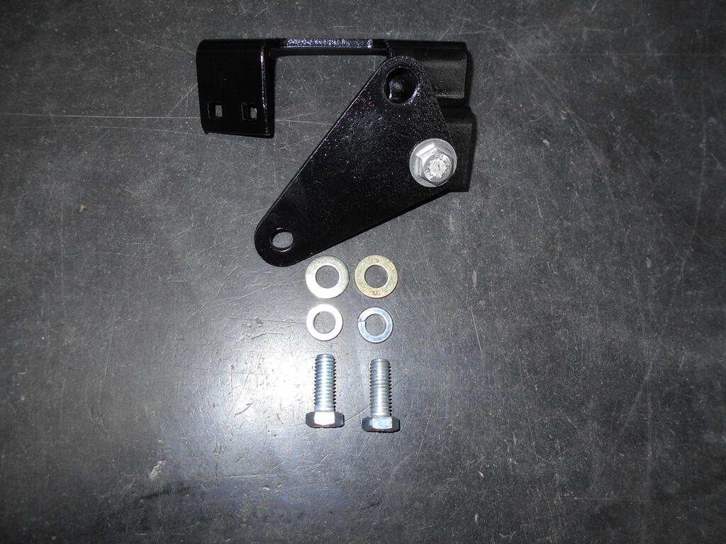

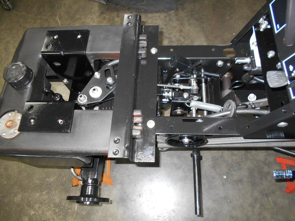

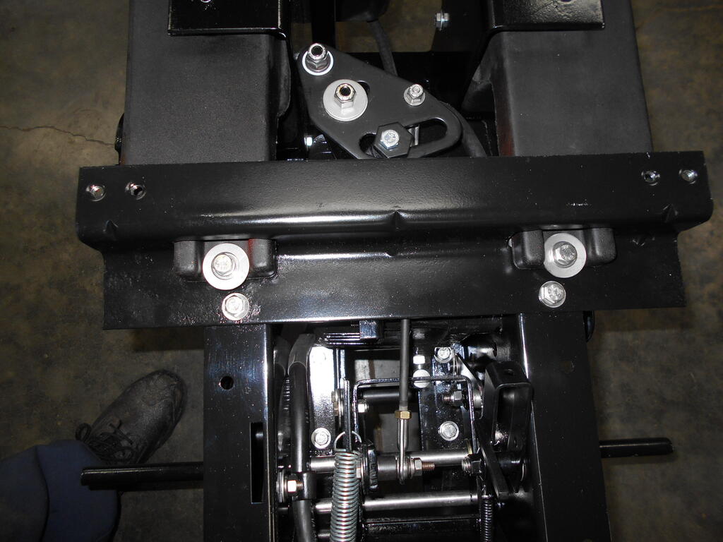

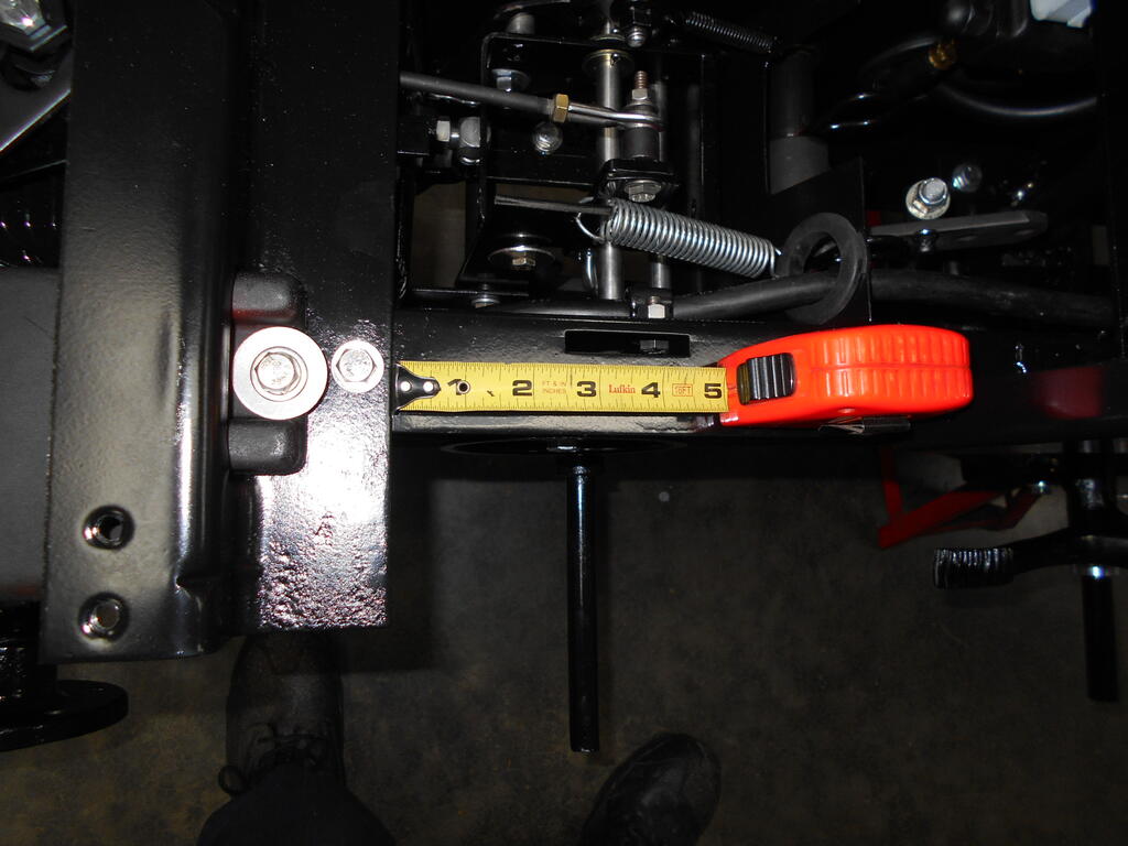

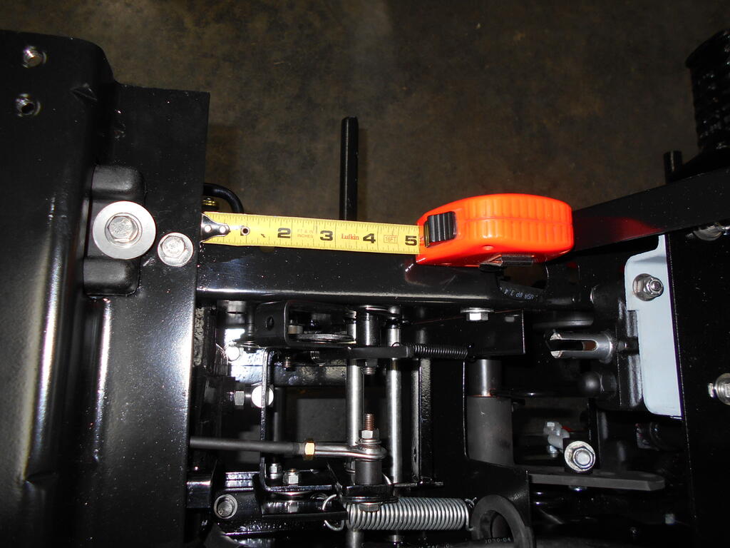

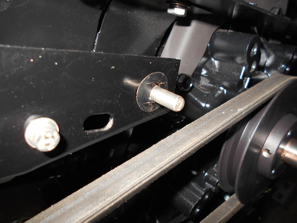

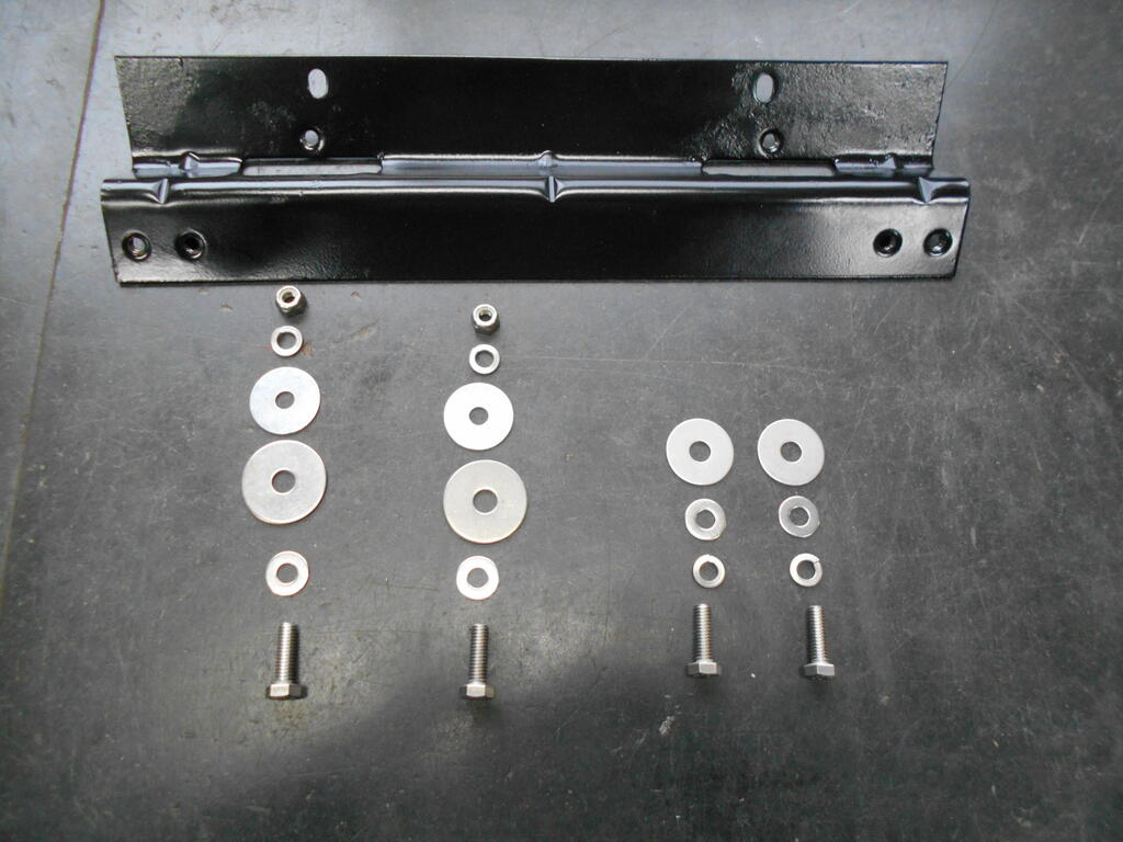

cleat 9,389 #345 Posted December 18, 2024 Front fender bracket ready to install. I am using a couple of large fender washers under the hoodstand for support to help prevent it cracking there again. Front fender bracket bolted to hoodstand. Front fender bracket bolted to hoodstand showing support washers underneath. Fuel tank bolted to front fender bracket. Front fender bracket was measured to be square and even so fender and seat will bolt on properly. Front fender bracket has slotted mounting holes to allow for proper fitment. Front fender bracket measured to be square to hoodstand Left side. Front fender bracket measured to be square to hoodstand Right side. 2 Share this post Link to post Share on other sites

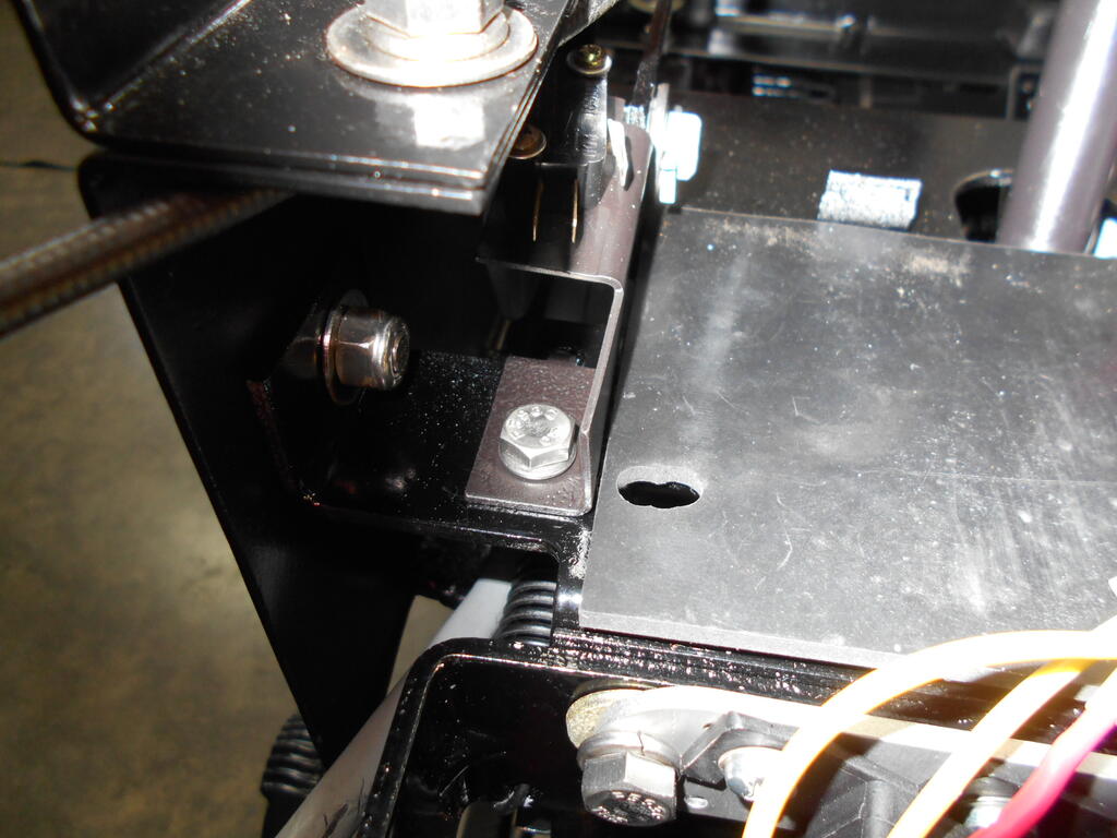

cleat 9,389 #346 Posted December 18, 2024 Some previous owner decided to drill a hole in the side of the dash console so I decided to square it off and install a carriage bolt. I could have had it welded in but decided this would work just as well. Here is the hole. Bolt installed. 2 Share this post Link to post Share on other sites

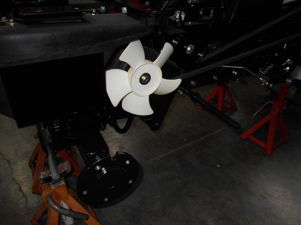

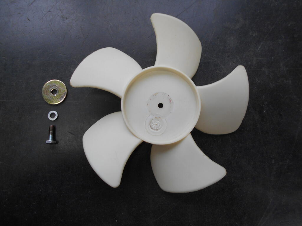

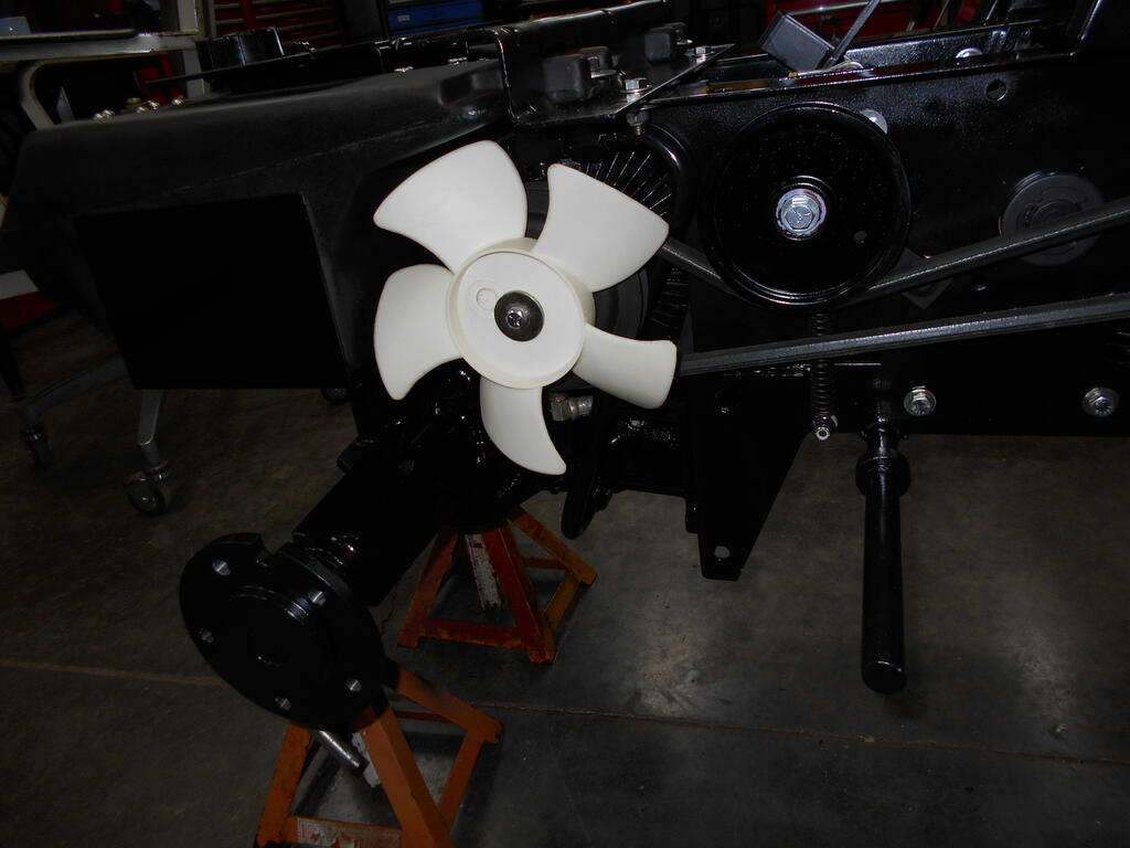

cleat 9,389 #347 Posted December 18, 2024 Hydro cooling fan ready to install. Hydro cooling fan installed and bolt torqued to 84in/lb. 2 1 Share this post Link to post Share on other sites

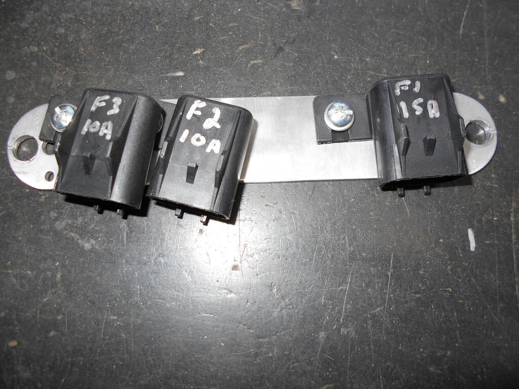

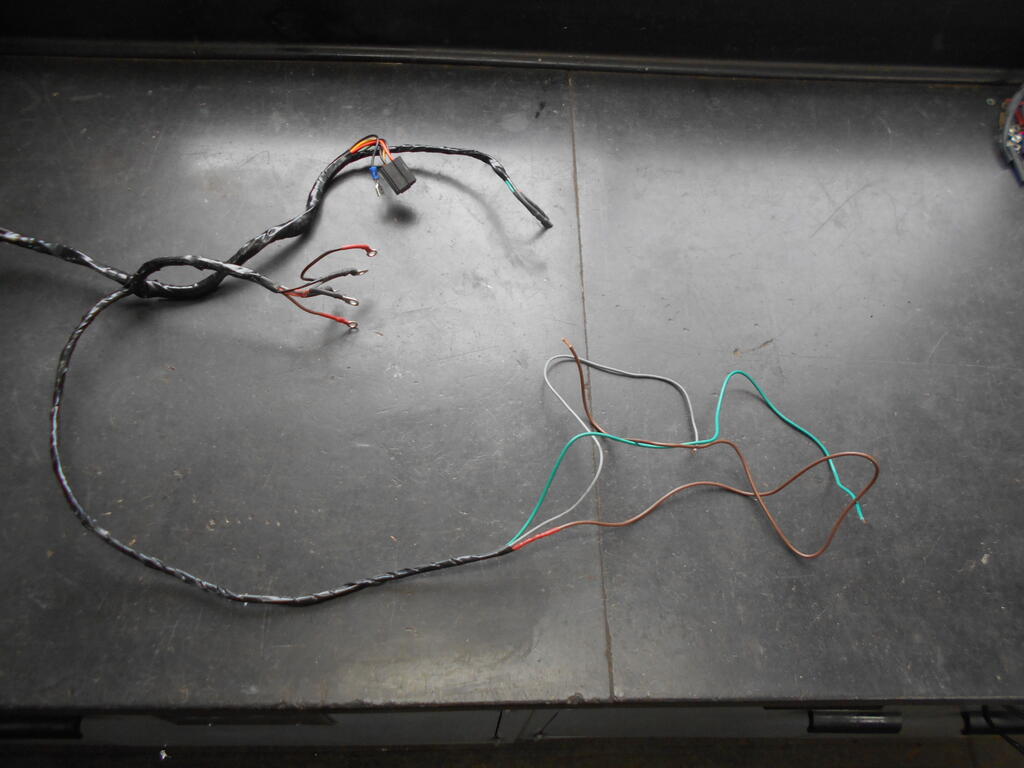

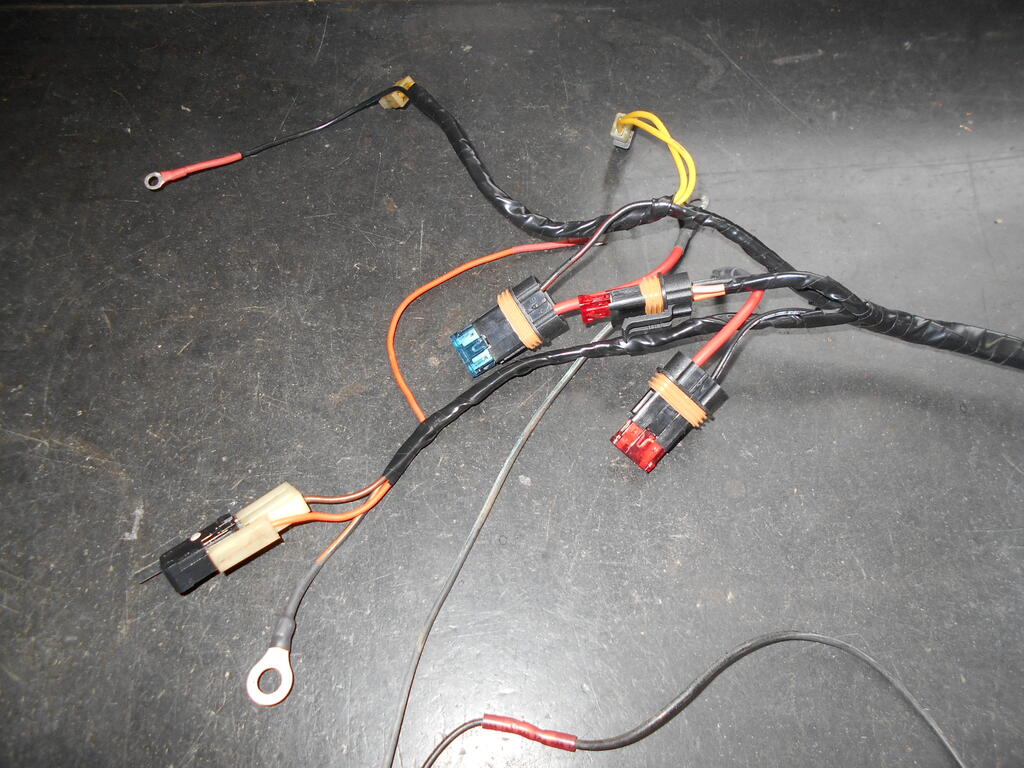

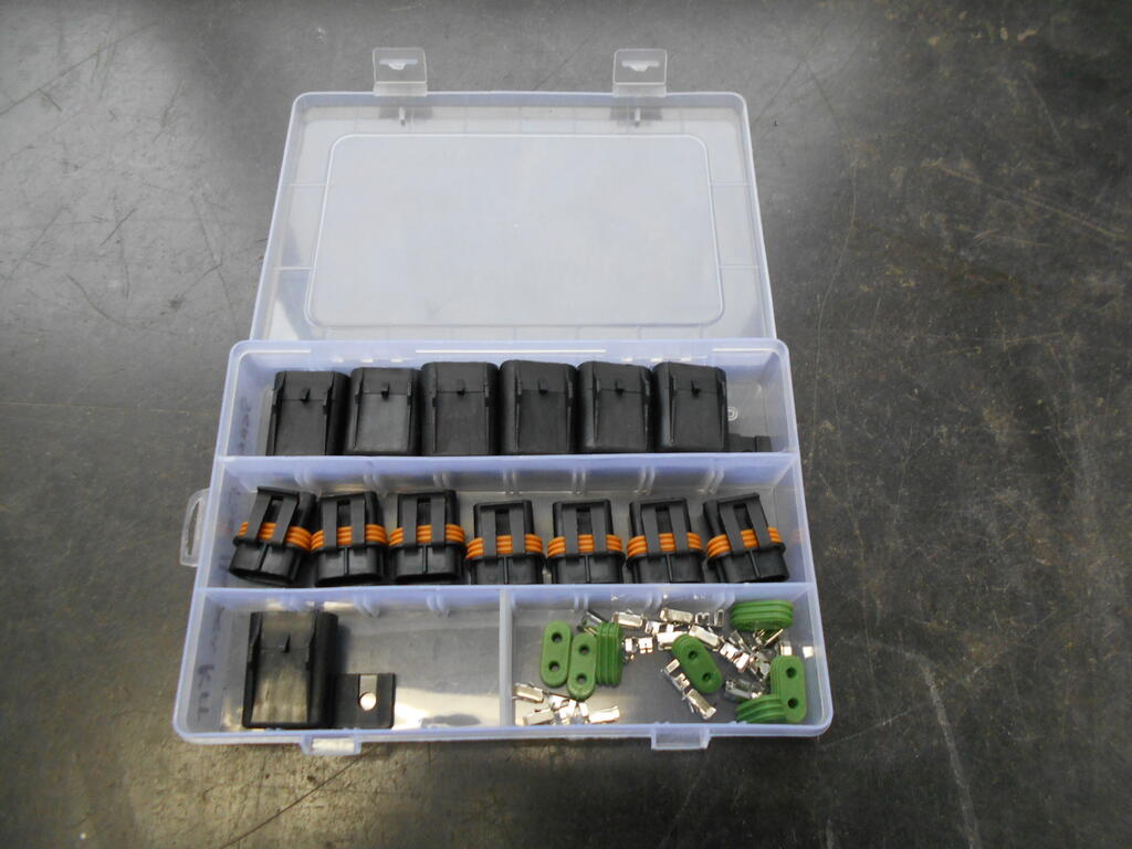

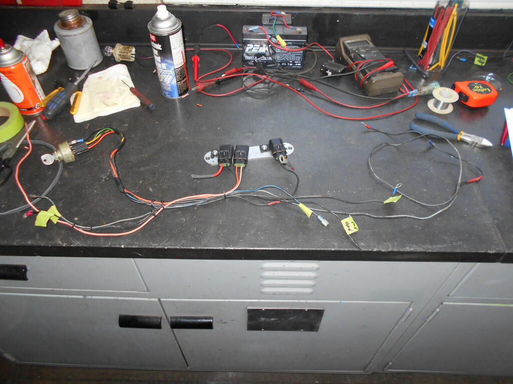

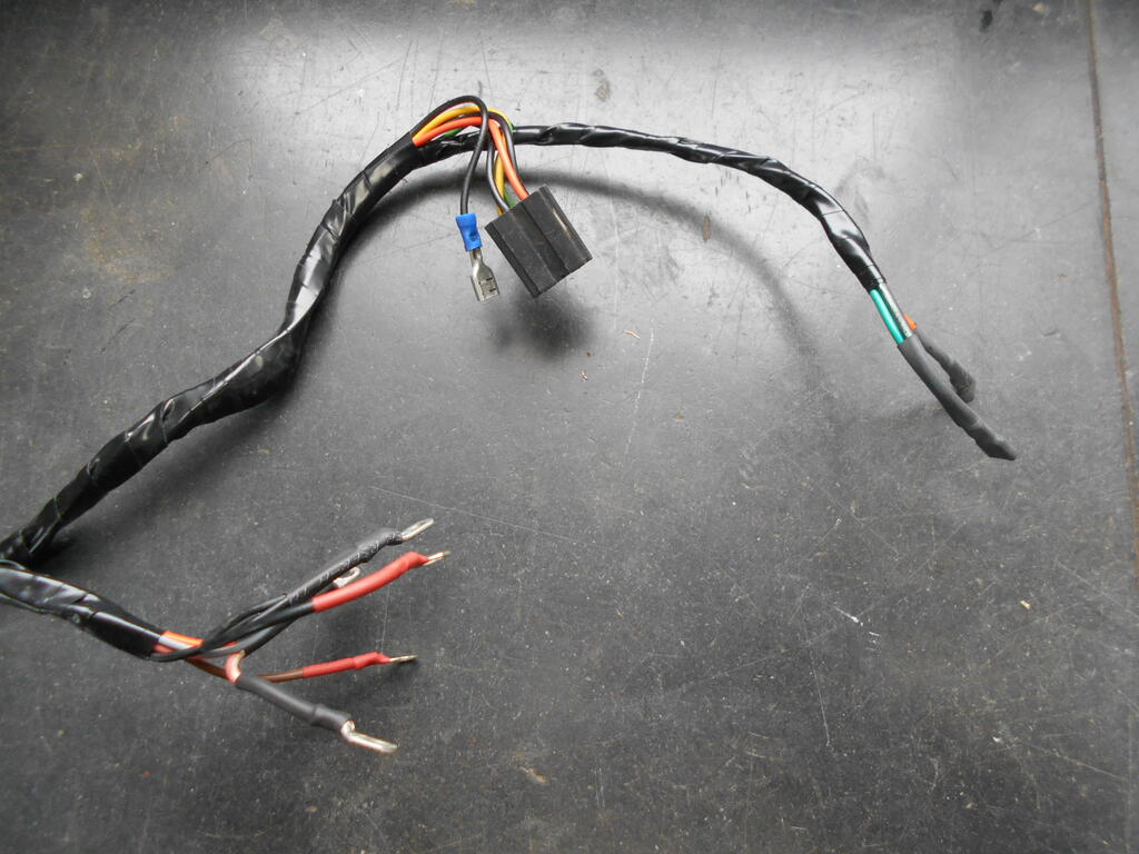

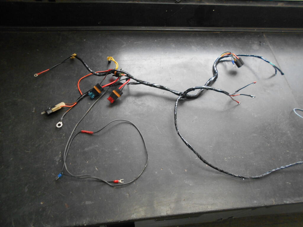

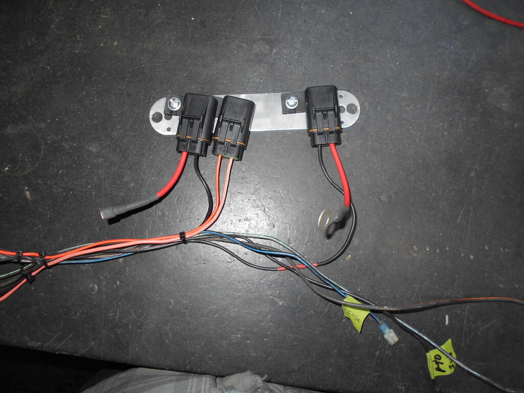

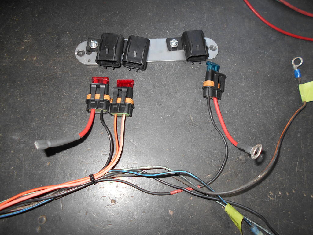

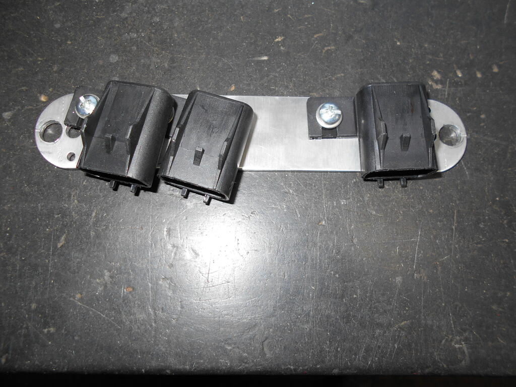

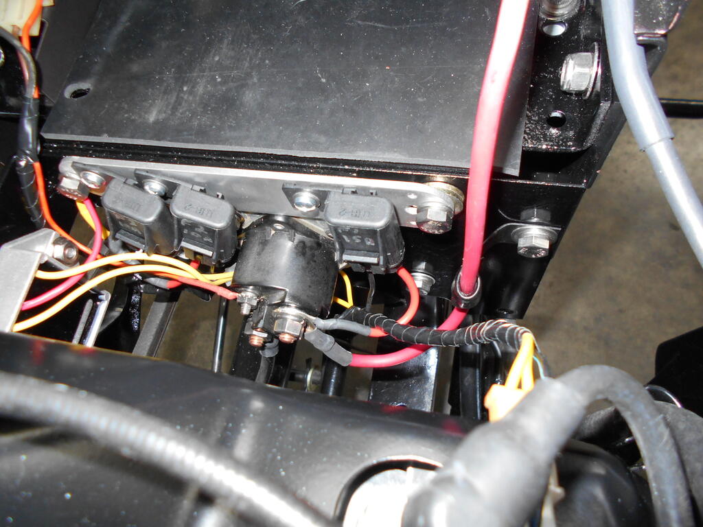

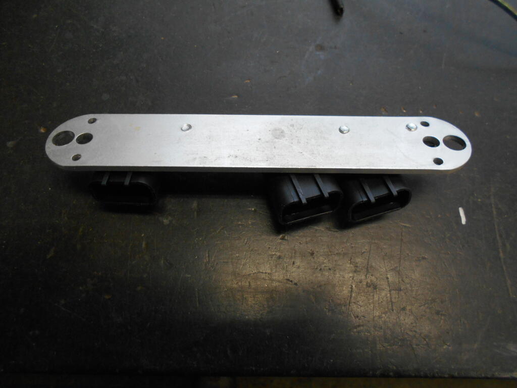

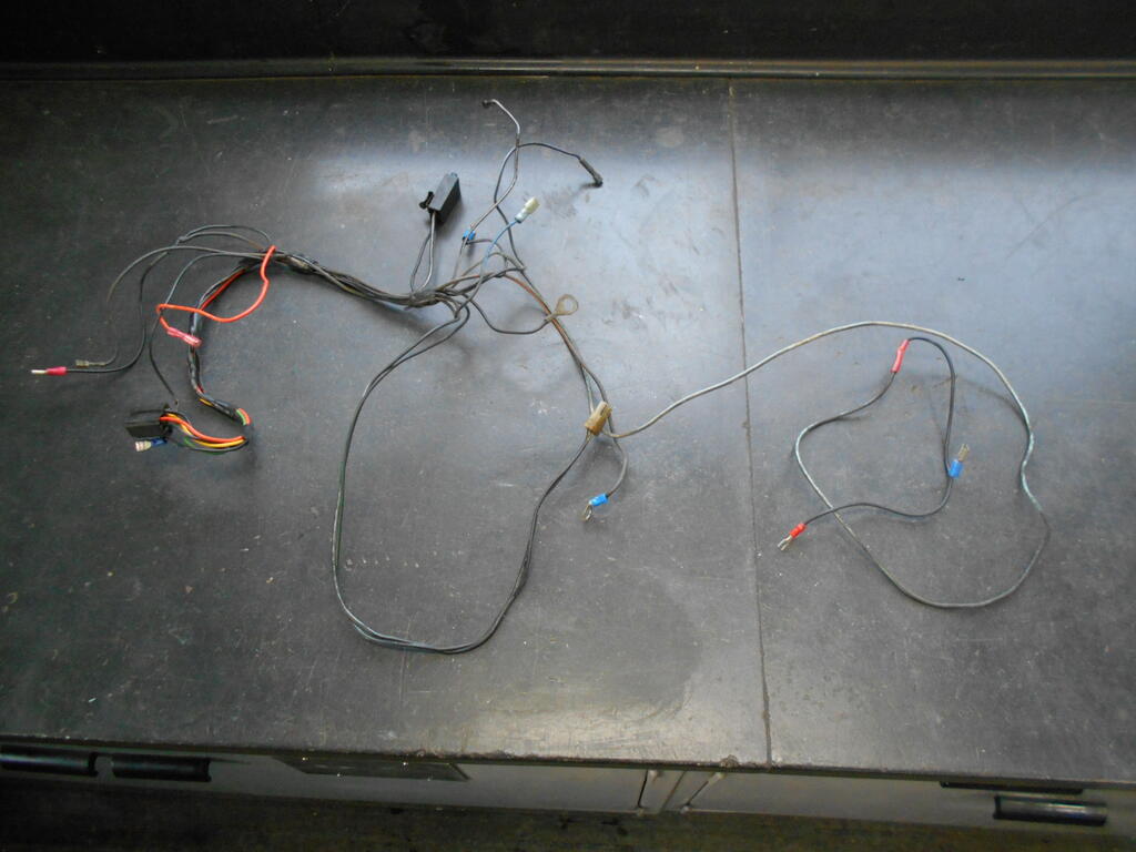

cleat 9,389 #349 Posted December 20, 2024 Wire harness as pulled from tractor. I made up a bracket to secure the sealed fuse holders from a scrap piece of aluminum that was kicking around the shop. It is drilled on each end to be mounted using two existing bolts that hold the front plate. It was then drilled and tapped so I could screw the fuse holders to it. Fuse holders labelled. This is the kit I used to make up the fuse holders. Wire harness at mid rebuild. Harness has been very modified to support the upgraded charging system, fuel gauge, tail lights. Wire harness ready to install. 6 Share this post Link to post Share on other sites

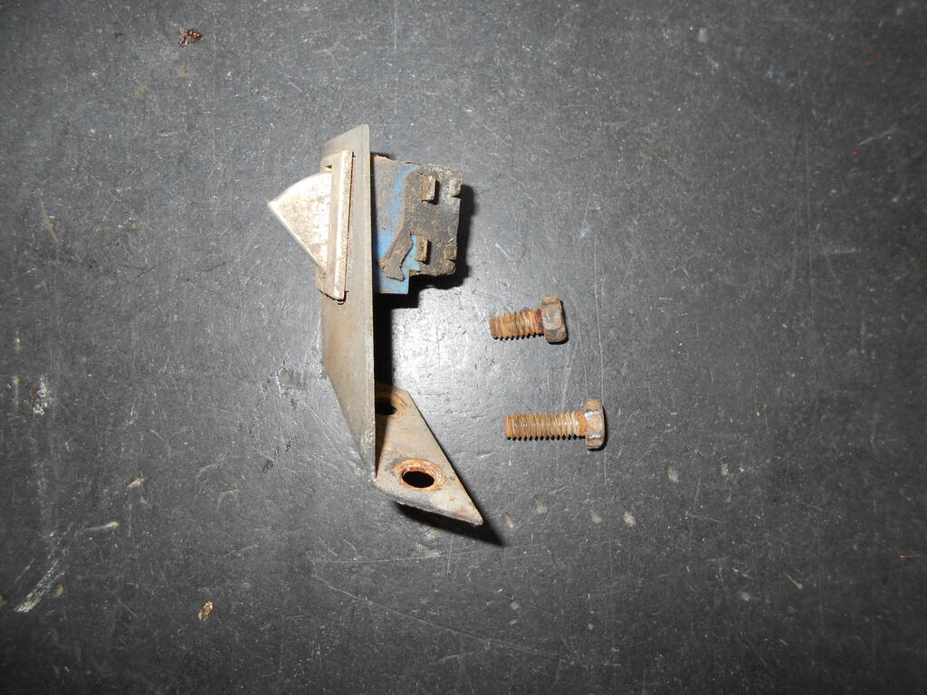

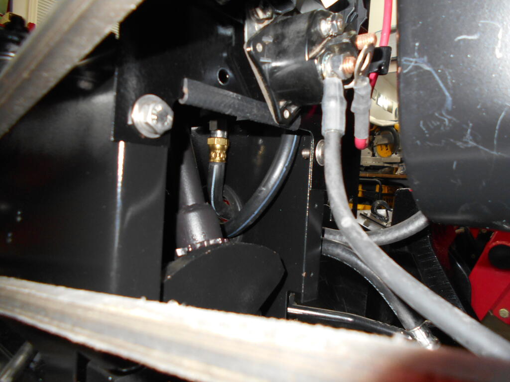

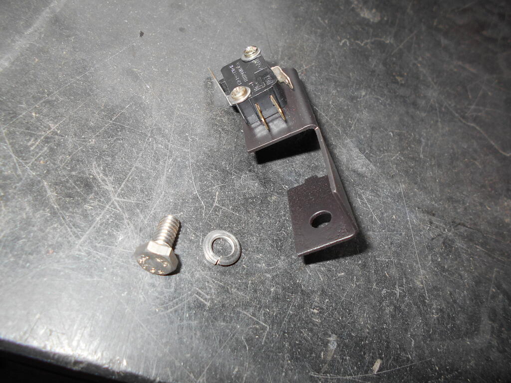

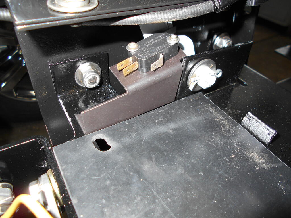

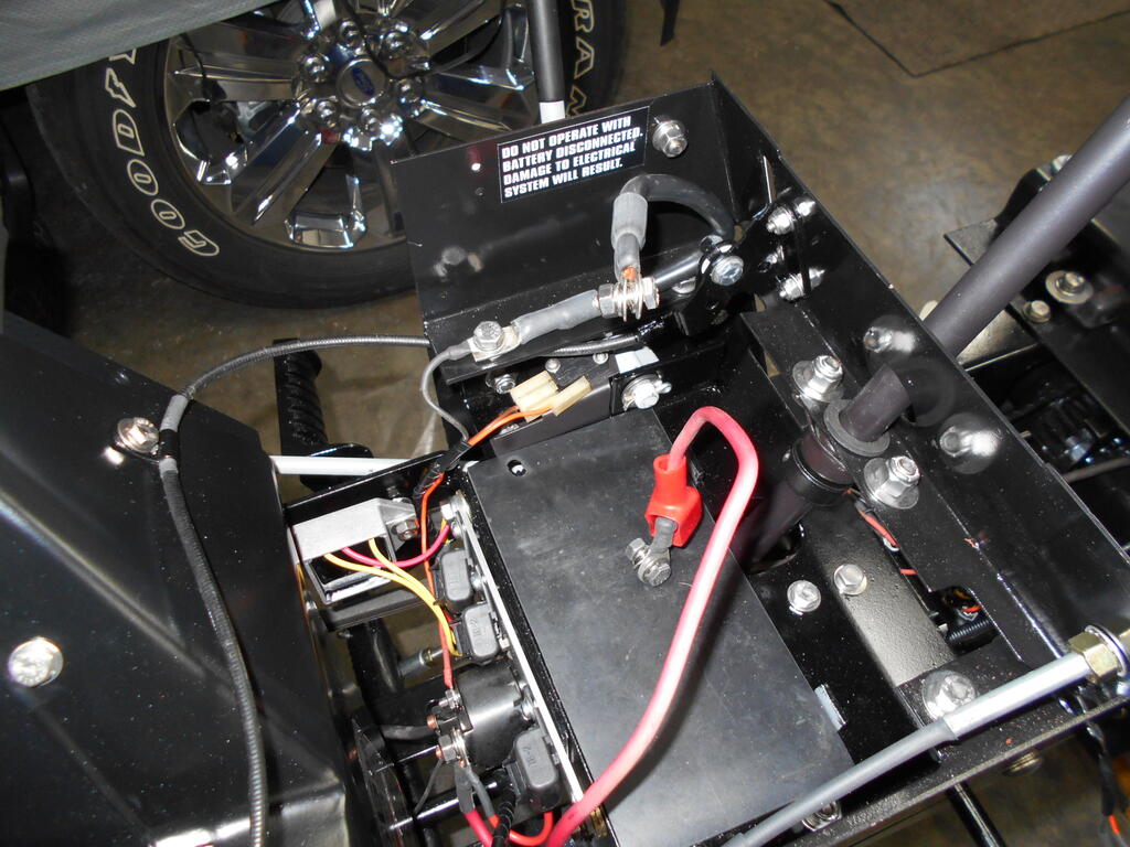

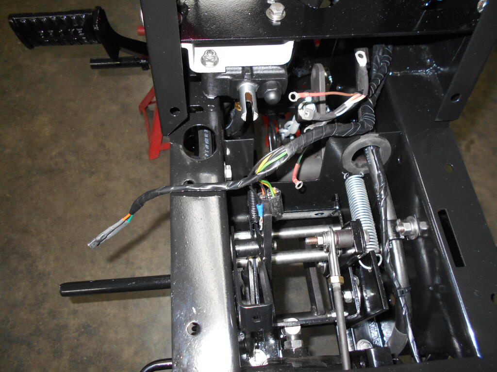

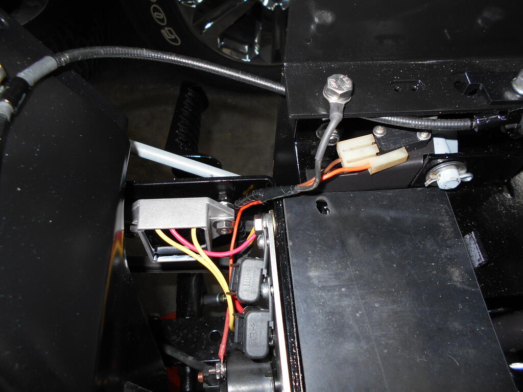

cleat 9,389 #350 Posted December 20, 2024 PTO switch ready to install. PTO switch installed. This is a change from the old style switch that the Work Horse came with. Old switch that was removed. PTO switch installed. Edge trim installed on bottom of front plate to protect wire harness. Wire harness installed. Wire harness connected to engine alternator and magneto. -Battery cable installed. Wire harness completed at fuel tank sender and tail light connector. 1 3 Share this post Link to post Share on other sites
