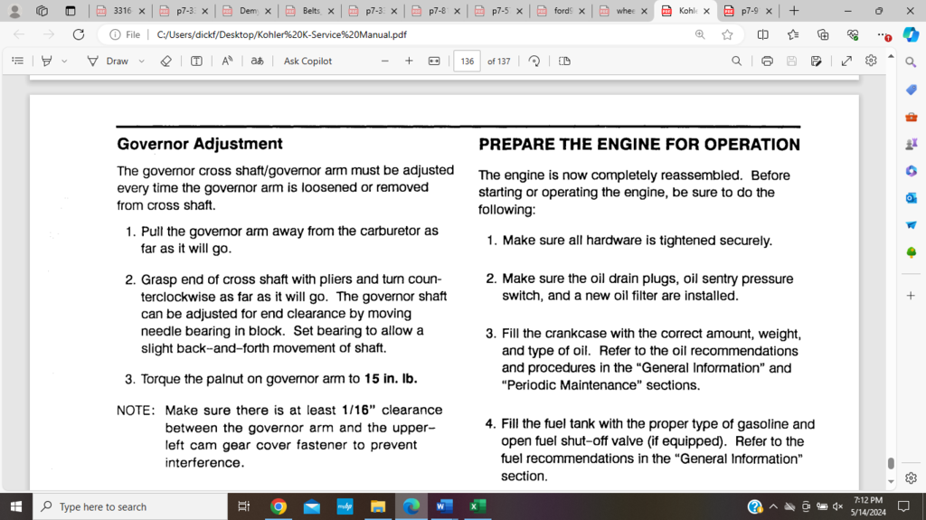

wallfish 19,299 #3 Posted May 14, 2024 If gas is flooding out the front of the carb then the float bowl valve isn't sealing properly and the extra gas is a problem with it running. Set the governor according to the manual. Then start the engine with trans in neutral. Move the carb / governor linkage by hand. You should feel it trying to push the carb closed. There's no guess work as it pushes pretty hard and noticable. 1 Share this post Link to post Share on other sites
953 nut 64,115 #4 Posted May 14, 2024 Here is the governor adjustment section of the Kohler Engine Manual. Share this post Link to post Share on other sites
