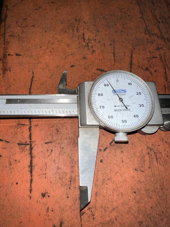

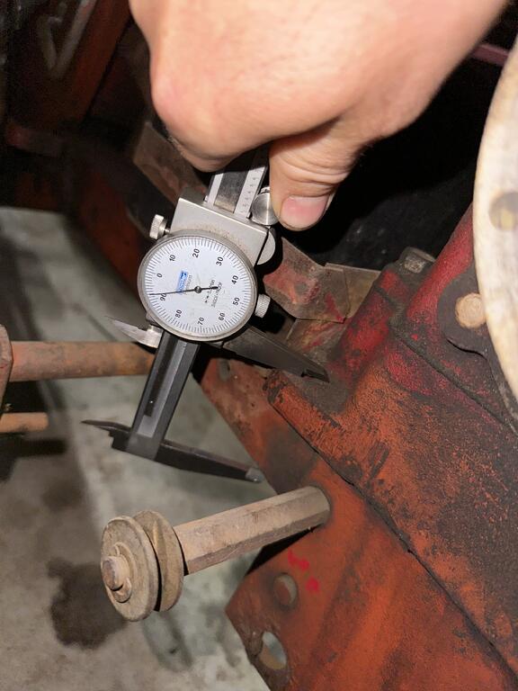

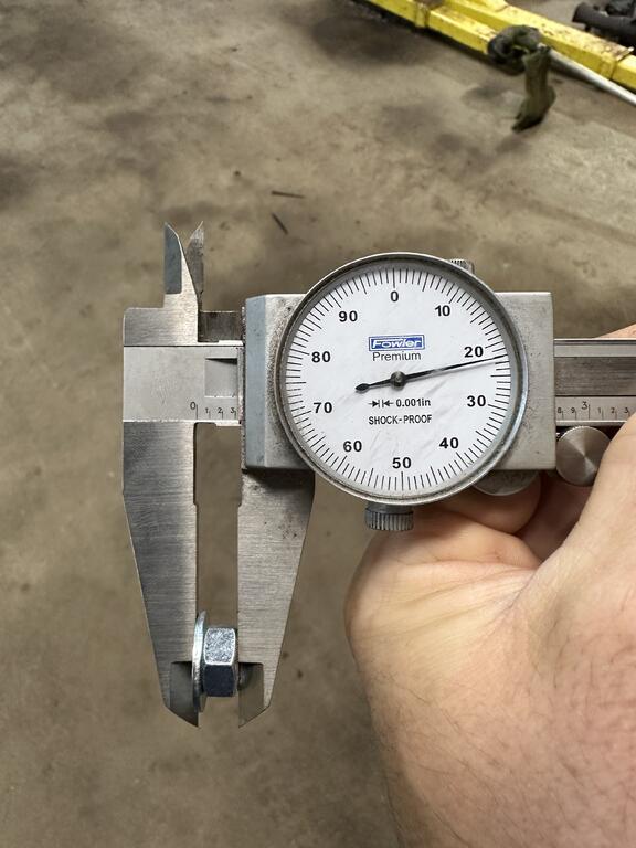

Pullstart 68,616 #2 Posted May 15, 2024 I did some measuring and come with a stack up of 3.015” from the bottom of the frame to the top of a washered nut. I’ll see about finding some 5/16” x 3-1/4” bolts, measured from the inside of the J to the end of the thread. 1 Share this post Link to post Share on other sites

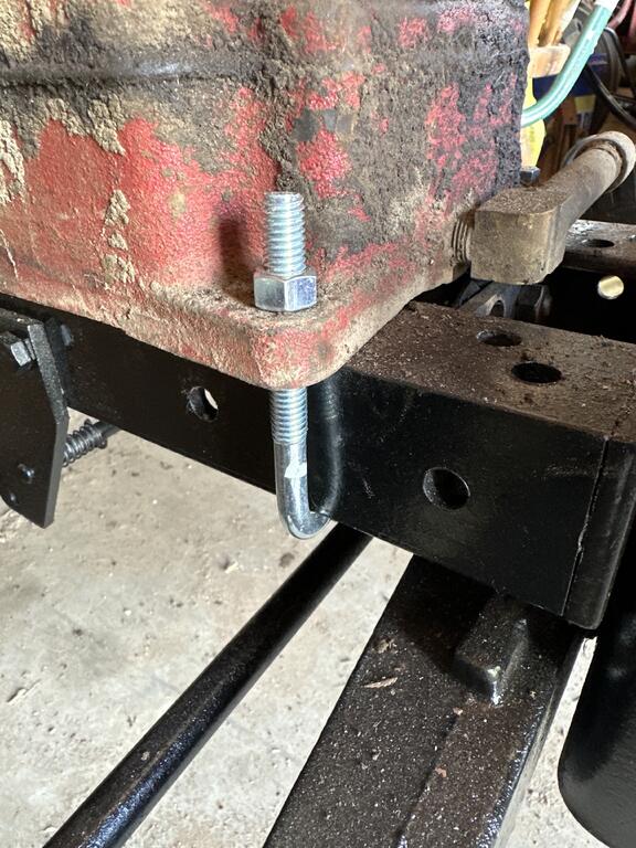

Pullhosen’s Pony Express 97 #3 Posted June 13, 2024 3/8” bolts will work best. This j bolt is 3-3/8” long inside of bend to end of threads. 1 Share this post Link to post Share on other sites
