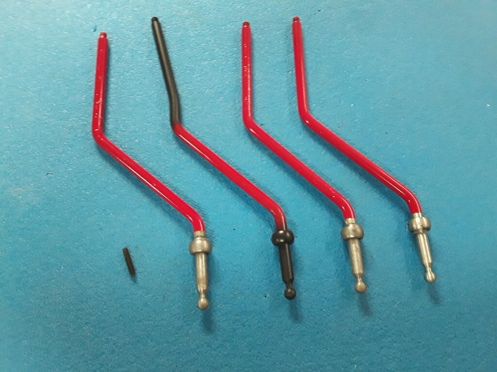

76c12091520h 3,892 #4 Posted May 13, 2024 Numerous reconditioned shift levers in stock along with new set screws. Private message me , or call/text for pricing and other questions. Share this post Link to post Share on other sites
