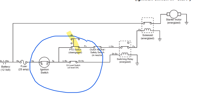

squonk 44,860 #3 Posted May 12, 2024 Here is a pic of a 86 414-8 starting circuit. The tan wire should be on the start terminal of the switch. Share this post Link to post Share on other sites
953 nut 62,996 #4 Posted May 12, 2024 Your ignition switch should be a 103-990 and from the sound of it you have the wrong switch. Not all Wheel Horse ignition switches are the same. Here is a series of electrical drawings for your tractor. Share this post Link to post Share on other sites
