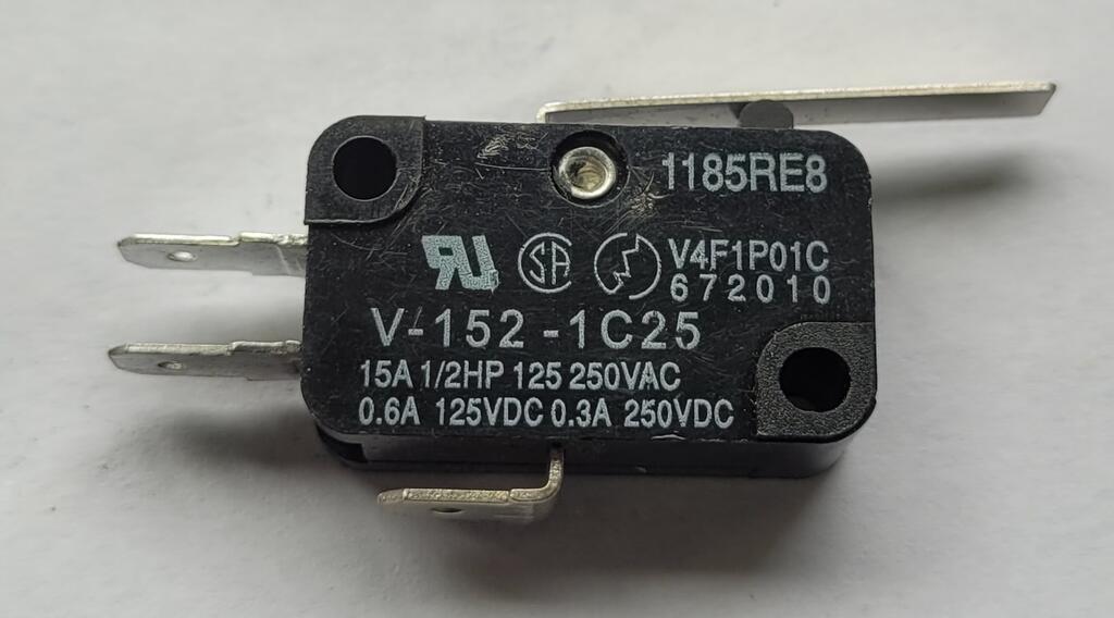

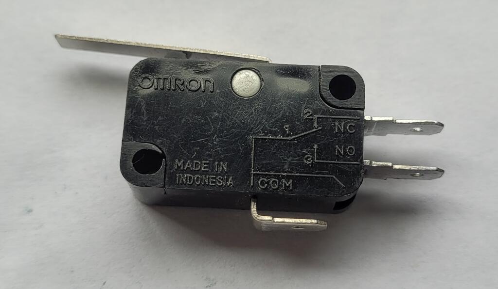

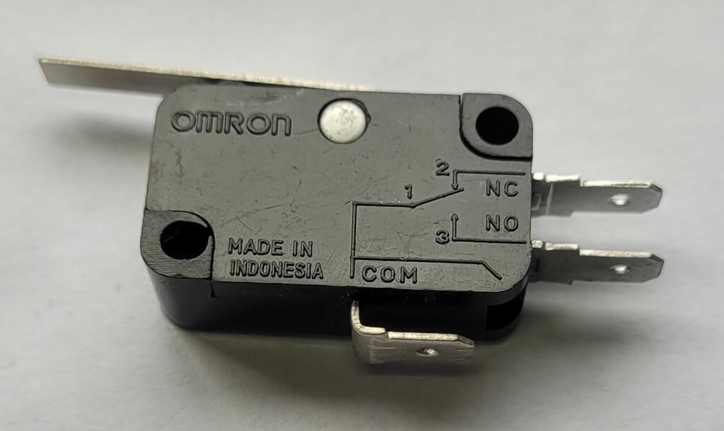

cleat 8,828 #10 Posted May 12, 2024 This is the switch I bought online a few years ago. I think I bought a bag of 10 for a few dollars. 2 Share this post Link to post Share on other sites
lynnmor 8,682 #11 Posted May 12, 2024 I see that you can still buy bags of V-152-1C25 switches for cheap, there no need to pay ridiculous prices. 1 Share this post Link to post Share on other sites

lynnmor 8,682 #15 Posted May 19, 2024 Look at the photos in post #10 above, see if your NC and NO are reversed. If so, simply switch the wires around. 1 Share this post Link to post Share on other sites
