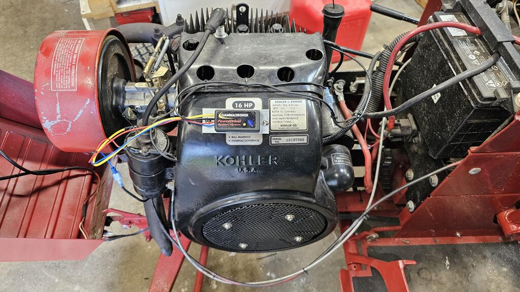

bds1984 1,503 #1 Posted May 10, 2024 Well, I finally got around to it, but I eliminated the condenser on my C165 and replaced it with a Gammatronix unit. The points are still there, but serve as a switch to fire the system. With a few minutes of run time, I have noticed a slight improvement in higher RPMs. I know this isn't the best place to mount this, however, it isn't permanent, just for testing. The bigger questions is: Can I use an electronic ignition emblem emblem from a junkyard? What's next, fuel injection? 2 2 Share this post Link to post Share on other sites
ri702bill 10,014 #2 Posted May 10, 2024 Nice - is it reverse polarity hookup safe?? Sealed, weatherproof constriction?? Share this post Link to post Share on other sites

bds1984 1,503 #4 Posted May 10, 2024 The instructions make it quite clear how to hook it up so I am not sure how well it would be handled if that happened. As far as weatherproof, the instructions say the unit doesn't like getting wet, but I would think it could handle some water better than points. As far as EFI, I have seen a few late model Cubs with it. I am waiting for one to come up for sale on FB or Ebay and then transplant it over. 1 Share this post Link to post Share on other sites

wallfish 18,625 #6 Posted May 10, 2024 If the points are still there for a switch, that's basically what they do with a condenser too. I don't seem to have very many bad condensers but have had some. So seldom that I've never had the need to buy one new BUT WOW, $50+ for an OEM Kohler condenser! Anyone going to the big show better keep an eye on your condensers. Anyone looking for used OEM condensers after June let me know, $30 each and buy 3 get one free! LOL 1 1 Share this post Link to post Share on other sites
ebinmaine 74,493 #7 Posted May 10, 2024 30 minutes ago, 953 nut said: Feel free to spend your money any way you choose to, $ 37.50 US Dollars plus shipping can buy a lot of condensers. Your logic is sound but I'll add a couple things. 1. With these modules the the points should never need replacement, cleaning or adjustment again. 2. Points are $15 - $20 bucks here. For cost of two sets of points I'd just as soon get a module. There's also ease of starting, smoother running engine, and decreased fuel usage. How much? Dunno.... Every little bit helps. Share this post Link to post Share on other sites

bds1984 1,503 #10 Posted May 11, 2024 I've had a few condensers fail over the years, and with the price of OEM units going to the moon, this is one reason why I went this route. I've had not-so-great luck with replacement parts that cost more than this module ($28/shipped) that were just trash and required replacement often, so I'll chalk that up as a win in my column. I wish I was one of those who could say that all you had to do was clean the points and off you went. But for now, I will endure this experiment and see how it goes. 2 Share this post Link to post Share on other sites
