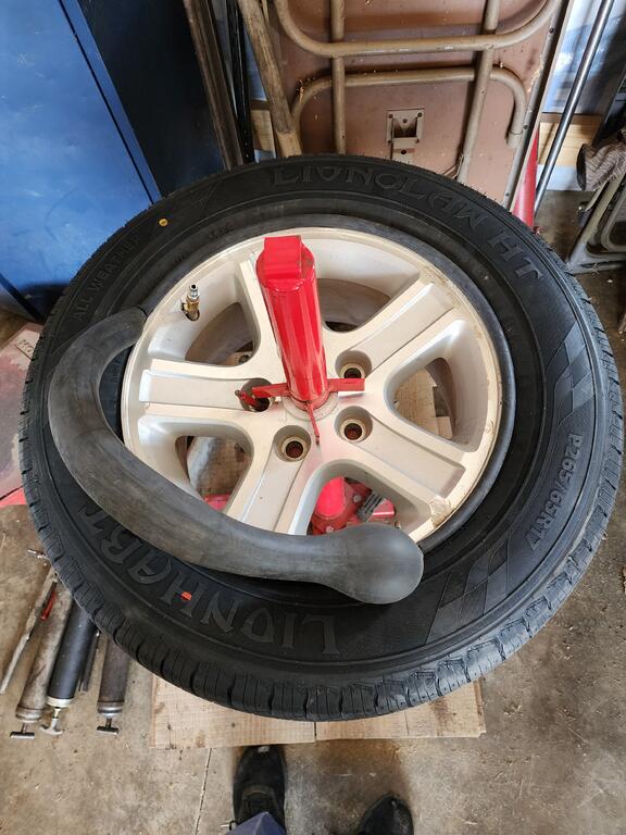

cafoose 3,337 #1 Posted May 10 (edited) I had a difficult time sealing tire beads when changing tires. I searched YouTube for a solution and someone said that if you take a 20 inch bicycle tube and inflate it enough to take up the gap then you can seal it easily. I tried it and it does work Once it's mostly sealed then remove the tube and continue inflating. Sometimes it takes a couple tries but eventually it will seal. Let most of the air out once it pops to be able to remove the tube. I used a centering cone from amazon to center the wheel on the tire machine and also to help protect it from scratches. Also got this tire machine adapter in the following YouTube link to change tires easily and it works https://www.amazon.com/dp/B0CBR5Y21D?ref=ppx_yo2ov_dt_b_product_details&th=1 Edited May 10 by cafoose 6 Share this post Link to post Share on other sites

cafoose 3,337 #3 Posted May 10 21 minutes ago, Pullstart said: Better yet, I’ll trade you a 2” ratchet strap to squeeze the tire in, for dibs on that pull start 10 horse Kohler that Richie has Already got several 2" straps and I tried that but it doesn't always work. If I make it too tight it pushes the tread in before it widens the bead separation 2 Share this post Link to post Share on other sites
ebinmaine 66,705 #4 Posted May 11 11 minutes ago, cafoose said: Already got several 2" straps and I tried that but it doesn't always work. If I make it too tight it pushes the tread in before it widens the bead separation Agreed. I've tried that and failed completely. Now.... tubes for all tires!!! 2 Share this post Link to post Share on other sites
cafoose 3,337 #5 Posted May 11 11 minutes ago, ebinmaine said: Now.... tubes for all tires!!! These are 17 inch truck tires and they're not mine, mounting them for a friend. I put tubes in all my tires 2 1 Share this post Link to post Share on other sites
