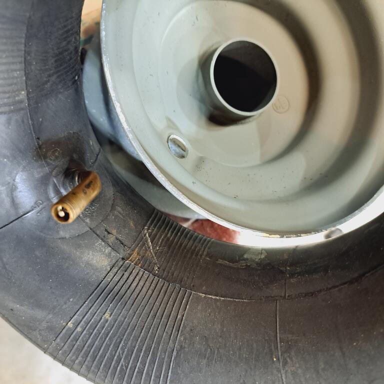

953 nut 64,066 #7 Posted May 8, 2024 This picture is from @WHX?? when he was putting "NEW" tubes into the new tires on my A-60. He mounted them and both tubes opened up at the seams when inflated. 2 Share this post Link to post Share on other sites
WHX?? 54,860 #8 Posted May 8, 2024 42 minutes ago, 953 nut said: This picture is from @WHX?? when he was putting "NEW" tubes into the new tires on my A-60. He mounted them and both tubes opened up at the seams when inflated. Was a real pain on small rims too. I think what happened is me airing and unairing to get the stem straight. Crooked stem is a pet peeve of mine. Still they shouldn't have split like that. Wasn't like I pinched it with the tire spoon. Do be careful on pulling the trigger Marv. Richard did order some with the wrong stem. Read the fine print. These will not work. Ones with the TR 13 stem should be fine. 3 Share this post Link to post Share on other sites

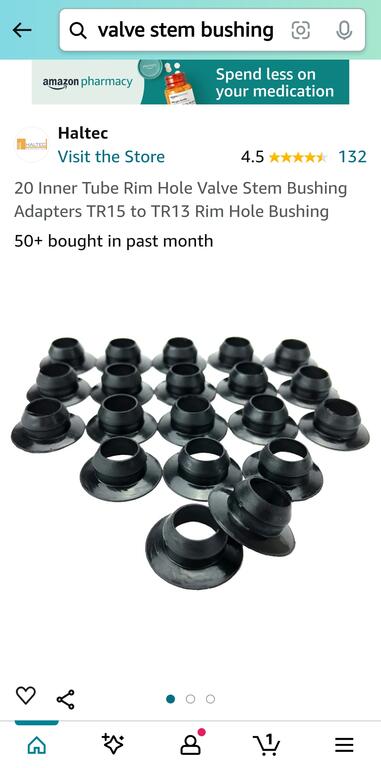

WHX?? 54,860 #9 Posted May 8, 2024 12 hours ago, ri702bill said: Marv.... You need a tube tjhat the stem fits a .453 diameter Not necessarily Bill. Some rims I just did had the .625 or 5/8 hole. If you run into that these are real cheap 3 Share this post Link to post Share on other sites
