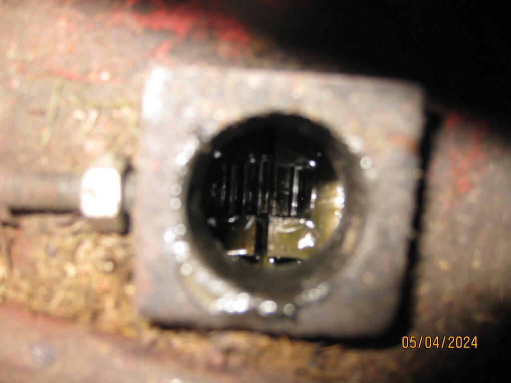

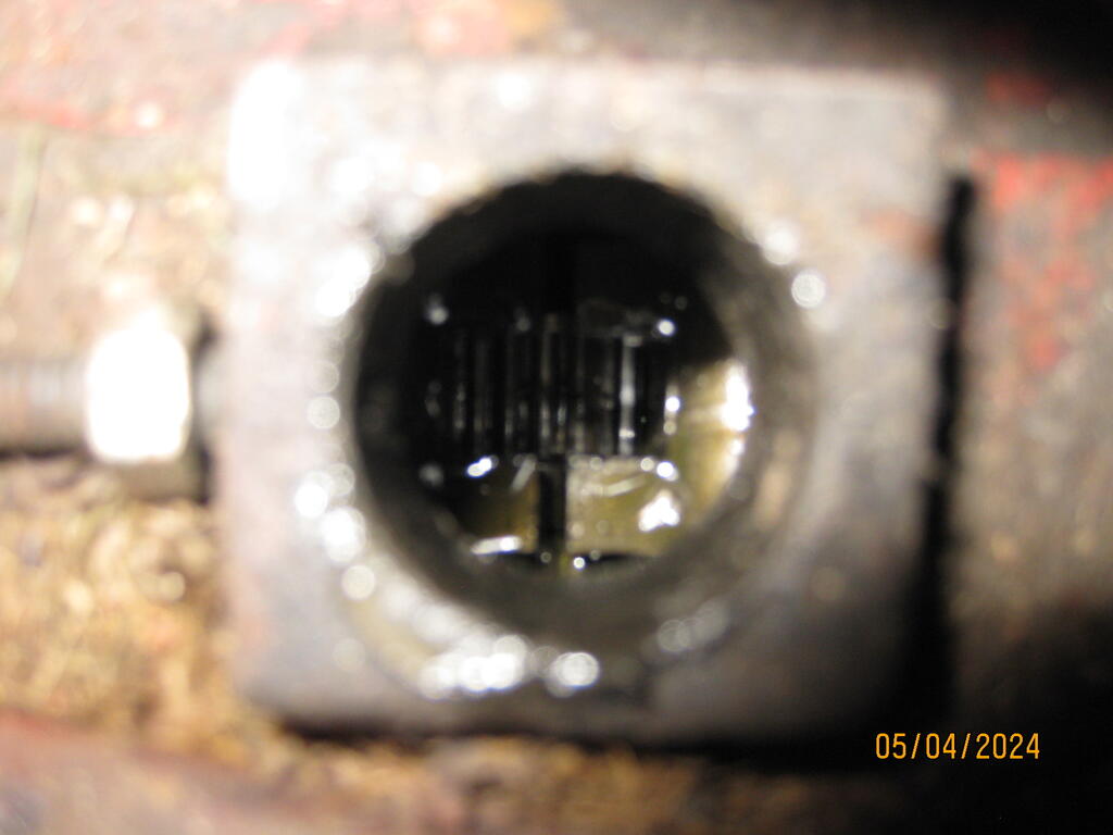

ebinmaine 77,504 #4 Posted May 4, 2024 2 hours ago, Man In Black said: Thanks for the quick response , I will try that tonight . I didn't want to force anything until I asked . Post pics of the shifter hole so we can see the forks. Also the set screw. There's usually a reason why that comes out. Wear on the end maybe. Shouldn't require a teardown but there isn't a ton of extra space where that set screw is. Share this post Link to post Share on other sites
Man In Black 4 #6 Posted May 4, 2024 1 hour ago, ebinmaine said: Post pics of the shifter hole so we can see the forks. Also the set screw. There's usually a reason why that comes out. Wear on the end maybe. Shouldn't require a teardown but there isn't a ton of extra space where that set screw is. 1 hour ago, ebinmaine said: Post pics of the shifter hole so we can see the forks. Also the set screw. There's usually a reason why that comes out. Wear on the end maybe. Shouldn't require a teardown but there isn't a ton of extra space where that set screw is. Share this post Link to post Share on other sites
Man In Black 4 #7 Posted May 4, 2024 I hope the pictures help . It's hard to get the light directed any better . Nothing wants to move with a long screwdriver . I tried moving the two slots across the center but everything is solid . there is not enough room on the left and right sides to get a screwdriver in to pry . Share this post Link to post Share on other sites
ebinmaine 77,504 #8 Posted May 4, 2024 Just now, Man In Black said: I hope the pictures help . It's hard to get the light directed any better . Nothing wants to move with a long screwdriver . I tried moving the two slots across the center but everything is solid . there is not enough room on the left and right sides to get a screwdriver in to pry . Looks like your forks are already in neutral. How's the condition of the set screw? Share this post Link to post Share on other sites

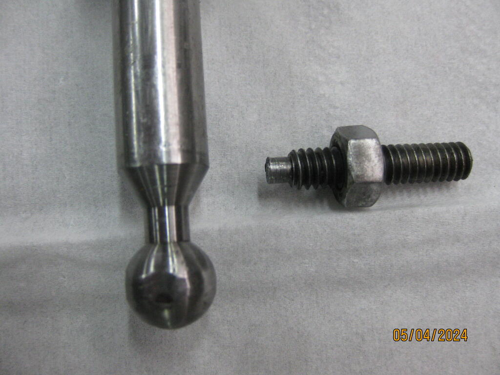

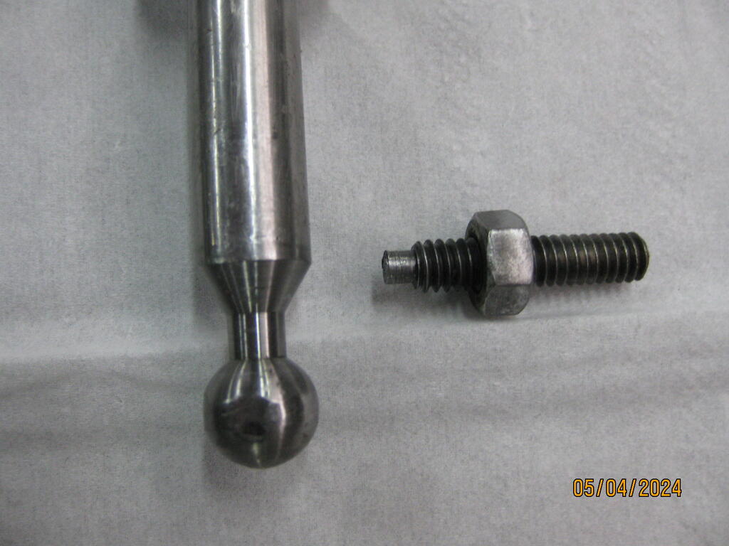

Man In Black 4 #9 Posted May 4, 2024 2 minutes ago, ebinmaine said: I will go out now and get a picture of the set screw and the bottom of the shift lever . It will take about 20 minutes . Thank you for your patience . Looks like your forks are already in neutral. How's the condition of the set screw? Share this post Link to post Share on other sites
953 nut 64,263 #10 Posted May 4, 2024 This thread will get you shifting again. 2 Share this post Link to post Share on other sites
953 nut 64,263 #12 Posted May 4, 2024 Is the donut on your shift lever? If so the point of the dogpoint goes in the hole in the donut. Share this post Link to post Share on other sites
Rick3478 445 #13 Posted May 4, 2024 It might help to conceptualize it not as a setscrew, but as a pivot screw. 1 Share this post Link to post Share on other sites
