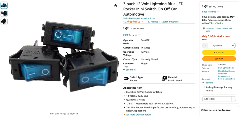

cafoose 3,664 #1 Posted May 2, 2024 Lights never worked on my 520-HC so I put a test light on the switch and power going in but nothing coming out. I jumped the switch and got lights. I ordered a new switch from amazon and just had to file the opening about 1/16 wider and it fit perfectly. now I have lights. Switch even lights up when on https://www.amazon.com/dp/B01CYZ1TTY?psc=1&ref=ppx_yo2ov_dt_b_product_details 5 Share this post Link to post Share on other sites
