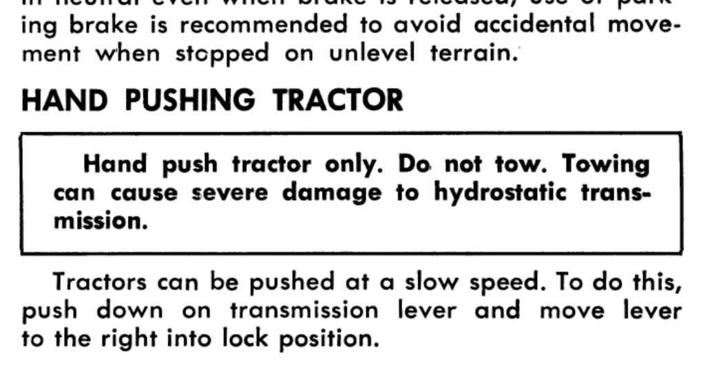

rmaynard 16,885 #3 Posted April 30, 2024 So, it doesn't run to be able to drive it onto your trailer? That's not a model that I know anything about. Having taken a quick look at the owners manual I found this on page 6. Good luck. Maybe someone will check in later with more knowledge. 2 Share this post Link to post Share on other sites

stevasaurus 23,619 #6 Posted April 30, 2024 By the sound of it, your choice is to jack up the rear end and put something with wheels under the tires. A creeper might work, a furnature dolly, a fork lift. One thing for sure, if you can't get it to free roll DO NOT push it. You will ruin the transmission. You might put the rear end on some good cardboard or a piece of paneling, then you could pull it slowly. Reguardless, you may have to lift the back of the tractor to get it on a trailer. If it is what I am thinking, 2 guys should be able to lift the back of the tractor up...not that heavy. 1 Share this post Link to post Share on other sites

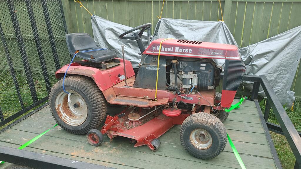

cJ_3D 9 #8 Posted May 1, 2024 After further investigation turns out the brake is stuck that's why it won't roll. Should be a simple fix. So I don't see a place for a fuel filter. Did these not come with it? I mean easy enough to add one but should I if it's not needed? The gas tank is nasty so will definitely need to be cleaned. So that and clean the fuel pump, add a fuel filter, clean the carb and get that brake unstuck. Also needs new tires, belts and battery. Should fire right up and go! 1 Share this post Link to post Share on other sites
stevasaurus 23,619 #9 Posted May 2, 2024 It probably did not come with a fuel filter, but it is cheap insurance. I have added them to my horses. That 252-H looks to be in good shape. Easy to clean up and enjoy. 1 Share this post Link to post Share on other sites
cJ_3D 9 #10 Posted May 2, 2024 (edited) 10 minutes ago, stevasaurus said: It probably did not come with a fuel filter, but it is cheap insurance. I have added them to my horses. That 252-H looks to be in good shape. Easy to clean up and enjoy. It's really not bad at all! I paid $100 for it so I think I got away alright. I'm going to clean up the tank and add the fuel filter for sure! I think I will do a complete repaint and new decals too. Edited May 2, 2024 by cJ_3D 1 Share this post Link to post Share on other sites
stevasaurus 23,619 #11 Posted May 2, 2024 Even though that is a verticle shaft engine, the deck is worth more then $100. You did very well. 1 Share this post Link to post Share on other sites
