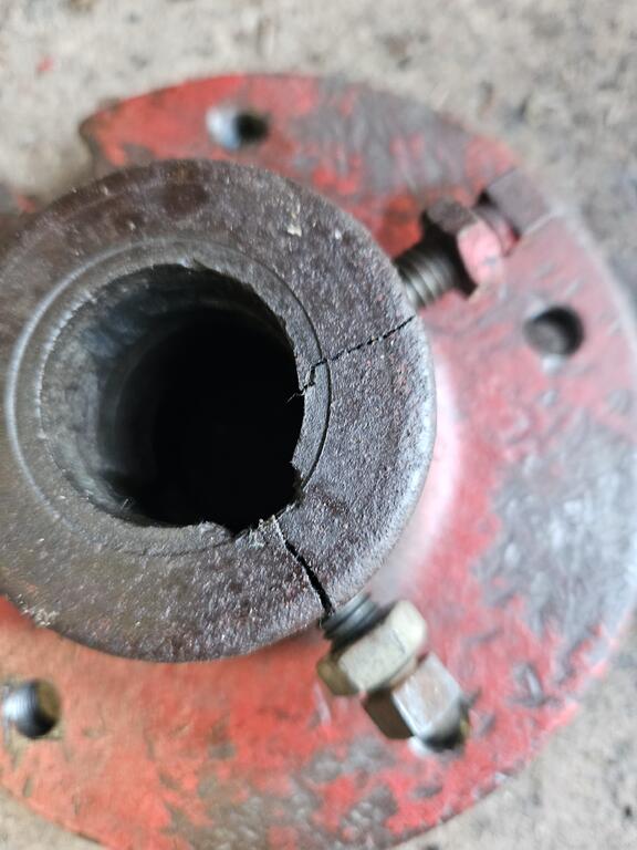

KW88 33 #1 Posted April 29, 2024 I have an 88 312-8 that has lot of wobble with rear wheels. Axles have no movement except less the 1/8" in/ out. Does anyone know if there is a bearing in the hubs and part # if so? Share this post Link to post Share on other sites
JoeM 9,642 #2 Posted April 29, 2024 (edited) A little play in and out is good. No bearing in hub just a tight fit. Sounds like your hubs are worn. Need to remove, replace the seal, install a new key, install new set screws, and apply some Loctite 660 quick metal to the bore, reinstall and let it set up. All that if the bore is not worn too bad in the hubs. If so need some replacement hubs. The Loctite 660 can take up about .005 in slop. Clean the shaft and bore with carb cleaner. If you have a way to measure the shaft and bore that would be a good idea. A-Z makes a taper hub that I have used on a shaft that is .007 worn. A good fit on an axle to hub is when you have to lightly tap the hub onto the axle. Edited April 29, 2024 by JoeM 2 Share this post Link to post Share on other sites
KW88 33 #3 Posted April 30, 2024 New hubs it is... Thanks JoeM 1 Share this post Link to post Share on other sites

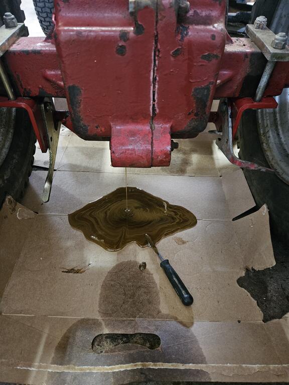

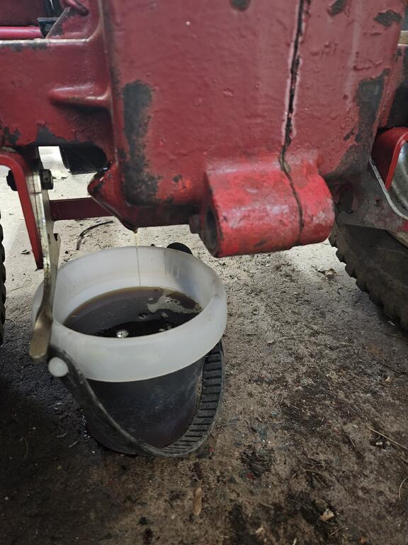

KW88 33 #4 Posted April 30, 2024 Well... this can't be good. Went to drain transaxle fluid and nothing came out the drain plug! So, took off the fill plug and it drained from there. Share this post Link to post Share on other sites

pfrederi 19,940 #6 Posted April 30, 2024 Stick an ice pick up in the drain and wiggle it around lets see what comes out Share this post Link to post Share on other sites
oliver2-44 11,248 #7 Posted April 30, 2024 (edited) 9 hours ago, KW88 said: Well... this can't be good. Went to drain transaxle fluid and nothing came out the drain plug! So, took off the fill plug and it drained from there. Look like it’s time for a diesel flush. Take a heavy wire and work a hole through that muck in the drain hole first. Put plug back in fill half full of diesel and drive up an down the road a while in all gears drain and repeat, repeat. Edited May 1, 2024 by oliver2-44 Share this post Link to post Share on other sites

KW88 33 #9 Posted April 30, 2024 When your horse has taco bell... 1 Share this post Link to post Share on other sites
Brockport Bill 2,226 #10 Posted May 1, 2024 6 hours ago, KW88 said: When your horse has taco bell... certainly looks like ya got some moisture in there -- ugh - i have had to do 3 kerosene flushes when a C165 we rescued had milky gear oil like that from being outdoors a few yrs with a cracked gear boot letting water into tranny 1 Share this post Link to post Share on other sites
kpinnc 17,265 #11 Posted May 1, 2024 (edited) The keyway in your hub pic is clearly wallowed out. Hopefully the axles aren't as bad. Sometimes you can have a standard 1/4 key slot cut onto the opposite side of the axle- IF they arent terribly worn from moving. And yes, new hubs would be a good thing. Edited May 1, 2024 by kpinnc 1 Share this post Link to post Share on other sites

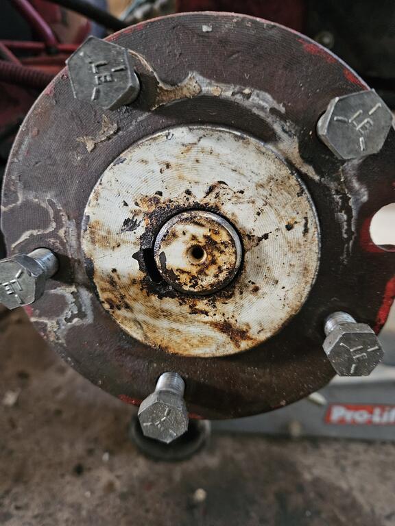

KW88 33 #12 Posted May 1, 2024 Bad find today on the 312-8 Share this post Link to post Share on other sites

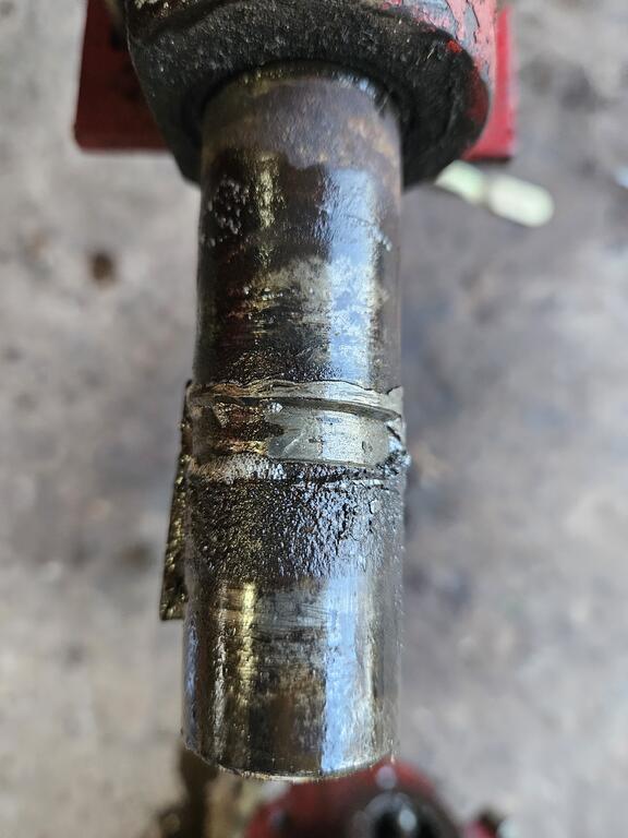

KW88 33 #13 Posted May 4, 2024 I need to replace axles on the 312-8 but I can't get the Woodruff out. Any tips? Share this post Link to post Share on other sites
kpinnc 17,265 #14 Posted May 4, 2024 21 minutes ago, KW88 said: I need to replace axles on the 312-8 but I can't get the Woodruff out. Any tips? If you're replacing the axles anyway, just saw the exposed ends off. No need to get the key out. Share this post Link to post Share on other sites
Bill D 2,604 #15 Posted May 4, 2024 On 5/1/2024 at 7:25 PM, KW88 said: Bad find today on the 312-8 That might be salvageable. If the keyway is still good, buy some replacement hubs from A to Z. He sells special hubs that clamp to the axle when tightened. Those grooves don't look to deep. Share this post Link to post Share on other sites
KW88 33 #16 Posted May 4, 2024 Anyone know the part # for axles ? There 1-1/8" Share this post Link to post Share on other sites
