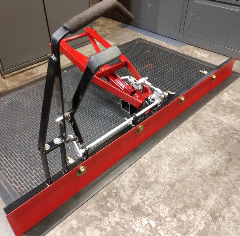

Horse Newbie 7,405 #26 Posted May 9, 2024 (edited) How high does it raise ?… enough to need rubber bumpers to protect tractor ? That is excellent craftsmanship.. looks like a factory piece ! Edited May 9, 2024 by Horse Newbie 3 Share this post Link to post Share on other sites
kpinnc 18,960 #27 Posted May 9, 2024 31 minutes ago, Horse Newbie said: How high does it raise ?… enough to need rubber bumpers to protect tractor ? That is excellent craftsmanship.. looks like a factory piece ! Thanks Tim! Much appreciated! It only raises about 3 inches off the ground, but there's another inch of adjustment. I'll tweak it a little, but didn't want to loose any cut depth until I figure it out. 3 Share this post Link to post Share on other sites
CCW 1,519 #28 Posted May 9, 2024 You have five slots angle adjustments. Do you find one of the angles to be most effective or is this still a work in progress? 1 Share this post Link to post Share on other sites

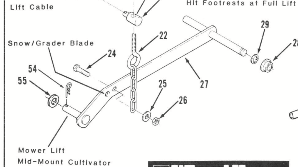

Handy Don 17,474 #29 Posted May 9, 2024 (edited) Looks terrific. Even better now that it’s dirty! The 3-ish inch range of the rock shaft lift arm is a constraint, for sure. To increase the lift range a bit for mower decks and accommodate “forward” center of gravity lift point of the deck frame, WH added the extra lift arm , #27 here. Note, though, that their grader blade attaches right next to the lift chain, so almost no benefit of extra lift range! Edited May 9, 2024 by Handy Don 3 Share this post Link to post Share on other sites
kpinnc 18,960 #30 Posted May 9, 2024 2 hours ago, CCW said: You have five slots angle adjustments. Do you find one of the angles to be most effective or is this still a work in progress? All depends on what I'm doing. But, I really like the "least" angle of the first detent. It moves material where I want, but without leaving a berm that I have to come back for on a second pass. 3 Share this post Link to post Share on other sites

87 416-8 horse 430 #33 Posted May 10, 2024 I might of missed it but where does it attach? Does it use a snow plow axel bracket? 1 Share this post Link to post Share on other sites
kpinnc 18,960 #34 Posted May 10, 2024 7 minutes ago, 87 416-8 horse said: I might of missed it but where does it attach? Does it use a snow plow axel bracket? Yes sir, connects with standard axle hitch. Only drawback would be the weight if used with manual lift. Definitely would need "Dial-a-height" for manual lift to set the cut depth. 2 1 Share this post Link to post Share on other sites
cod 136 #35 Posted May 11, 2024 Nice looking grader. Think a strip of rubber along the top in the center, maybe 10 or 12" long, would keep the rocks off the pivot? 2 Share this post Link to post Share on other sites
kpinnc 18,960 #36 Posted May 11, 2024 6 minutes ago, cod said: Nice looking grader. Think a strip of rubber along the top in the center, maybe 10 or 12" long, would keep the rocks off the pivot? Thanks. I was actually thinking of making a top edge guard that runs the full length. The top side of the blade is pretty sharp, maybe enough to be a little dangerous walking around it. 2 Share this post Link to post Share on other sites
