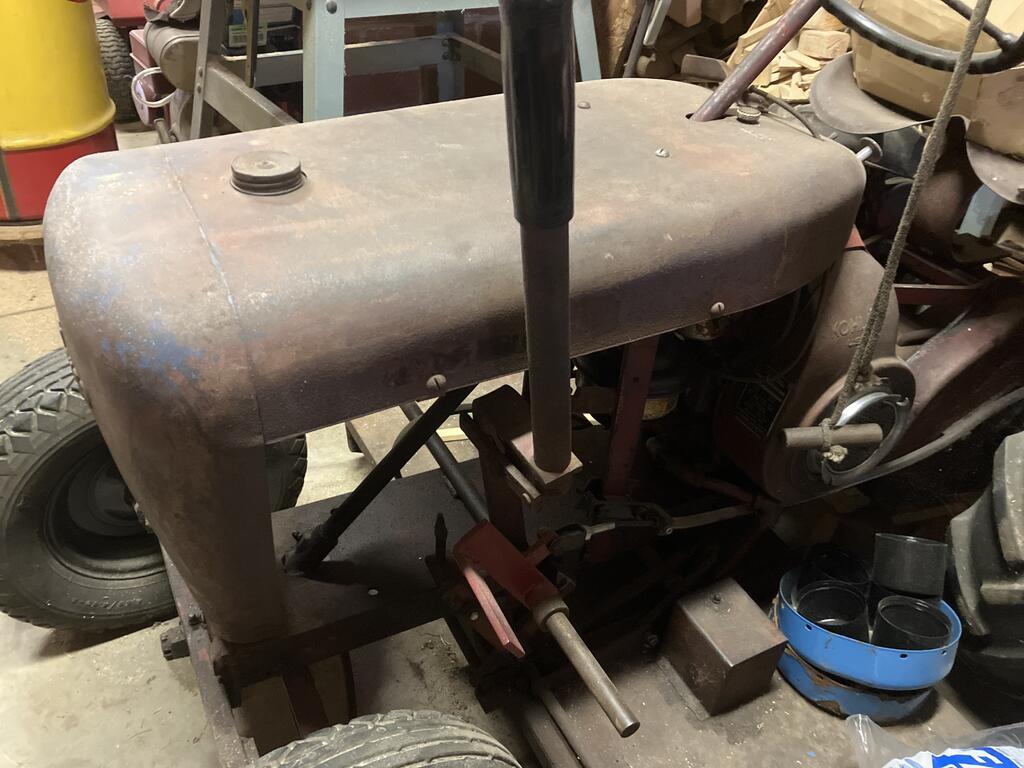

OoPEZoO 609 #28 Posted April 27, 2024 2 hours ago, Ed Kennell said: I'm no round hood expert Keith, but I am learning from this thread. IMO, those are Fe2O3 holes and need to be repaired. I think the only holes in that hood should be the four for the fuel tank straps and the two for the throttle control, and the three that bolt to the frame. Those two holes in front of the throttle were from a tool box that the PO added. I didn’t think they were original, but they are definitely NOT rust holes….if you look at the bottom of the picture I posted on the left and right side. There are holes on both sides and they are symmetrical. Same with the upper 2 holes, there are matching ones on the other side of the hood out of frame. Then there are more along the sides of the hood and they are also symmetrical on both sides. They are definitely intentional, that’s why I questioned if they were factory or someone got drill happy with it at some point. At this point, I plan to weld them and smooth them out. Just seems like someone put quite a bit of effort into putting them there, would love to know why….LOL Share this post Link to post Share on other sites
Ed Kennell 46,798 #29 Posted April 27, 2024 1 hour ago, OoPEZoO said: I didn’t think they were original, but they are definitely NOT rust holes I agree, those two at the bottom look like drilled holes. I didn't even notice those holes. I saw a couple at the top front that looked like rust thru. I can't imagine why a PO would drill those holes. Share this post Link to post Share on other sites

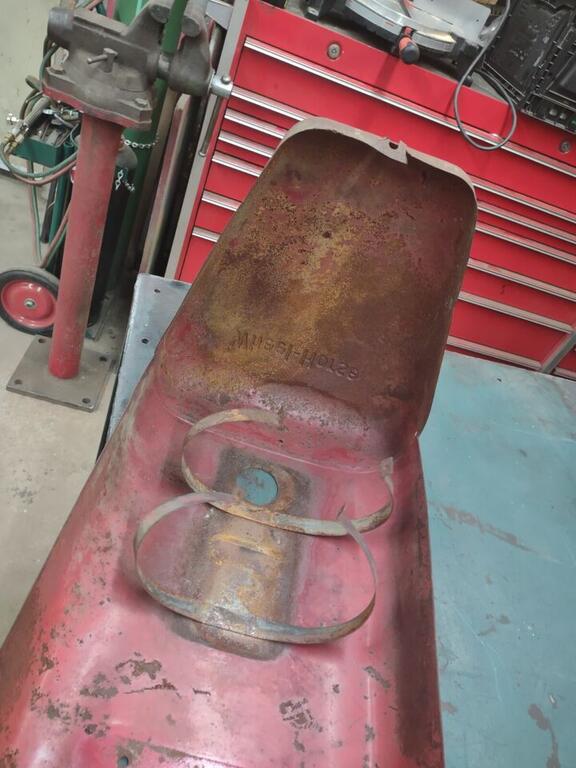

953 nut 68,177 #30 Posted April 28, 2024 9 hours ago, Ed Kennell said: I think the only holes in that hood should be the four for the fuel tank straps The gas tank straps on the RJ 35, RJ 58 and 59 and Suburban 400/401/450/451 were all welded to the bottom side of the hoode. The RJ 25 had a fuel tank stand. Share this post Link to post Share on other sites
Ed Kennell 46,798 #31 Posted April 28, 2024 2 hours ago, 953 nut said: The gas tank straps on the RJ 35, RJ 58 and 59 and Suburban 400/401/450/451 were all welded to the bottom side of the hoode. The RJ 25 had a fuel tank stand. My RJ (Wally) had the 3pc tranny making it a 58 or later. But it had a smooth non-ribbed WH name embossed hood with bolted on fuel tank straps, so that makes it a 57 or earlier. Maybe WH used some 57 hoods on some of the 58 RJs. So Wally could be a 57 1/2 RJ. 1 Share this post Link to post Share on other sites
wallfish 20,386 #32 Posted April 28, 2024 6 hours ago, Ed Kennell said: My RJ (Wally) had the 3pc tranny making it a 58 or later. But it had a smooth non-ribbed WH name embossed hood with bolted on fuel tank straps, so that makes it a 57 or earlier. Maybe WH used some 57 hoods on some of the 58 RJs. So Wally could be a 57 1/2 RJ. Many of those tank straps broke off due to vibration or whatever, so it's very common to see repaired bolted straps. Your tractor and hood is a normal everyday RJ-58 There are cast codes next to the shifter so the last number will indicate the year it was cast. 1 1 Share this post Link to post Share on other sites

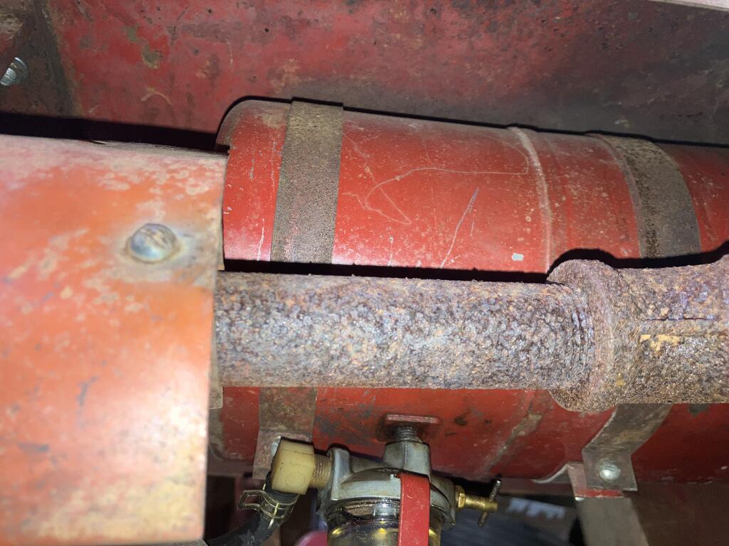

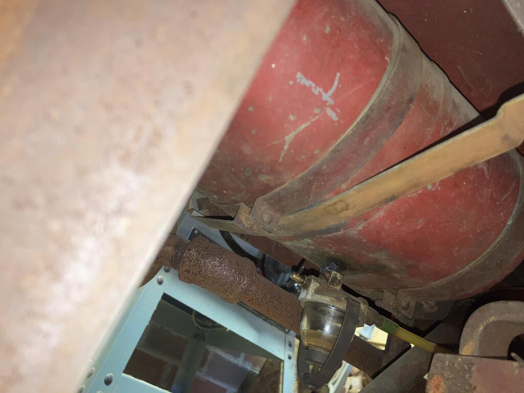

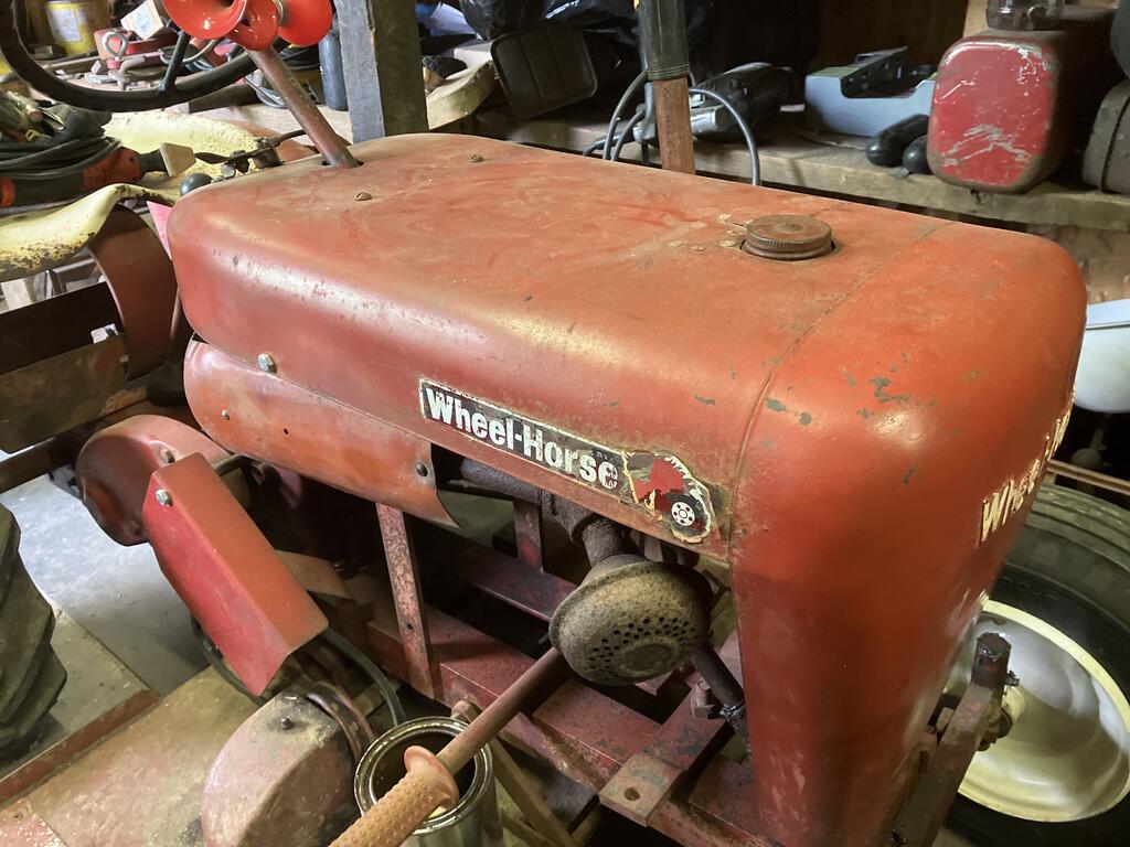

wh315-8 623 #34 Posted April 28, 2024 (edited) My 57, has two extra holes with a gas tank strap. Maybe added later, whose to know 67 years later. This tractor is all original with mower deck. My 59 & my 58s all have same holes as in last two pictures. Just 4 for the hood stand and 1 on the frame in bottom front. Edited April 28, 2024 by wh315-8 1 1 Share this post Link to post Share on other sites

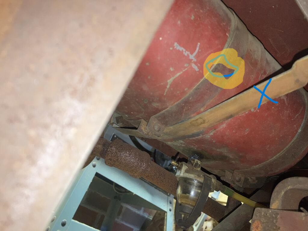

Ed Kennell 46,798 #35 Posted April 28, 2024 Yeah, the yellow strap looks like the factory welded to the hood strap and the blue X was added after the weld broke or to prevent it from breaking. My 58 had two straps bolted thru the top of the hood. Nothing thru the sides of the hood. 1 Share this post Link to post Share on other sites
