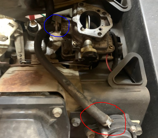

JoeM 9,347 #2 Posted April 24, 2024 Debbie I will try to give you some help here. In the picture there is a hose that leads from the fuel pump to the carb. It would be best to take the hose off at the carb, blue circled fitting, and place it in a water bottle and confirm that fuel is indeed making it to the carb. When you crank the engine over you should get a stream of gas from the hose, if so need to head into the carb. If not got to go to the tank. Let us know what you find. Share this post Link to post Share on other sites
eibbed 63 #3 Posted April 24, 2024 Joe, Thank you for your reply! I did check this hose and there was gas streaming from it. Share this post Link to post Share on other sites

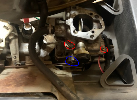

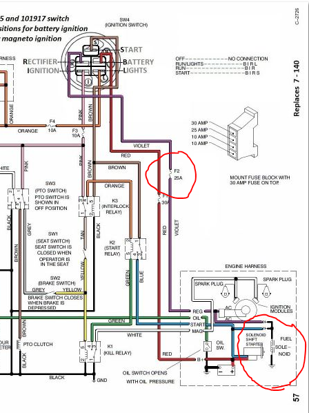

JoeM 9,347 #6 Posted April 25, 2024 2 hours ago, eibbed said: I did check this hose and there was gas streaming from it that is a good thing and maybe like Gary said could be electrical as the carb has a solenoid that turns off the fuel to the main jet. It is used as a anti backfire devise. If you have some way of testing for power a 12V test light can be used on the violet wire at fuse 2 when the key is in the run position there will be power to the violet wire and to the solenoid so it open and gas flows to the main jet. You can, if it is very quiet, put your ear near the back of the carb and hear a click when the key is turned to run. If that is all working then you will have to remove the top of the carb and it is very simple. Remove the fuel line and take out the 4 Philips head screws two are shown in red others are on the other side and easy to get to. lift straight up and that will allow the choke linkage blue to be removed after you lift it up. Be careful cause there are jet tubes that will come up with the top of the carb. That will allow you to look and see if gas in in the bowl. I will try to get some pic of one off tomorrow and post later on tomorrow evening. In the mean time maybe you can get a handle on the power checks. Share this post Link to post Share on other sites

eibbed 63 #9 Posted April 25, 2024 Thank you gentlemen once again!! I found the culprit! It was the 25amp fuse!! Who would think something so little and simple would cause all of my problems? Joe, I was getting ready to check the wires at the fuses and I thought why not check the fuses first and there it was!! Let me tell you, it was a Thank You Jesus moment!!!!! I can't tell you how much I appreciate all of the input from all of you!! Thank you, Debbie 1 Share this post Link to post Share on other sites
