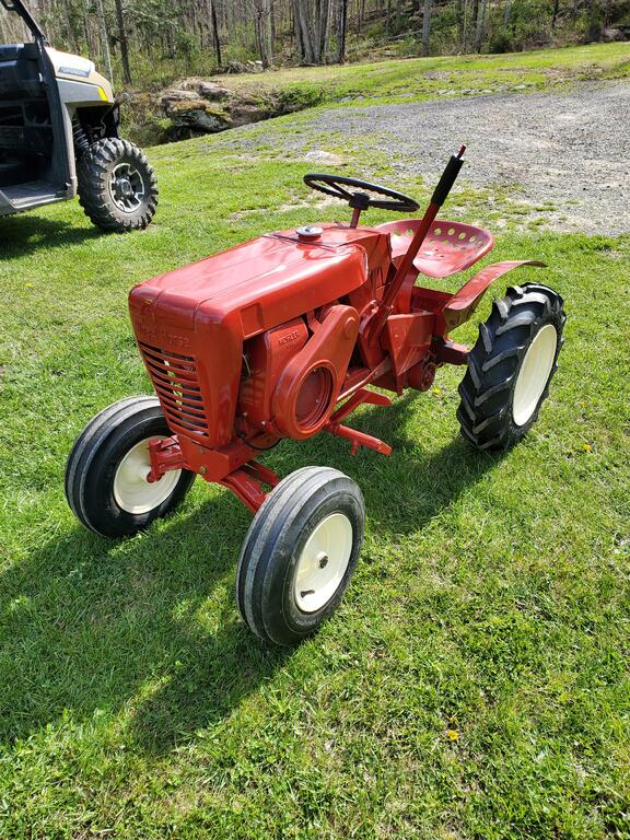

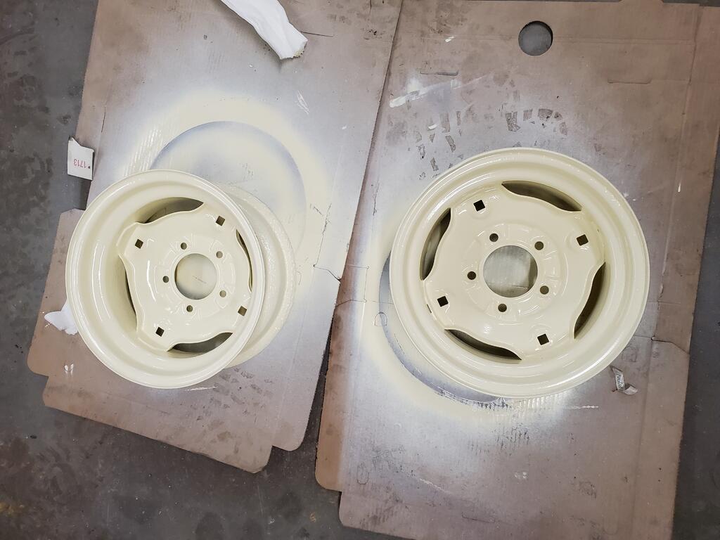

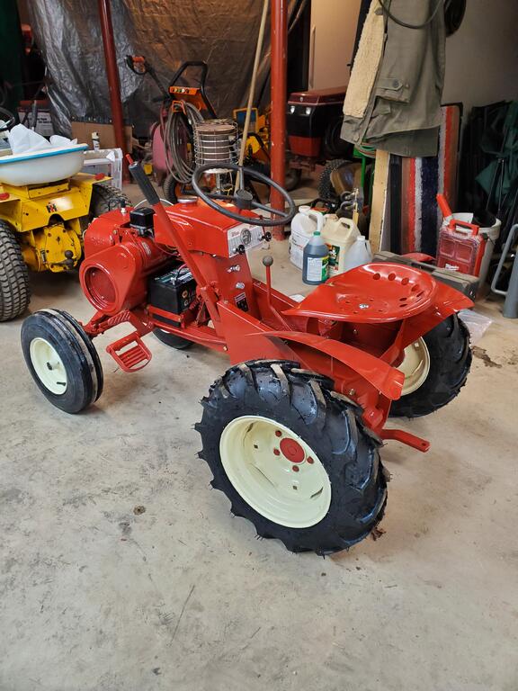

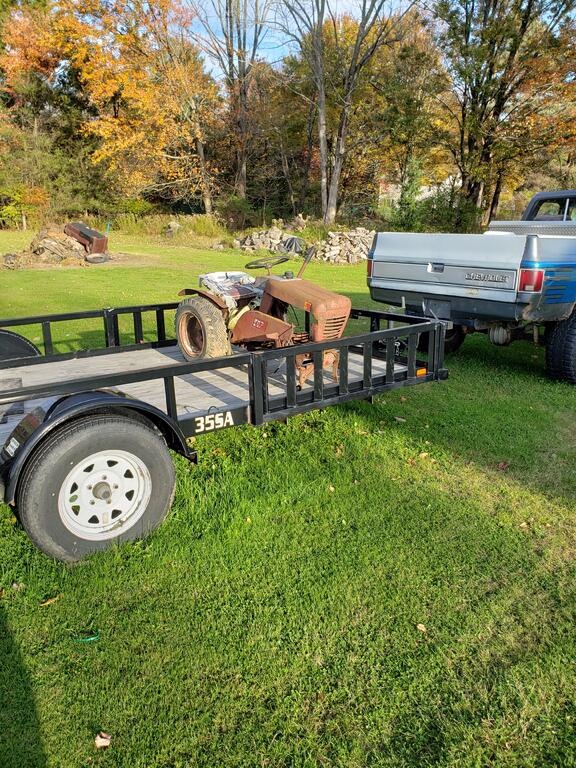

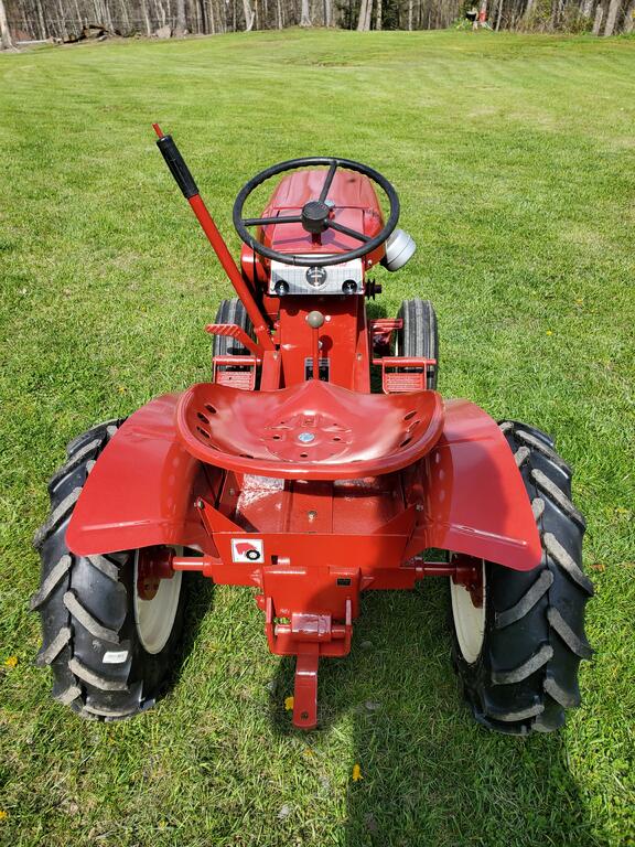

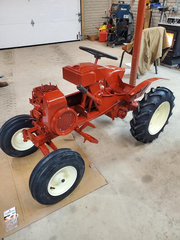

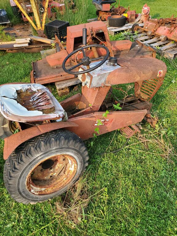

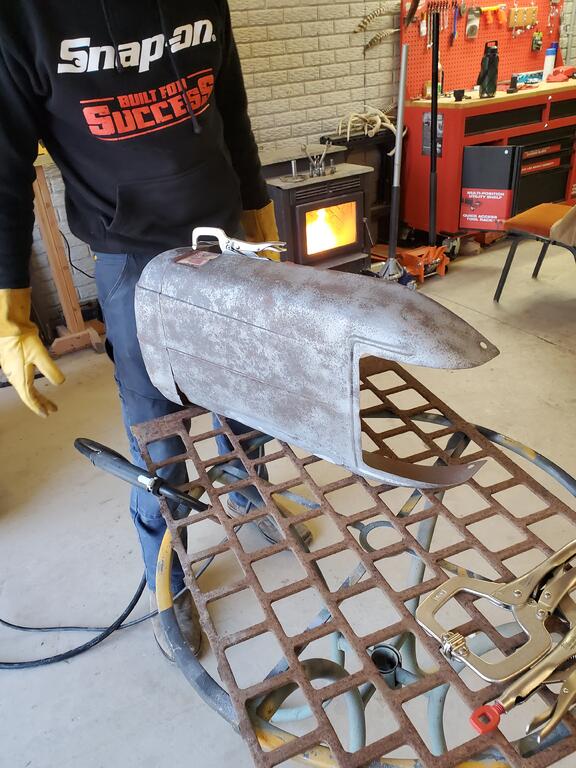

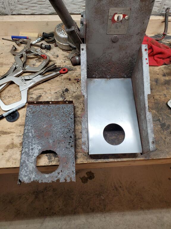

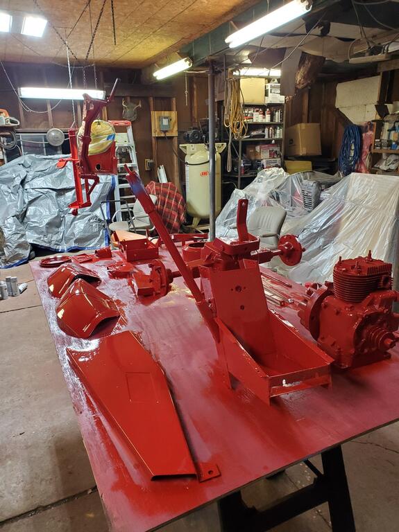

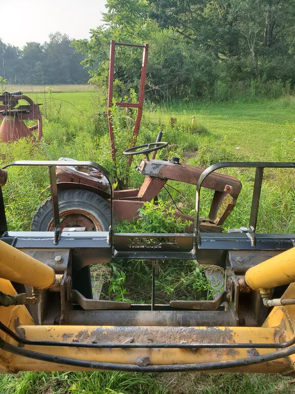

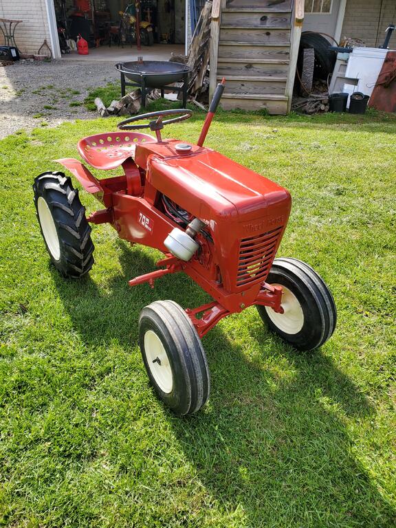

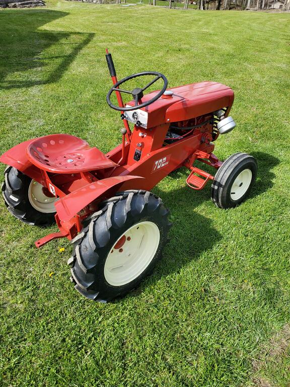

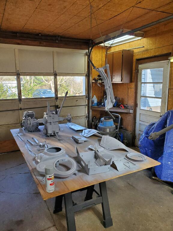

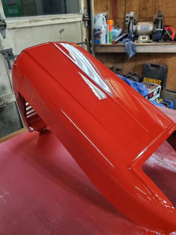

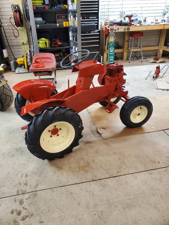

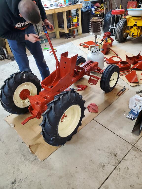

Cody 277 #1 Posted April 23, 2024 After months of restoring, we finally wrapped up this project, years ago a friend bought this 502 with hopes of restoring it one day, late last fall we finally dug it out of the weeds and started its journey. We opted to turn this into a 702 for a few different reasons, ease finding a somewhat original engine being the biggest. I'm not sure what the rear came from, it is a little newer because the brake band mount is orientated differently, I'm guessing 953/1054 because of the long axles but I'm not positive. The hood was by far the worst of it, believe it or not there's 2 hoods welded together along with a few hand made pieces and easily 30 hrs in it including paint. All that's left is to apply the 2 hood decals and the new knurled knobs for the hood. I'm very pleased with the way it came out. These little tractors are a lot of fun and my buddy got a first hand experience in the time and amount of money it takes to fully restore one. All I can say is they're a labor of love. 3 13 2 Share this post Link to post Share on other sites

kpinnc 16,224 #5 Posted April 24, 2024 (edited) Those wide (Commando or 8 4 speed?) rear axles really add a nice wheel track! Beautiful machine! Edited April 24, 2024 by kpinnc 3 Share this post Link to post Share on other sites
ri702bill 10,594 #6 Posted April 24, 2024 5 hours ago, kpinnc said: Those wide (Commando or 8 4 speed?) rear axles really add a nice wheel track! Beautiful machine! And you get the benefit of having better 5 lug hubs vs. the 3 lug originals... Nice work. 1 Share this post Link to post Share on other sites
rjg854 12,636 #8 Posted April 24, 2024 Now that's the way to save a tractor Great job Share this post Link to post Share on other sites
rmaynard 16,700 #9 Posted April 24, 2024 Great job. Share this post Link to post Share on other sites

stevasaurus 23,517 #11 Posted May 2, 2024 That is considered a 4 speed transmission, notice the brake drum mounted on the cluster gear shaft. That is why your linkage is mounted different. The horse is beautiful, nice job. Share this post Link to post Share on other sites
