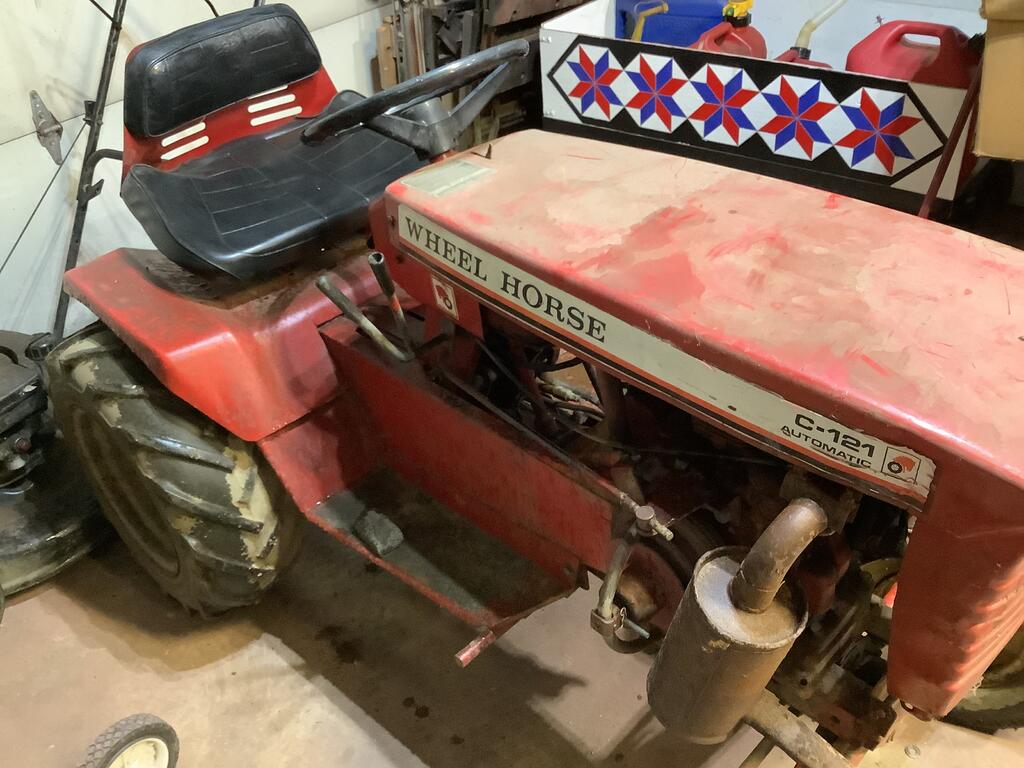

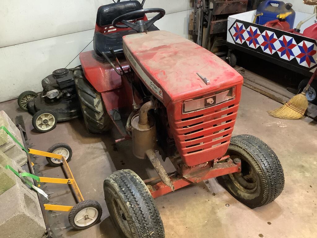

CRF857 291 #1 Posted April 23, 2024 Picked up this tractor this morning. Hood says C121. Model/serial numbers on side of dash say it is a 1969 Electro12. Hydraulic lift and a real nice seat. 4 5 Share this post Link to post Share on other sites
Achto 30,034 #2 Posted April 23, 2024 20 minutes ago, CRF857 said: Hood says C121. Model/serial numbers on side of dash say it is a 1969 Electro12. Nice tractor!! Wrong hood & dash tower to be a C-121. Probably wrong just decals. 2 1 Share this post Link to post Share on other sites

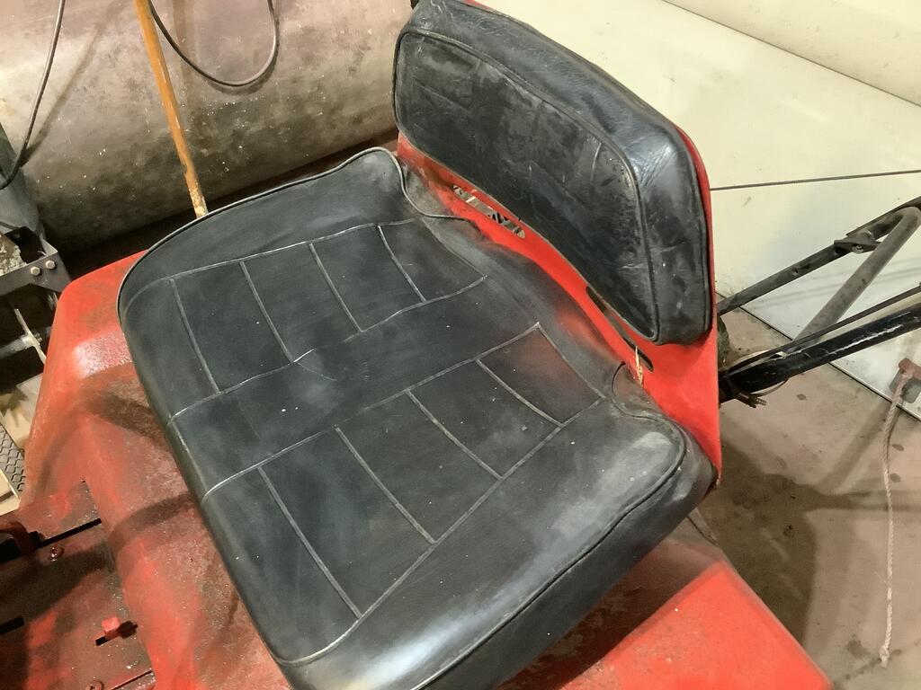

oliver2-44 11,025 #3 Posted April 23, 2024 Very nice original seat Share this post Link to post Share on other sites

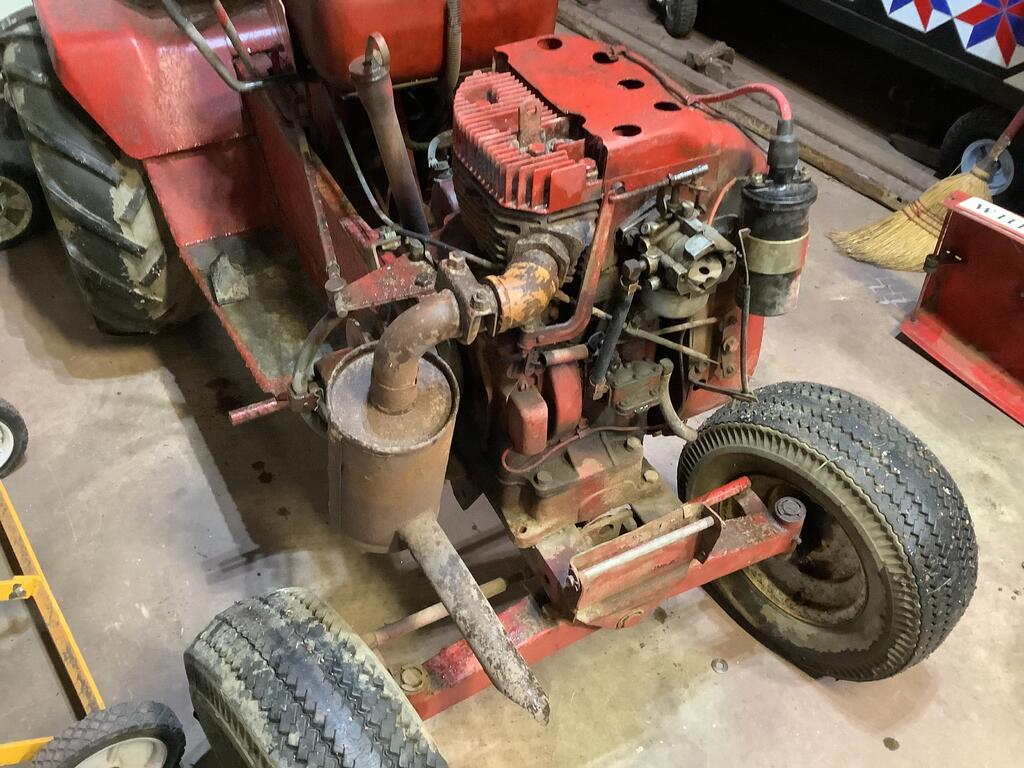

ebinmaine 74,964 #4 Posted April 23, 2024 The correct frame, hood, front tires for a 60s Electro. Manual PTO. Most Electros had Electric PTO... I think 🤔 How many cylinder head bolts? Fuel pump looks like a slightly later one too. @Achto @WHX?? Share this post Link to post Share on other sites
Achto 30,034 #5 Posted April 23, 2024 9 minutes ago, ebinmaine said: Fuel pump looks like a slightly later one too. Looks like the high volume pump more typically found on 16hp engines, Nothing wrong with it, if it works - run it. 1 Share this post Link to post Share on other sites
ebinmaine 74,964 #6 Posted April 23, 2024 8 minutes ago, Achto said: Looks like the high volume pump more typically found on 16hp engines, Nothing wrong with it, if it works - run it. That was part of what made me wonder if it was a 16 horse engine that somebody had transplanted but I can't count the cylinder head bolts 1 Share this post Link to post Share on other sites
Achto 30,034 #7 Posted April 23, 2024 15 minutes ago, ebinmaine said: I can't count the cylinder head bolts Me thinks I count 10 head bolts. That would make it a 16hp 1 Share this post Link to post Share on other sites
ebinmaine 74,964 #8 Posted April 23, 2024 4 minutes ago, Achto said: Me thinks I count 10 head bolts. That would make it a 16hp Yeah I thought I had that too Share this post Link to post Share on other sites
CRF857 291 #9 Posted April 24, 2024 7 hours ago, ebinmaine said: Yeah I thought I had that too 7 hours ago, Achto said: Me thinks I count 10 head bolts. That would make it a 16hp 7 hours ago, ebinmaine said: That was part of what made me wonder if it was a 16 horse engine that somebody had transplanted but I can't count the cylinder head bolts 8 hours ago, ebinmaine said: The correct frame, hood, front tires for a 60s Electro. Manual PTO. Most Electros had Electric PTO... I think 🤔 How many cylinder head bolts? Fuel pump looks like a slightly later one too. @Achto @WHX?? Yep! 10 bolts, 16 horse. 2 Share this post Link to post Share on other sites
