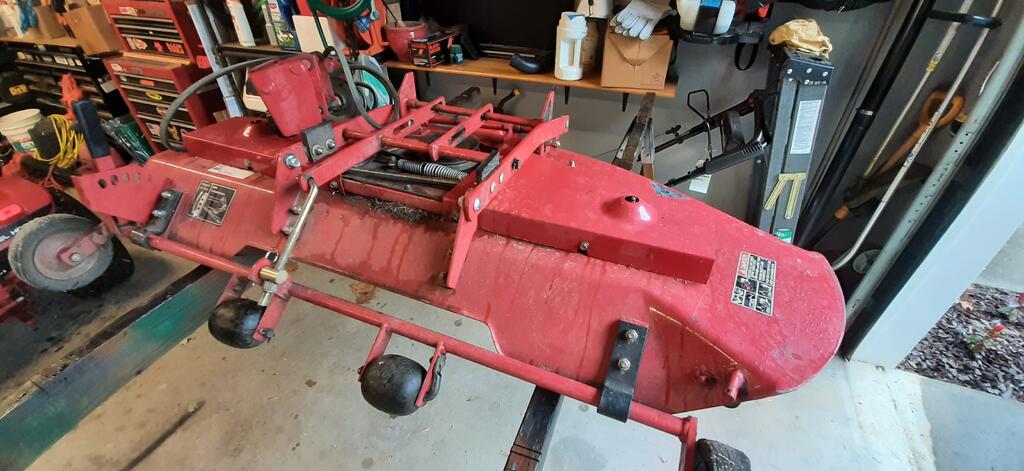

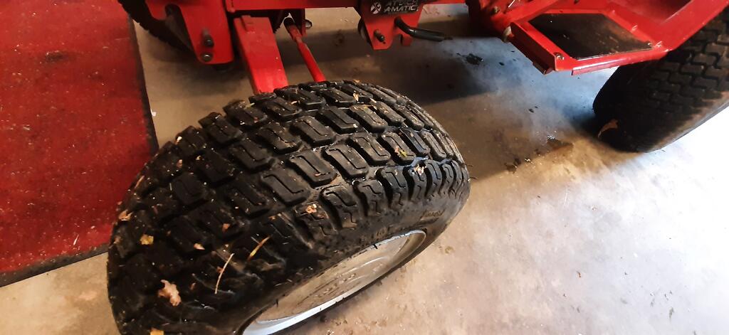

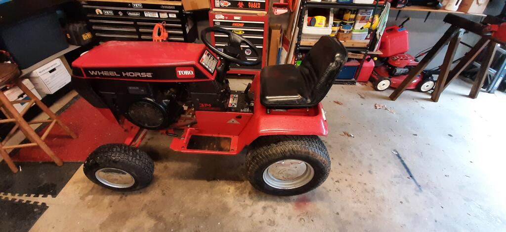

John c 136 #1 Posted April 23, 2024 I went sunday and picked up the 314H I'd found. It's in good original condition besides the tires, and a few seat cover cracks, looks like it'd been kept out of the weather til I brought it home in the rain, cranks and runs like new. 48" deck is solid top and bottom, the spindles are not corroded and spin freely. I'll go over it service the fluids, filters etc, clean the deck, inspect the bearings, belts etc. I'd been wanting a hydro drive WH for some time, I'm glad to have found it. 4 9 Share this post Link to post Share on other sites

OoPEZoO 593 #4 Posted April 23, 2024 Well done….I’ve always thought the 314-H was the perfect mix of simple yet very capable. That one looks like it will be an easy clean up and should be an excellent tractor. How many hours on it? 3 Share this post Link to post Share on other sites

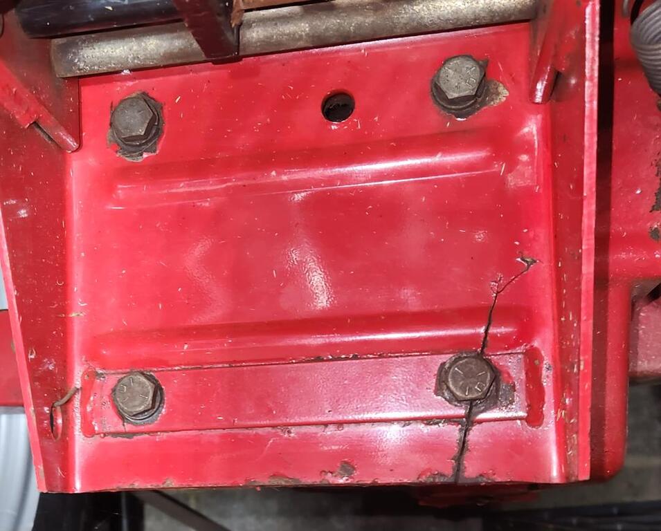

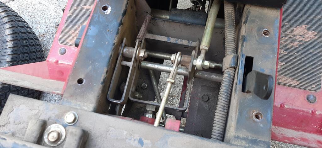

Brockport Bill 2,207 #9 Posted April 23, 2024 suggest when you are servicing it you look underneath and check the tranny frame plate that has 4 bolts attaching main frame to transmission -- be sure it doesn't have a stress crack fracture? 1 1 Share this post Link to post Share on other sites

peter lena 9,755 #11 Posted April 23, 2024 @Brockport Bill excellent reference point , there are so many things to look at on a recent pick up , always add something that was not even a thought , suggest a maintenance look over , think I would , do some cross bracing ,and weld over that crack . thats frame twist , generated , pete Share this post Link to post Share on other sites

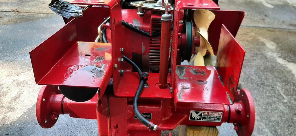

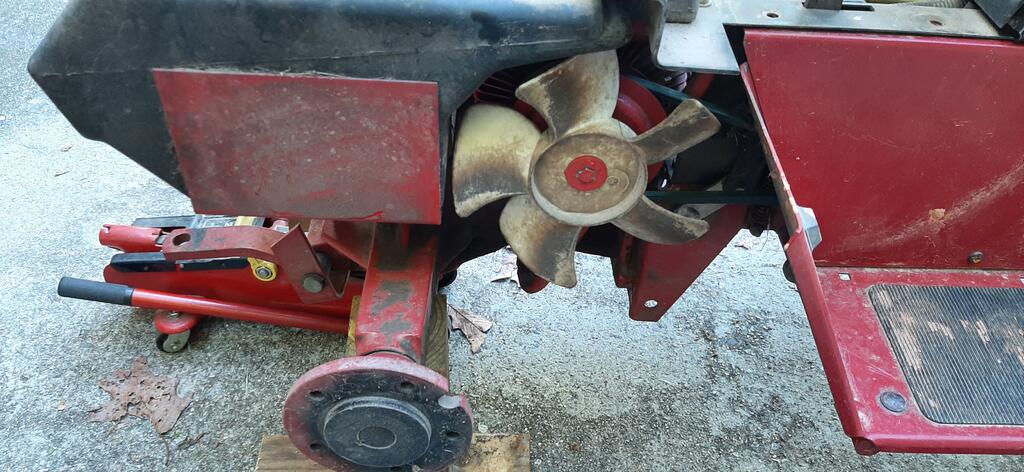

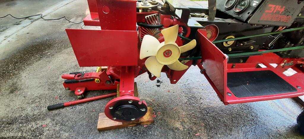

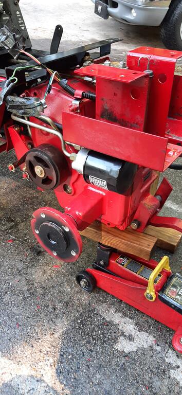

John c 136 #12 Posted April 23, 2024 I took the back fender/seat off and cleaned off the drive unit this morning, Before...... Share this post Link to post Share on other sites

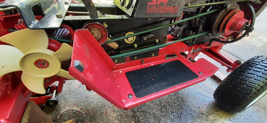

John c 136 #15 Posted April 23, 2024 f you become a site supporter there's no limit and your name will look good in red!............Well that's easy enough to fix I guess So here it is after I washed it. 2 2 Share this post Link to post Share on other sites
John c 136 #16 Posted April 23, 2024 Can somebody tell me the year of mfg, Share this post Link to post Share on other sites
Brockport Bill 2,207 #17 Posted April 23, 2024 5 minutes ago, John c said: Can somebody tell me the year of mfg, per partstree.com its 1994 Share this post Link to post Share on other sites

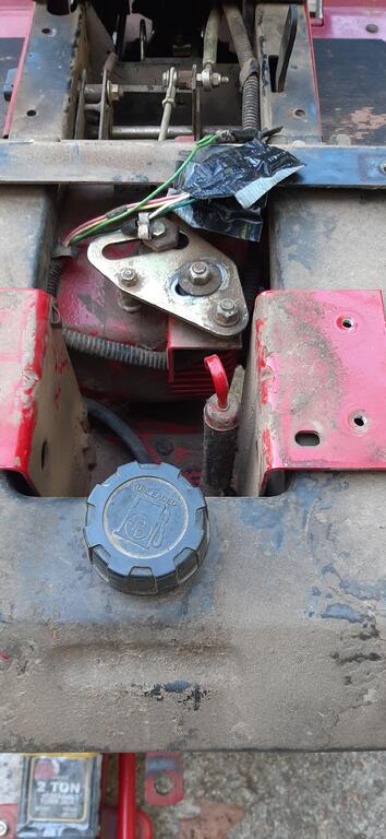

Bill D 2,593 #18 Posted April 23, 2024 1 hour ago, John c said: f you become a site supporter there's no limit and your name will look good in red!............Well that's easy enough to fix I guess So here it is after I washed it. Take off the cross bar that holds the front tabs on the gas tank and check for cracks where it mounts to the hood stand. Add thick fender washers when reassembling. 2 Share this post Link to post Share on other sites

lynnmor 8,612 #20 Posted April 23, 2024 Be sure to oil every pivot point in there while it is apart, I use motorcycle chain oil so it has some staying power. Do not oil the friction washers on the speed cam plate. 1 Share this post Link to post Share on other sites
