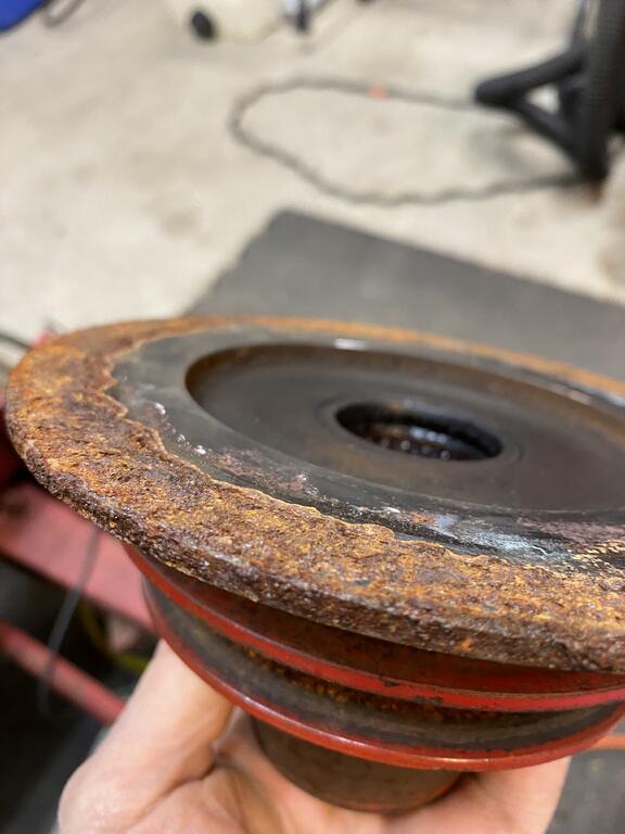

ebinmaine 80,755 #26 Posted May 5, 2024 11 minutes ago, Sparky said: PTO WOW is that rough!! 1 hour ago, Sparky said: minus the seat, how the heck does that get swapped? 3/8 hex "nut driver". Sockets are almost always too large an outer diameter. 1 Share this post Link to post Share on other sites

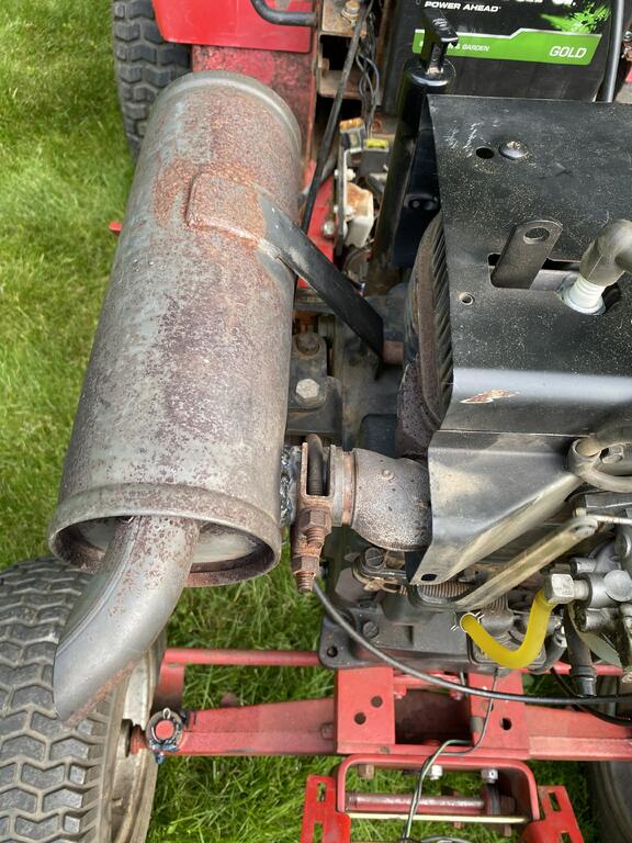

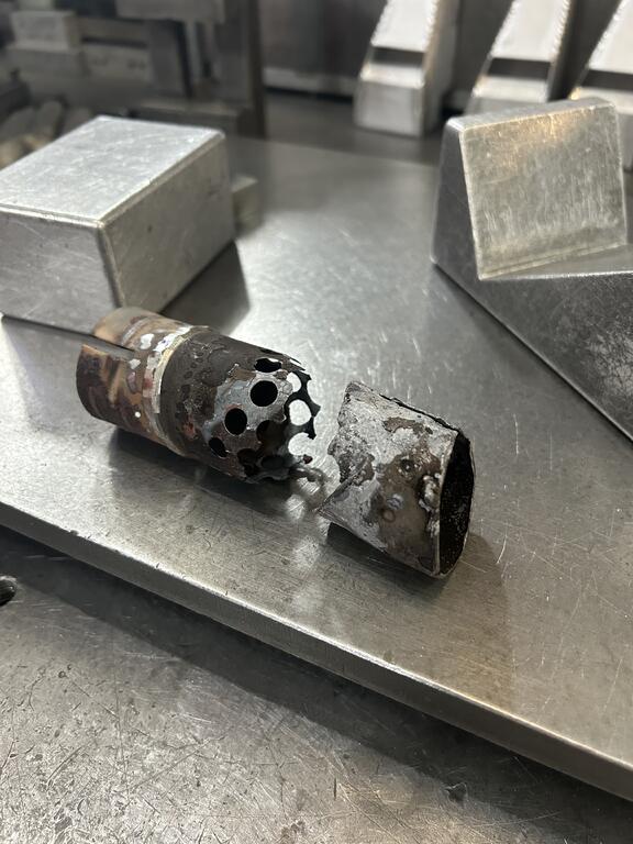

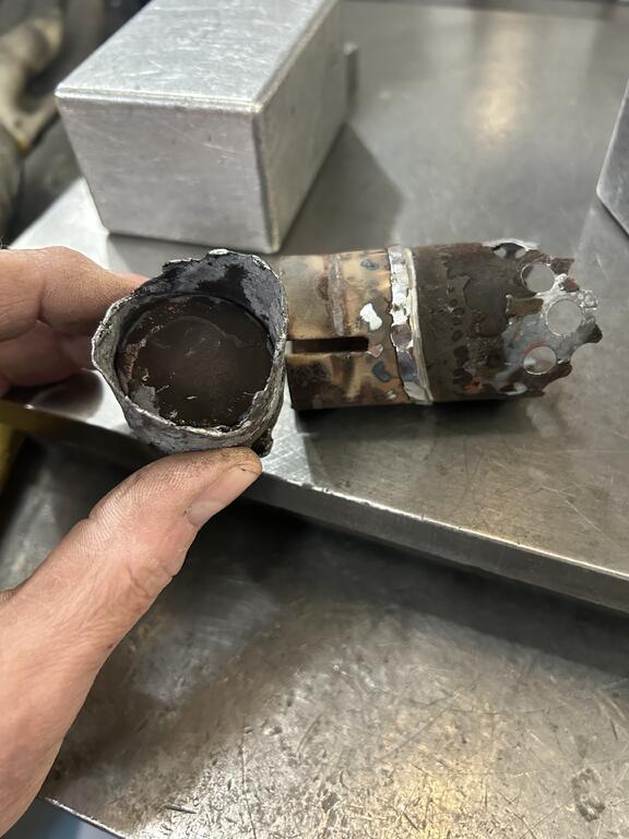

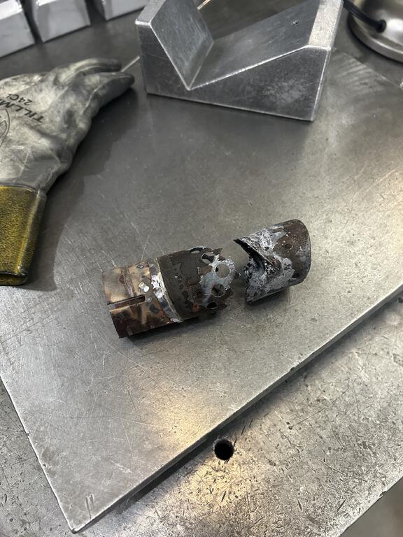

Sparky-(Admin) 26,384 #32 Posted June 5, 2024 Been awhile…but still banging away on this one. Like I said it fires up and runs, but would run good and then run crappy for awhile. Occasionally it would straighten out and then once again start running lousy. Tried a different “proven good” carb from my other 414 but no change. @wallfish mentioned something about stuck valve and/or blocked exhaust. Valves (both) seem fine. Pullled the canister muffler and BAM!! Something big was in it! Had a friend that welds take it to his shop and get into it. Seems the exhaust inlet pipe goes deep into the muffler body and inside it’s welded /capped off and has perforations in the pipe (never knew that). The stub rusted off where the perforations are and that chunk was being pushed up against the outlet when the 14 Magnum was throttled up past the 3/4 mark. My buddy got the piece out, welded it back up and I reinstalled it last night. Fed it all the onions for like 15-20 minutes and it never skipped a beat! Just ran and ran and ran ! 8 Share this post Link to post Share on other sites
OoPEZoO 609 #33 Posted June 5, 2024 Haha…..i had the same problem but different symptoms with my 314-8 a few years ago. I had this terribly obnoxious rattle at full throttle. It has always run great and has never burned a drop of oil in the 20ish years I’ve had it. First, I thought the bearing was going out in the PTO bell. Nope. Then had myself convinced that it was internal to the engine and it was going to blow any minute. I parked it for months until I knew I would have time for major surgery. Took the muffler off first with intent of pulling the motor and yup, that was it. Inlet pipe broke off inside and was rattling around in the bottom, but only under full throttle. I made a new perforated piece out of black pipe and welded the original flange onto it. love it when it’s something relatively simple 2 1 Share this post Link to post Share on other sites

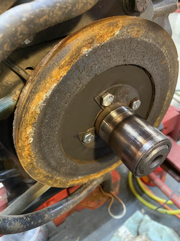

oliver2-44 11,755 #35 Posted June 6, 2024 On 5/5/2024 at 6:00 PM, Sparky said: Looks like I’ll simply be replacing it all I’d take a wire wheel to that PTO bell surface and see what it really looks like. 2 1 Share this post Link to post Share on other sites

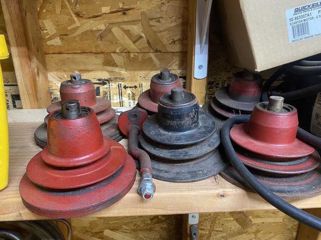

Sparky-(Admin) 26,384 #36 Posted June 6, 2024 13 hours ago, oliver2-44 said: I’d take a wire wheel to that PTO bell surface and see what it really looks like. I’ll try it…but I have 7 nice ones on my parts shelf so I see a simple swap in its future. 1 Share this post Link to post Share on other sites
squonk 48,137 #37 Posted June 6, 2024 That PTO bell needs to be turned into a paper weight! 1 Share this post Link to post Share on other sites
ebinmaine 80,755 #38 Posted June 6, 2024 3 hours ago, Sparky said: I have 7 [PTO bells] Running low??? 1 Share this post Link to post Share on other sites
squonk 48,137 #39 Posted June 6, 2024 The PTO bells are competing with the snowplows for garage space. Time to build another bay! 1 1 Share this post Link to post Share on other sites
oliver2-44 11,755 #40 Posted June 7, 2024 4 hours ago, squonk said: That PTO bell needs to be turned into a paper weight! I guess with less horse in Texas we try to resurrect parts some of yall would scrap. Share this post Link to post Share on other sites
Sparky-(Admin) 26,384 #41 Posted June 7, 2024 4 hours ago, ebinmaine said: Running low??? YEP! I was wrong, only have 6.. and ones the older style 1 Share this post Link to post Share on other sites
