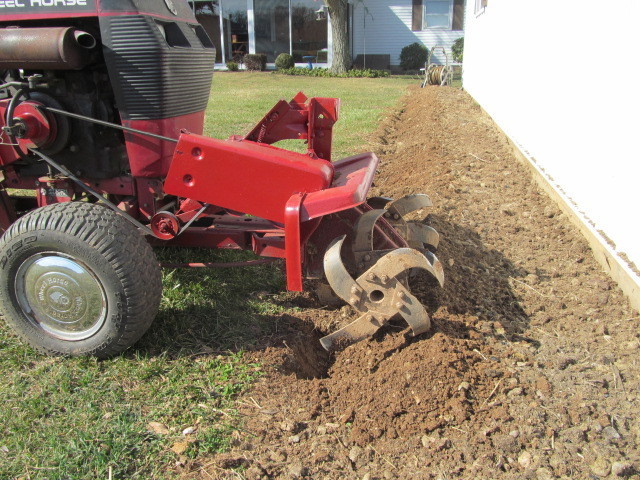

Monstrosity 1,147 #1 Posted April 20, 2024 Does the tiller spin backwards or forwards. Should I twist the belt so it spins backwards or keep the belt normal. In the picture it is twisted to drive the tines backwards (counter clockwise as pictured) Share this post Link to post Share on other sites

squonk 45,826 #7 Posted April 20, 2024 Look at the tines on Ed's garden scratcher. You can see the leading edge of the tines and tell which way it turns. You really want the tine to "scoop the dirt" and flip it over. 1 Share this post Link to post Share on other sites

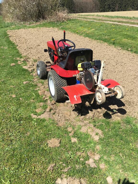

Tractorhead 9,217 #10 Posted April 21, 2024 (edited) Made me one myself out of an old Handsteering tiller. enlarged it with 2 more Shovels and refitted it with a stronger Engine. that thing digs like a charme. Oh, forgotten - for a quick stop i added an Automatic Clutch on the Engine - Throttle can be pulled on the tiller or with a remote bowden. It sits on the rearhitch with an self constructed Mount. up and down is made with the Original Wheelhorse hitch. i let the Original Tyres on it to move it simpler arround in my Shed. Edited April 21, 2024 by Tractorhead 3 Share this post Link to post Share on other sites

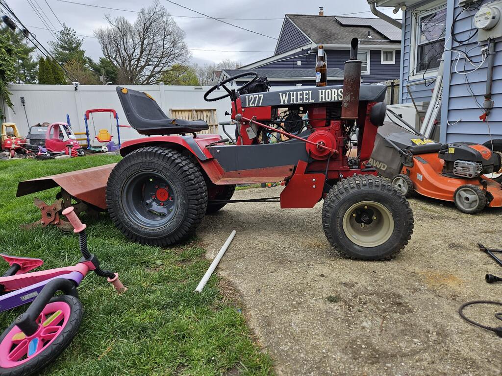

Monstrosity 1,147 #16 Posted April 23, 2024 So it worked better opposing the direction of the tractor 2 Share this post Link to post Share on other sites
Rick3478 445 #17 Posted April 23, 2024 8 minutes ago, Monstrosity said: So it worked better opposing the direction of the tractor I had the same experience with mine when I put a tiller on it. The tines do more pushing than the wheels. In fact the transmission has to hold the tractor back, which doesn't work so well with hydros. One bright note is that the belt is actually long enough to put a twist in, so you have the option of forward or reverse tine rotation. I'll never try it on a hydro again, though. It's gear drives with the tiller for me. 1 Share this post Link to post Share on other sites
