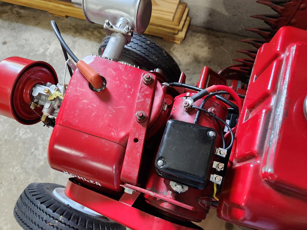

Racinbob 13,193 #35 Posted April 27, 2024 Got her all done and installed. It cranks like it never has since I got the tractor. The insides cleaned up nice. I forgot to take a picture. I gave up on the pulley. I looked at a bunch of videos and never saw one like it. I just didn't want to chance damaging it. I had picked up a new regulator quite some time ago because the mount was different. Instead of saddling the body it mounts lengthwise. Drilled and tapped a couple of 1/4-20's and we're good to go. Prior to this work the voltmeter was pretty erratic but now it's nice and steady. I'm ready for another summer of scalping briars. 2 2 Share this post Link to post Share on other sites
