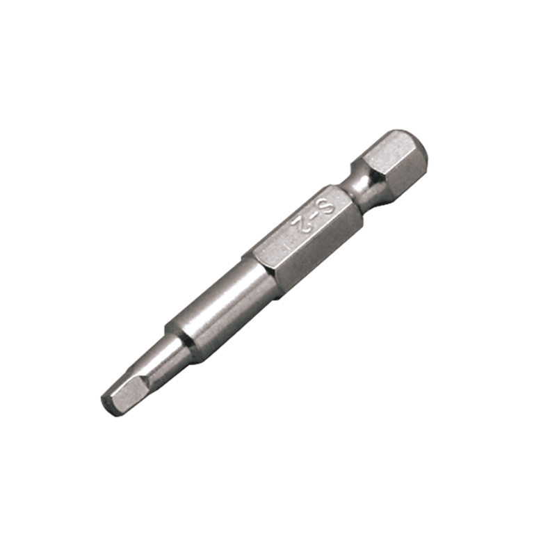

kpinnc 15,717 #6 Posted April 18, 2024 And square bits grip better than phillips. Just be aware if it strips with a square bit, it's not coming out... 1 Share this post Link to post Share on other sites

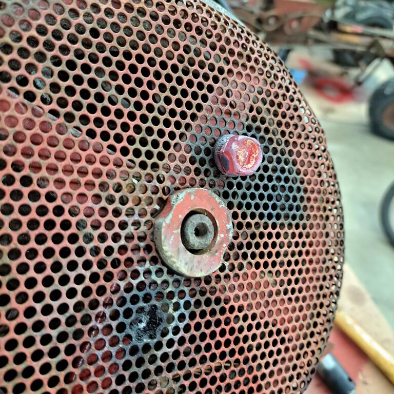

87 416-8 horse 429 #10 Posted April 18, 2024 I’ve had luck with heating them up and instantly spraying penetrating oil on them. And then hit them with a manual impact like EB said. IMG_2268.webp 2 1 Share this post Link to post Share on other sites

Pullstart 68,181 #14 Posted April 18, 2024 10 hours ago, 87 416-8 horse said: I’ve had luck with heating them up and instantly spraying penetrating oil on them. And then hit them with a manual impact like EB said. IMG_2268.webp 6.79 kB · 0 downloads I have an old chunk of paraffin wax sitting in my torch tray. That heat pulls in the wax and lubes the threads well. 1 1 1 Share this post Link to post Share on other sites
