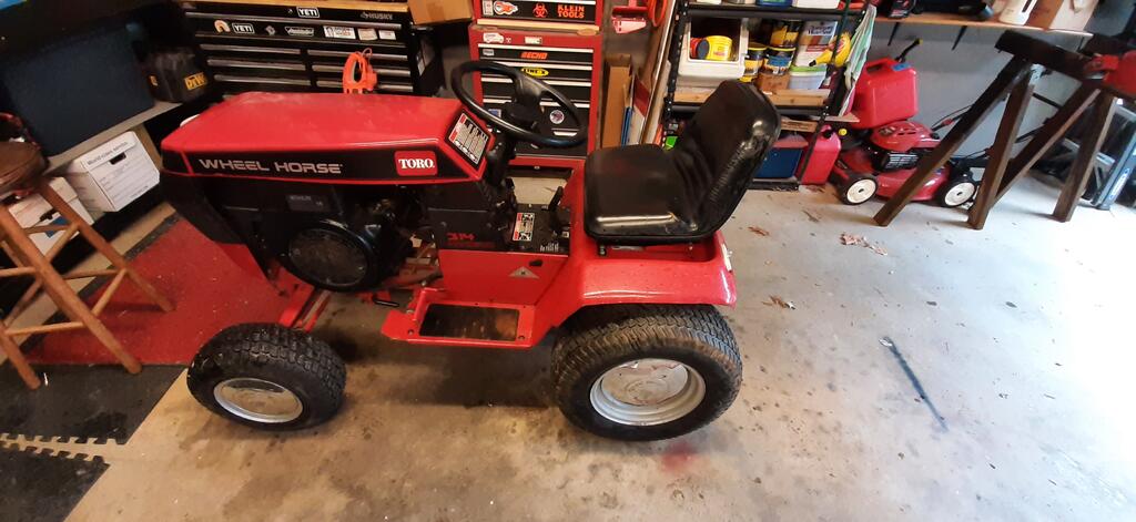

John c 177 #26 Posted April 23, 2024 thanks for the comments and help learning about the transmissons. I picked it up sunday, I posted some pictures in the tractors section. Share this post Link to post Share on other sites
Ed Kennell 46,197 #27 Posted April 23, 2024 1 hour ago, John c said: I picked it up sunday, Wow, nice 314 and it came with $300 worth of hub caps. How many hours? Share this post Link to post Share on other sites
John c 177 #28 Posted April 23, 2024 240hrs, original owners son inherited it and had no need for it 1 2 Share this post Link to post Share on other sites
