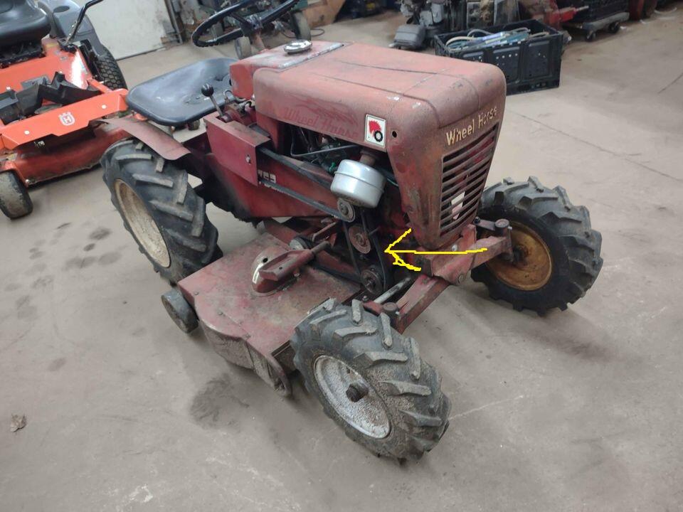

Looking to replace this belt that drives the deck, but can't find a parts list with it and of course there's no numbers or anything on the belt.
This belt is WAY too long and i need to find a part number or size/dimension for the correct one.
Thanks for any help
peter lena
@wminmi  part of the problem is probably related to related pulleys that don't  move easily / smoothly , check those out also, another member familiar with your set up will chime in  on the belt issue , Pete
  • Like 1
squonk
4L280    1/2" X 28" belt
