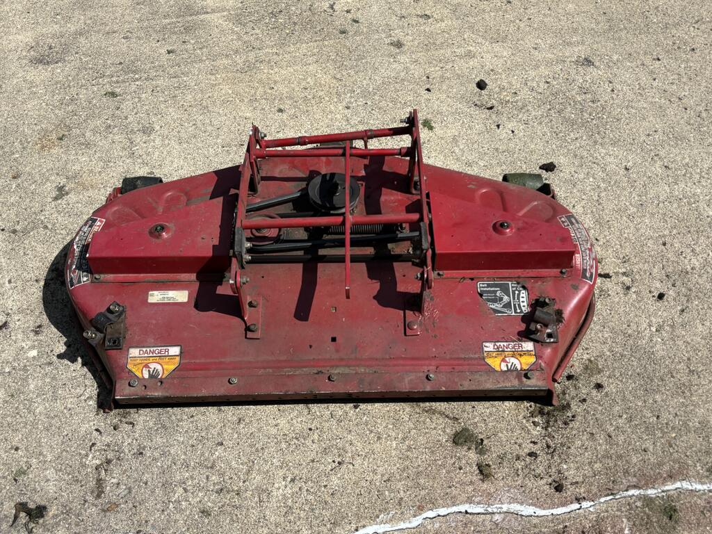

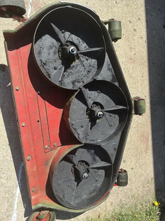

JimSraj 566 #1 Posted April 10, 2024 (edited) The following Reference #s and Part # are described as’Special’ washers for over and under the blades as well as above the Idler Support Bar, on a 78345 deck. Ref # Part#. Description 29. 3256-28. Washer - Special ( goes under the blades) 32. 107675. Washer - Special ( goes above Idler Support Bar) 33. 920257. Washer x Special. (goes above the blades) Anyone know what is it that makes them ‘Special’? Edited April 10, 2024 by JimSraj Added text 1 Share this post Link to post Share on other sites

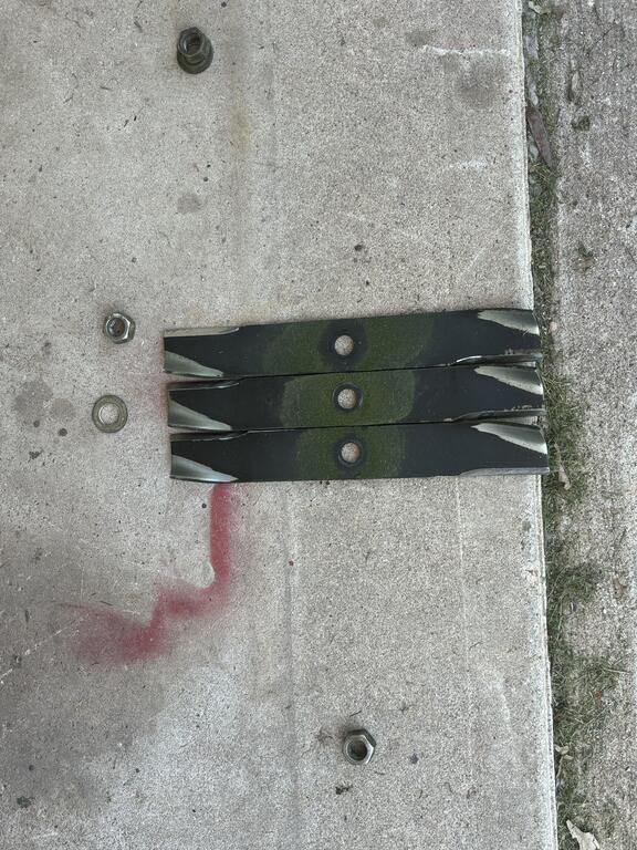

JimSraj 566 #5 Posted April 11, 2024 My thinking (guessing) was that they may be, as gwest says special dimension, but the wave washer (bent in a special way) is a good possibility also. I was hoping someone with an original (if there is such a thing) 78345 deck might chime in. Both of the ones I have came to me with only one washer below the blade and the ones on the support bars are beat so can’t tell much about them. 1 Share this post Link to post Share on other sites

Lane Ranger 11,840 #7 Posted April 11, 2024 I just sharpened blades on this deck last week and did take a picture of the blades with one washer and not. This goes on top the blade but there is a much thinner one used under the blade. My pic would be of the #33. Washer on top. But #29 is the under blade washer. They are different and “special” since Toro made them so! 3 Share this post Link to post Share on other sites
