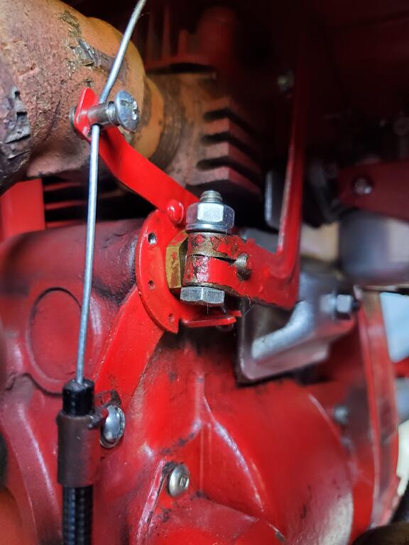

Racinbob 12,765 #7 Posted April 10, 2024 I modified mine like this. No welding needed. 2 1 Share this post Link to post Share on other sites
