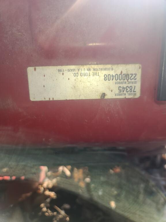

Cee245 846 #1 Posted April 7, 2024 Does anyone know the proper size of blades and belt length for model # 78345 ? S/N is 220000XXX. Looks like a 42" Does this mean its a 2002? Came with my 93 314-8. Thanks Share this post Link to post Share on other sites
gwest_ca-(File Mod) 11,875 #2 Posted April 7, 2024 Drive belt 102742 replaced by 94-2501 (1/2" x 103") Spindle belt 6738 (1/2" x 86") 106077 replaced by 106636 3-blade set (3/4" round hole) 1 Share this post Link to post Share on other sites
