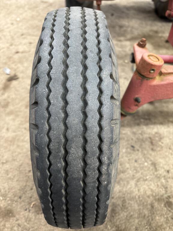

fourwheelhorseman 362 #1 Posted April 6, 2024 My left hand front tire on my 753 has no less that 4 plugs in it, it leaks air as fast as I put it in. Anyhow, not knowing anyone around my area that collects wheelhorses, oem is most likely out of the question. What’s a good option for a replacement front tire other than a tri-rib. I’m wanting to go for the original tread design if possible. Thanks! 2 Share this post Link to post Share on other sites
ebinmaine 78,032 #2 Posted April 6, 2024 Can you post a pic of what's on there? 1 Share this post Link to post Share on other sites

fourwheelhorseman 362 #9 Posted April 6, 2024 (edited) What I have is Goodyear 4.8 x 4 x 8… 2 ply. Just wanting one to match. Edited April 6, 2024 by fourwheelhorseman 1 Share this post Link to post Share on other sites
ebinmaine 78,032 #10 Posted April 6, 2024 33 minutes ago, fourwheelhorseman said: What I have Not counting the plugs, how cracked up is the tire you want to replace? 3 hours ago, pfrederi said: want to tube it I'd put a second vote for installing tubes. I put tubes in ALL the tires we swap nowadays. Old reinstallation or newly mounted off the shelf. 1 Share this post Link to post Share on other sites
fourwheelhorseman 362 #11 Posted April 6, 2024 It’s bad man… I THINK the plugs are an attempt to fill in big cracks. I’ll take a few pics in a bit 1 Share this post Link to post Share on other sites
Lee1977 7,631 #12 Posted April 6, 2024 Goodyear stopped making those around 50 or more years ago. Save yourself some problems and buy two new matching 4.80 x 8 4ply tires. 1 1 Share this post Link to post Share on other sites
ri702bill 11,627 #13 Posted April 6, 2024 (edited) @fourwheelhorseman GOT ONE!! Goodyear Super Rib from a 702. PM me.... Just like in the picture, but much better condition. Bill Edited April 6, 2024 by ri702bill 1 1 Share this post Link to post Share on other sites
