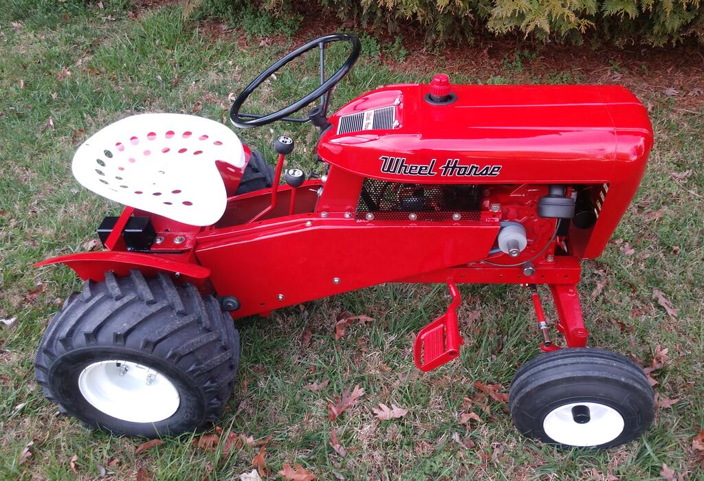

Ed Kennell 44,810 #13 Posted April 2, 2024 A few of my rattle can Queens that found new castles. 3 6 Share this post Link to post Share on other sites

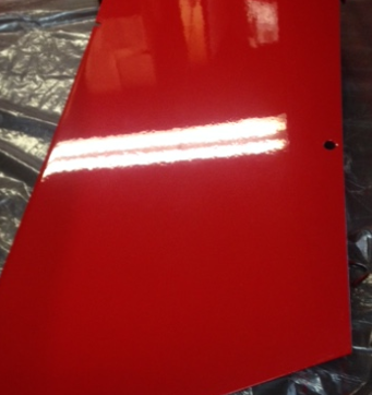

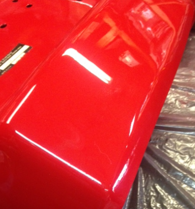

kpinnc 17,132 #20 Posted April 3, 2024 (edited) 12 hours ago, Achto said: This is one reason why I use stainless bolts when I do a resto. Never have to go back and touch up hardware. Not to mention they give a little bling that never rusts! I use stainless fasteners wherever I can. I also flip washers upside down on sheetmetal so the edges don't dig into fresh paint. My latest rattle can job. Hope it cures well enough to buff later.... Edited April 3, 2024 by kpinnc 4 6 Share this post Link to post Share on other sites

JoeM 9,603 #22 Posted April 3, 2024 12 hours ago, kpinnc said: My latest rattle can job. Hope it cures well enough to buff later. When I plan to buff a rattle can paint job I put a couple top coats of Crystal Clear Enamel on before the color paint drys. If you don't put it on wet you have to wait a couple weeks for the color to dry or the paint might lift. This stuff buffs up amazing for a rattle can and will reduce fading. Does provide some UV protection. Can be buffed in about 7 to 10 days at 70 degrees. 1 3 1 Share this post Link to post Share on other sites
Ed Kennell 44,810 #23 Posted April 3, 2024 1 hour ago, JoeM said: I put a couple top coats of Crystal Clear Enamel on before the color paint drys. If you don't put it on wet you have to wait a couple weeks for the color to dry or the paint might lift. How long do you wait between coats Joe and how heavy a coat? I always seem to have trouble with the recoats crazing. 1 Share this post Link to post Share on other sites
pfrederi 19,864 #24 Posted April 3, 2024 (edited) If I get bored enough to start buffing paint on tractors...please shoot me. Edited April 3, 2024 by pfrederi 4 1 Share this post Link to post Share on other sites
JoeM 9,603 #25 Posted April 3, 2024 3 hours ago, Ed Kennell said: How long do you wait between coats Joe and how heavy a coat About 10 minutes, I try to paint when it is around 70. The coat is wet. 2 1 Share this post Link to post Share on other sites
