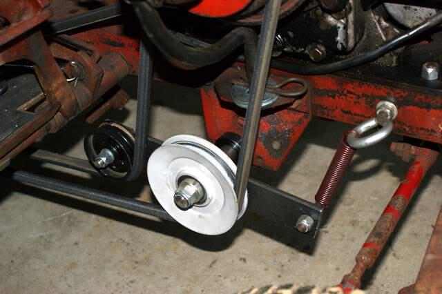

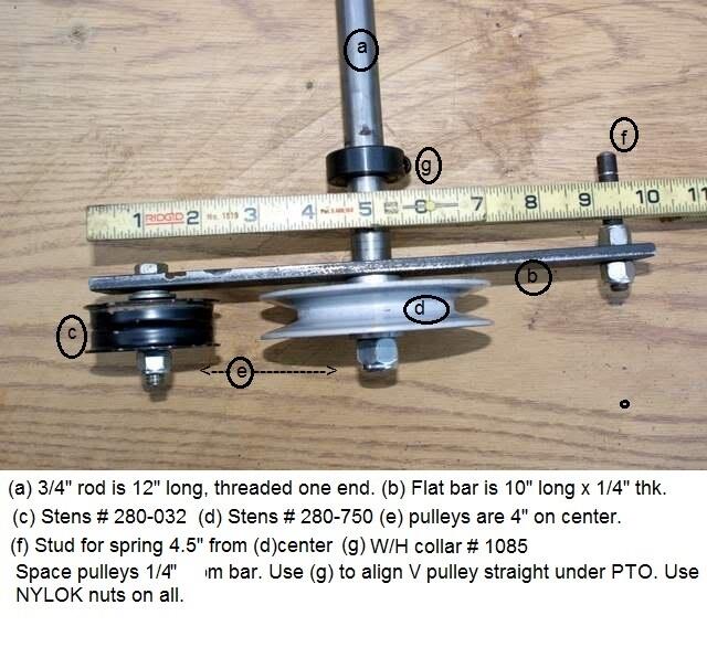

daveoman1966 3,841 #3 Posted March 30, 2024 If on a tight budget (aren't we all), you can make the Mid-Mount Idler Pulley Assembly with parts from a local hardware. 4 Share this post Link to post Share on other sites

xstang77 2 #5 Posted March 30, 2024 7 hours ago, daveoman1966 said: If on a tight budget (aren't we all), you can make the Mid-Mount Idler Pulley Assembly with parts from a local hardware. Thanks for the link I'll get to work on fabbing I imagine ebay is the most affordable place to source the pulleys and wh collar etc or is the collar something can match up at lowes? Otherwise is it correct to assume then I'll just have to order the rear rockshaft kit with cable from the vendor and a belt and I might be in business for under $200? Share this post Link to post Share on other sites
