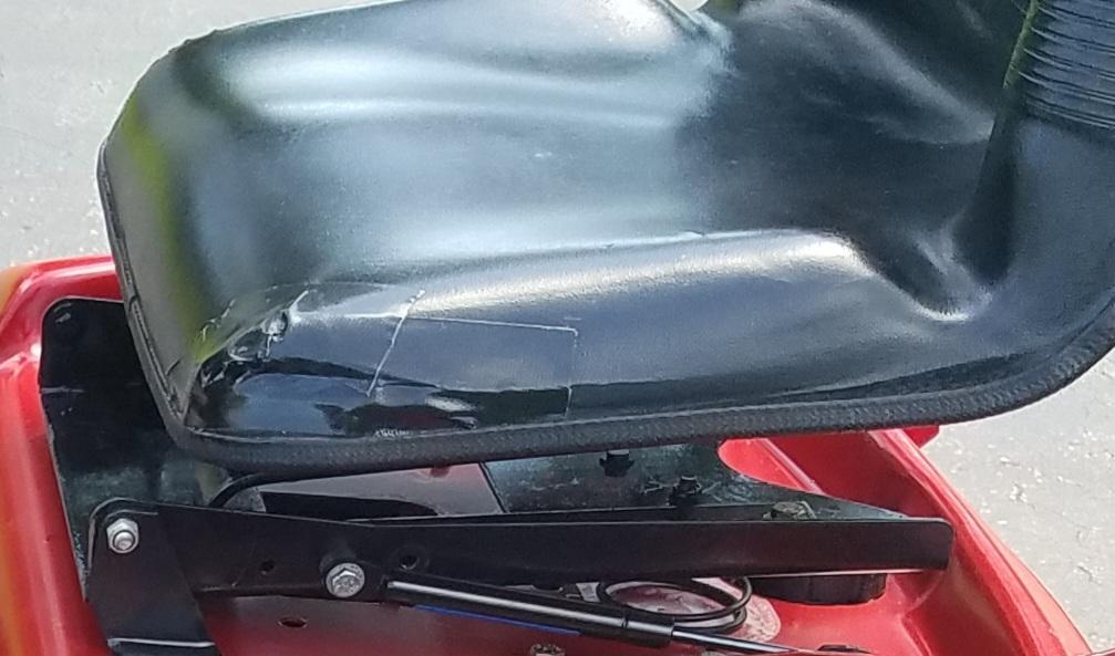

Brockport Bill 2,260 #4 Posted March 29, 2024 cheapest, but not the best solution -- remove the vinyl strip frame edge and clean its inner slot and be sure to save the clip that joins the 2 ends of the edging on front of seat between your legs -- use black gorilla tape to repair the seat vinyl - - take your time cutting repair pieces of tape to fit the contour of the seat -- reinstall the form fitting seat to the steel frame -- folding and tucking the the vinyl seat cloth edges carefully working the vinyl strip edging around the steel frame to re-connect the seat unit to the frame -- You will need to manipulate and compress the foam to its proper contour -- End product should be usable but certainly not like new -- You may also want to visit online sites, or Amazon, etc - - there are vinyl patch repair products sold that have pieces that come in various sizes and shapes or can be cut from sheets -- i believe they are self adhesive -- Another option is local furniture repair shop or upolstry repair shop - - either buy materials they sell or have them do repair -- Also Tractor Supply sells new seats as does Northern Tool etc 3 Share this post Link to post Share on other sites

giant_g2 24 #6 Posted March 30, 2024 Thanks for the suggestions! I think I'll do the gorilla tape for now and look into an upholstery shop in the future. I'd like to avoid getting a different seat if possible. 1 Share this post Link to post Share on other sites
