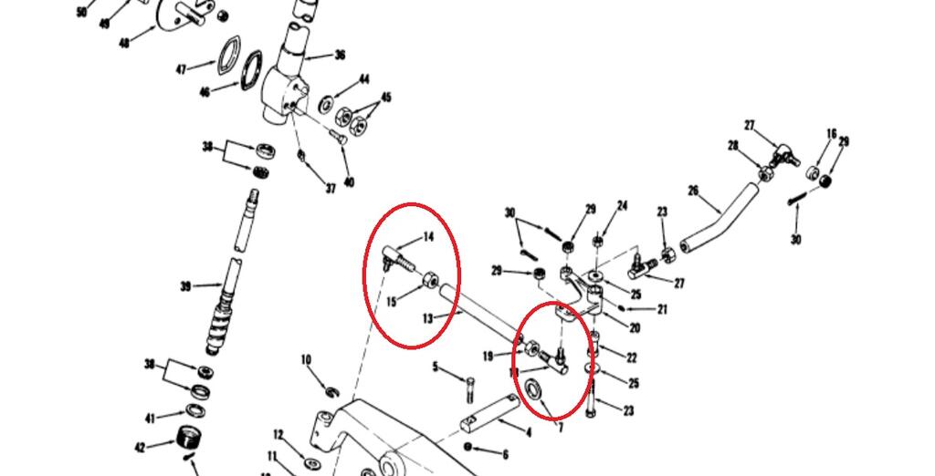

Ketche22 0 #1 Posted March 28, 2024 Hi all. New member here and first time owner/ posting. Looking for a part number for replacement tie rods with bushings for 77 d160. Major camber/ toe out of alignment and worn ball joints. Hoping to replace as one piece. Thanks in advance. Share this post Link to post Share on other sites

wallfish 19,239 #6 Posted March 29, 2024 (edited) 15 hours ago, Ketche22 said: Hi all. New member here and first time owner/ posting. Looking for a part number for replacement tie rods with bushings for 77 d160. Major camber/ toe out of alignment and worn ball joints. Hoping to replace as one piece. Thanks in advance. I'm not familiar with the D series very well but according to that IPL Garry posted for the tractor, those rod ends are threaded into the tube and are adjustable. You just can buy new joints. And- there's 2 more joints on that IPL pic too that aren't circled. If you in there might as well replace them all. Edited March 29, 2024 by wallfish 2 Share this post Link to post Share on other sites
ri702bill 11,232 #7 Posted March 29, 2024 (edited) 13 hours ago, Ketche22 said: Major camber/ toe out Welcome!! A camber issue could indicate either a bent spindle or severely worn axle bore. Toe-in is adjusted just like a car by lengthening or shortening the tie rod assemblies, as pointed out above. Or - the tie rod tube #13 could have a bend or kink in it - That would make for severe toe-out on one side...... Edited March 29, 2024 by ri702bill Share this post Link to post Share on other sites
