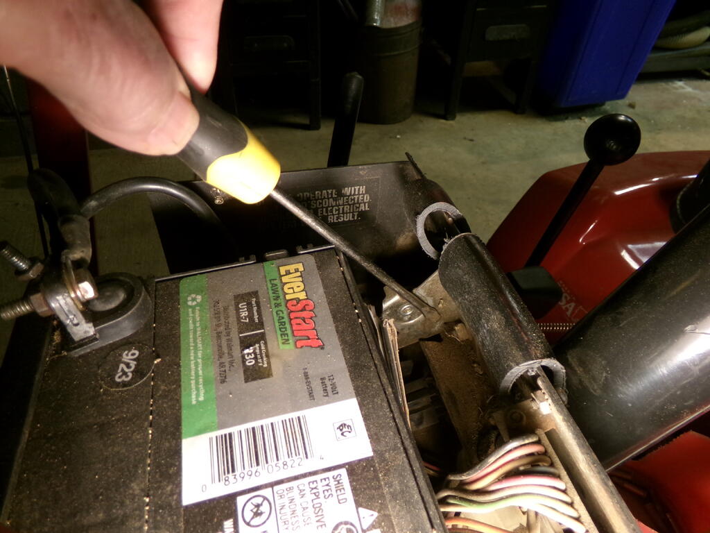

Ed Kennell 43,101 #8 Posted March 25, 2024 Sometimes a picture helps. This is the rivet you need to squeeze or drill out and replace with a bolt and nylock nut. 5 1 Share this post Link to post Share on other sites

tunahead72 2,581 #10 Posted March 25, 2024 14 minutes ago, Ed Kennell said: Sometimes a picture helps... It does indeed, thanks for covering my lazy butt! 2 Share this post Link to post Share on other sites
