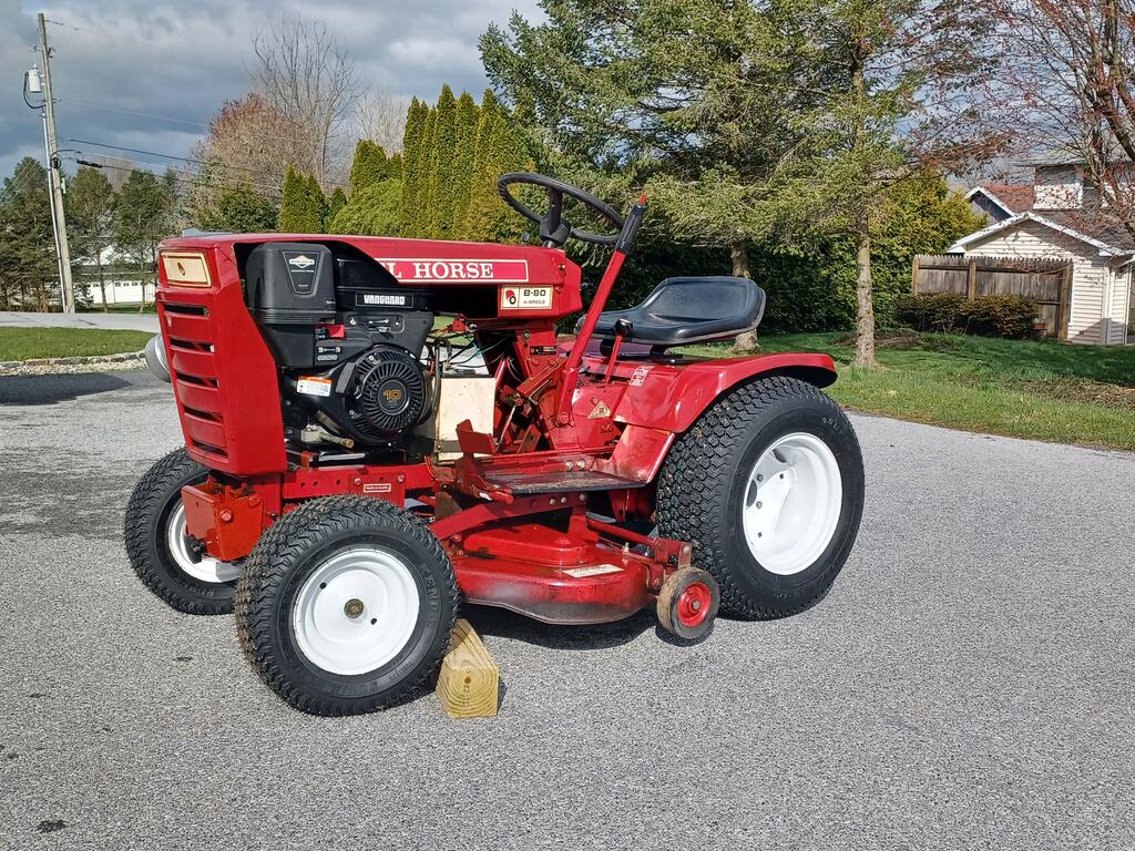

giant_g2 24 #3 Posted March 22, 2024 (edited) This is a rear discharge. The spindles are round with 2 flats. It came with a 1975 B80 the metal tag on it says model 5 0612 9 Edited March 22, 2024 by giant_g2 1 Share this post Link to post Share on other sites
gwest_ca-(File Mod) 11,444 #4 Posted March 22, 2024 The 5-0621 should have registered but didn't. The 9 makes it a 1974 model. Click on the fuzzy pictures for more info. 2 Share this post Link to post Share on other sites

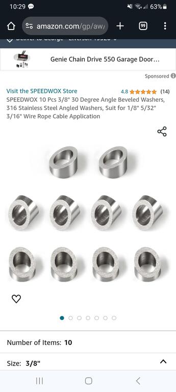

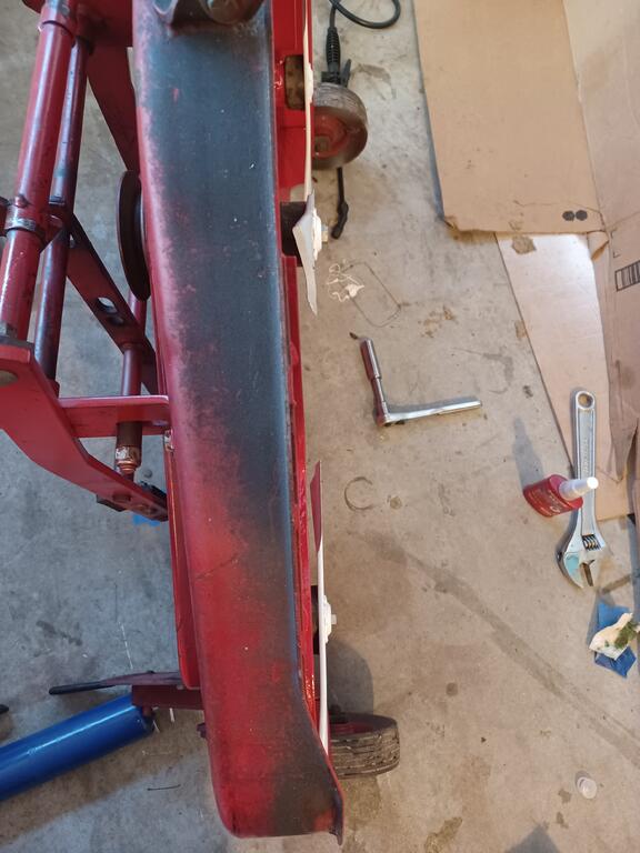

giant_g2 24 #14 Posted April 5, 2024 I have one safety related question. It seem slide the rear guard is just a straight extension to the deck and that the blades could easily throw balls/rocks/etc backwards. Has anyone tried using beveled washers to change the angle a bit? Something like these. I can't see it causing any problems, so I might give it a try. Just wanted to see if anyone had any input on this sort of thing. 1 Share this post Link to post Share on other sites
ebinmaine 72,404 #15 Posted April 5, 2024 3 hours ago, giant_g2 said: input I've seen pics of a deck that someone had built and installed a different or extended shield. I don't recall the extra length or angle but I believe it was slanted down maybe 30⁰ or 40⁰ and extended 3 to 5 inches so it was an inch or so higher than the bottom of the original deck. I like this idea because it would also keep more dirt and grass clippings out of the transmission. 1 Share this post Link to post Share on other sites

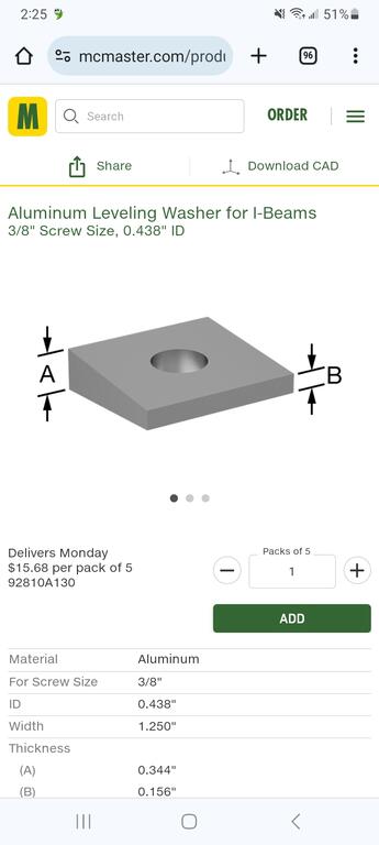

giant_g2 24 #16 Posted April 5, 2024 I'm going to give these a try. I think the flat wedge shape will spread any force out a bit. I think they're also a shallower angle than the 30 deg ones I posted earlier. 1 Share this post Link to post Share on other sites

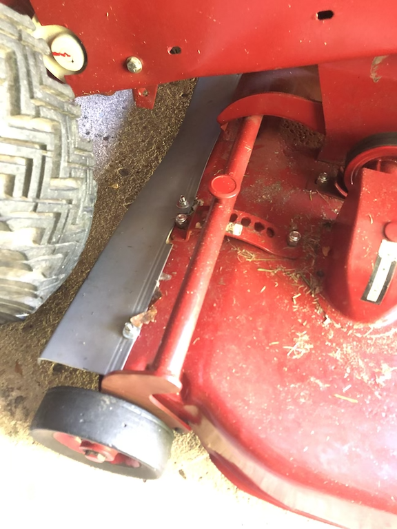

Handy Don 13,976 #17 Posted April 5, 2024 43 minutes ago, giant_g2 said: I'm going to give these a try. I think the flat wedge shape will spread any force out a bit. I think they're also a shallower angle than the 30 deg ones I posted earlier. I've put these on two RD decks--a 42” and a 36" geared. 4” vinyl cove base. They help A LOT at keeping stuff from blowing or throwing around. 3 1 Share this post Link to post Share on other sites
Brockport Bill 1,932 #18 Posted April 5, 2024 1 hour ago, Handy Don said: I've put these on two RD decks--a 42” and a 36" geared. 4” vinyl cove base. They help A LOT at keeping stuff from blowing or throwing around. Don - i may have originally borrowed "stole" the rear discharge flange idea from you a few years ago ? Put them on a couple 42" r.d decks -- yup, used Vinyl cove base - works perfect !! 4 1 Share this post Link to post Share on other sites

giant_g2 24 #23 Posted April 14, 2024 Thanks! I did mow with this. It worked fine. I had it on the second to highest setting. I would guess the lower setting would require a much smoother/flater yard than mine. I'm still working on the idea ro change rhe angle on the guard to direct it down more. The washers I posted before won't work. The 2 of the 4 bolts holding it on are at a different distance from the edge, it end up that I would need different angled washers for two of the holes. Using the same 4 ends up with a slight gap between the body and the guard. 1 Share this post Link to post Share on other sites
ebinmaine 72,404 #24 Posted April 14, 2024 2 hours ago, giant_g2 said: still working on the idea ro change rhe angle on the guard to direct it down more Might be easier to leave the guard in place and ad the vinyl piece 🤔 Share this post Link to post Share on other sites
giant_g2 24 #25 Posted April 19, 2024 Yeah, but my main concern was stuff the vinyl won't stop, like rocks or baseballs in tall grass. The kids are always leaving stuff in the yard. 1 Share this post Link to post Share on other sites
